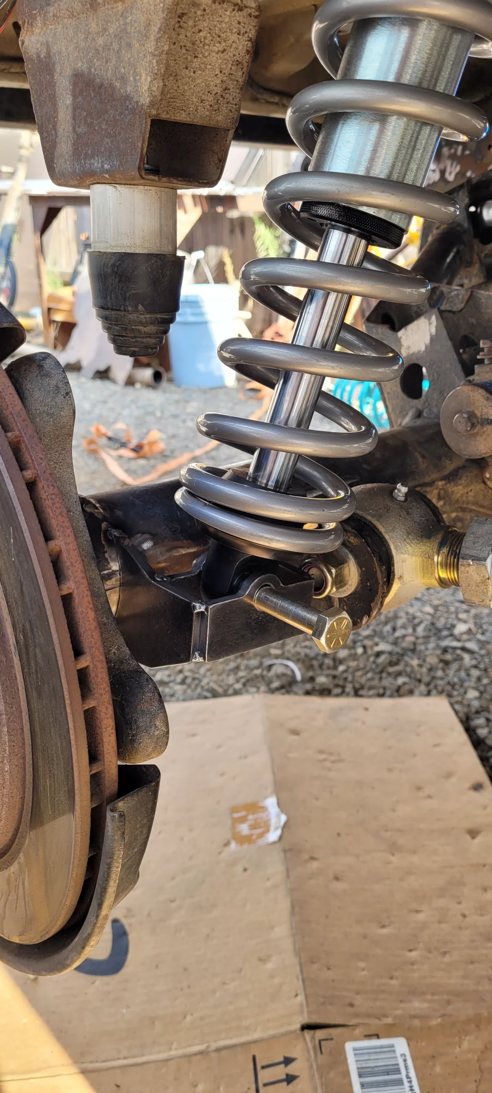

Coilovers are way overkill, all started with wanting to lower it and needing to replace the trashed OME shocks. Along with redoing the steering and needing the real-estate the factory coils occupy.

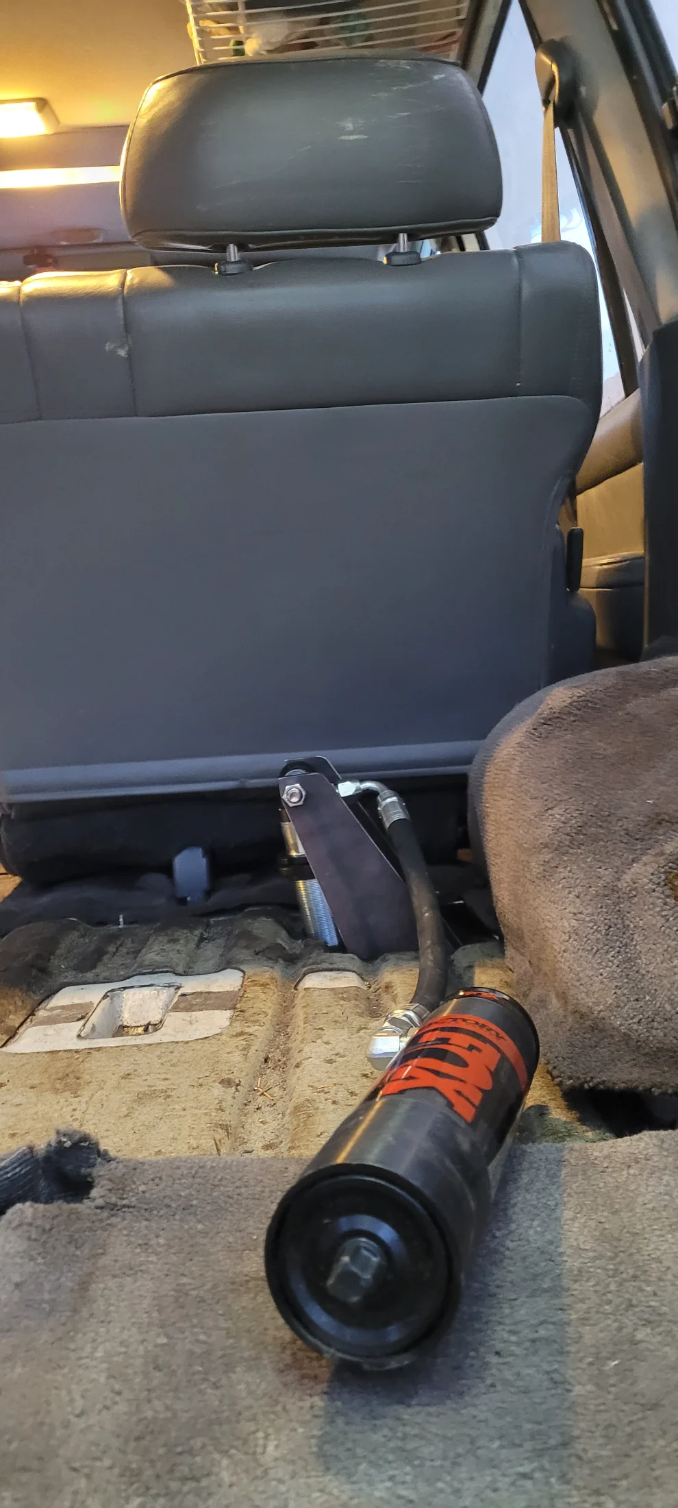

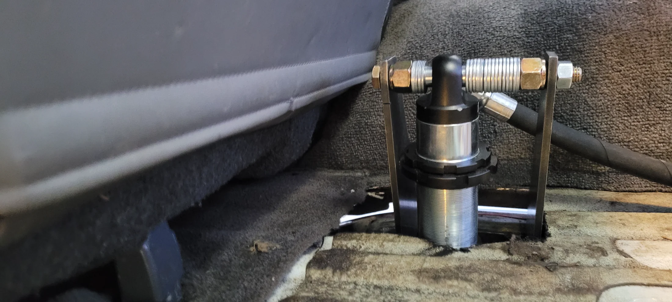

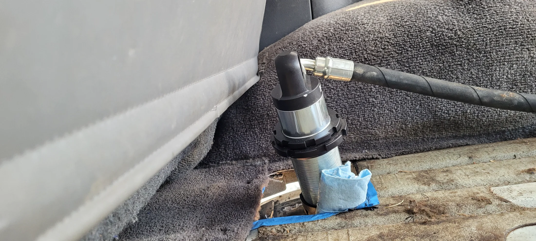

Current rev. mount. Look good, shock top will not be any further forward than this, need to get a mount up there all while missing the seat and it's fold down motions.
Going to make one small tweak for the drivers side and start doodling up the upper mount. Think the reservoir will end up being inside if I can snake the mount around it...

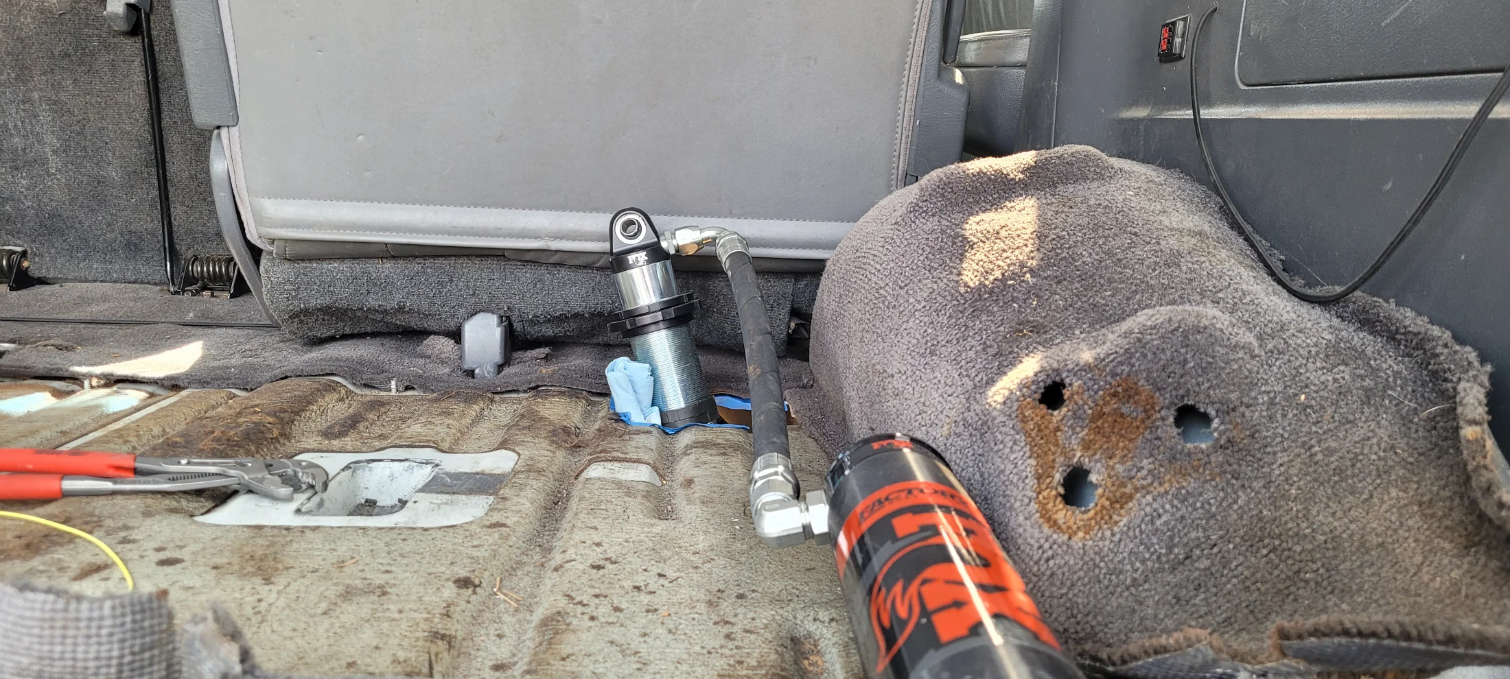

Actually has clearance and full travel. Ignore the bump-stop extension/extension/extension. The two inches of shock shaft is for the some day hydro bumps.

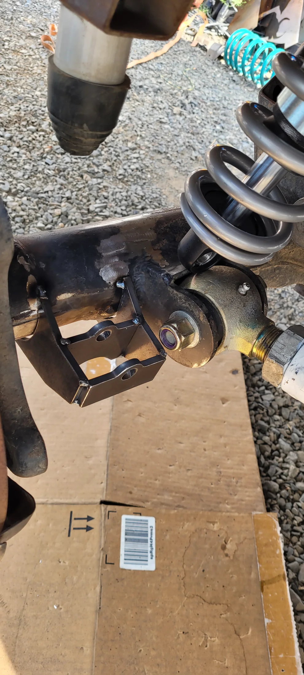

Next up is modifying the wishbone, burning the brackets to the axle and re-making the brake lines across the axle. Along with finishing the rear driveshaft and sealing the body.
Guess there is more to do than I recall... Everything has been drawn up and cut on my plasma table, nice to make quick revision changes and start cutting while doing other work. Might offer up some or all the brackets in the near future.

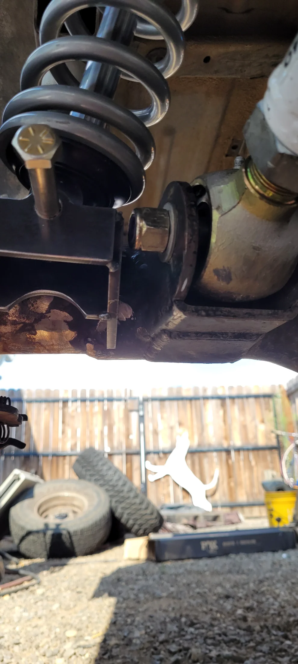

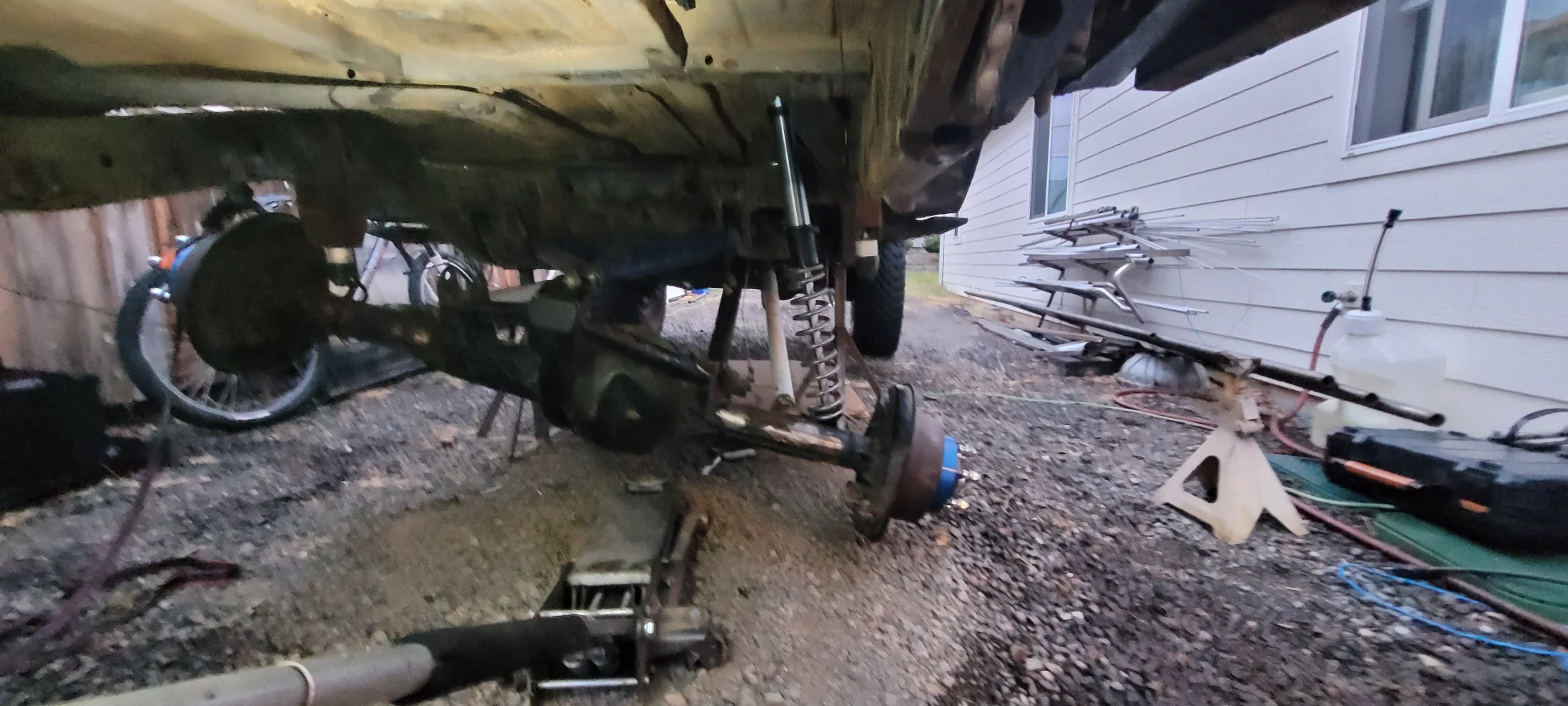

Got it moving enough to move it to the driveway. Boy gravel is rough to work on after having concrete!
Close to done. Still need to mount the reservoirs, air tank and build the rear winch tray. Think I'm in the ball park for spring rate now, but want to get some miles on it to let things settle.
Waiting on clamps to attach the brake lines, axle breather and elocker wiring.

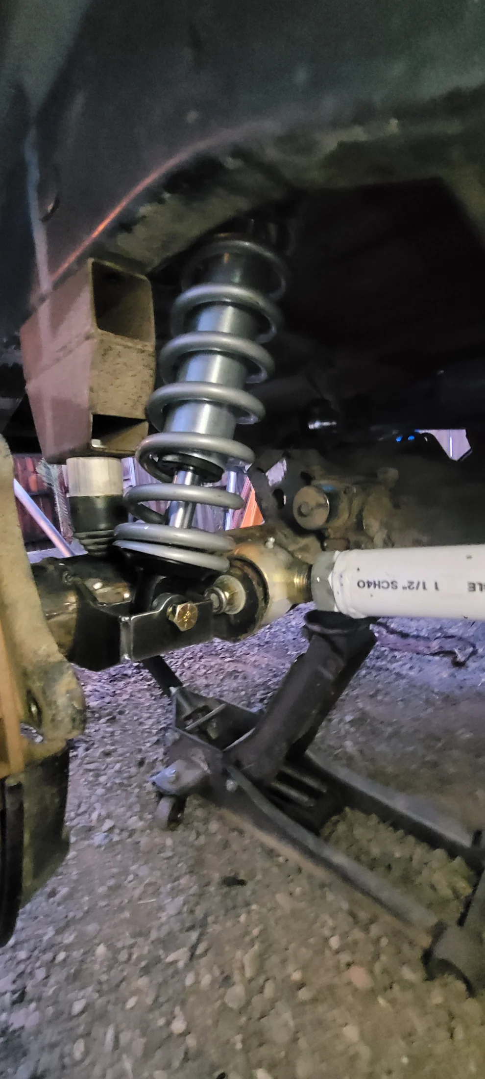

Front towers cut, assembled and ready to be burned in. Need to add a couple small fishplates and should finally be done with this part.
Going to be relocating and finally mounting the charcoal canister, moving the brake line junction and lines to where the firewall intersects the frame and routing the front brake line down the drivers lower link and ARB down the passenger. Figure its time to finish up all these little details... Also have the reservoirs plumbed to be mounted next to the top of the inner fender just outside of the hood strut, will have to move the washer reservoir and figure out how much tube work I want in the engine bay.
Notice the awesome temporary panhard mount.. Got it buttoned up enough to move to the driveway and out of the gravel which is nice for building, but I don't have enough power to do finish welding. Really need to get a 220v welder one of these days.
And this is where I am stalled at. Front axle is cleaned up and C/O mounts done. Final welding is waiting on finishing the axle side panhard mount, which is waiting on knuckles. Brake lines clips/mounts are also waiting on knuckles. Also me being lazy and not wanting to move the axle around for routing lines down the links, waiting on knuckles.
Just waiting on a couple parts then plan on burning it all in at once, ready to drive this thing so I can tear it apart again...
