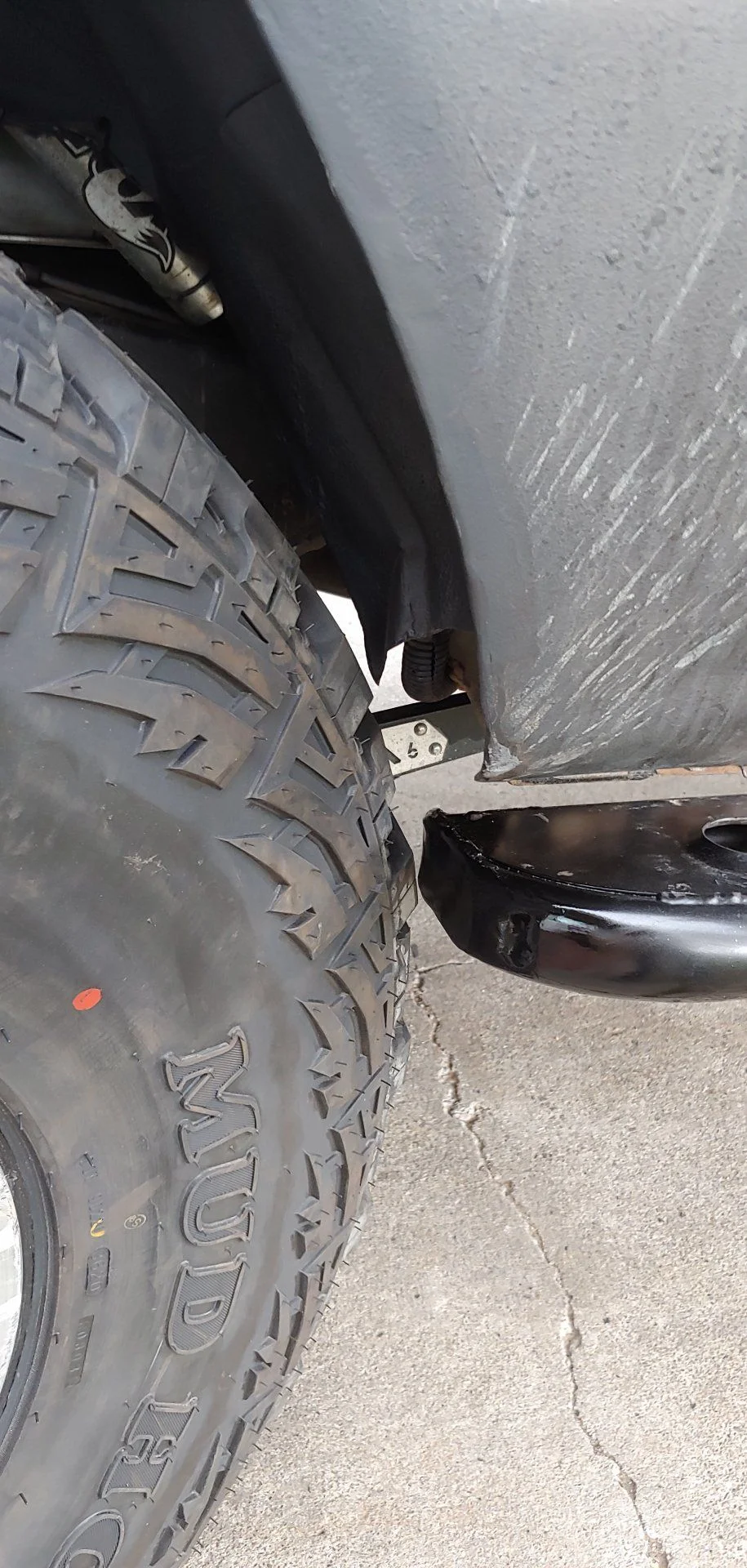

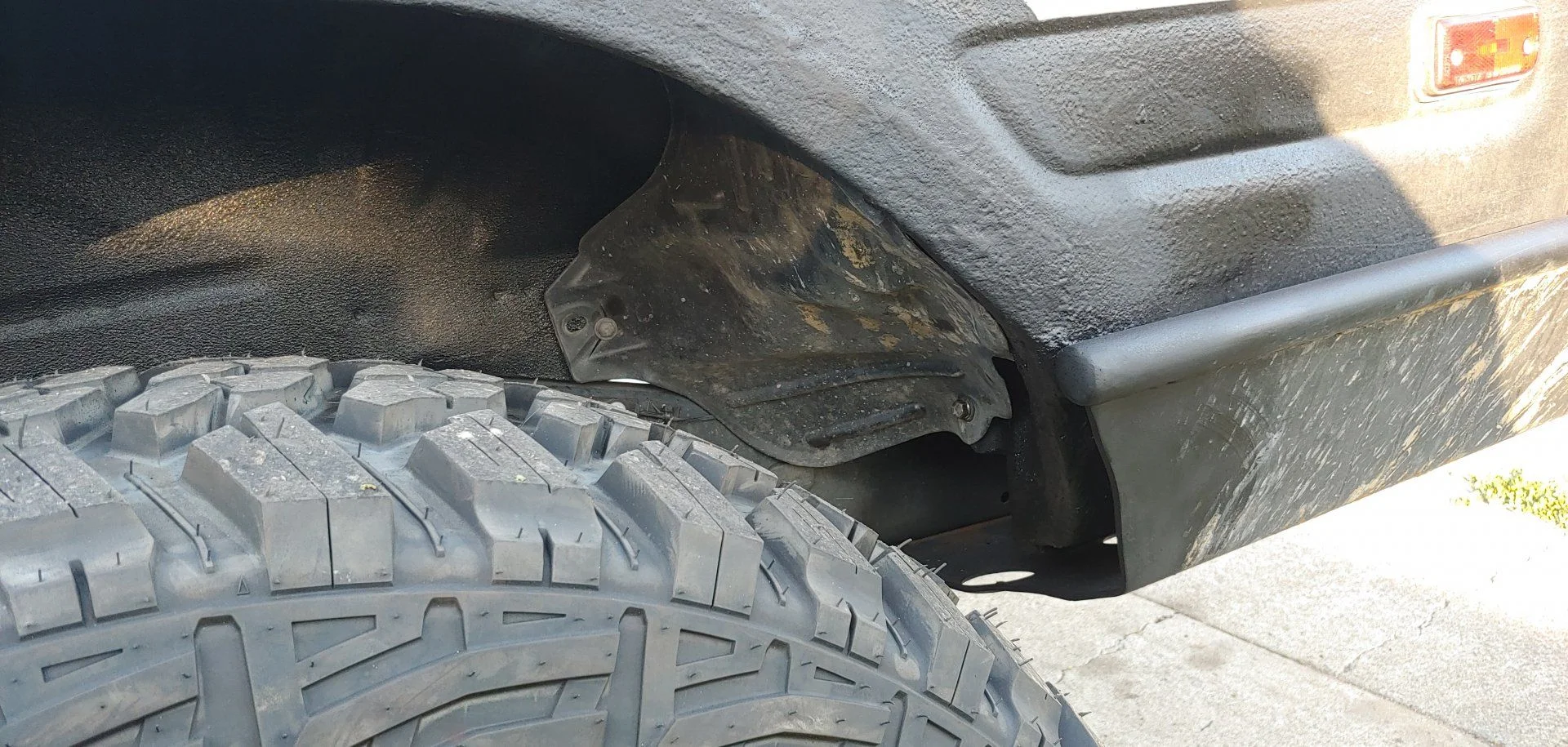

40's can be wheeled hard on "stock" axles, but it's tough on them. Weight is a huge factor, I can't wait to be back under 6k fully loaded, which is still heavy, but not terrible. Lighter than most JK's.
Fenders look awesome, you guys that took the time to seal it up nice make me jealous.

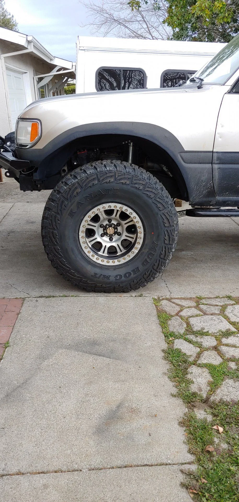

Rears done

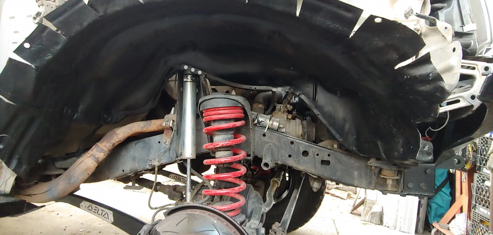

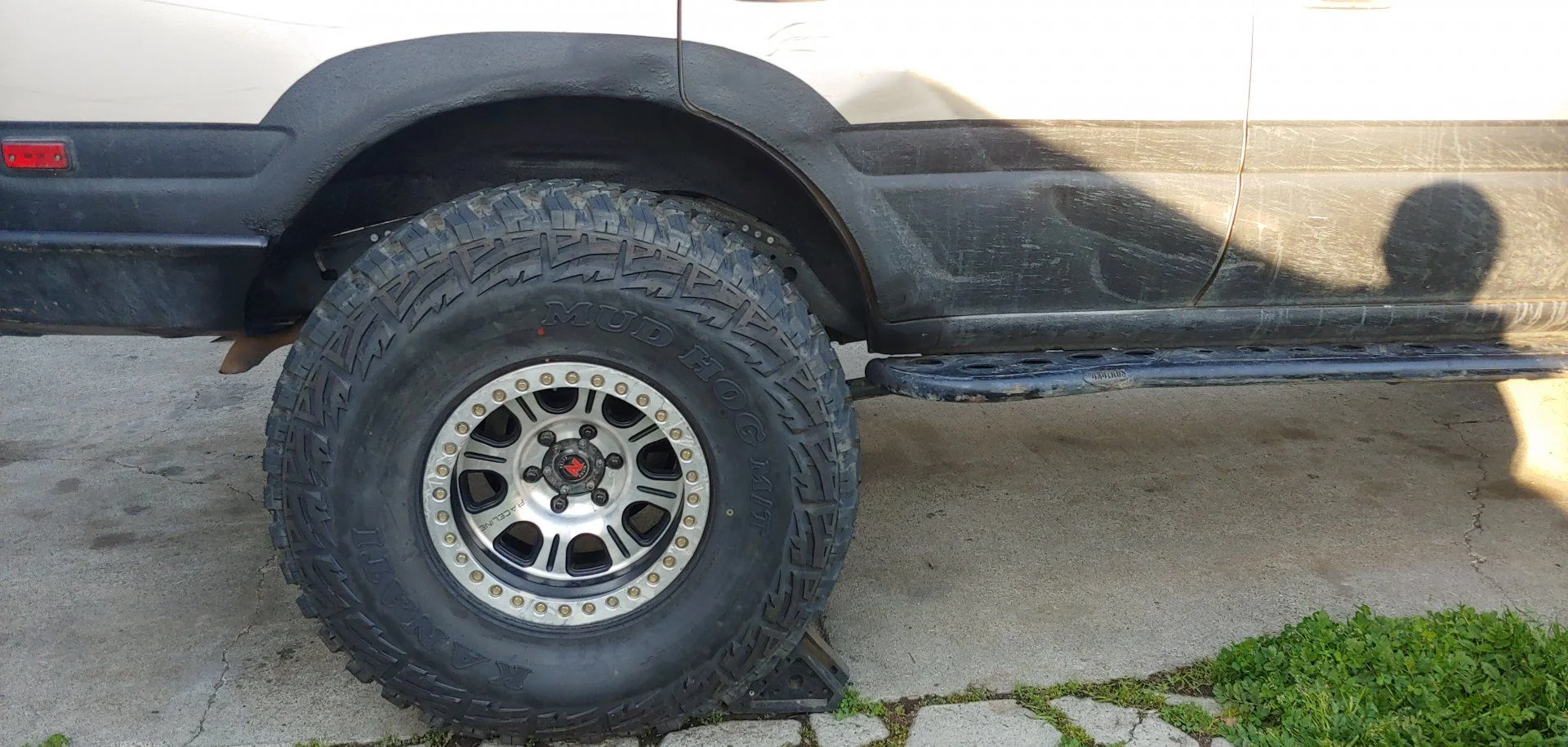

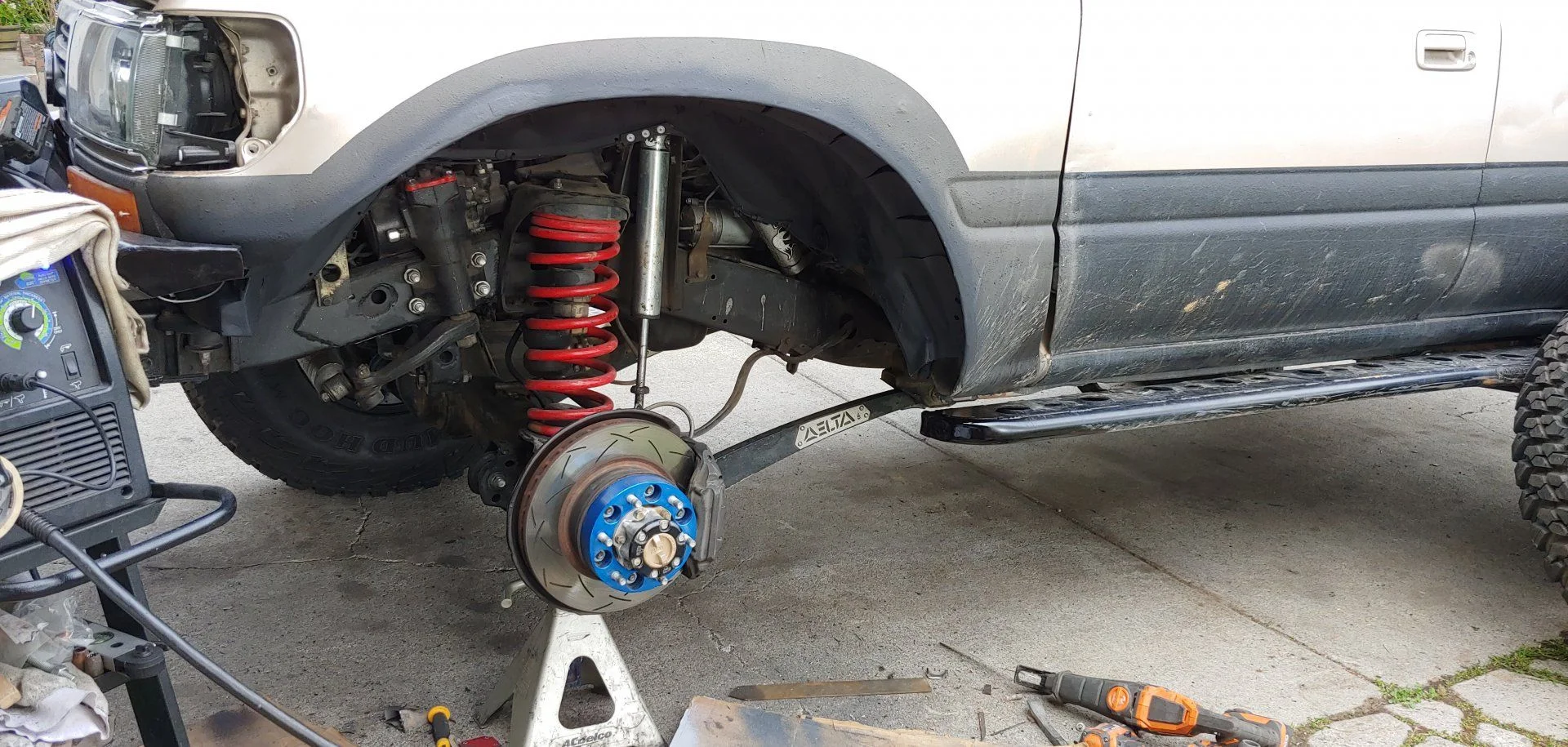

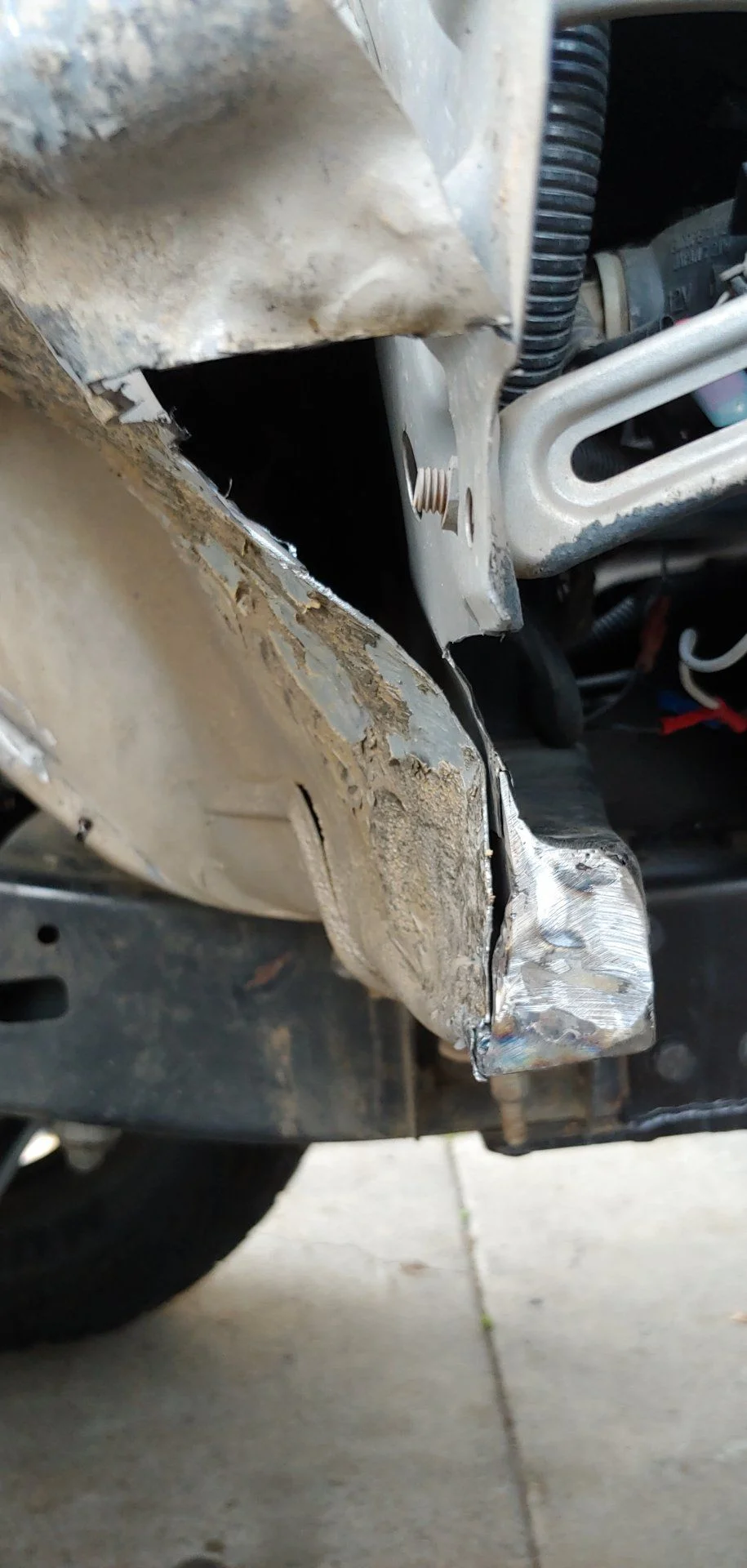

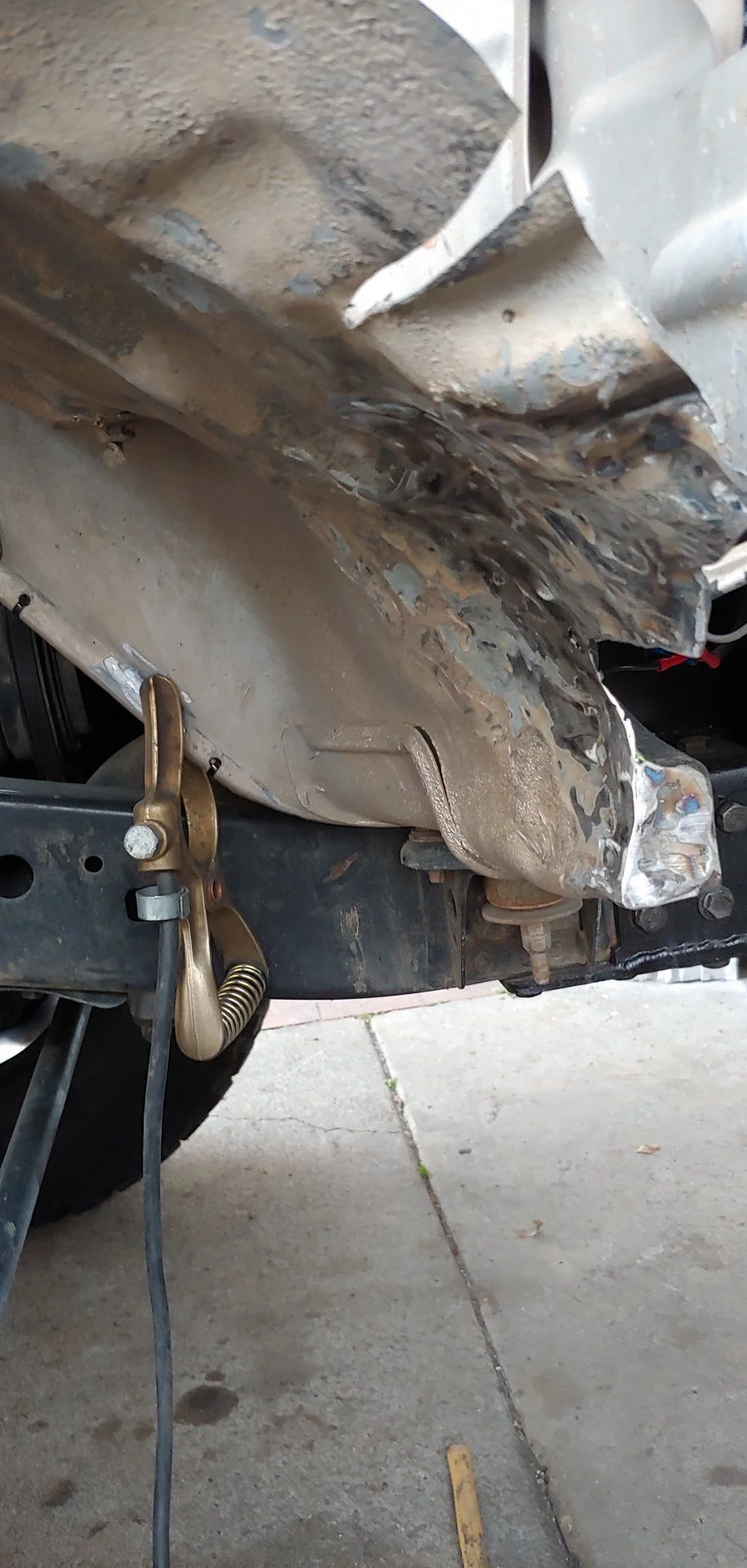

Last side today. Only took me 4 weekends. Ugh. 1 side each weekend. It's a lot of f...kn work welding it up. Thin sheet metal sucks.
I still need to close up the pie cuts up front only. Ita cosmetic at this point but 100% clearanced and functional
Did you remove the springs and cycle the suspension in different scenarios to determine exactly how much body you needed to remove or just guess?
Eyeballed, free handed and guessed. Good enough. Lol.
And a lot of big f...kn hammer! Sledge hammer too.
The other way takes months instead of weeks, ask me how I know ;)

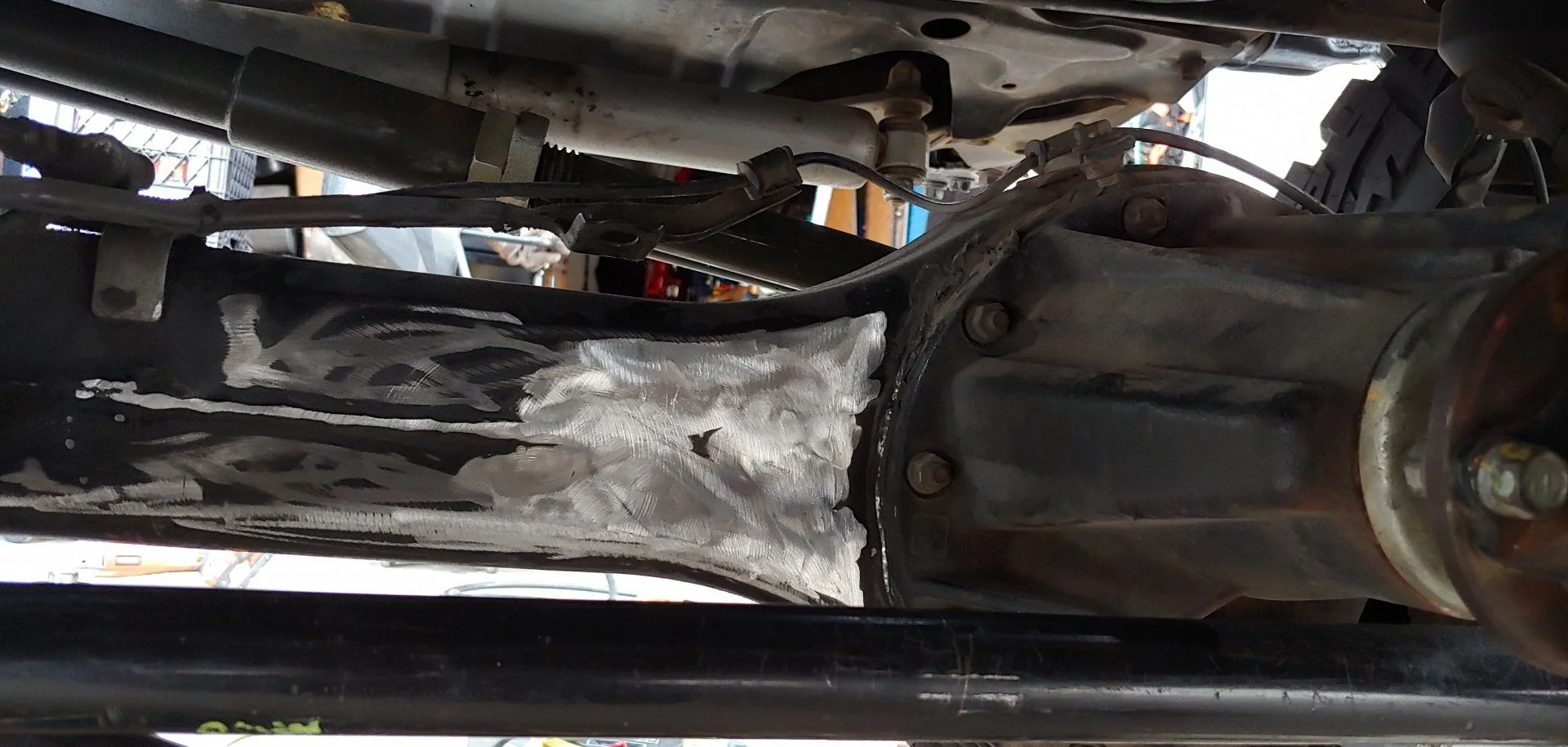

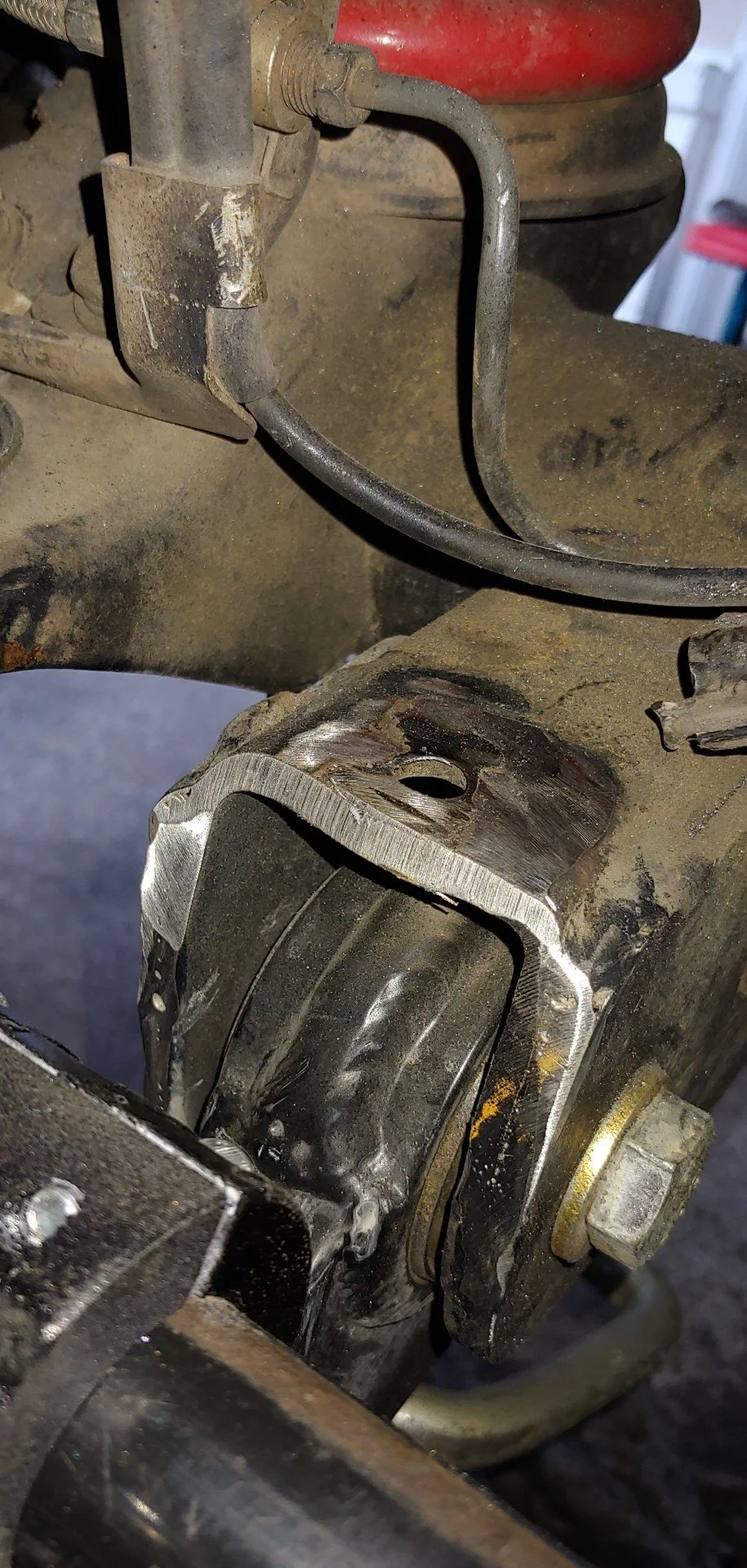

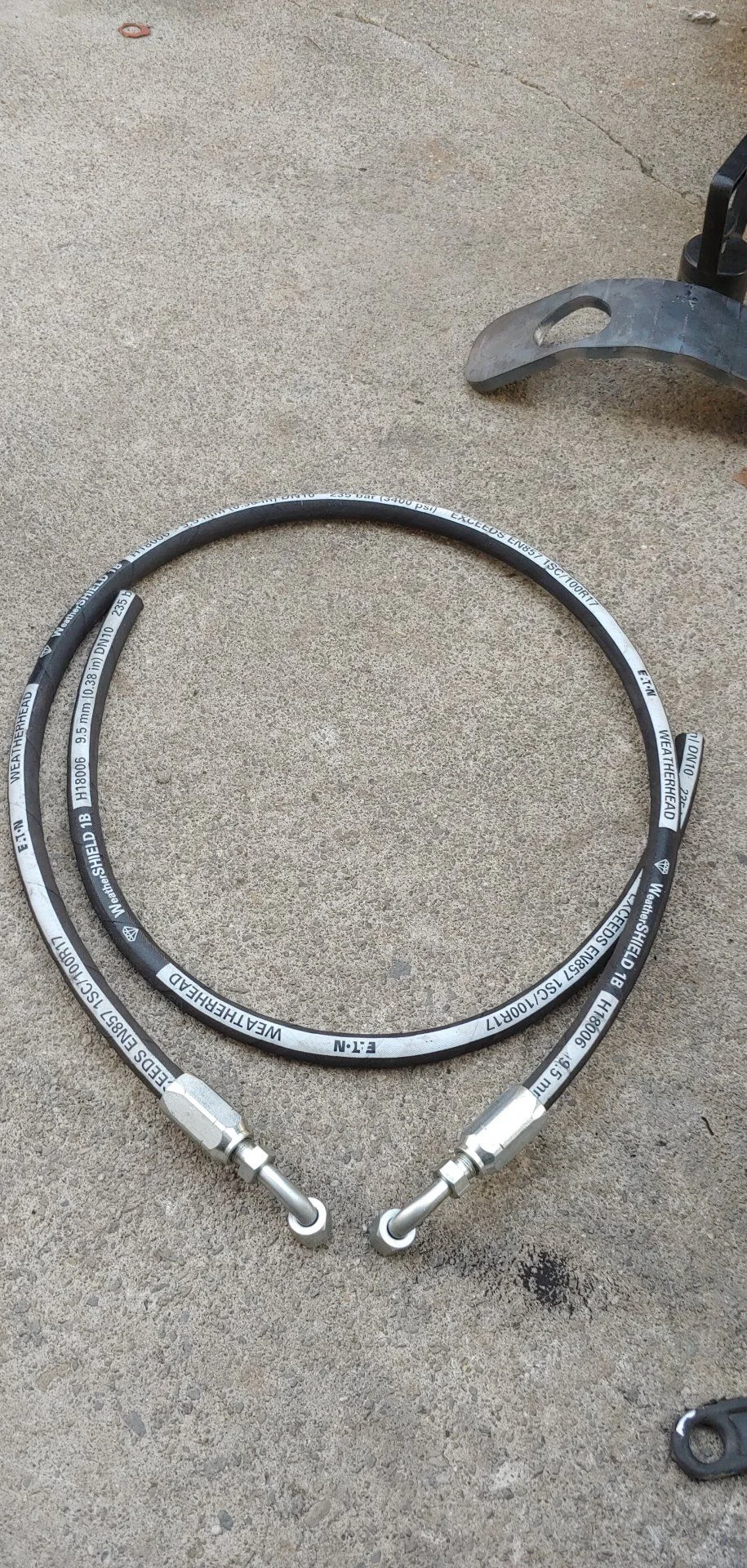

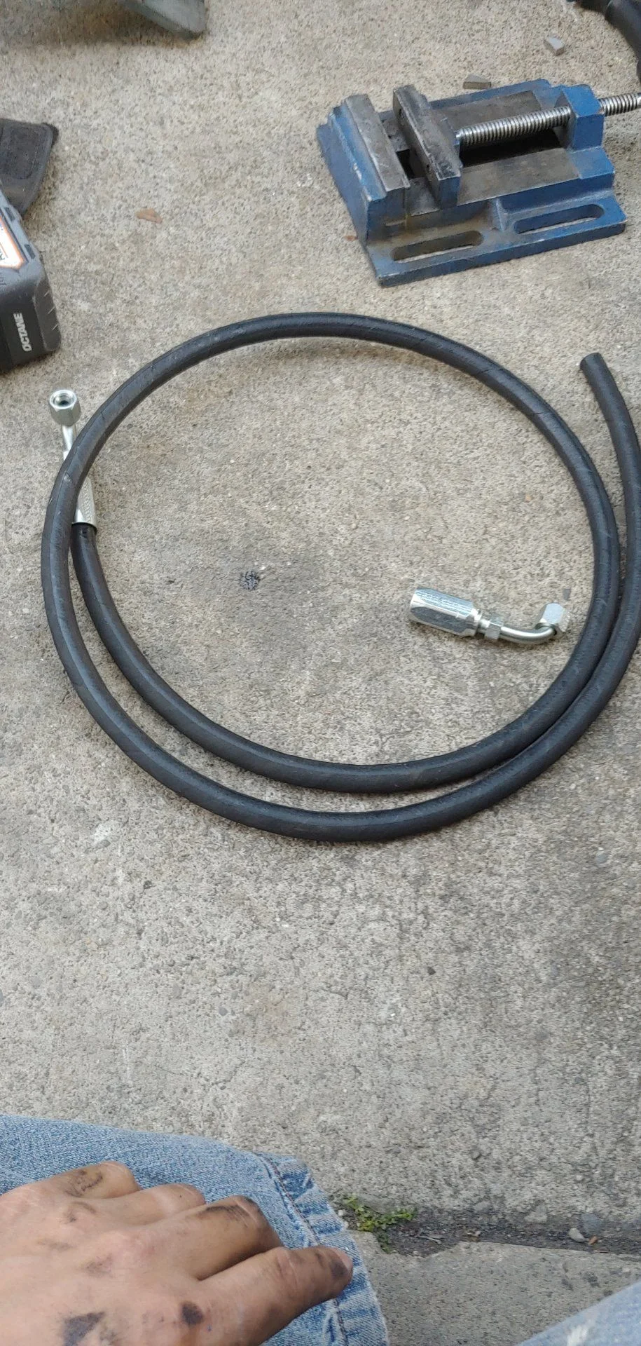

Ordered a bunch of AN6 and AN10 lines from Summit and amazon to finish my reservoir and cooler install. I have a 1.75 inch drag link bar I will be cutting off and welding on new ends to work with my EMF TREs (already have EMFs in the rear tie rod bar with my new hydro). Then I will be welding on the axle housing trusses, diff armor and knuckle ball reinforcement. That's going to surely melt the axle seals. So the front axle will need to be rebuilt and what better time to pull the diff out when the shafts are out. Pulling the diff out will go out for 5.29 install. That's the one thing I'm not confident on DIY. I'll rebuild a motor before I'll do my own gears. I really need someone to show me how its done so I can learn. Or maybe watch a few dozen YouTube videos.
Lots of front end work going on. Won't really get to test out my new hydro till the front end is all back together.

I think it's worth it to pull the front axle housing to do all that welding, That how I did mine, I also used a Jig when doing all The welding ;)
Yea I saw your post on that. Unfortunately, don't have a BIG ASS railroad tie or beam to use to anchor it down to prevent warping. I know that's the preferred method but I can't think of any way to put downward pressure on it.
I do have some 4 foot tall jack stands I could put on the frame allowing the heavy 125lbs tires to hang down. I was also thinking of maybe using a small bottle jack to push down on the ball some how. I'm thinking maybe a lot of wood pressed up on the inner wheel well or shock tower to put a downward force.
I do not like taking out the whole axle housing alone. I did that 3 times in the past. Once on my Turbo80 and twice on my sold 93 LC. Only had help once and the other two times I fought the reinstall for hours. Not my idea of fun solo wrenching job.
The least I will be doing is putting the entire truck in the air with my 4foot jack stands on the frame and letting all 125lbs each wheel hang. Tack it all into place and SLLLLLLLLOOOOOOOOOWWWWLLLLY stitch weld all that on. I mean slow too. I will do 1" inch every 15 to 30mins and work side to side. It'll take me probably a week to stitch all that in but that's the only way I can think of letting it cool down to prevent warping.

Strip everything off the housing before you pull it you need to anyway, after that it’s pretty easy to man handle I just can’t see doing all that welding under the truck.

If I lift it with my 4 foot jackstands on the frame. it's decent space to weld underneath. It wont look pretty in spots with hard access.
