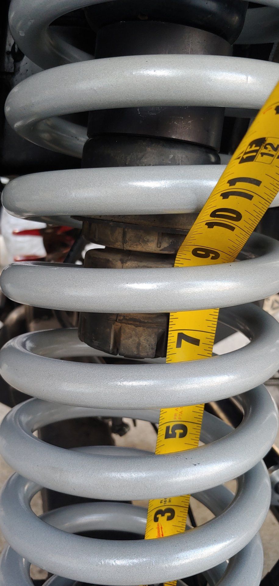

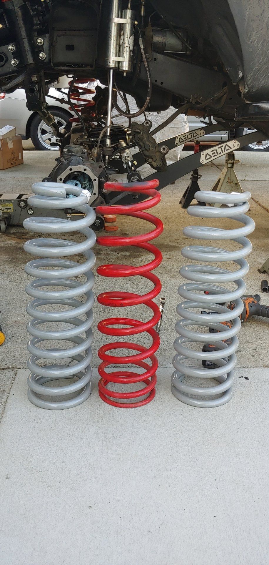

The heavies are a 4” lift spring if your rig weighs something like 7k pounds. Mine lifted my rig almost 6” empty and what I call a full load only mashed them maybe an inch to 1.5” inches so I still had at least a full 4” of lift with my version of a heavy load. And they don’t ride harshly unloaded. A high quality product.

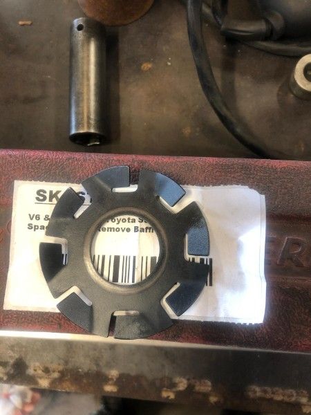

He had to tear mine apart 3 times before the pattern was right. He also used the factory oil singer gear with the solid spacer. Nitro in the box said its ok not to use it. He was like thats crazy since Mr T has it in there for a reason. He had to modify it to work but it's in with the solid spacer now.

Here are pics of the Original Mr T oil baffle slinger. The sticker said to remove that. My buddy just modded it to work with the solid spacer. Most installers would have just thrown that away. He did the same mod to my Turbo80 488s oil slinger.
Mr T engineers put it there for a reason!
My diffs were built by Justdifferentials with solid spacers. When I replaced the front pinion seal and worn companion flange, the slinger was there.
It’s good to know that some builders might leave the oil slinger out.
Mine doesn’t have one of those.

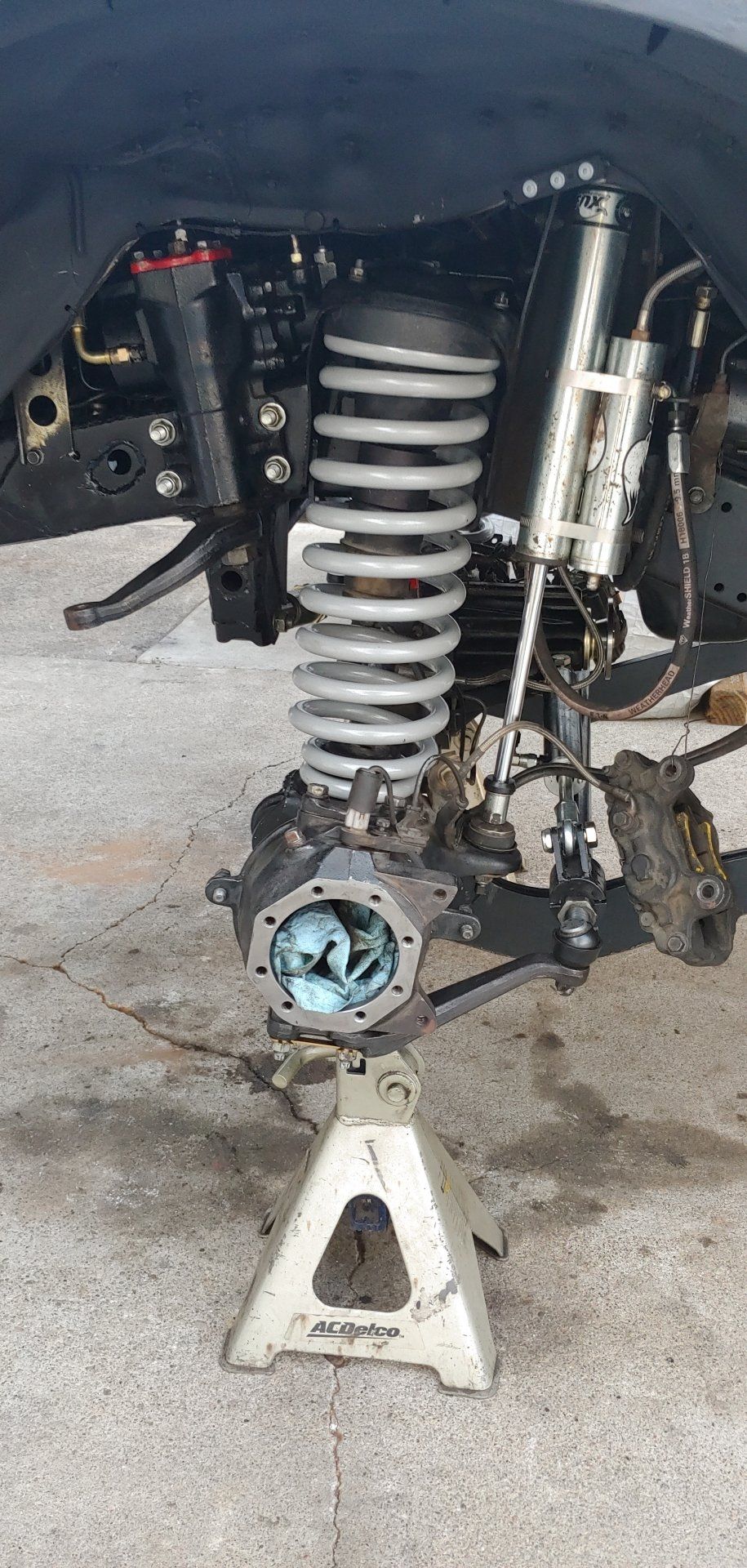

Popped in the shafts and assembled the knuckles.
Waiting to ABS delete before put driver tire on.

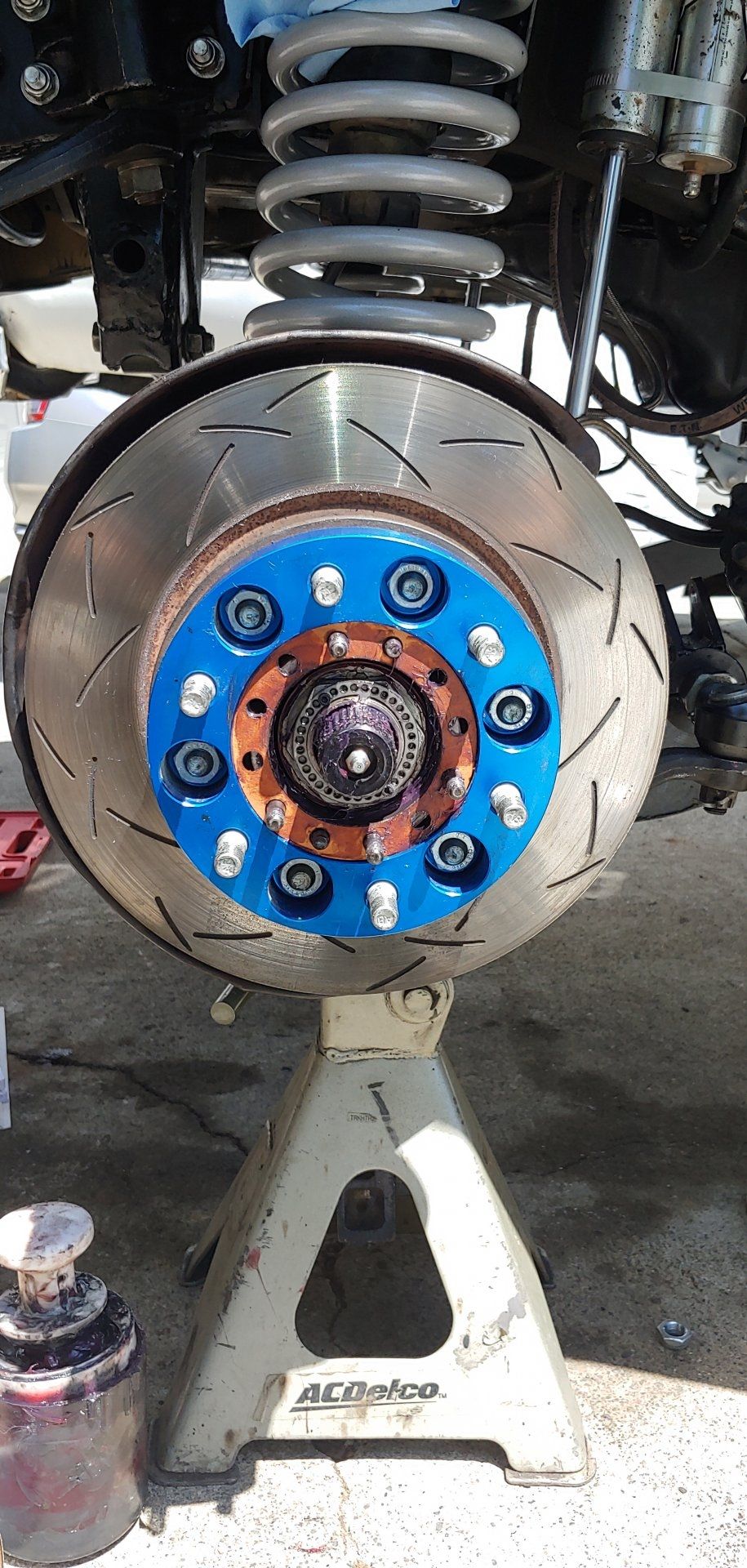

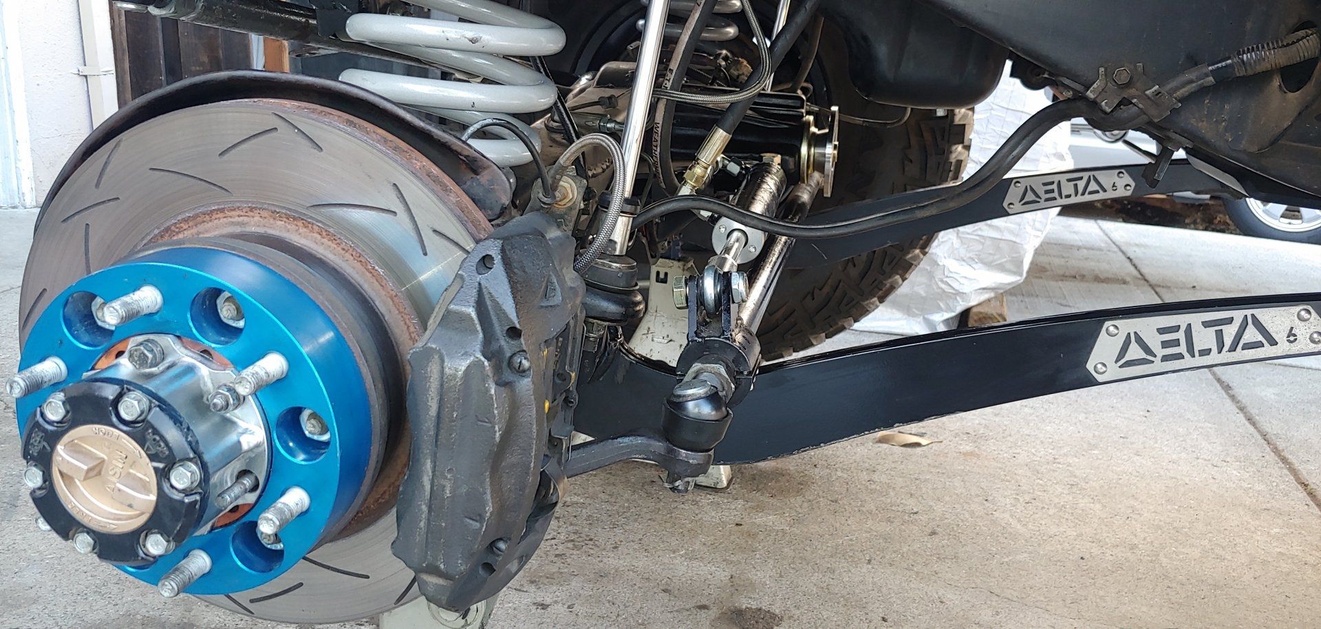

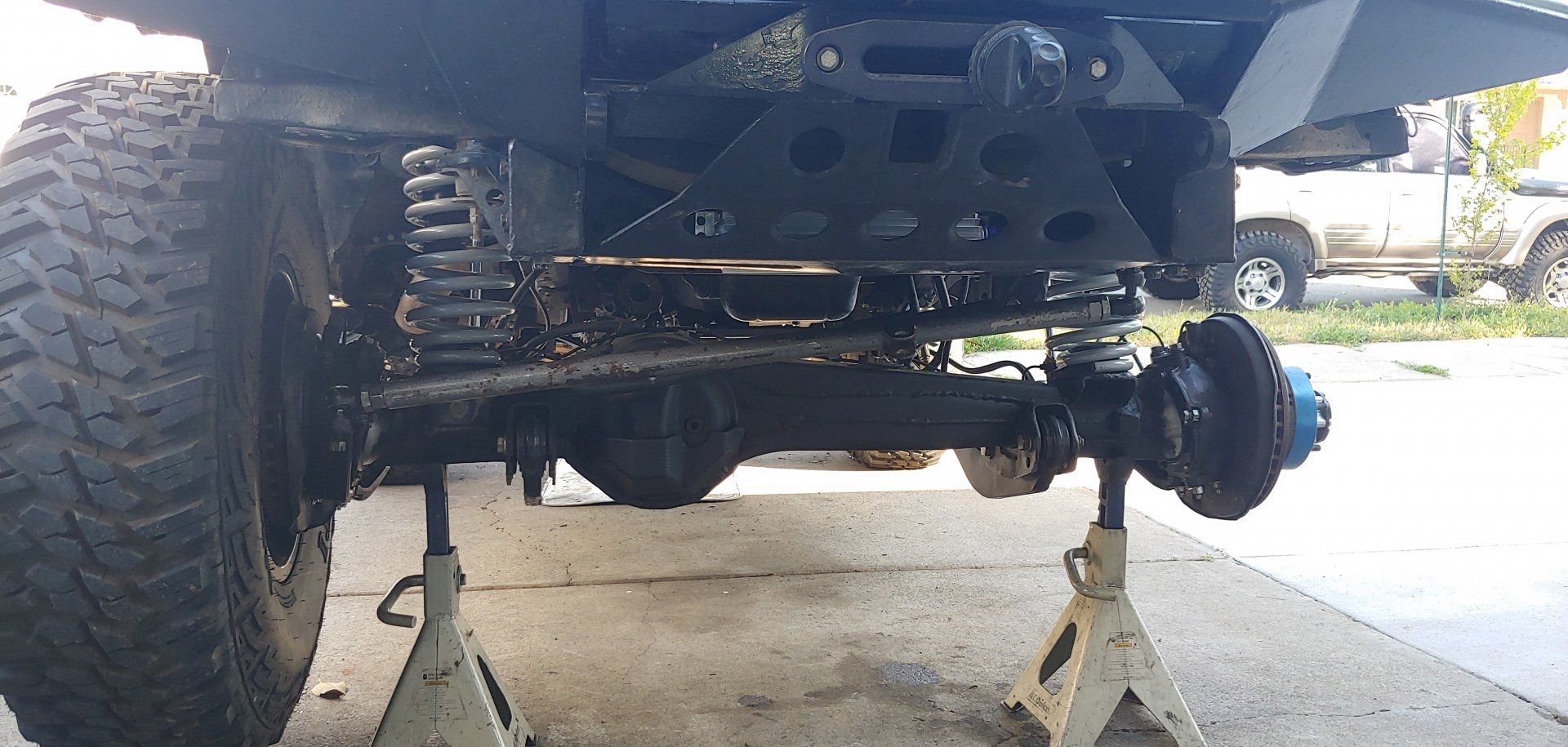

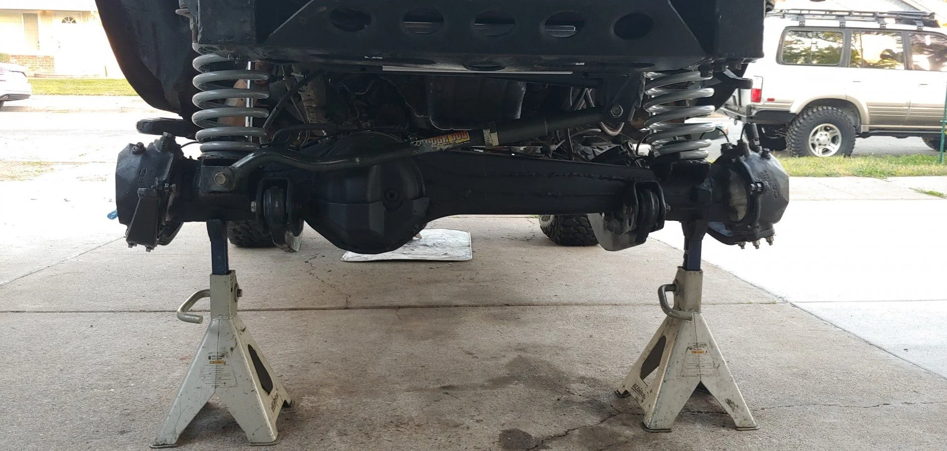

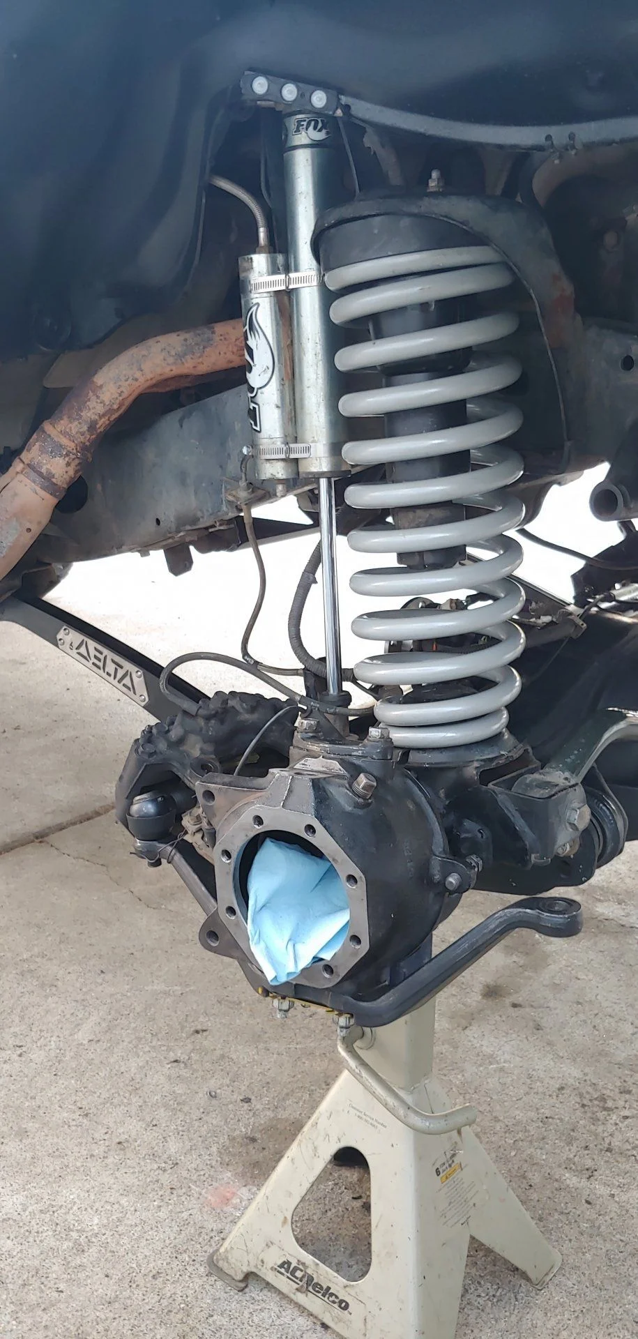

I'm thinking with 5" of lift and the Delta arms you may need a longer drive shaft. I'm sending my in to be lengthened after moving my axle foreword.
What back spacing are your wheels, I'm curious as to why your running wheel spacers.
The Slee shaft is made for 4 or 6 inch lift.
My mini shaft is the same length as the Slee. Its good to go. Its at the perfect length at rest.
Plus my mini shaft has long spline which probably isnt needed for an 80. It won't be popping apart at full droop.
Extra width so it feels less tippy. I ran it that way to Hammers on my 4in. It wheels fine and actually felt really stable. I got spacers in anticipation for my original thought of going 6in lift. Yes I know wheel spacers put pressure on bearings. Don't care, this is not a daily driver. Wheel bearings are cheap and easy to replace.
BS 3.75 on the racelines

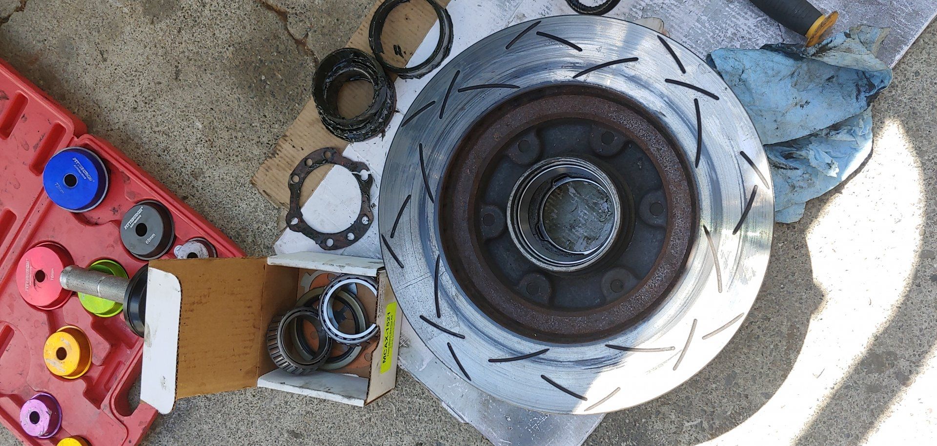

Fixed the Slee shaft using a die grinder and clearancing the flange. Cut a 13mm wrench to make a custom length and thinner profile and opened it up to 14mm. I have like 3 13mm wrenches for some reason. Time to make use of one of them.

Getting close to done. Weekend... I will weld lower rear Eimkeith link armor. Weld in my rear currie antirock sway. Wheel bearing job in the rear. Then pop in my rear diff and reassmble all the rear axle and install new Slee 4" heavy progressive springs and Dobi 4-5 yellow shocks.
