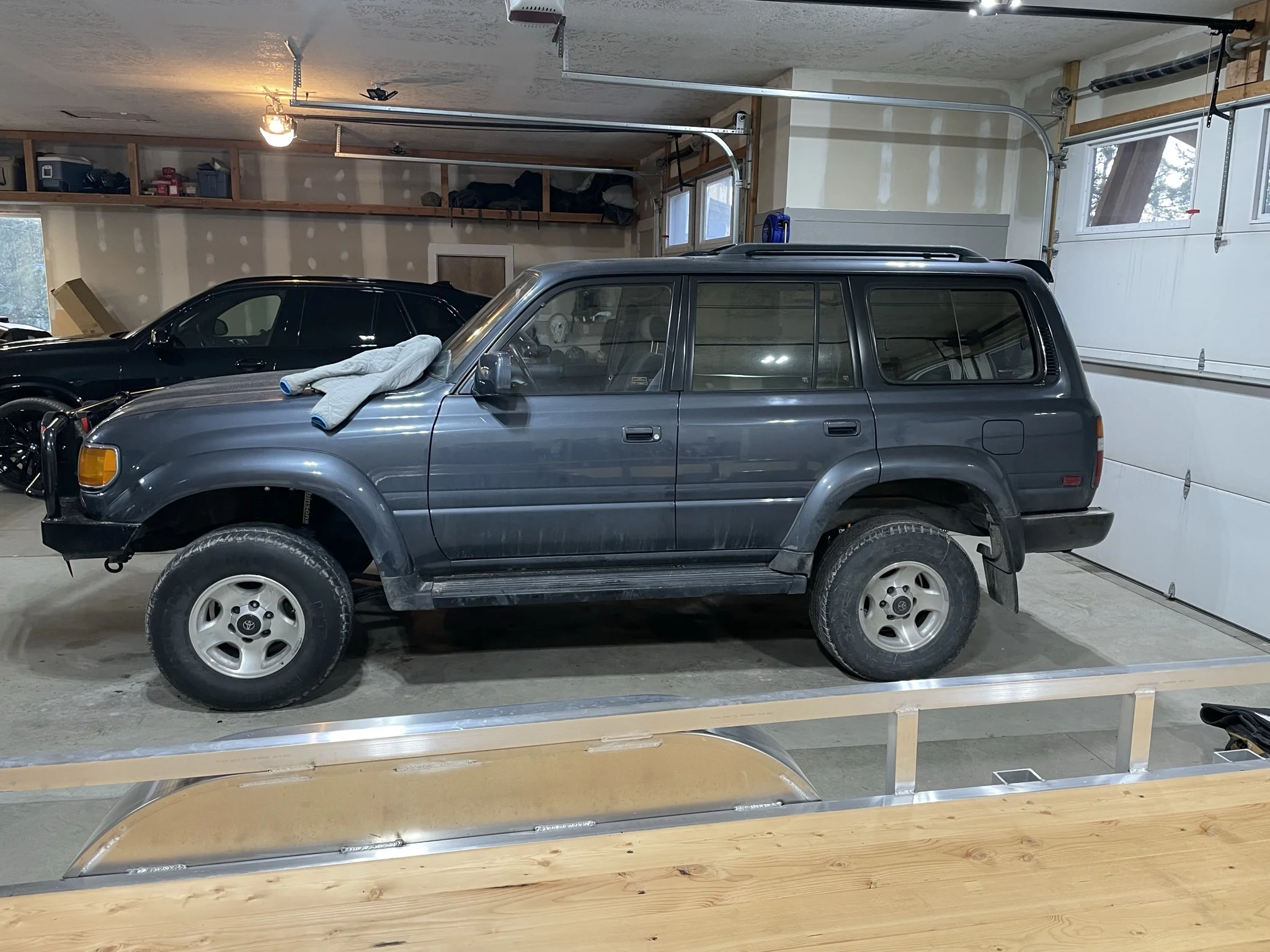

I've always been into LCs. My oldest bro is into Rovers. He grew up around cruisers too, but since living in Scotland for a couple of years he's caught the Rover bug.
One day he calls to invite me on a road trip with him up to Seattle to get a new chassis he's imported for a D90. I'd been looking for a clean 80 for a few years, patiently waiting for the right one - 93-97 with cloth seats, low miles and no fake wood. Triple locked if possible. My dad had one like that new back when I was a teenager.
As a joke, I told him "If you can find me an 80 that fits my criteria in that part of the country I'll go with you." 15 minutes later he sends me an ad for this 1994, 99k mile cloth seats, no fake wood fzj80 in Portland. It wasn't triple locked but that can be added easier than the other items on my criteria list.
We were on the road the next day. I've modified it a bit since then, so this is the beginning of my build thread.
It was a fun drive home, and the power of the 1fz was a delight - I was primarily driving my fj55 and fj60 at the time so it felt great in comparison.
Unfortunately, the odo flipped over to 100k on the drive home.

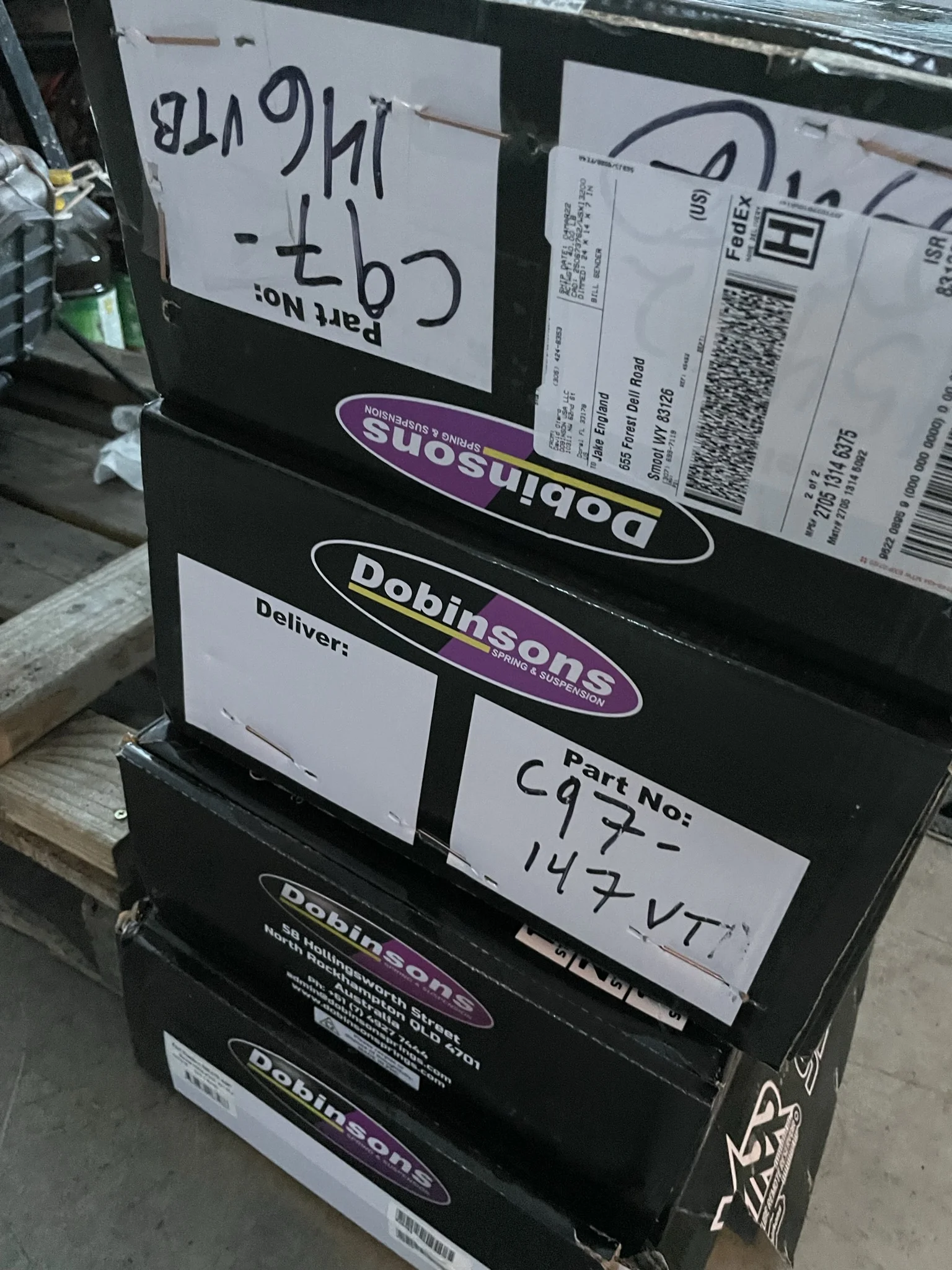

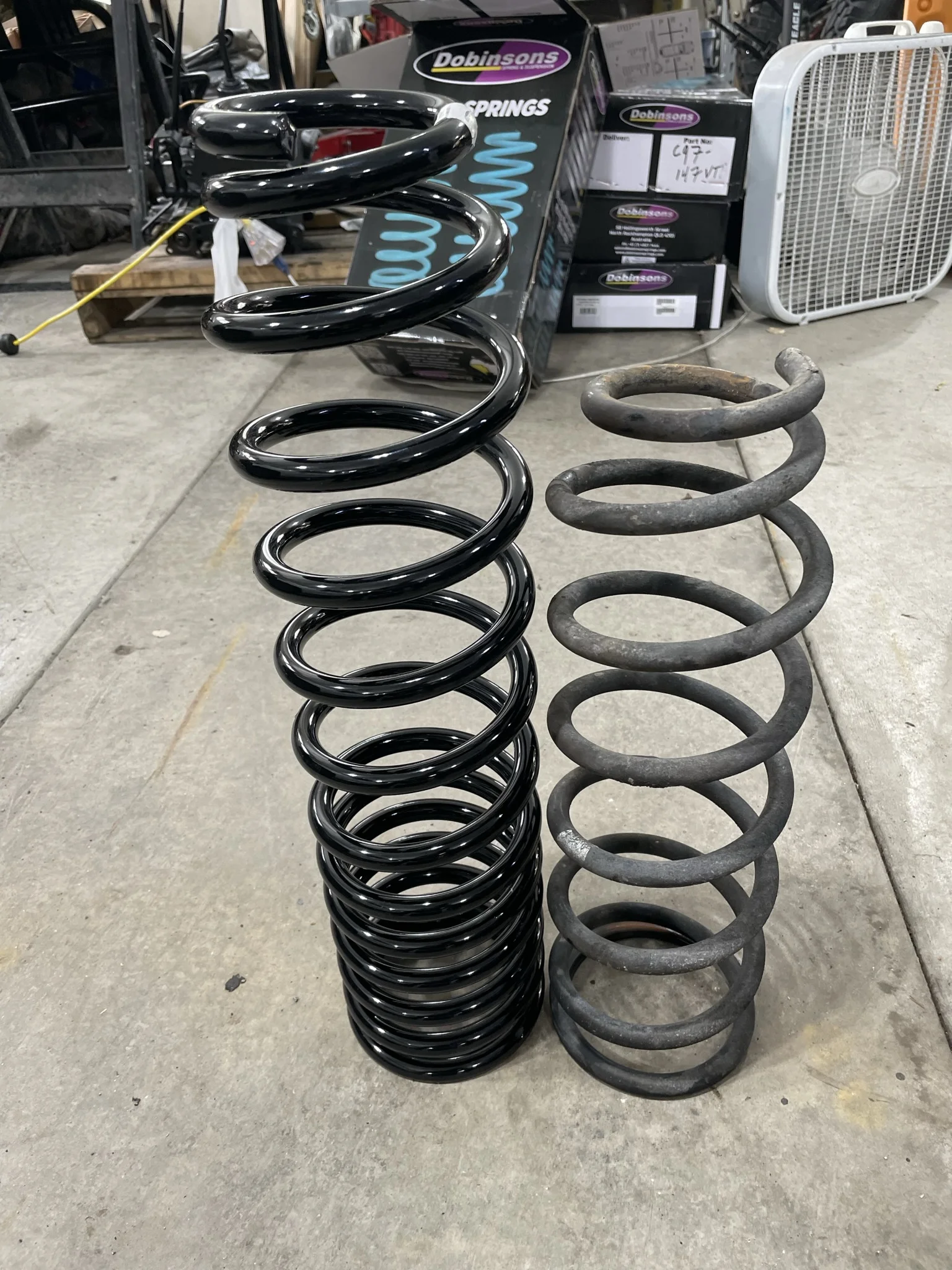

My Suspension mods included:
Dobinson's 2.5 VT Springs Front: C97-146VT Rear: C97-147VT
Dobinsons's MRA Adjustable Shocks
Dobinson's Steering Damper, Brake Bias Adjuster, Rear Sway Bar Extension
Delta VS Panhard Drop Bracket
Delta VS Front Swaybar Drops
OEM Brake Lines (replacement longer lines)

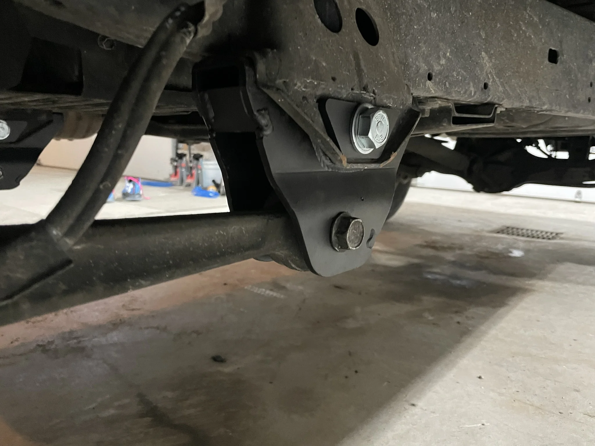

Ironman Control Arm Drop Bracket
I installed everything myself. Caster for sure needed to be corrected. The Iron man drop bracket improved it significantly, but I don't love how far it hangs down. I may switch to some @Delta VS control arms in the future.

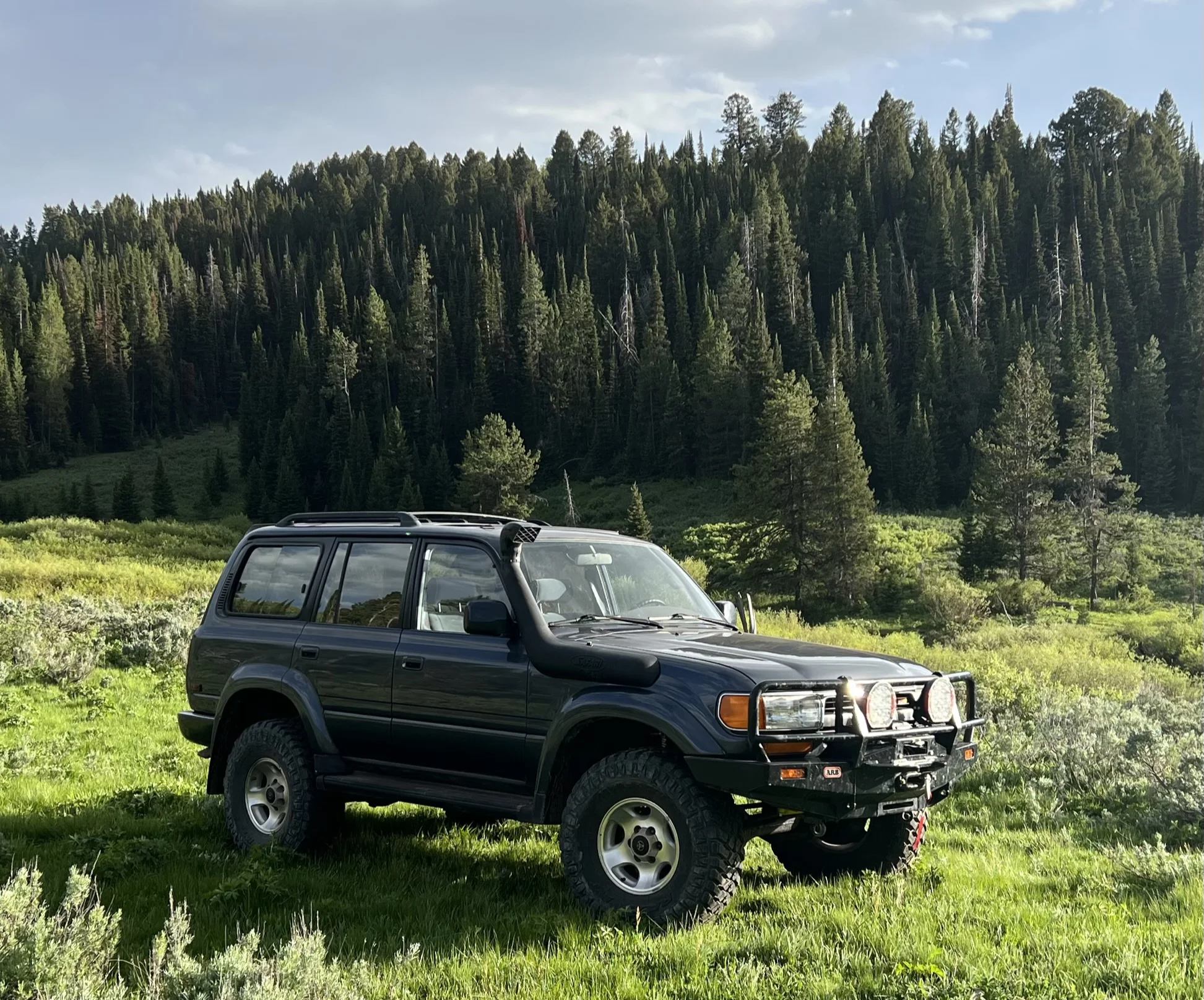

With my son's help we installed a safari snorkel. I needed his skinny arms and lanky body to reach back inside to tighten those bolts on the inside of the fender cavity. The snorkel didn't really add any wind noise I could detect. Probably not a necessary mod, but I'm building this one out and the kids thought the snorkel was cool so why not.

I wasn't sure what to expect from the lift. I have a friend that is running an OME lift, J springs I think. It rides pretty firm so I was really hoping it would not be like that. The Dobinsons lift is so nice. The ride is nearly as posh as my 200 and I didn't expect that. I've loved it. It was not the most affordable option, but it really is good.
