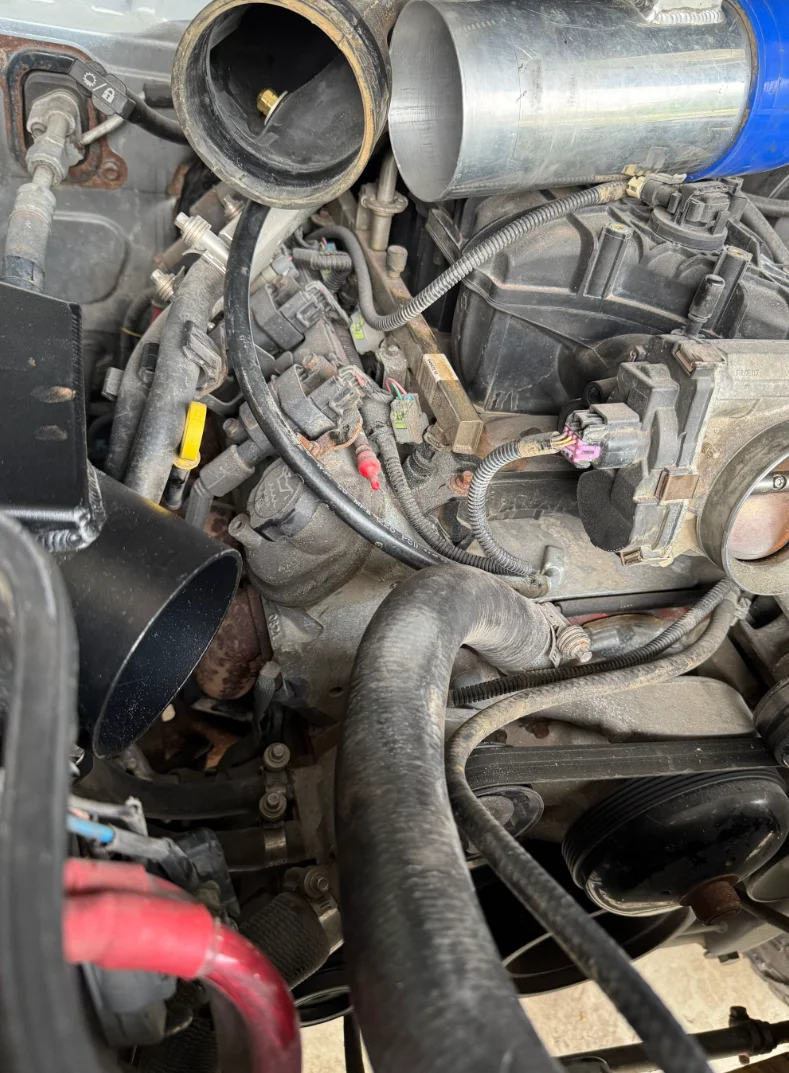

Working on installing the Radius Airbox. I’m going to have to shorten up my intake tube, and re route the radiator hose lower for fitment.

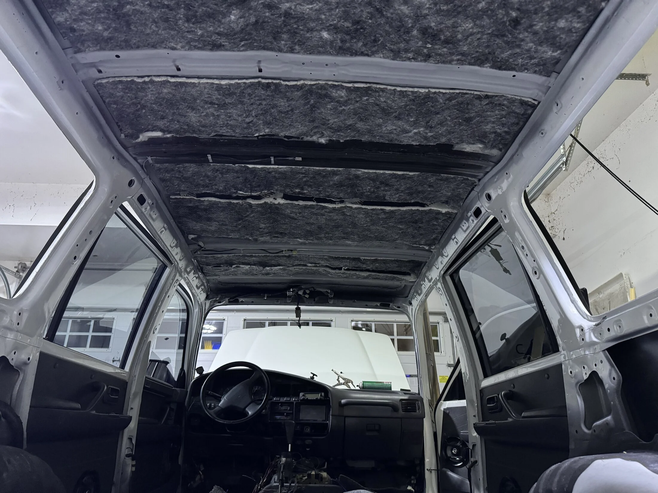

New carpet trimmed last night. I'll be adding a couple layers of sound deadening and thermal insulation before finalizing that install.
I also finished adding some foam to the A/B/C pillars to match the factory setup. I believe I'll be starting to glue in the headliner tonight.

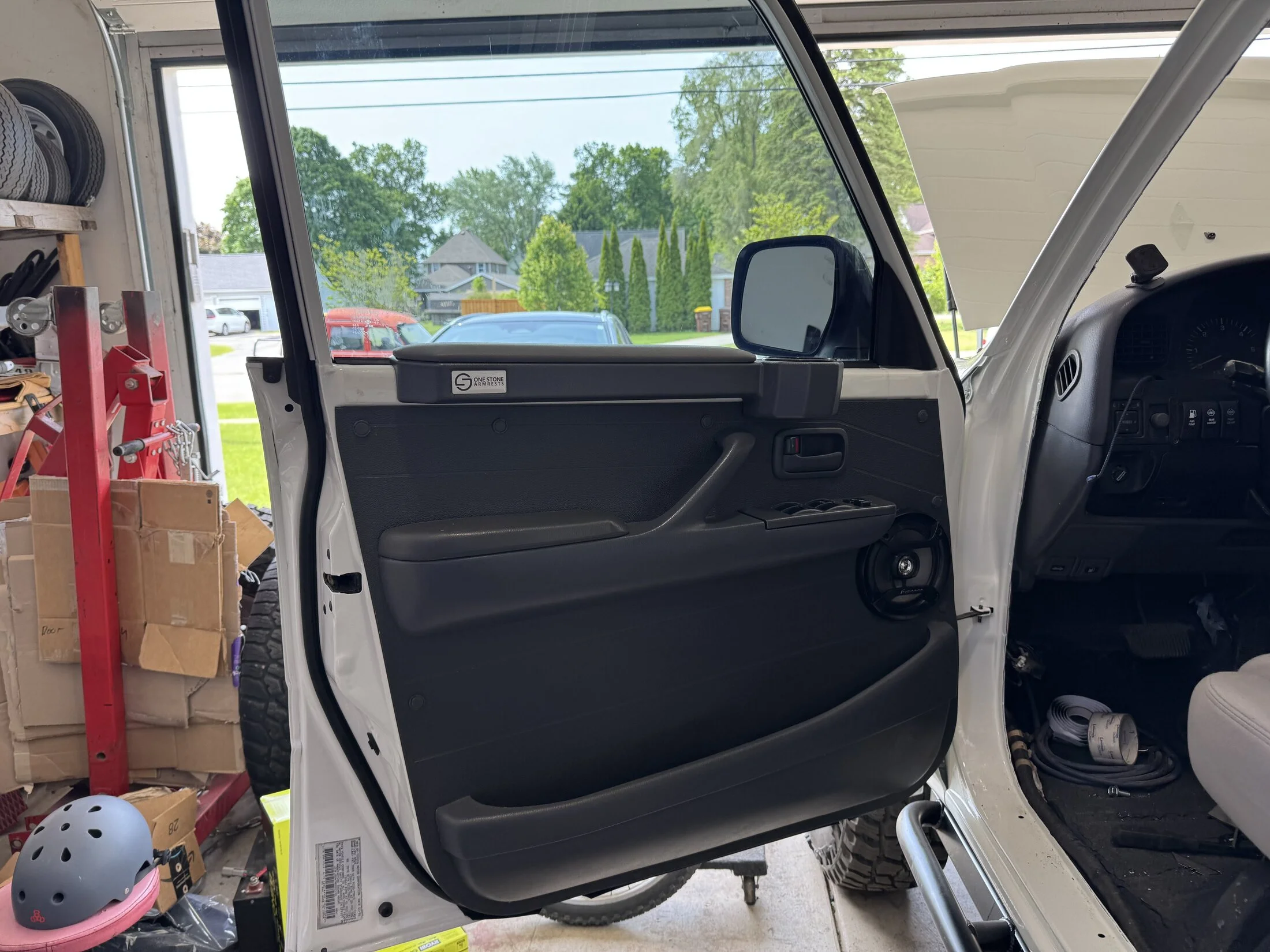

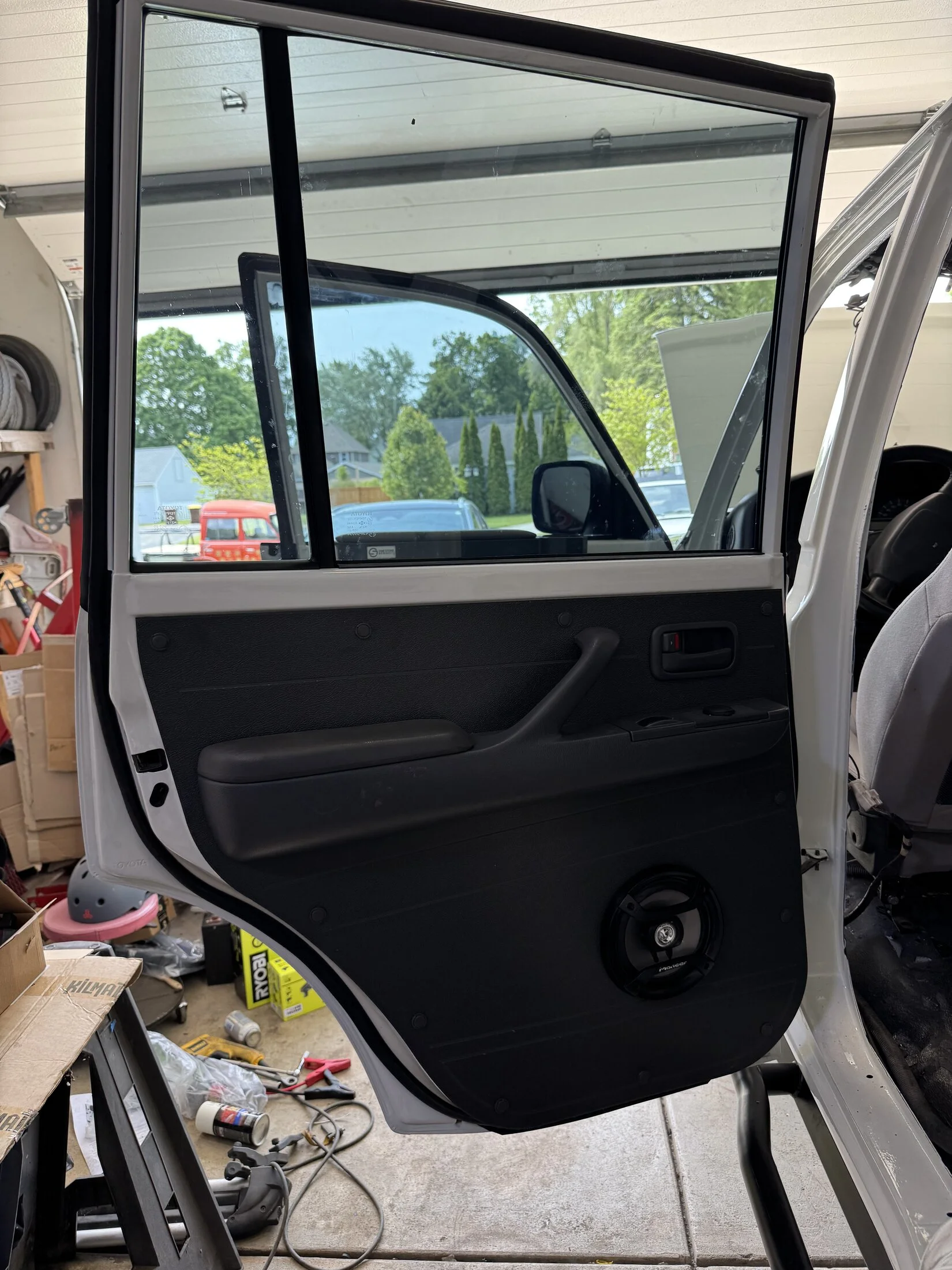

I dig those door cards- nice alternative to the usual US spec versions. I wish we had a better source for the factory style door pulls/armrests/window switch bezels in the aftermarket. It took me a while to find a decent set to make mine look nice.
I've got those same OneStone armrests modified to work with my factory door panels and love 'em!
The burning question is: If you pull the front shaft, & lock the center diff, will it do a big smoky burnout? ha ha ha
Thanks! I'm a fan of the simplified door cards as well. I have a set of the OneStone armrests, split between my LHD 80 Series and my RHD 62 Series. They work great!

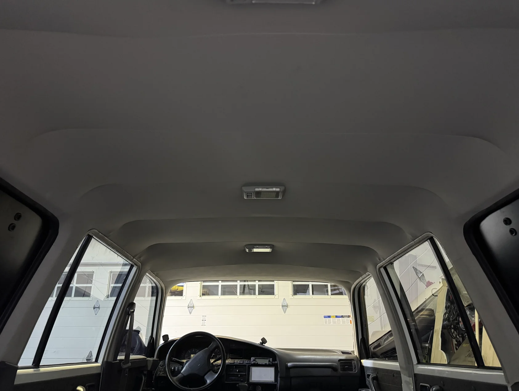

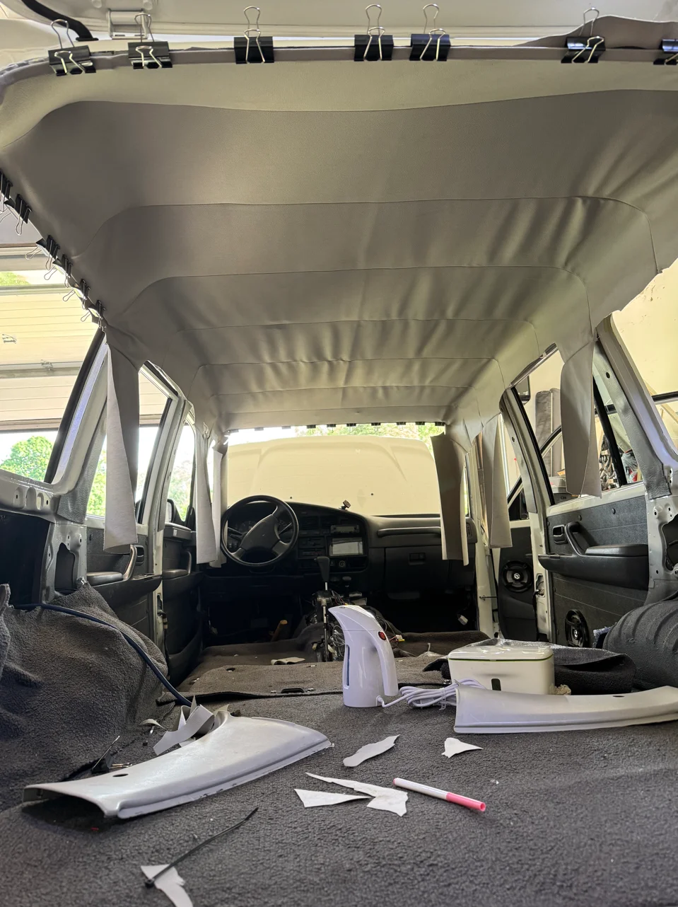

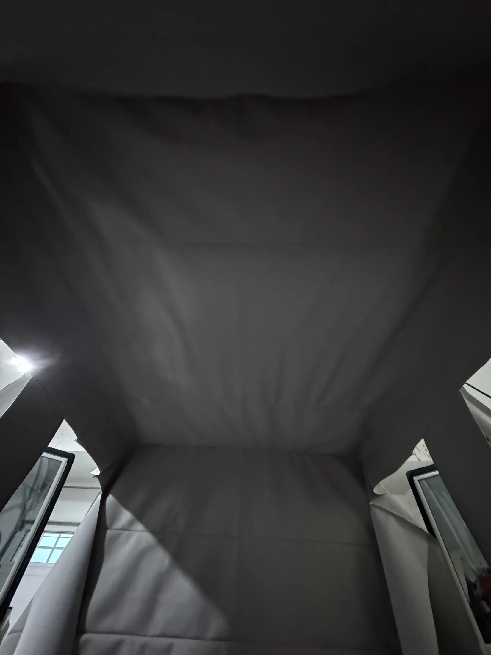

Next up, headliner installation! What a PITA. I don't want to have to do it again, but it turned out pretty good.
With the headliner in, I was also able to install the gullwings.

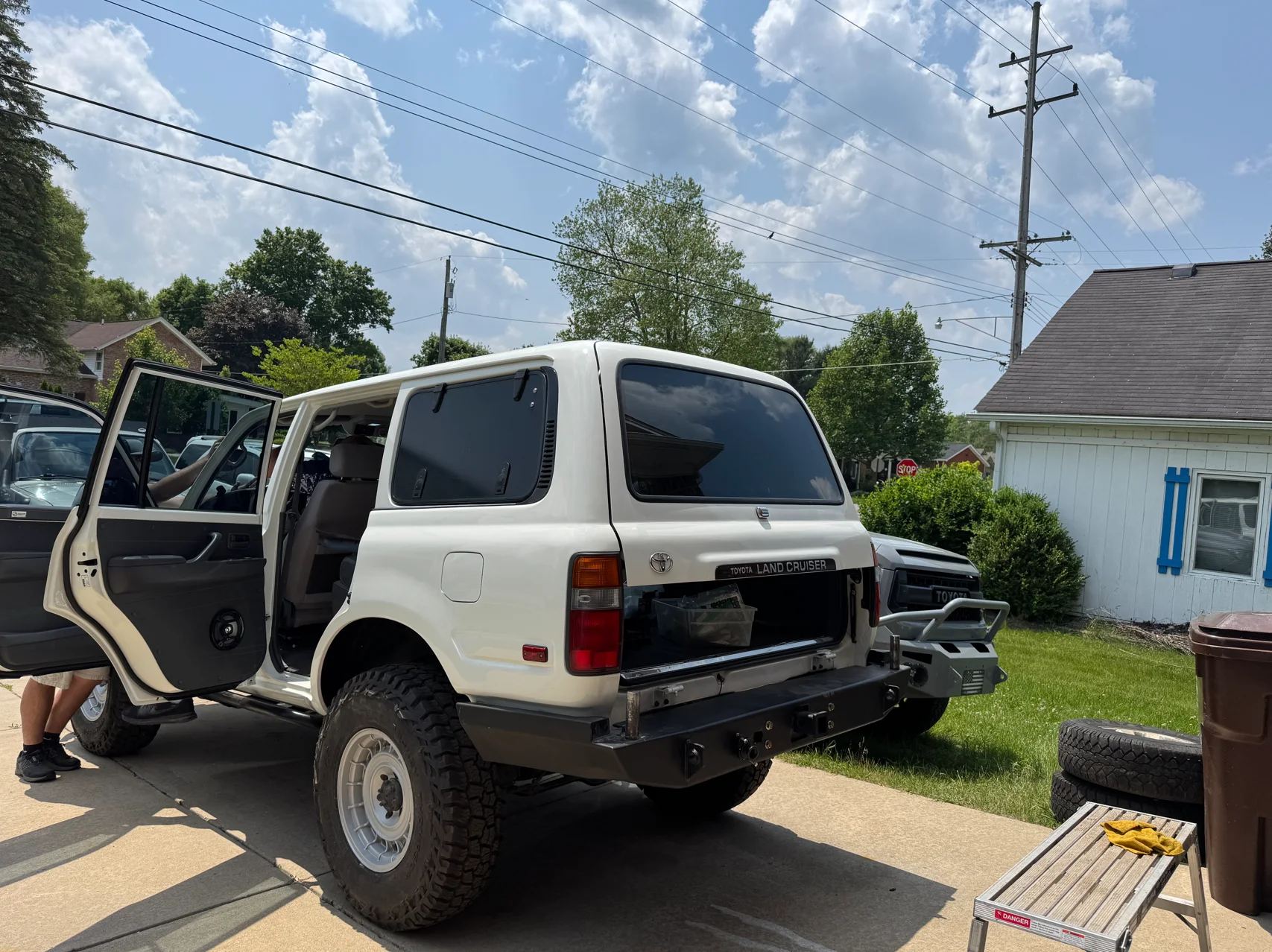

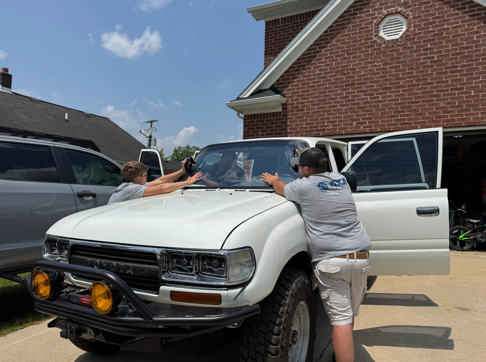

With the headliner in, I called to schedule the windshield and rear glass install. I had all the OEM seals, as well as the Betaseal U-418 that was recommended as a suitable replacement for the NLA Toyota sealant. I found a shop that does a lot of classic cars, and was willing to follow the service manual, using my parts.
They did a great job!
I think I'm only a couple days away from driving this thing again!

Maybe i missed it, but where did you get the new headliner? How long did it take to replace?
The headliner came from headlinermart.com. The pattern they used was almost spot on, I'd use them again.
In all, between insulation, prep and installation, I probably have 24 hours of labor in the headliner projects.

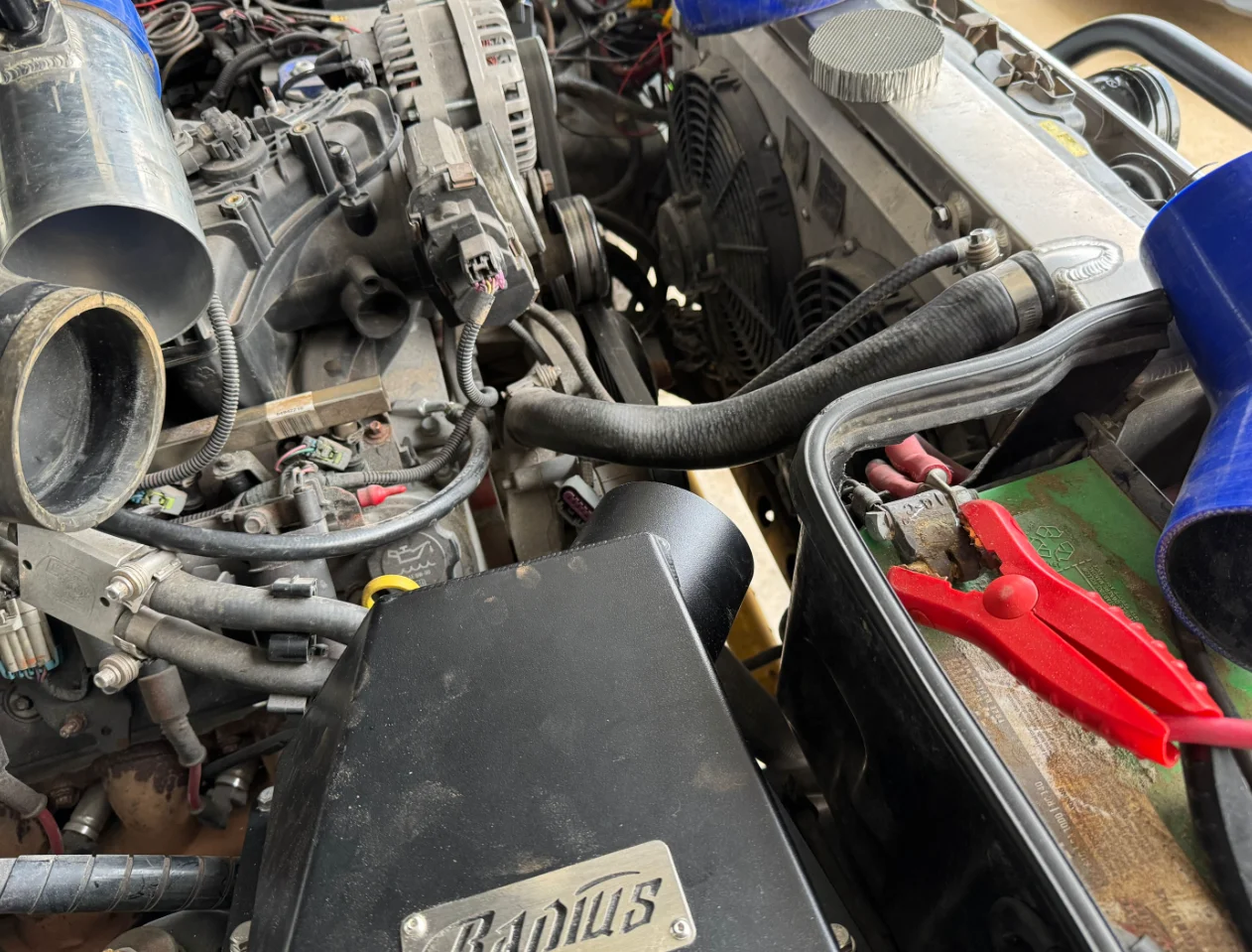

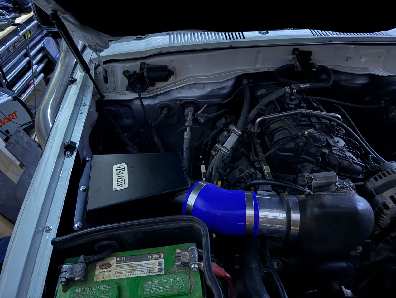

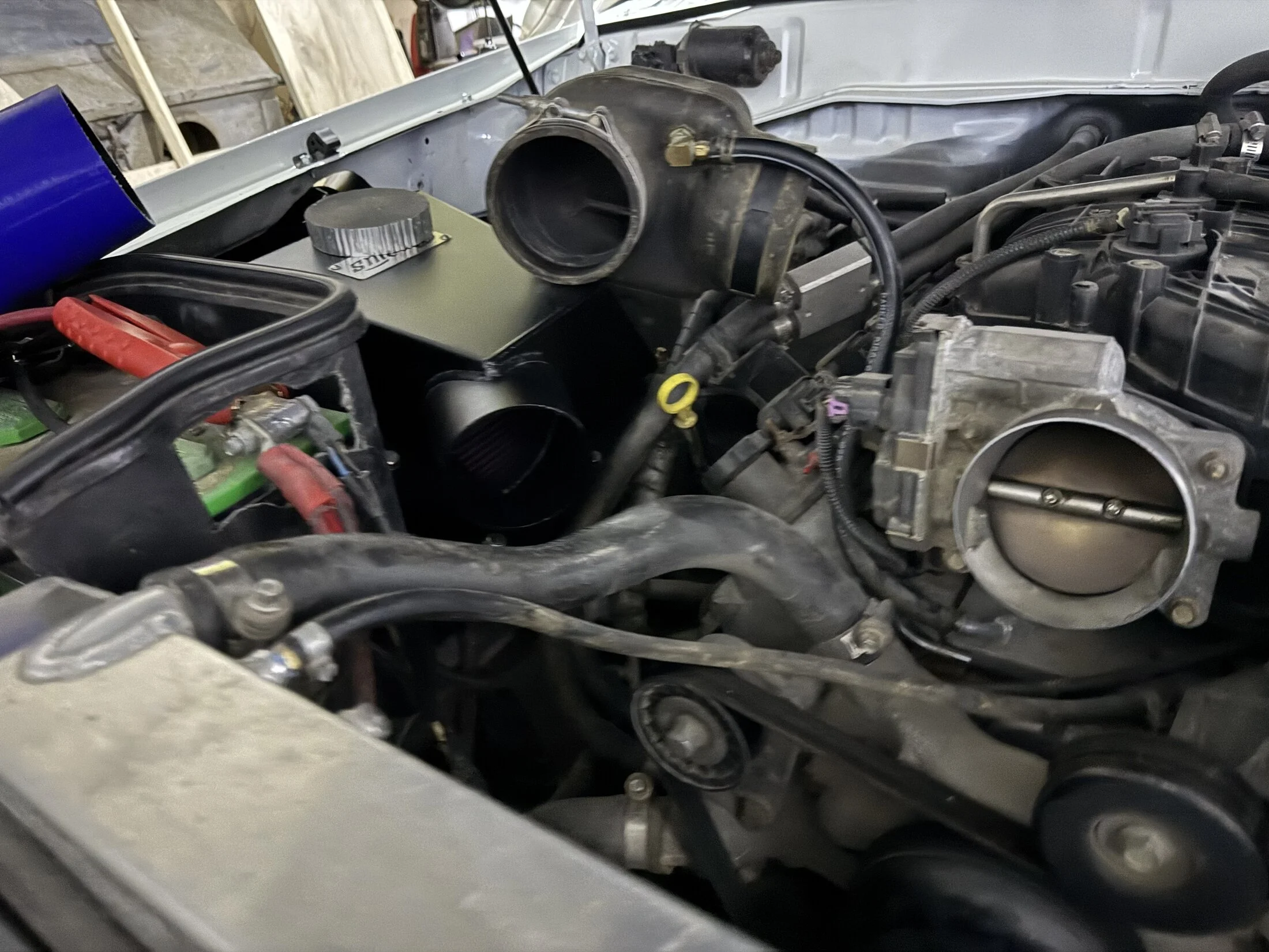

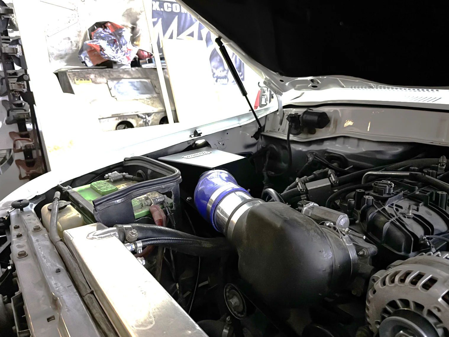

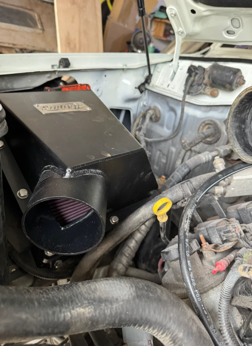

Finalized my Radius airbox installation last night. The airbox exit sits a lot lower than my previous setup, and ran it right through my radiator hose. I decided not to mess with any of that, and spaced the Radius airbox up a couple inches. No more clearance issues, and still plenty low enough for the hood.
Before:
After:

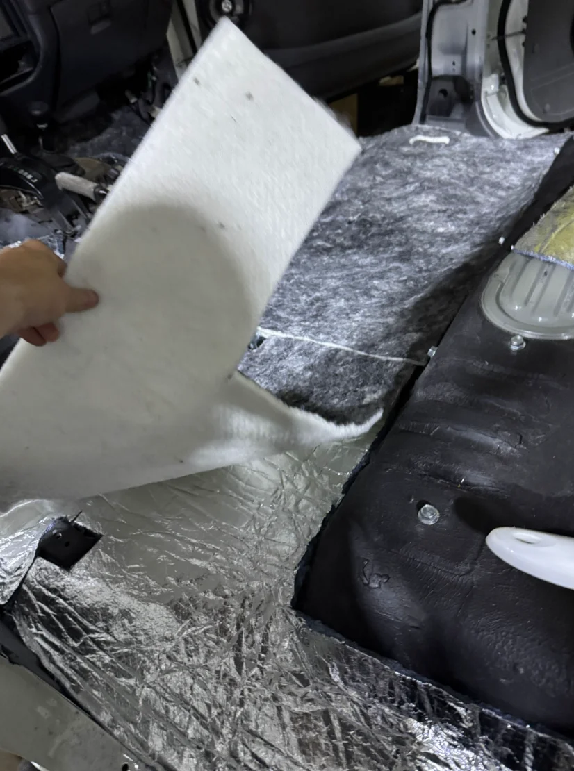

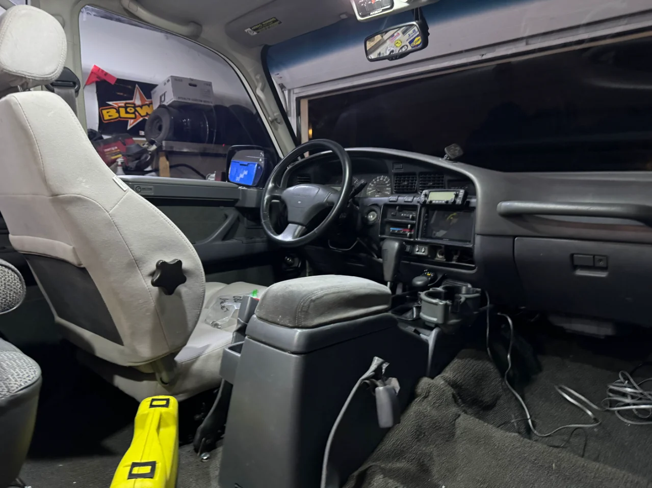

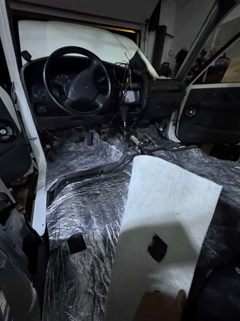

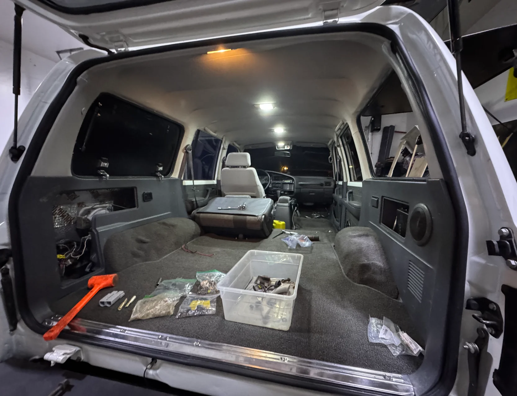

Next up was to finish up the interior. First was a couple layers of sound deadening. I went with a base of Second Skin Spectrum, followed by Second Skin thermal insulation, finished up with DEI BoomMat. It should be significantly better than the rotted jute that was there before. I installed all of the roof mounted lights, handles and console, and installed most of the side panels. Some seats are still out because I'm working on a custom fridge mount platform in the rear passenger seat area.
Before:
After:
-Rob
Did you cut the fender for the snorkel before or after raising the air box? I do think the Radius box could have the outlet putting more upwards than it does...
My intake is awfully close to an idler pulley and raising the Radius Airbox would help with clearance...
The fender was cut before, using Radius's template. The airbox is more tilted than raised, the inlet from the snorkel still fit perfectly after relocating it. I ended up using the normal rear Radius mounting tabs, but moved them back to different existing holes in the fender (it lined up pretty well). The front mount is floating for now, but I'll make a small bracket to attach it to the fender.

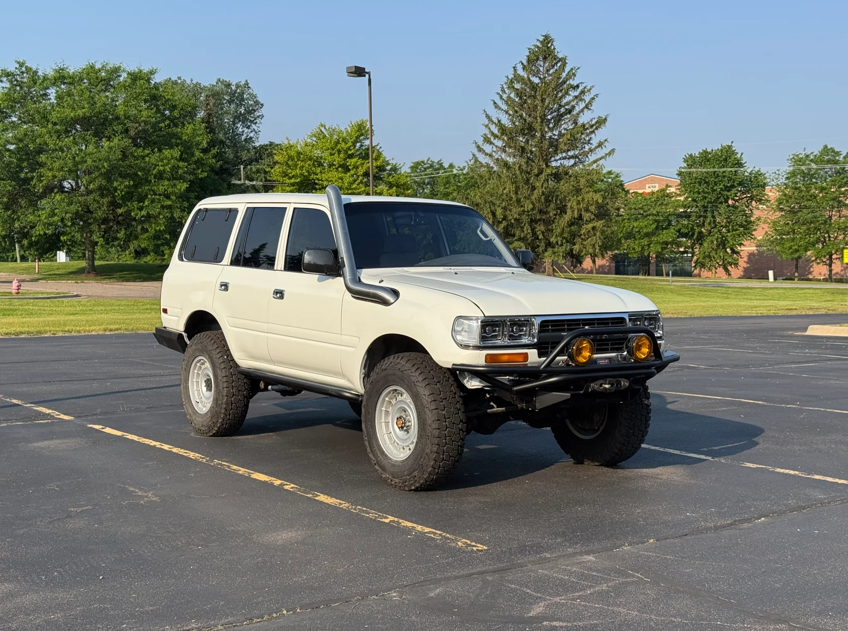

Playing a little catch up here.

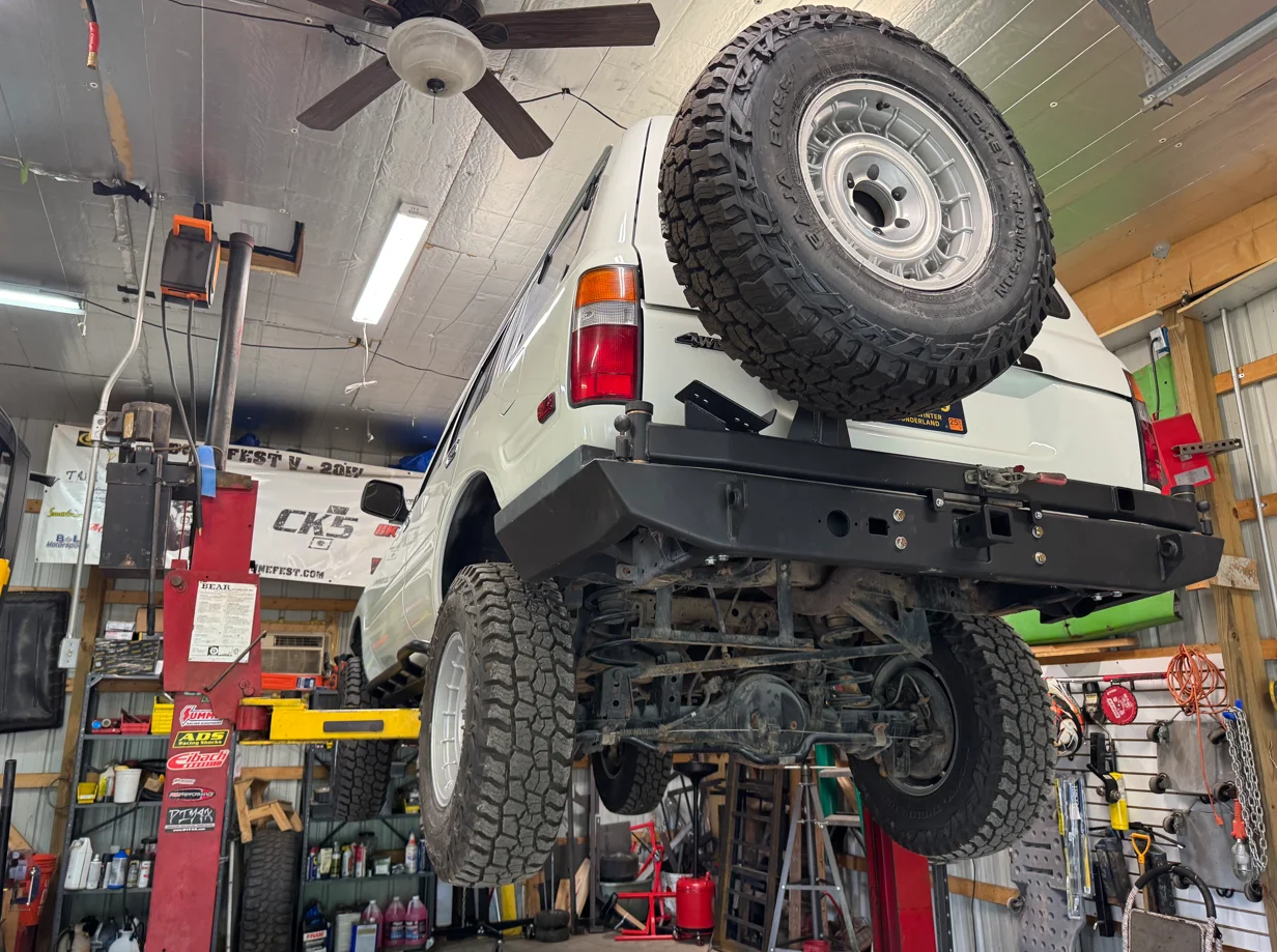

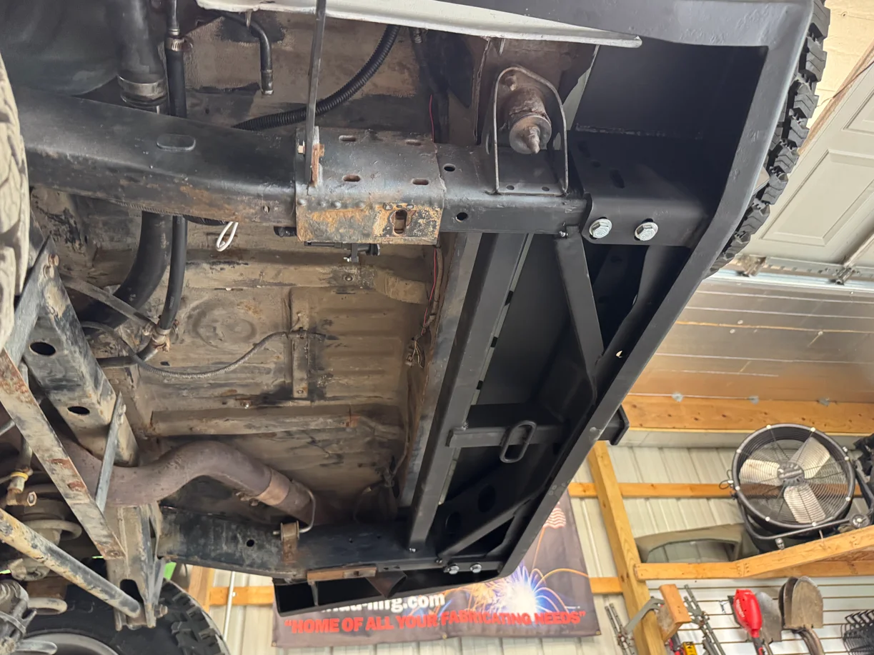

Rebuilt and the Trail Tailor bumper with all new hardware, and welded the modified crossmember / hitch to the frame. Not shown, but I also reinstalled my aux tank system, with an OEM dual filler neck.

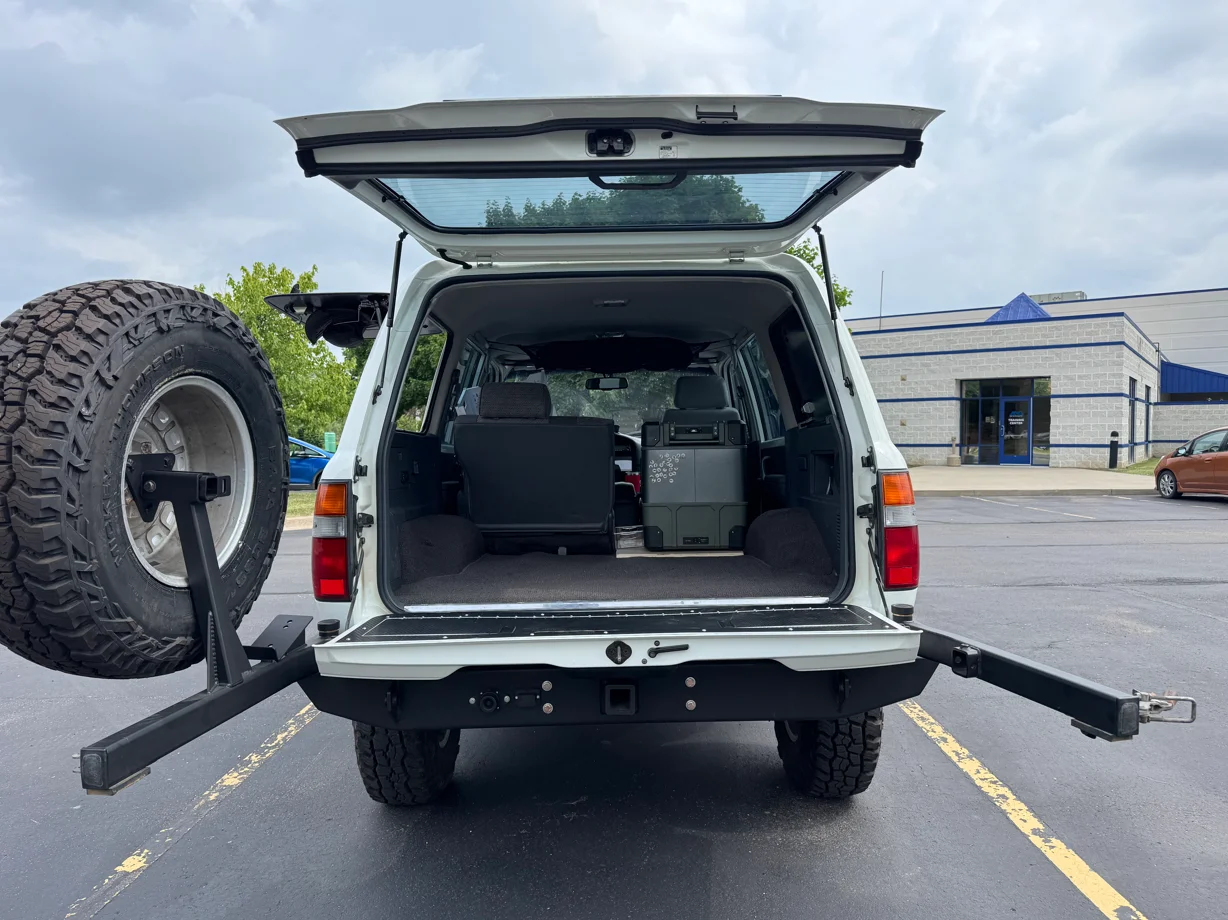

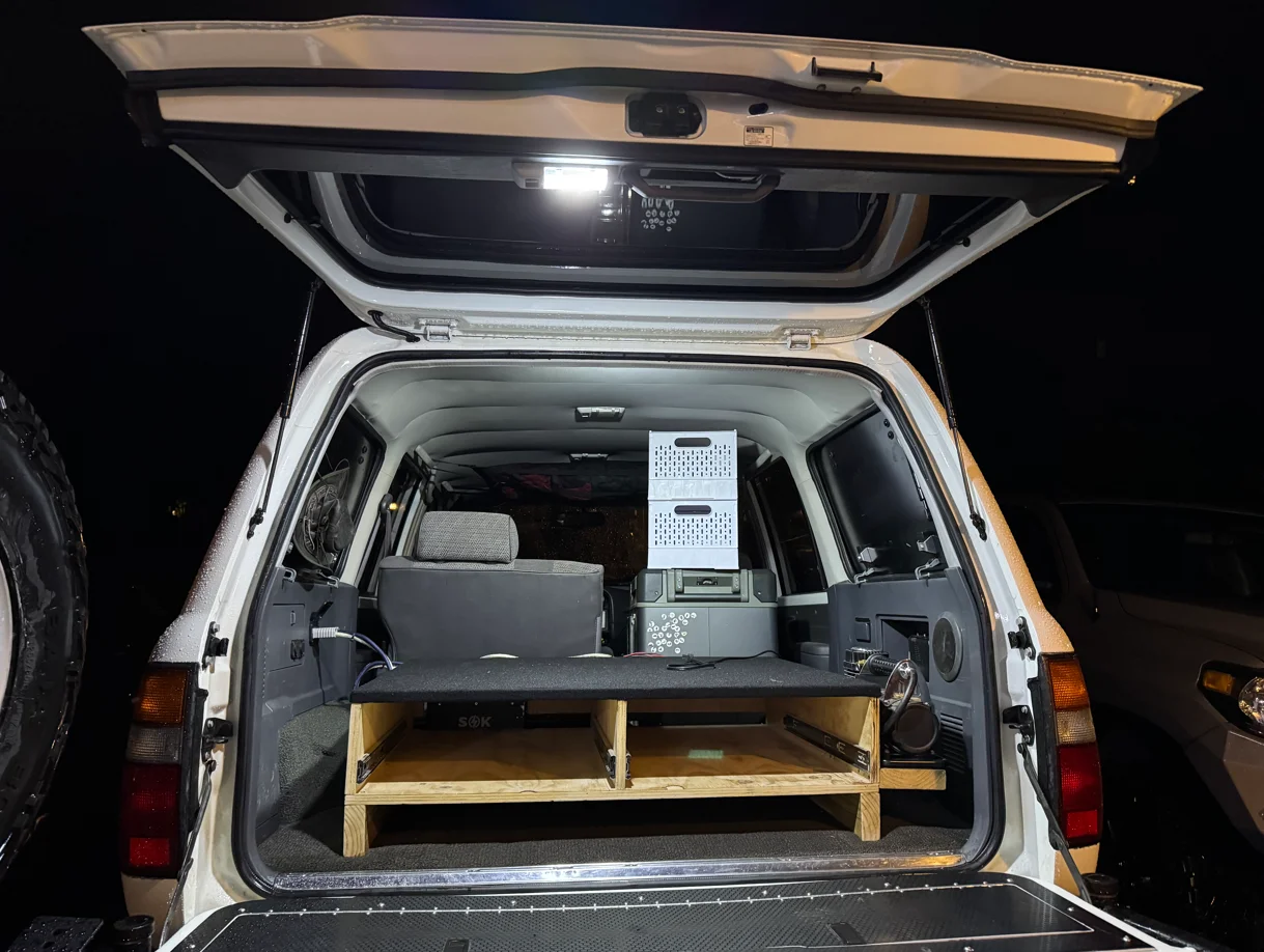

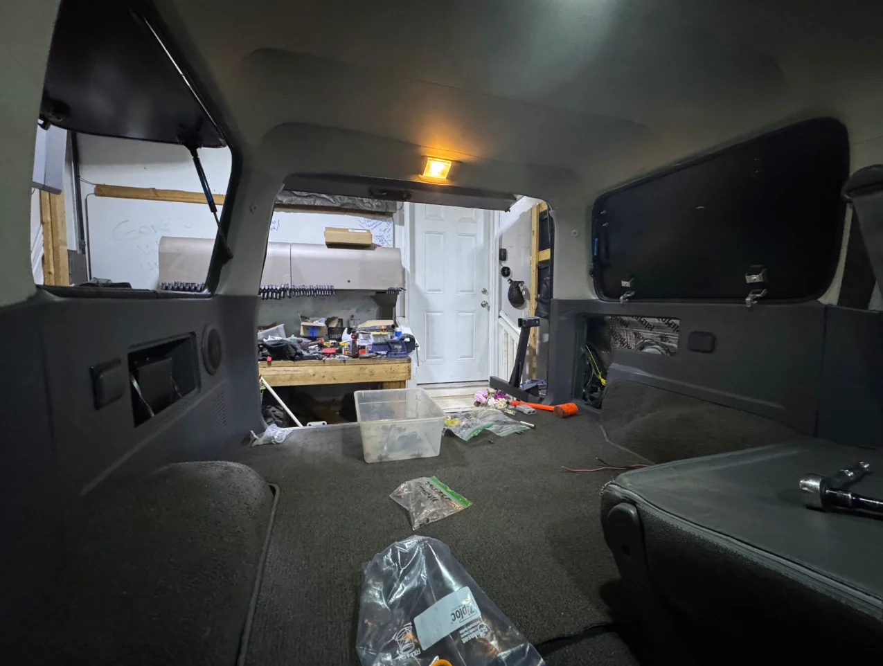

Finished out the interior, installing a fridge platform in place of the passenger rear seat. Two dome lights, linked to the rear hatch, were installed. One on the hatch, and a second inside, on the rear door frame. I also installed my dual battery system, and began installing the drawers.
