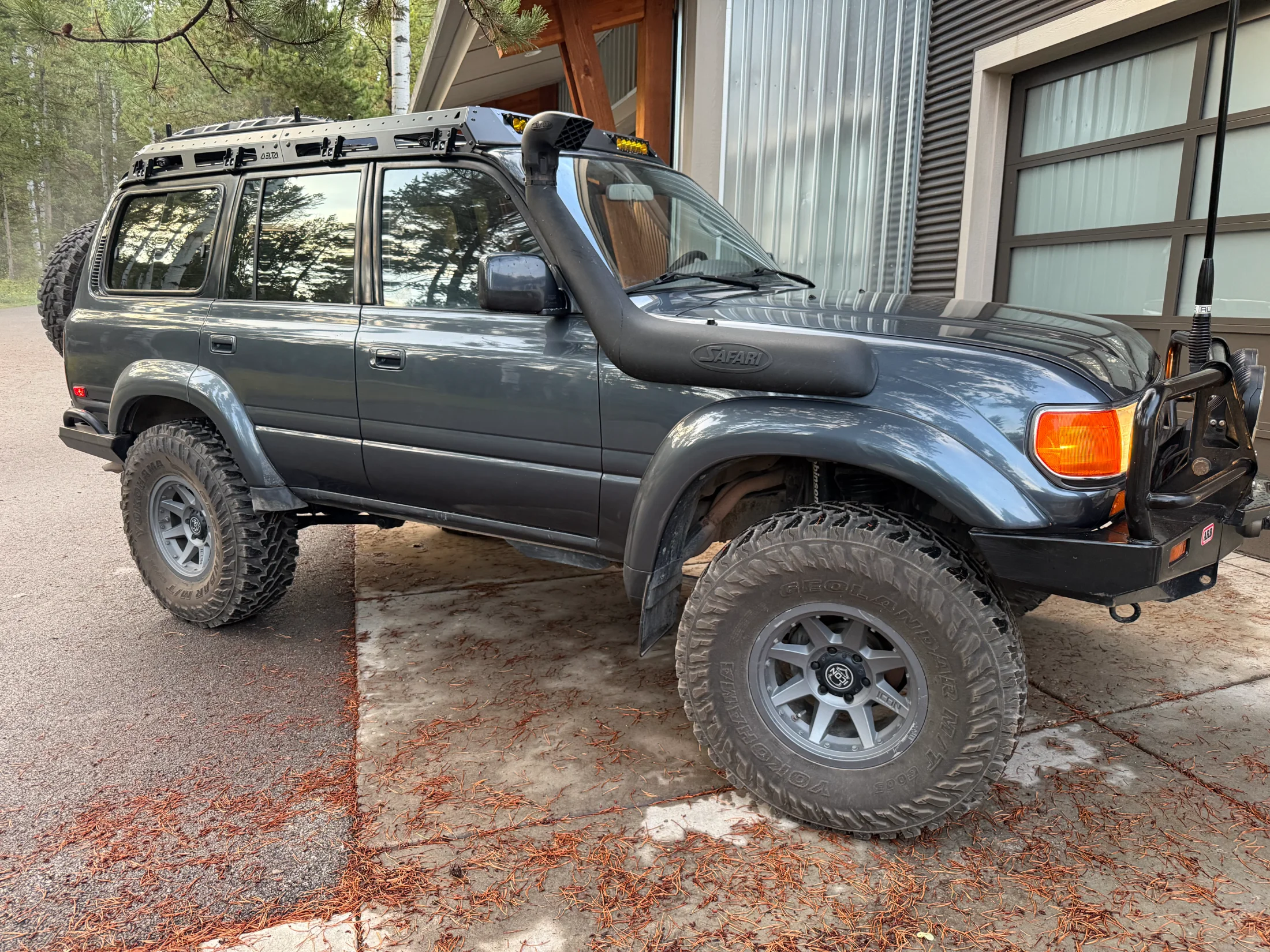

Didn’t plan on acquiring another 80 this weekend. Local ad popped up for a 97 40th anniversary with 133k miles. 2 owner with a stack of maintenance records since new. Made an offer I thought he’d refuse, drove it home later that day and immediately took it out in the hills. Seller told me it’s always been a garage queen at their second home so I felt like I had to.
Removed the pin stripes this morning. Couple of cosmetic things to fix but over all a really clean rig. Fun to drive a stock 80 again - not that I dislike the mods on my 94 at all.

Nice find, Looks really clean !!

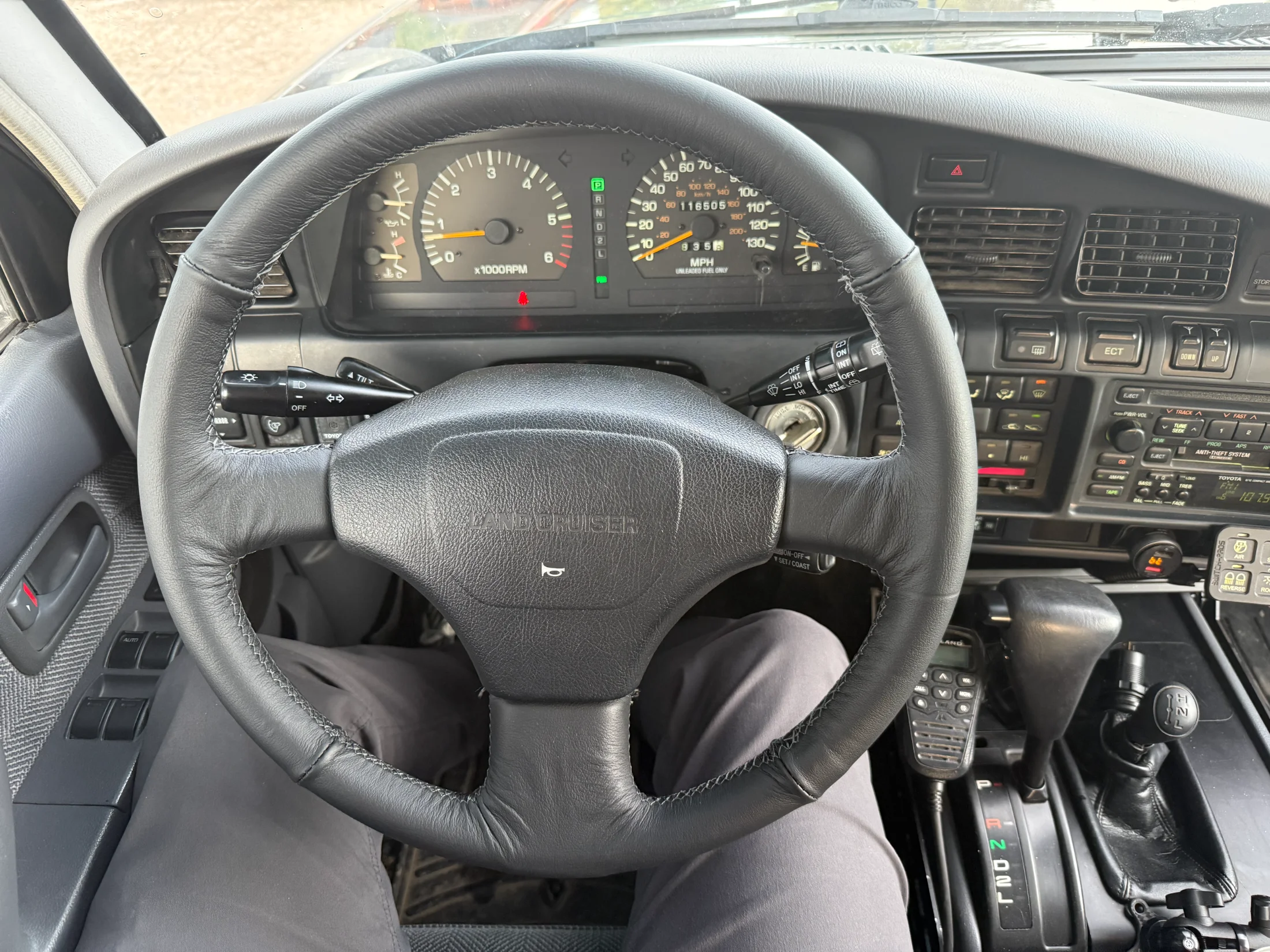

I've had this redline steering wheel cover in my center console for about 2 years. Finally stitched it up. Not the very best fit, but probably good enough for who its for. That lower spoke just didn't want to sit right. If I find a better solution some day, maybe I will redo it.

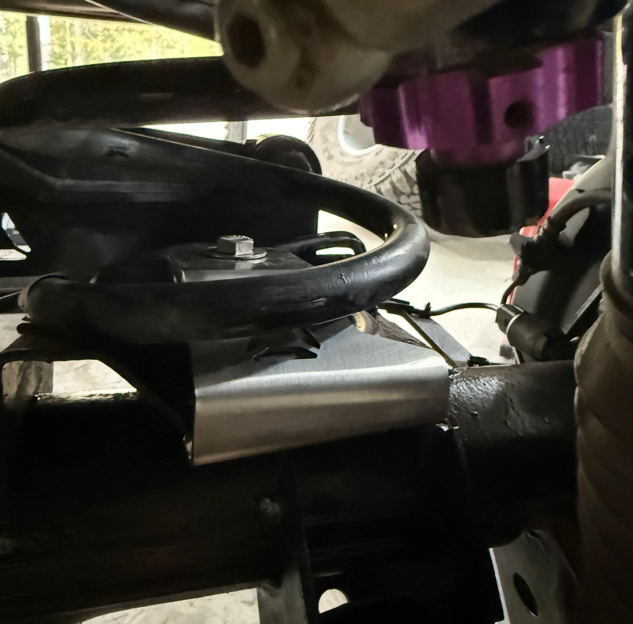

You bet. Here is the drivers side. I can take some pics of the passenger later and post them up. If anyone is considering these and have questions, fire away. They aren’t inexpensive so I get it, happy to share what I know of take pics.
This plate in the middle that covered the support sits flush with the outer tread plate shell. But is on top of the base of the skid. All the bolts on the angled section are countersunk.
I bought their skids too, as I mentioned can’t mount the front skid up until I swap out the drop plates for new radius arms.
I do appreciate @Delta VS skid plate design. It has a sub plate that supports the t-case. The actual bash plates are separate so they can be removed without losing the support. My Slee skid was stout and a great product but it was also the support. More of a convenience thing for cleaning or maintenance, but well thought out.
