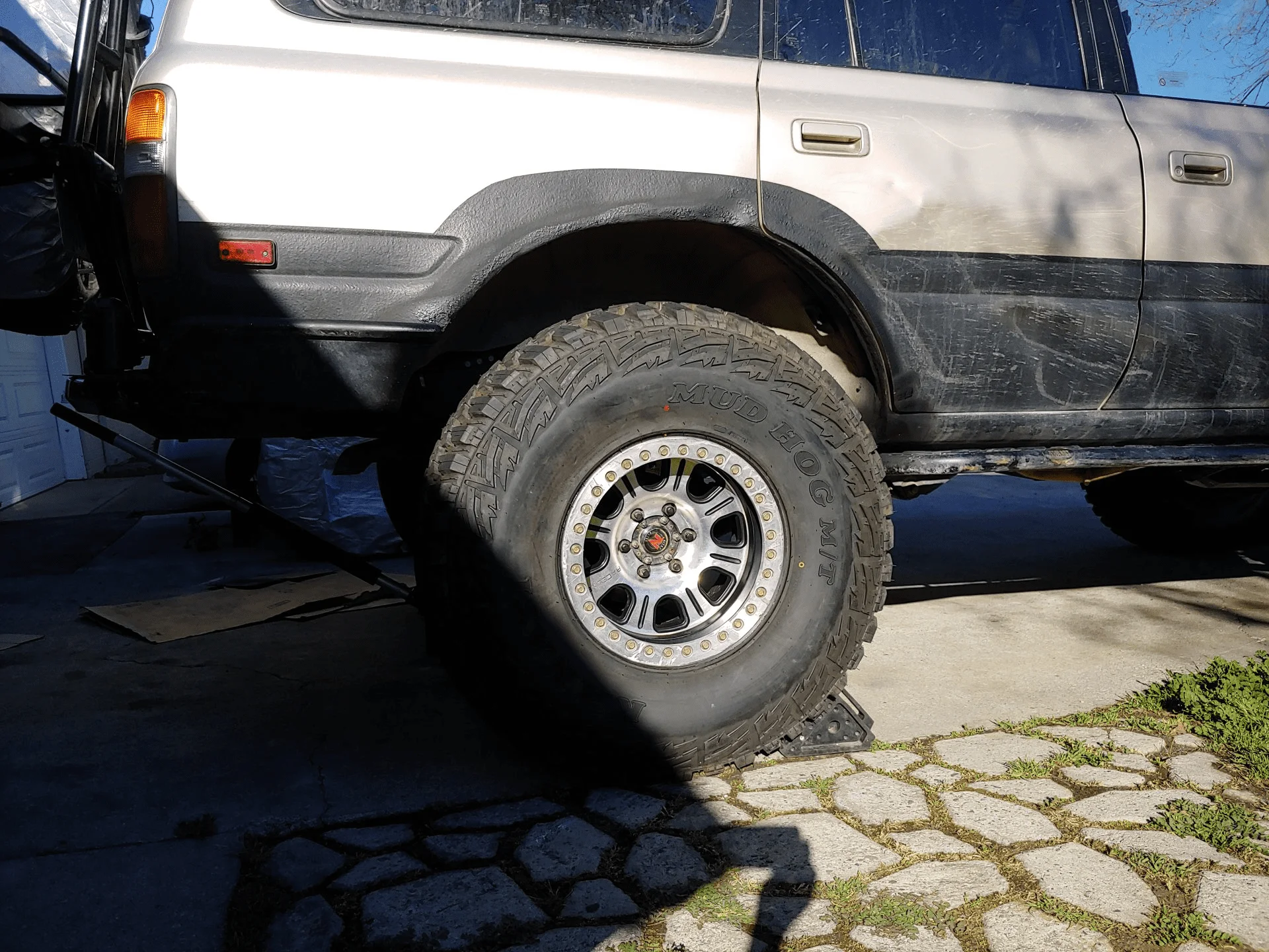

I hear ya. I rotate my tires myself, even though Les Schwab will do it for free. I just don't trust the airguns with the luck I've had with broken studs. What works for me in my driveway is a hand truck, you know what you use for moving boxes around. Pulling the tires off the axle is no problem, its putting 'em back on. So I'll lean the tire/wheel on the axle end, grab my hand truck and slip the blade about an inch under the tire. Using my foot to trap the hand truck so it will pivot up without rolling back and with one hand pull back on the hand truck and the other guides the tire on to the axle end. With our FF rear axle and hub on the front, the wheel will just "pop" on to the hub. Once there, move the hand truck out of the way and rotate the wheel to line up the studs and push the wheel on to the studs and install the lugnuts. As I say, this only works in my driveway where the hand truck is handy and I'm not in a garage or parked in between other vehicles. You need room to use the hand truck. One other tip: Don't try to jam the blade of the hand truck too far under the tire. An inch or so is all you need. Actually it helps to just barely get enough of the blade under the tire to lift it off the ground. Then when it clears the axle it'll just pop on to it. I don't know how much my 35's weigh, but I'm sure they're lighter than the 39's & 40's mentioned earlier. But this has sure made my life easier. I use this method on my other rigs, also. They say to use your legs and not your back when you do heavy lifting. Well, its impossible to use your legs when your squatted down mounting wheels on axle ends. You need to use some assistance when doing this chore or you'll eventually end up with back problems, if you don't have them already!

Try my hand truck idea sometime if you've got a hand truck. You might be surprised how easy it is. Here's a pic of mine - just an old one that almost got pitched one time. Now has a useful healthy life:
Of course it won't take the place of all the other uses that a prybar has, but for lifting tires onto an axle in your driveway - it's pretty damn handy. YMMV
