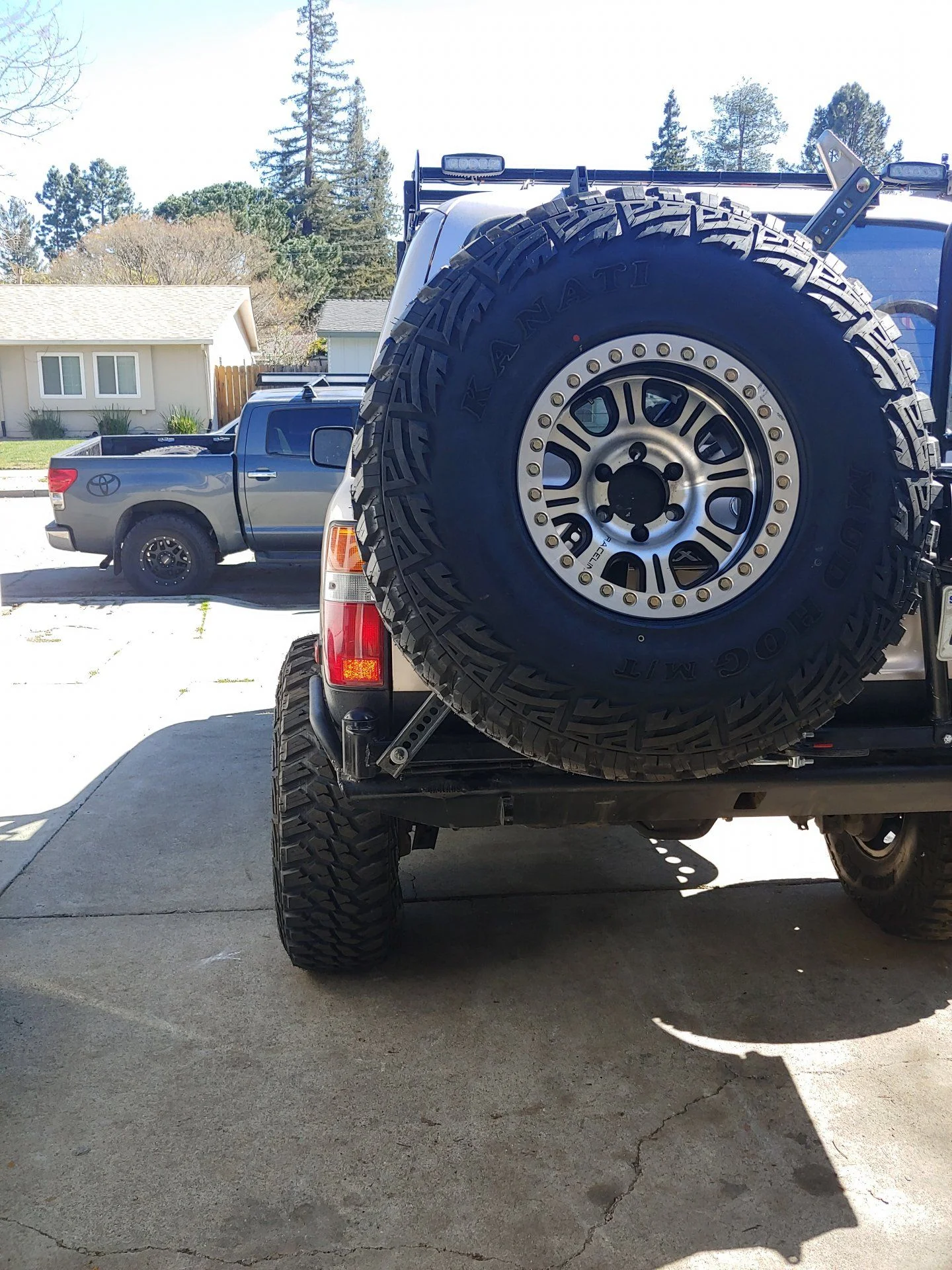

Update. I modded the 4x4labs tire carrier and have 39 spare and a triple can gas carrier.
I think there are very few 80s that run tires this big and even have it mounted on a swing out.

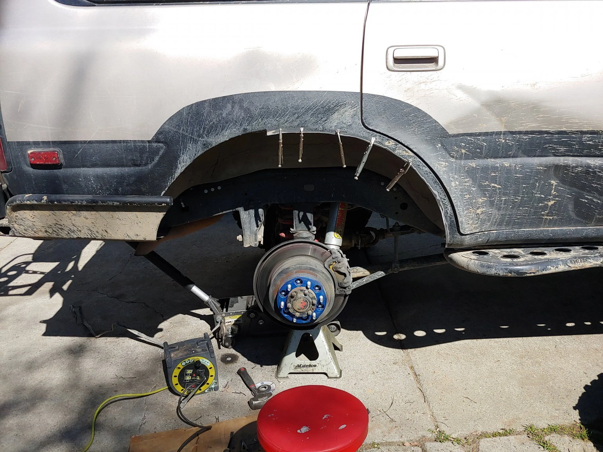

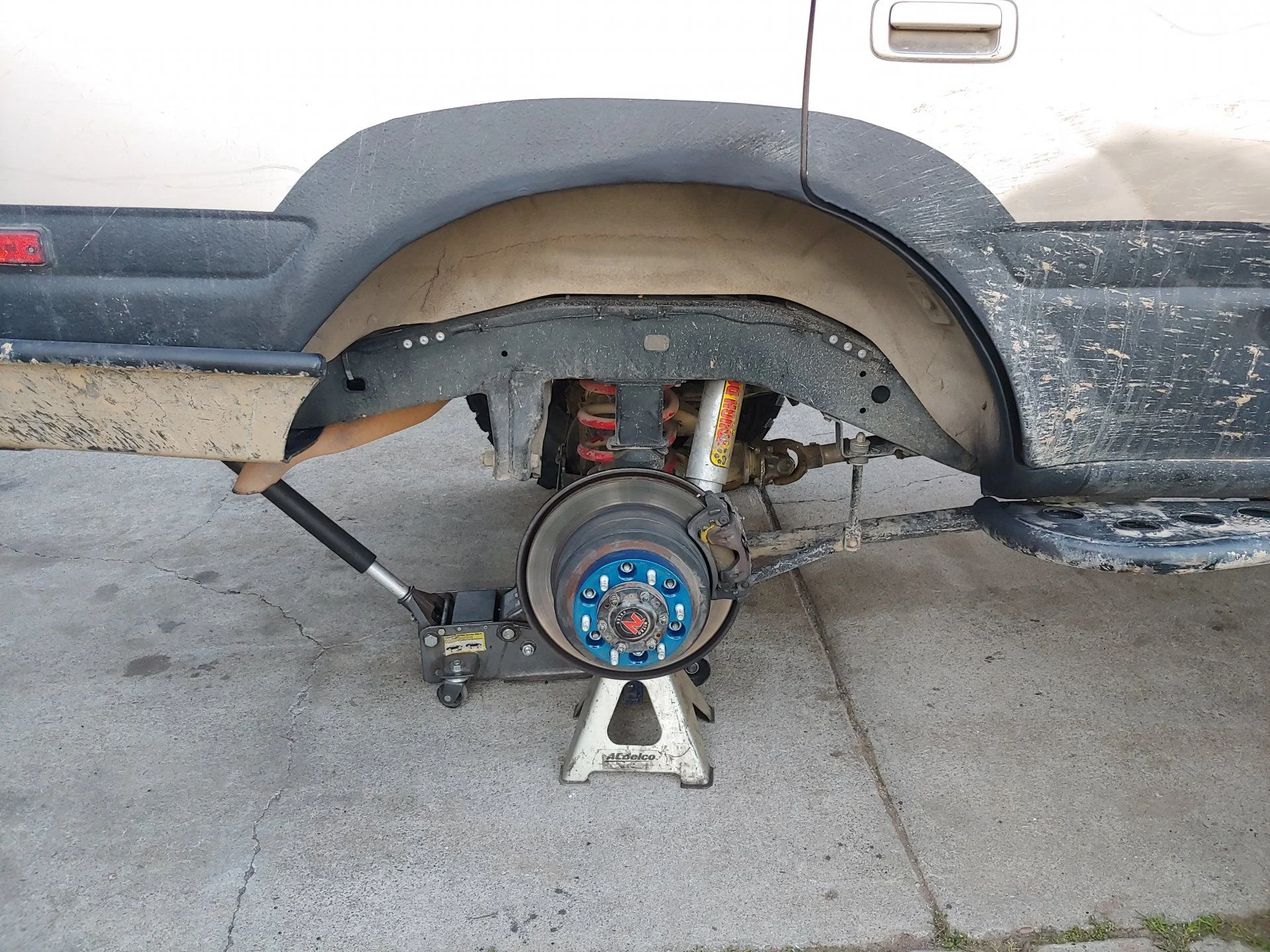

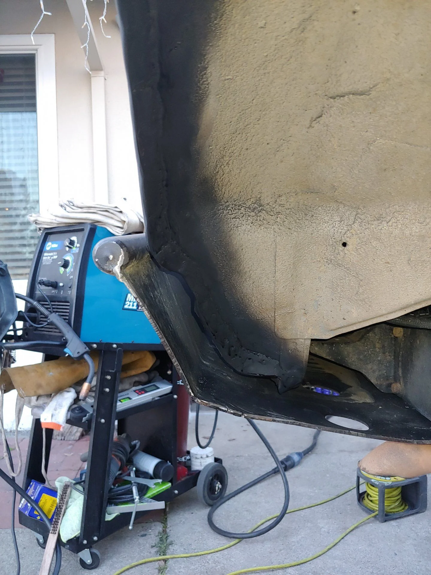

And this weekend I'm working on fender trimming and hopefully welding in hydro and hooking it up.

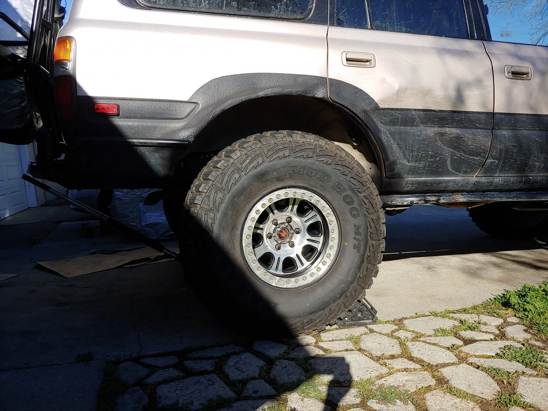

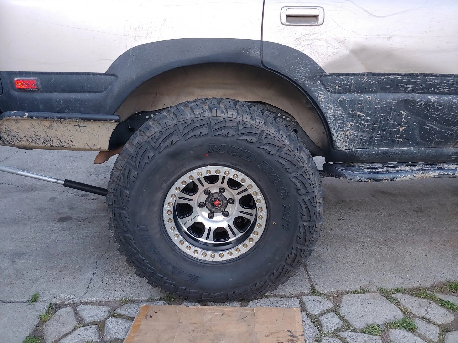

Its in seriooooouuuusssss need of hydro with 39s. 37s was a pain but she ain't happy with 39s.
So far im really happy with going 39s. Not to loud on the street and they roll smooth. No beads or weights. The extra approach and departure angle is night and day. Diff is tiny bit higher too. I'm actually thinking of not going 6inch lift and maybe keeping it 4s.
I do need to buy heavy Dobi 4s tho and cancel my Dobi 6s.
However having that extra 2 inch would be really nice as long as I keep it crawling. Would give me more belly clearance.

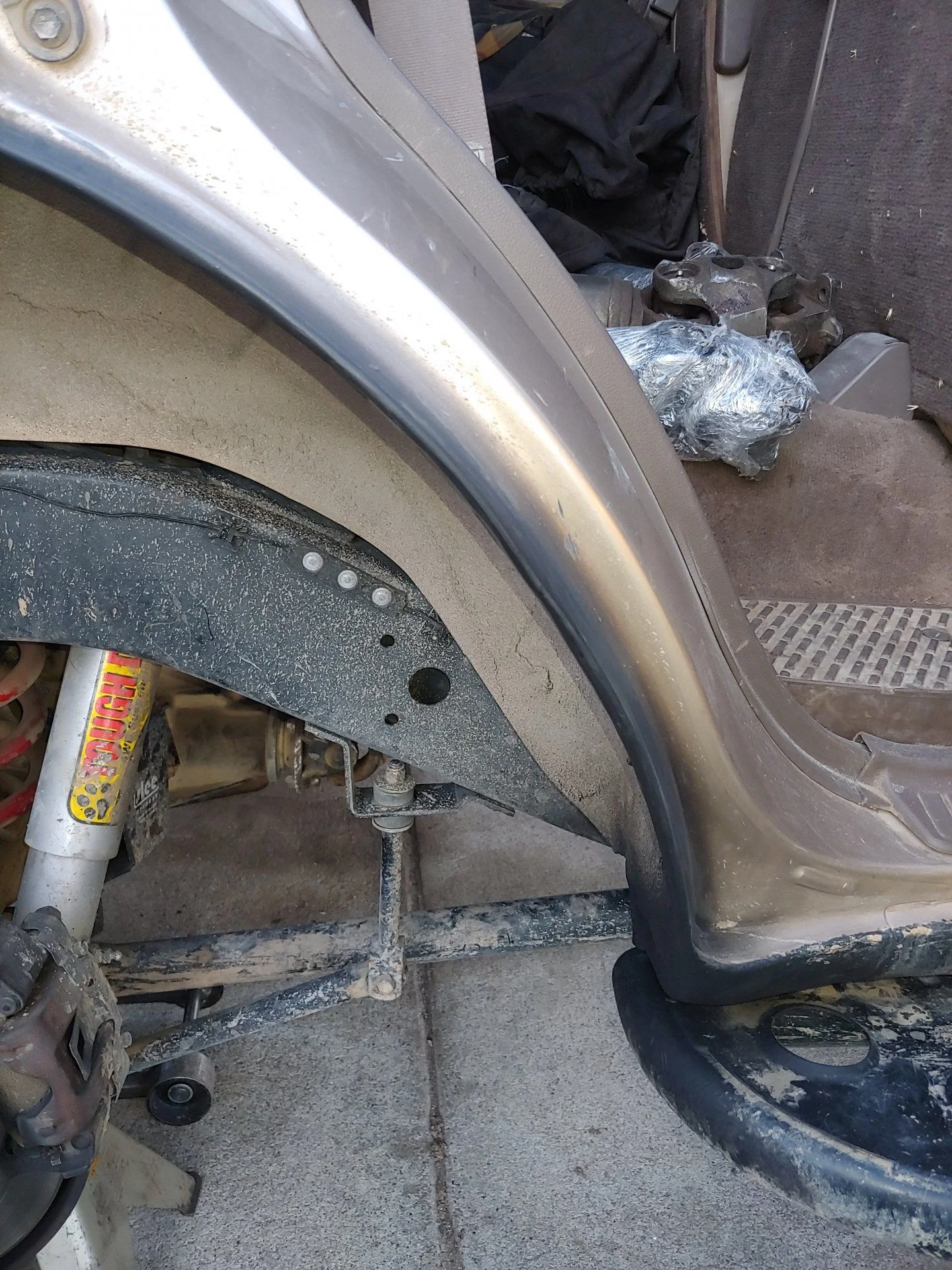

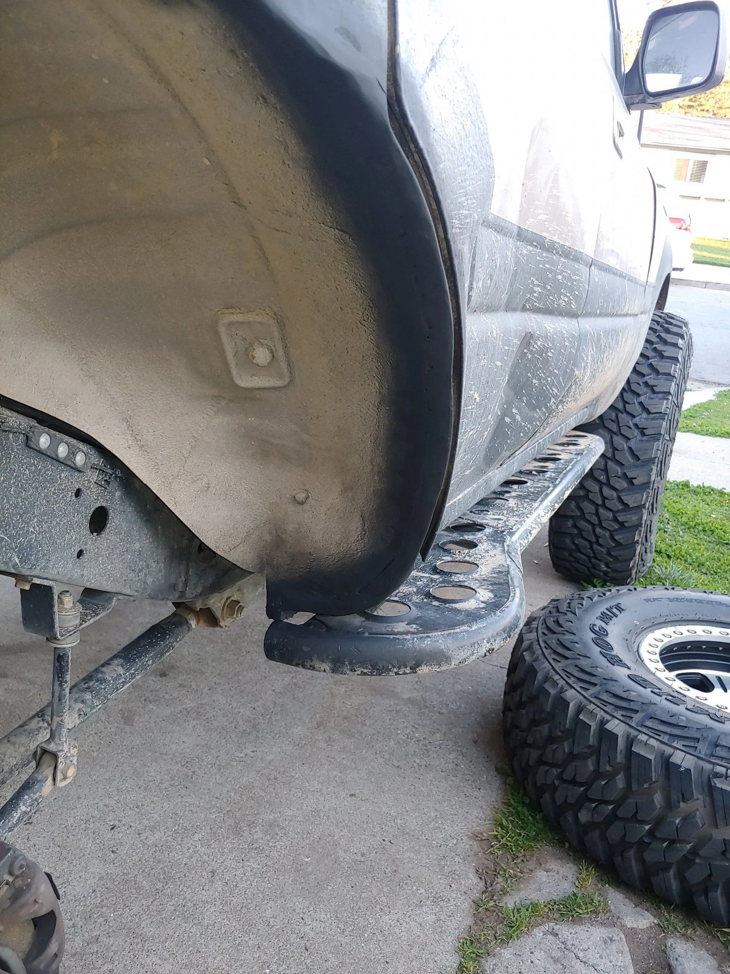

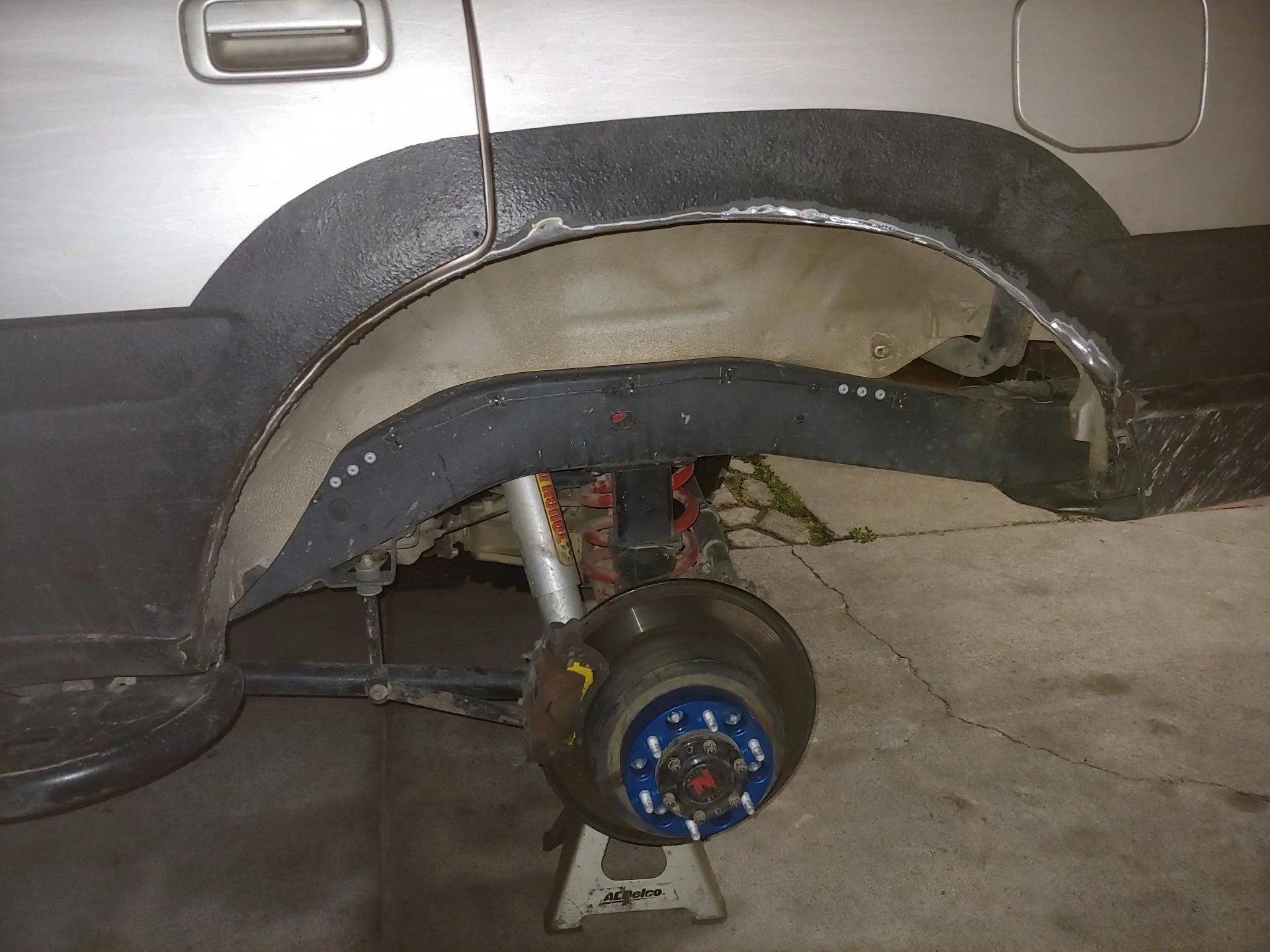

And a hole lot of cutting!!!!!!!!!!!!!
Nice trim work there, but if you want less the a 3.5" bumpstop back there with more uptravel then you will need to pie cut much deeper into the inner tub.
This, what Gary said or maybe the 6" lift kit.

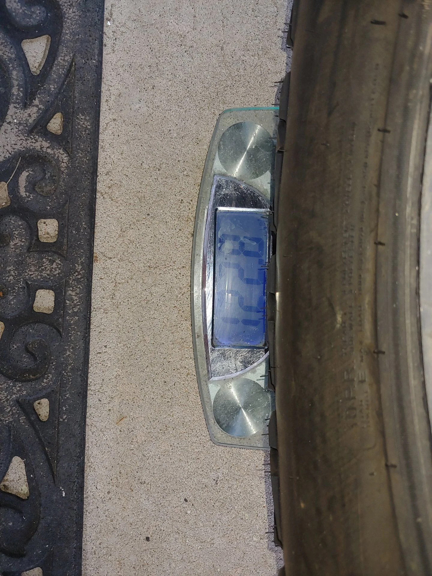

That's impressive. My 40" Nittos on racelines tip the scales at 145 per corner.
You guys can't be serious o_O I'd have to call 911 if I got a flat. I might be able to pick it up, but I'd have no accuracy to get it on the studs:bang:
old mechanic trick my buddy taught me. Use a big f.....n pry bar as the leverage to lift. The other hand guides it on. I always carry a 3 foot pry bar in the truck. Multi purpose tool.
While that works for mounting it on axle.
I hurt my back lifting that 39 inch monster onto the studs on the 4x4labs swing out. 125 is heavy but what makes it worst is the giant size and its awkward to hold. I can barely get my arms around it.
I'm actually second guessing myself and not carrying a spare anymore. I always bring a flat kit and a can of foam slime. However, my luck with tires is not so good lately. I've shredded 4 tires thus far in the past 3 years. Back of my head tells me I need a spare cause all 4 times a flat kit would not have fixed it. that weight and departure angle has me concerned.
