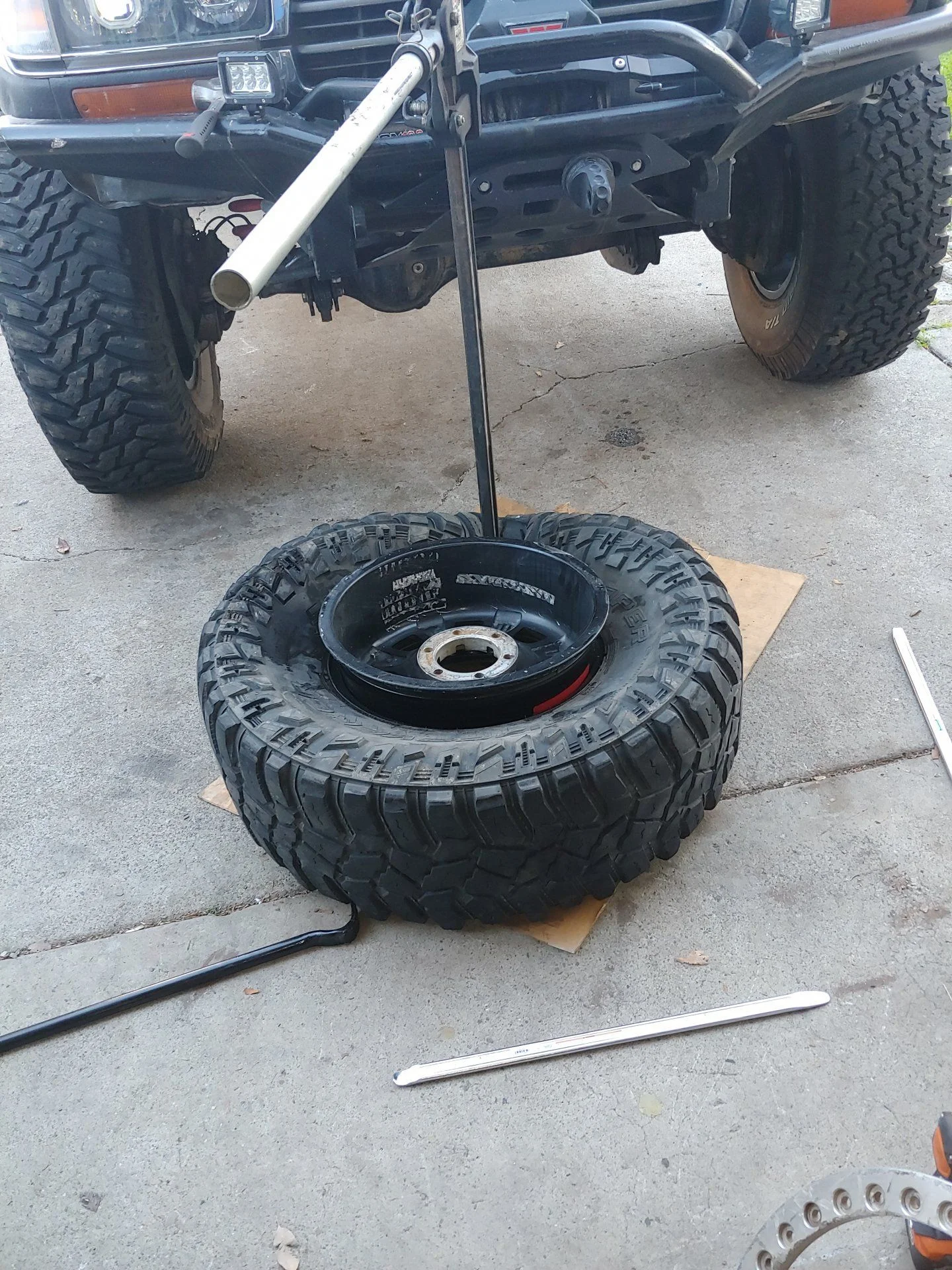

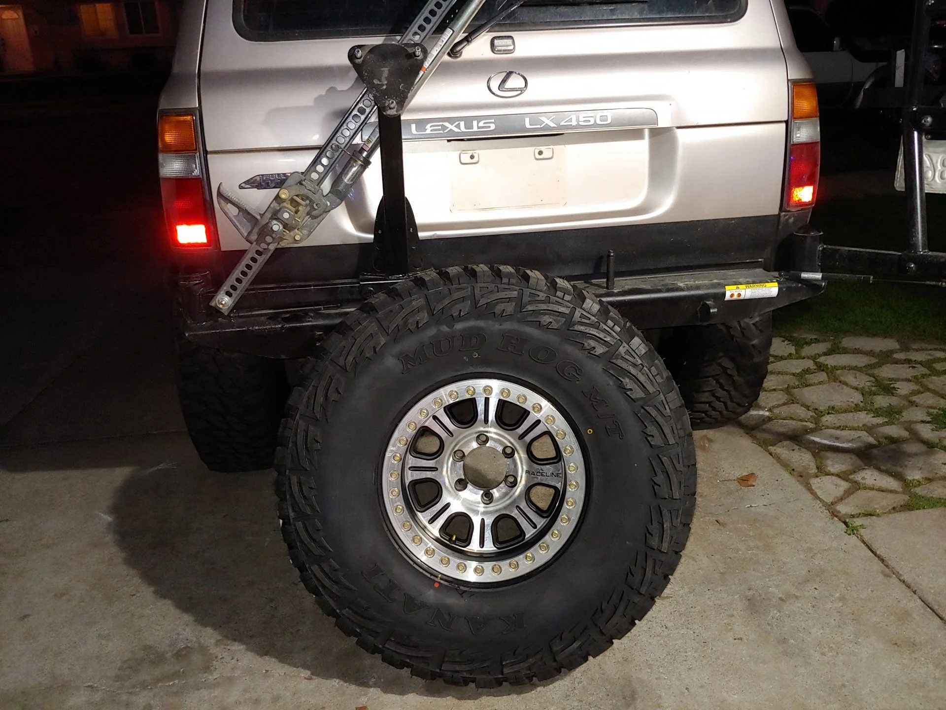

buddy came over yesterday and helped me for a short time and we popped the bead off with the hilift. Took 3 rotations to break that sucker and a lot of windex, jumping, pry bar and sledge hammer action to unseat the back bead about 20 minutes. Removed the used tire off the rim (5mins) and then throw the new Kanati on (5mins). All that in about 30mins with 2 people for 1 single tire. I did not attach the ring yet and will try and do that later if I have time. Otherwise 3 more tires to do. Hopefully another buddy comes over and helps with the remaining 3 tires. It's waaaaaaay faster with 2 people to work the hilift and apply force on the bead to break it loose.
My hat is off to you Sir, I threw in the towel and went to the tire shop.
Ugh. Mounted number 3 today. Only 2 more to go. This is painful and im about to take it to the tire shop to just have them debead and unmount it.

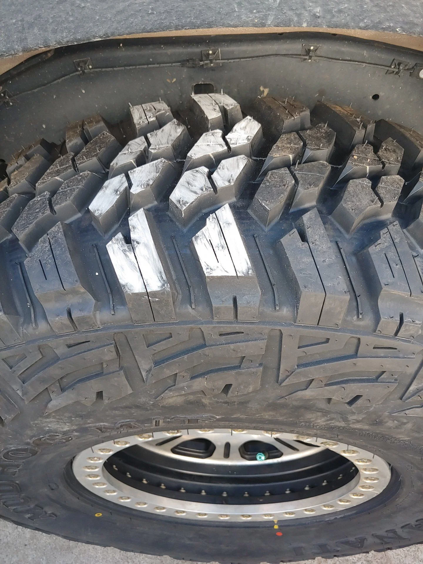

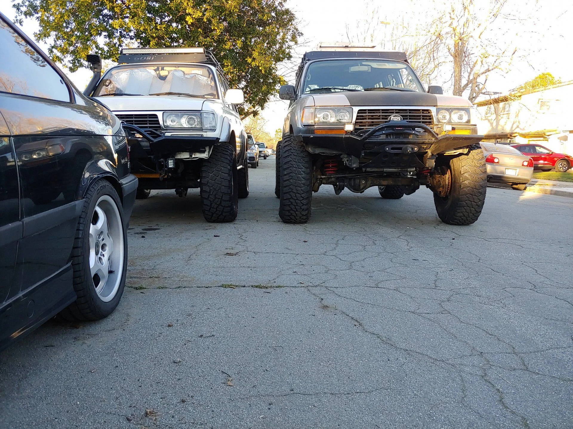

Also went for a drive with 39s in the rear and 37s in the front. No weights no beads and the rear was smooth for a quick 50 mph lap.
Also did a chalk test and these 39s on my empty truck likes 19-20 psi with nearly even wear.
Its stuppppid slow now with 4.10s and 39s pushing it. Can't wait for my 5.29s to be installed.
And this weekend I'm working on fender trimming and hopefully welding in hydro and hooking it up.
Its in seriooooouuuusssss need of hydro with 39s. 37s was a pain but she ain't happy with 39s.

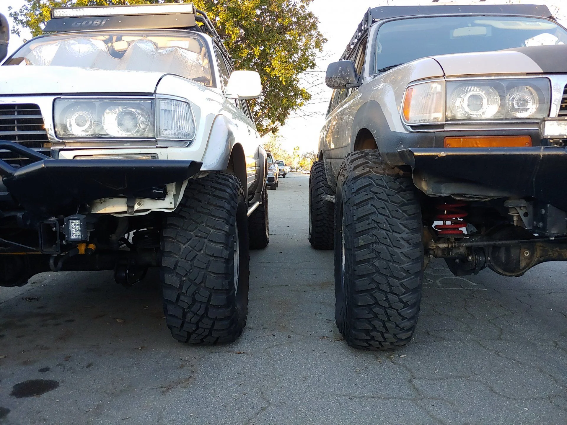

So far im really happy with going 39s. Not to loud on the street and they roll smooth. No beads or weights. The extra approach and departure angle is night and day. Diff is tiny bit higher too. I'm actually thinking of not going 6inch lift and maybe keeping it 4s.
I do need to buy heavy Dobi 4s tho and cancel my Dobi 6s.
However having that extra 2 inch would be really nice as long as I keep it crawling. Would give me more belly clearance.

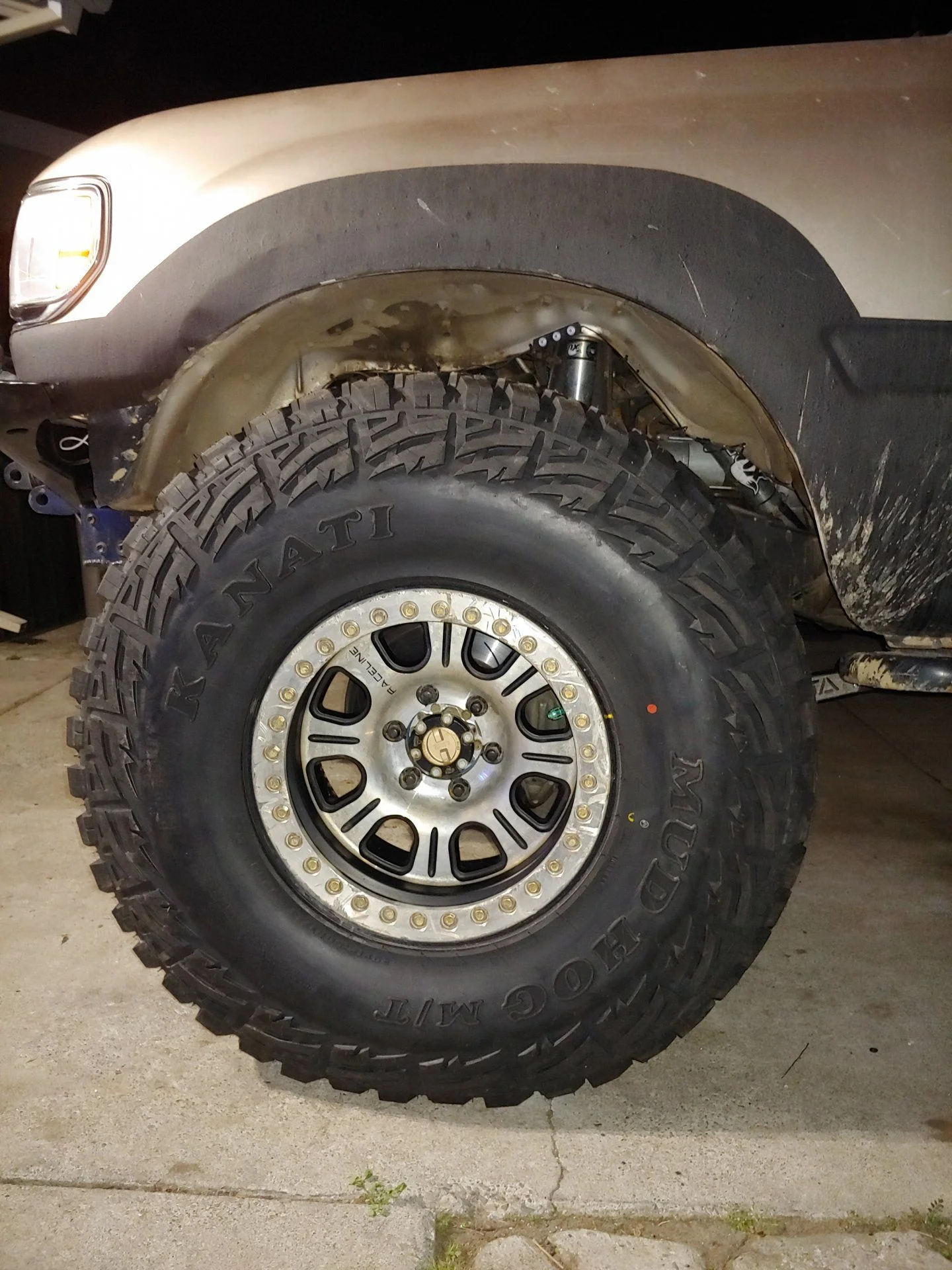

I saw @malteserunner @Broski and @Noahrob truck last weekend and spoke extensively with Broski on how he did his cutting. His work was immaculate and looked really good. I'm probably not going to make mine that nice and had 3 examples of how to do it. I think ive decided to copy Noahrob example of pie and rolling and tapping it up to make the lip. Then welding the pie slices together, grinding smooth, seam sealing where needed and then bed line for final step. That's the best compromise for me as mine doesn't need to be super pretty and just functional and strong with no sharp lip to cut a sidewall.
I'm running Timbren bump stops and tried them for the first time at Hammers. They actually worked really well and absorbed a lot of the woops and wheeled well. I disnt notice any drastic rubbing innl the wells. I have not done a forklift flex with the bumps yet and want to make sure they arent limiting up travel. Worst case is I take them out and go back to regular OEMs with appropriate spacer height to minimize tire rub and up travel. Timbren would go onto my Turbo 80. I take that to Baja a lot and they really do make a huge diff in the woops
