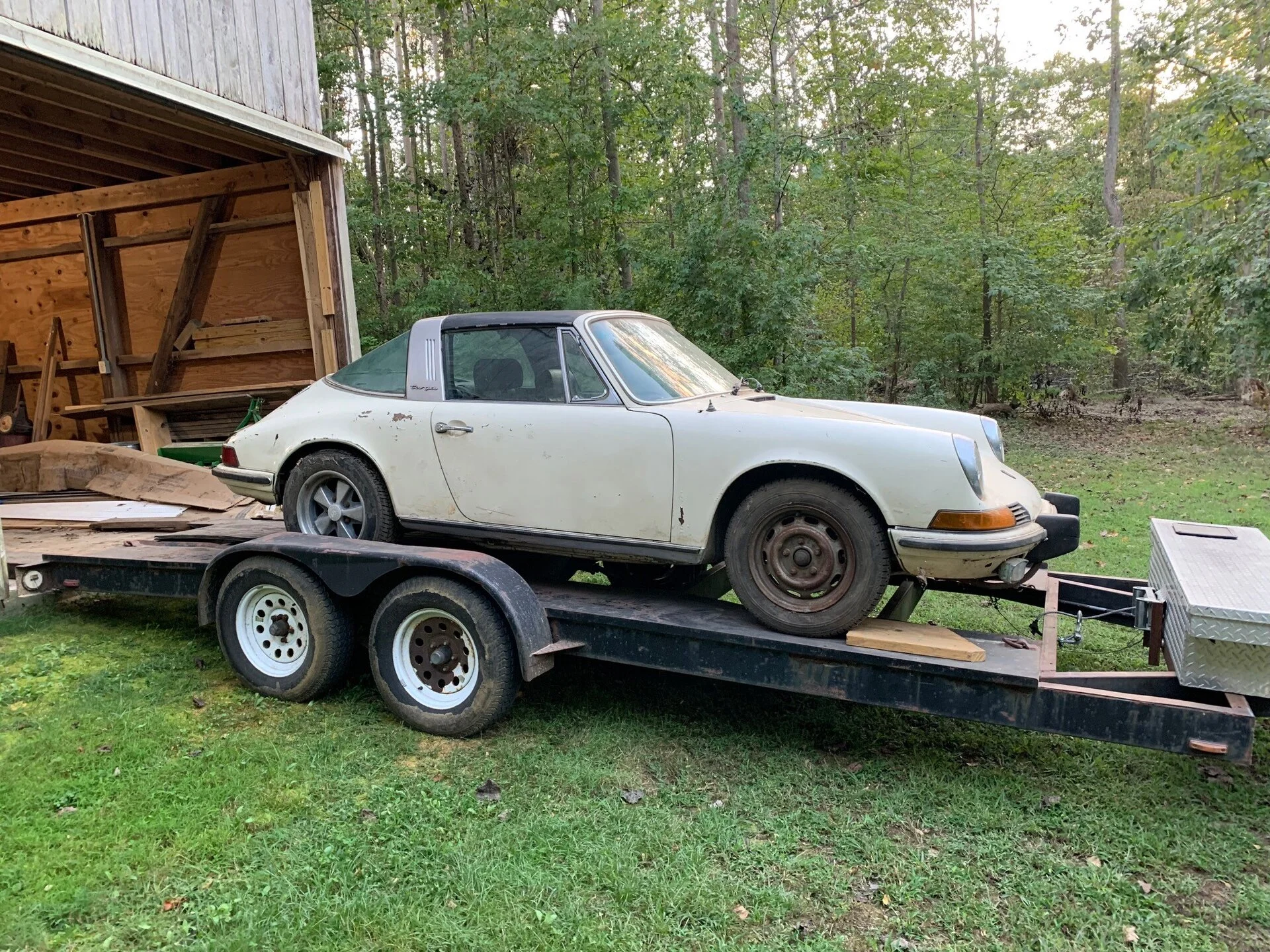

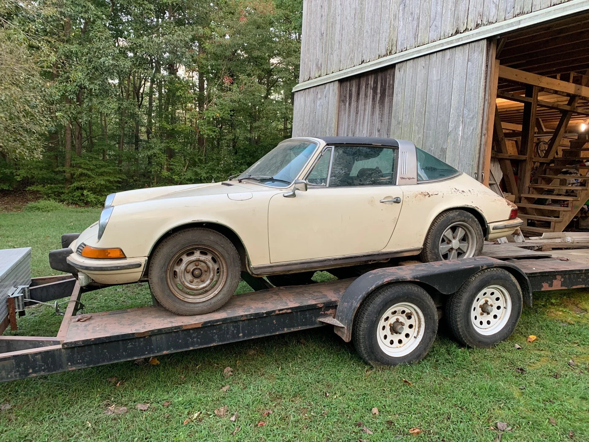

I had seen this 80 sitting at a local repair shop for about a month. I finally called them to see what was going on with it. The shop said it had come in for a new sunroof glass and the owner was supposed to supply the part, they did release the owners phone number to be because they did believe she was interested in selling it. Well i called and left a voicemail and about a week later i got a call back from the owner Nancy. We spoke in lengths about the truck and the other vehicle she had. Some belonged to her and some where her husband's Ken. Ken unfortunately passed away a few years prior to our meeting. She said that she was getting up in age and she wasn't going to have the time to give to the vehicles that were in the barn and was interested in selling everything, she really didn't have the expertise to list them in front of the right audiences either. Well it turned out that in the barn there was an 73' Porsche 911T Targa, 88" Porsche 924se (1-500 in the US), 59 BMW R69S motorcycle, 76 R90E BMW motorcycle and an 85' K100RS BMW motorcycle. o_O We came to an agreement that I would help her sell off the vehicles for a commission. I was able to find a buyer for the all of the vehicles over the course of the next month. After the sale of the first 2 vehicles she sat me down to speak about my commission for helping her get her barn cleared out. well that commission happen to be this 80 series!

a few of the vehicles that came out of the barn

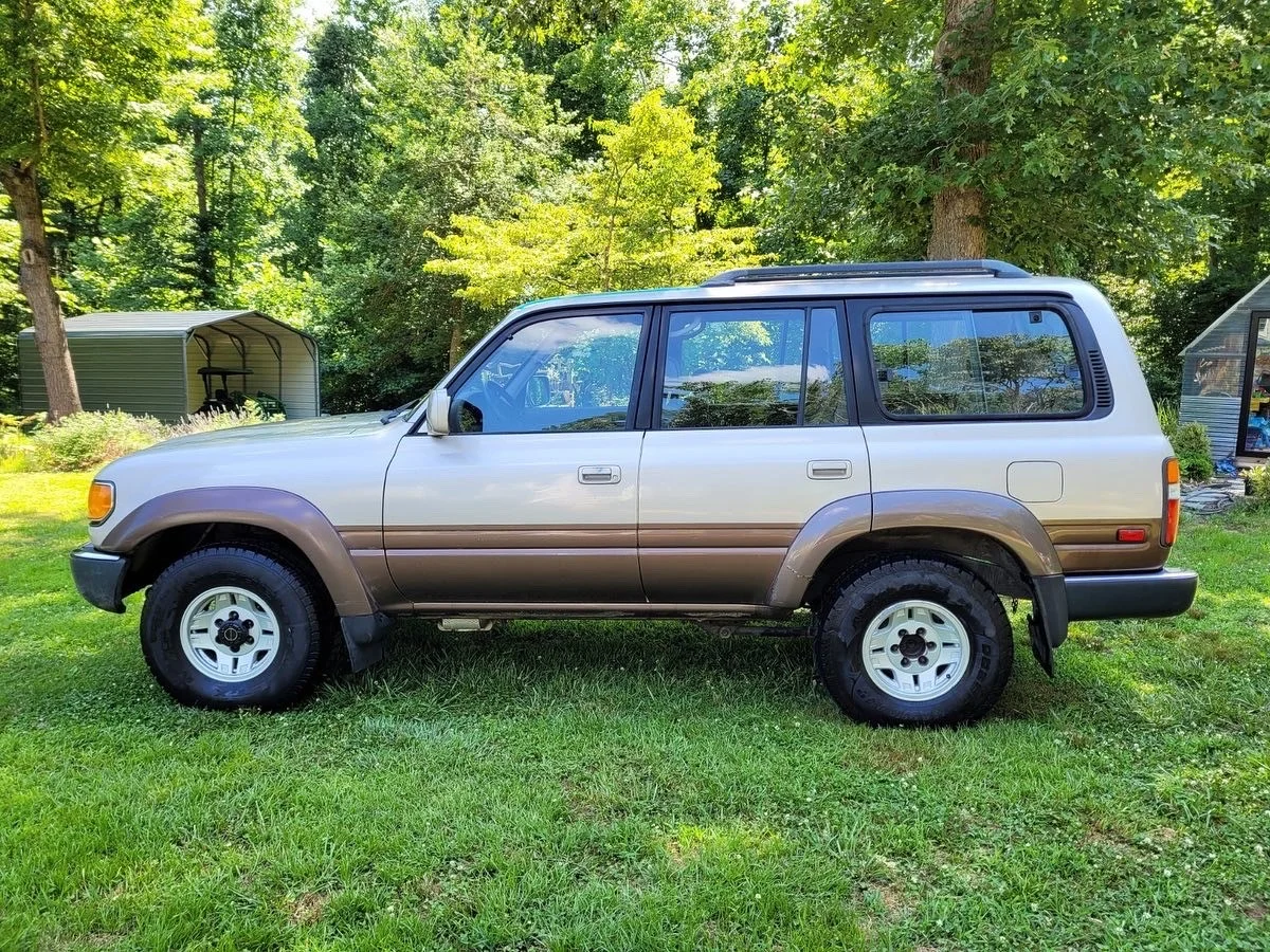

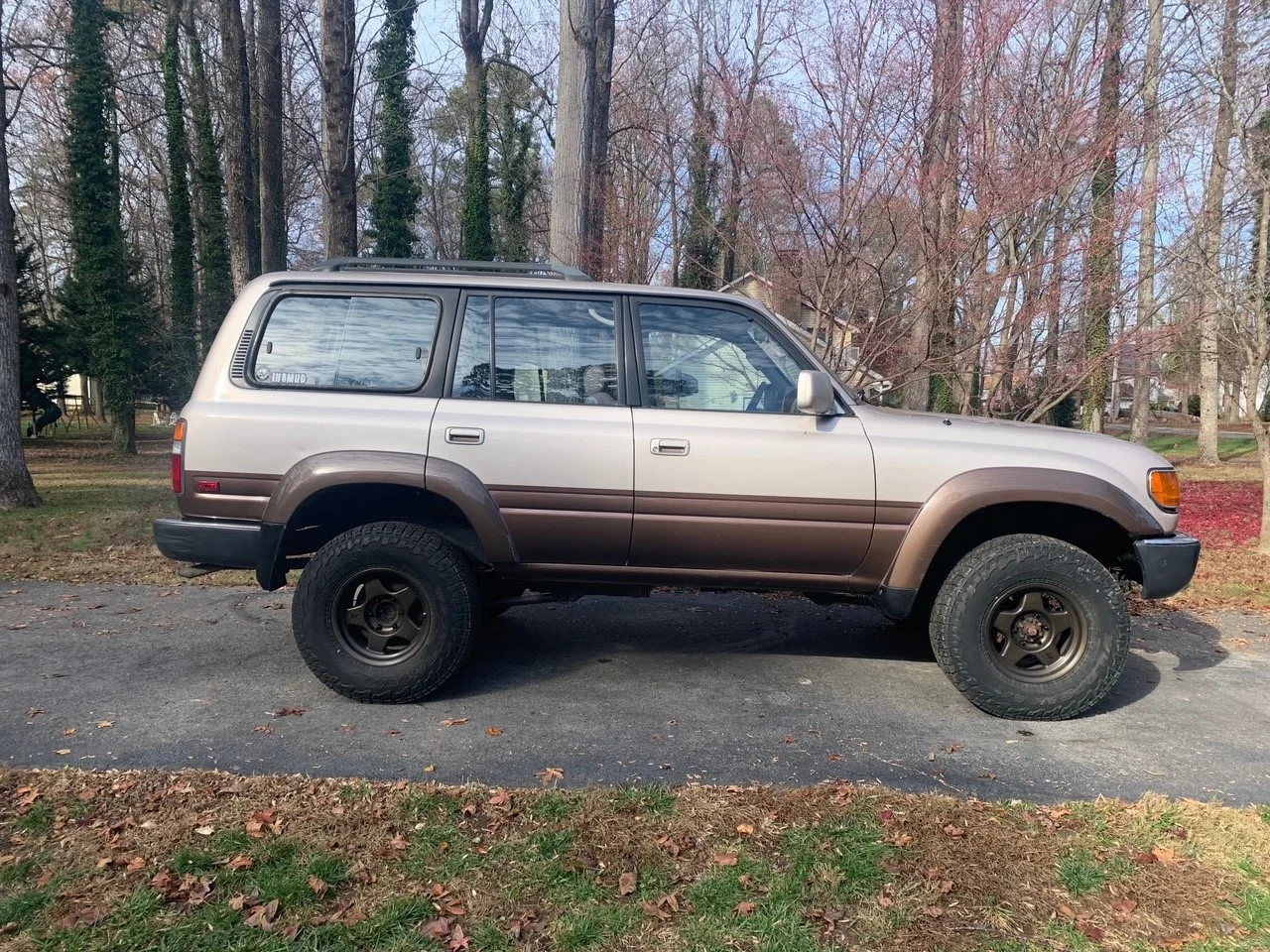

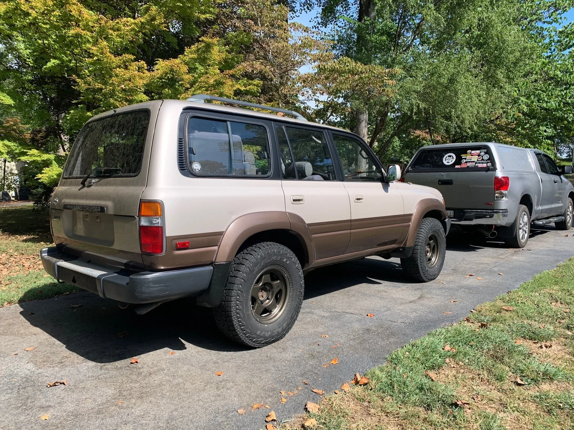

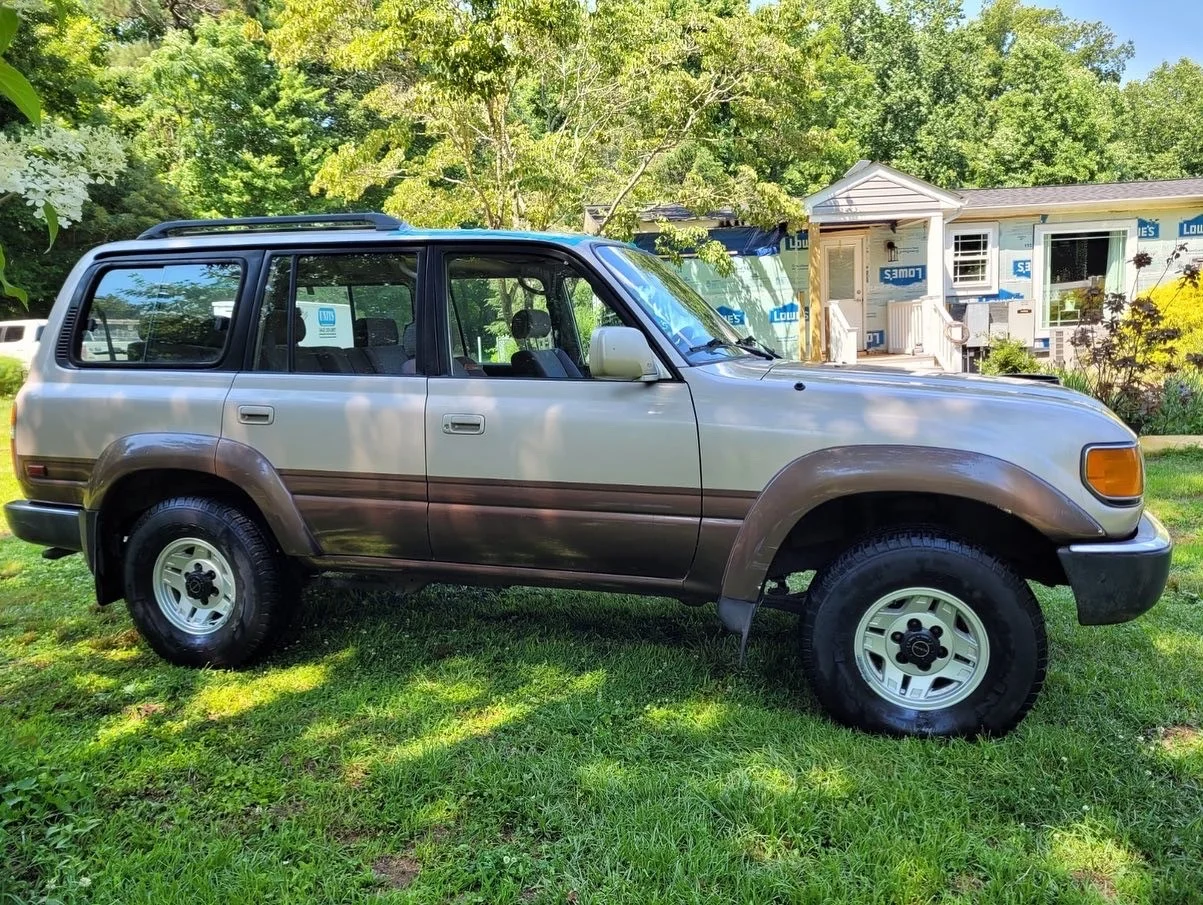

The day I brought the 80 home, which has been named Waffles 🧇 🧇 🧇 by my son for obvious reasons lol
finished in Beige/Cedarwood 4K1/4L6

ya he did, so the cruiser, 924, r90 and k100 were ken's
the 911 and the r69s were nancy's

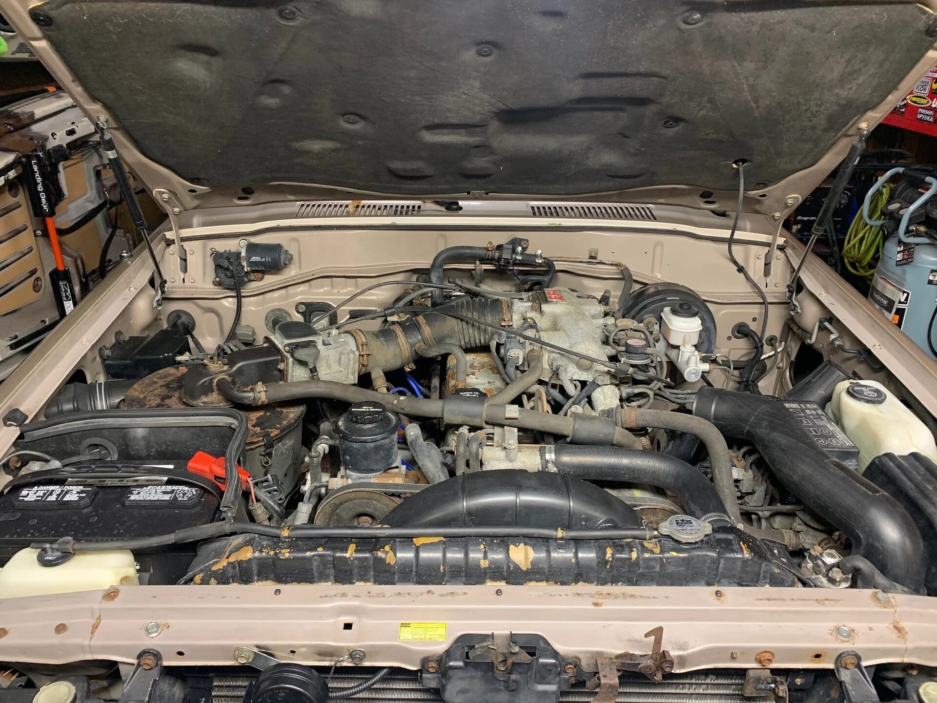

next up was to replace all the drive belts with OEM. for some reason the alternator tensioner bolt was missing so my good friend @ToyotaMatt at vintageteqparts.com hooked me up with brand new one. He is definitely the guy to see for those hard to find parts. also got a new washer tank. Did a fresh oil change and started gathering parts for the desmog. The engine bay needs so TLC but ill get too it. getting a blast cabinet for my shop and ill be able to really start cleaning up bits and pieces.

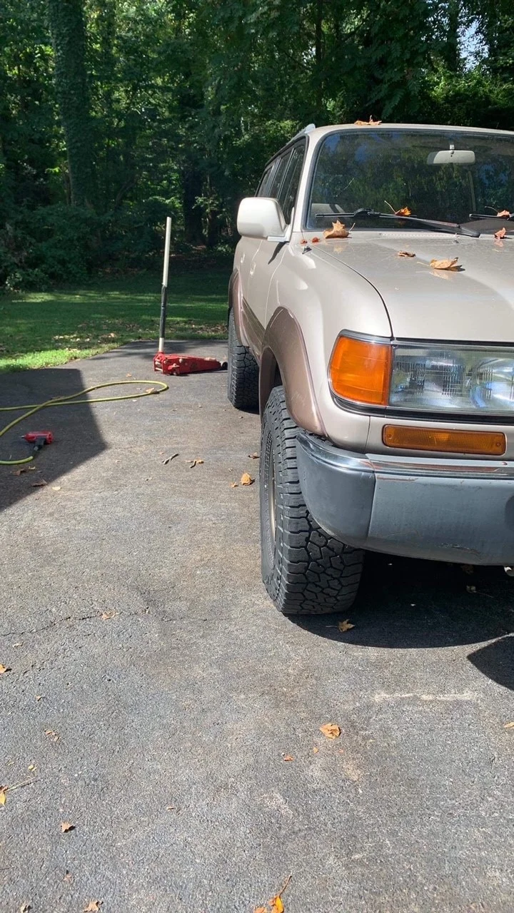

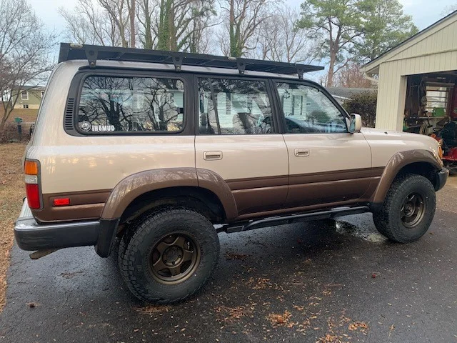

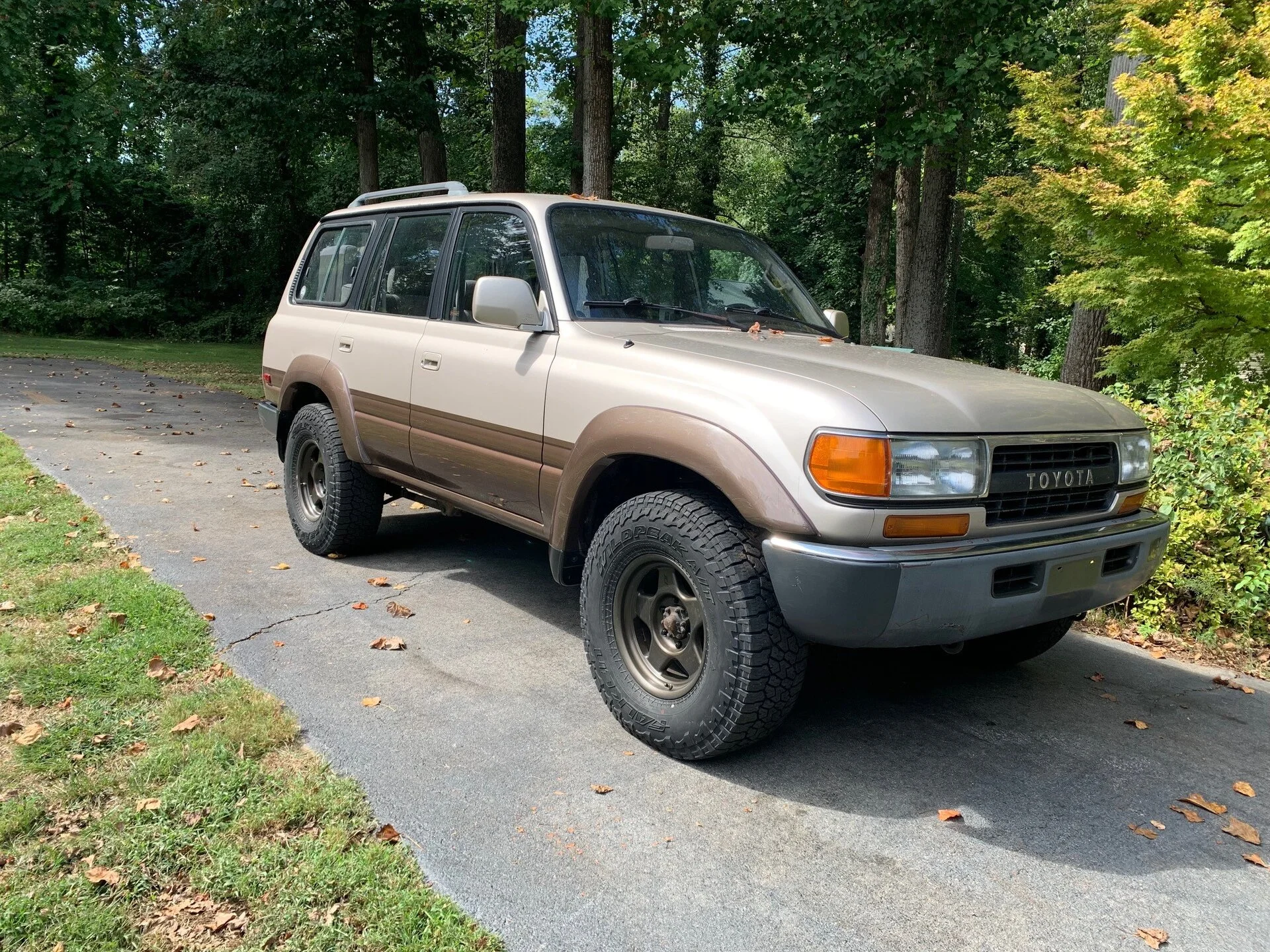

about a month went by from that point its been running great but the tires where so dry rotted i had to make that my next priority. i was just about to purchase some when these matte bronze F5's popped up locally on marketplace. Was a set of 5 wrapped in 285/75r16 falken wildpeak at3's. I couldn't say no to the price and i think they complement the truck great

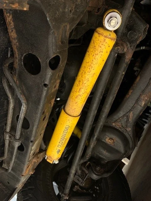

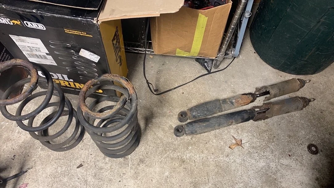

Was able to score a set pair of OME 850 springs from a club member and a set OME L shocks from another mud member. Already had some rear 860's laying around from my 100 series so had a lift for under 200 dollars and man did it need it the original where so worn out. Truck rides 100% better even with a little altitude adjustment.

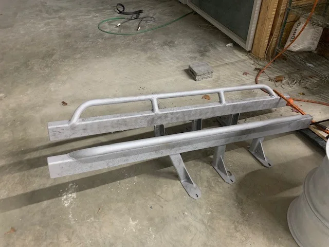

We have the greatest group of guys in our local TLCA chapter! I had someone give me a set of early SLEE sliders that had been sitting in his backyard, they are rough but couldnt argue with free. they where for a late model 80 so i had to modify them a bit to get them to clear my cats. set them to blasting and then painted them up at my shop. You can still see all the rust pitting but again i have like 150 dollars into them so im happy. the sliders are the only "armor" i plan to add to the truck.
also had another club member sell me a home built full lenght roof rack for 100 bux and i couldnt be happier with it.

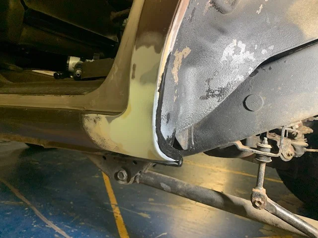

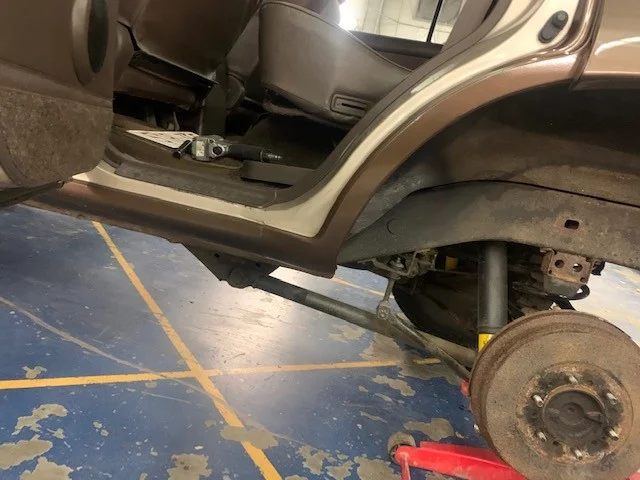

and a small spot on the rear of the driver side lower rocker. it was minor but needed to be addressed. I cut out the rust, fabricated a patch, welded it in and did the body and paint work. I treated the inside of the rocker with cavity wax so the rust should not return. I thought i had photos of the patch welded in but i cant find them but you get the idea
EDIT: found a photo of the patch welded in

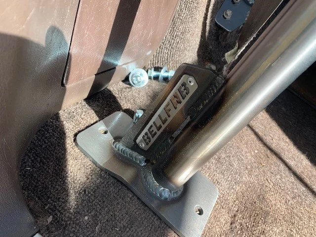

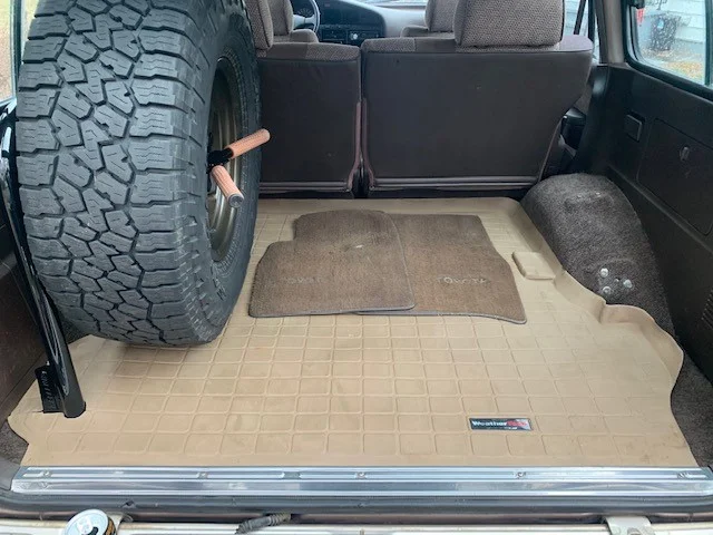

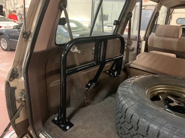

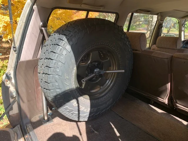

With no future plans to add any type of rear bumper/ swing out i had to come up with a good place for the match spare and wasn't too keen on placing it under the truck. Was originally going to fabricate my own in-cab tire carrier but landed on the BellFab one, really well built piece. i painted it standard toyota black but added some champagne pearl to it just because. Had the old weathertech truck mat out of my 100 and with a little trimming it fits nicely

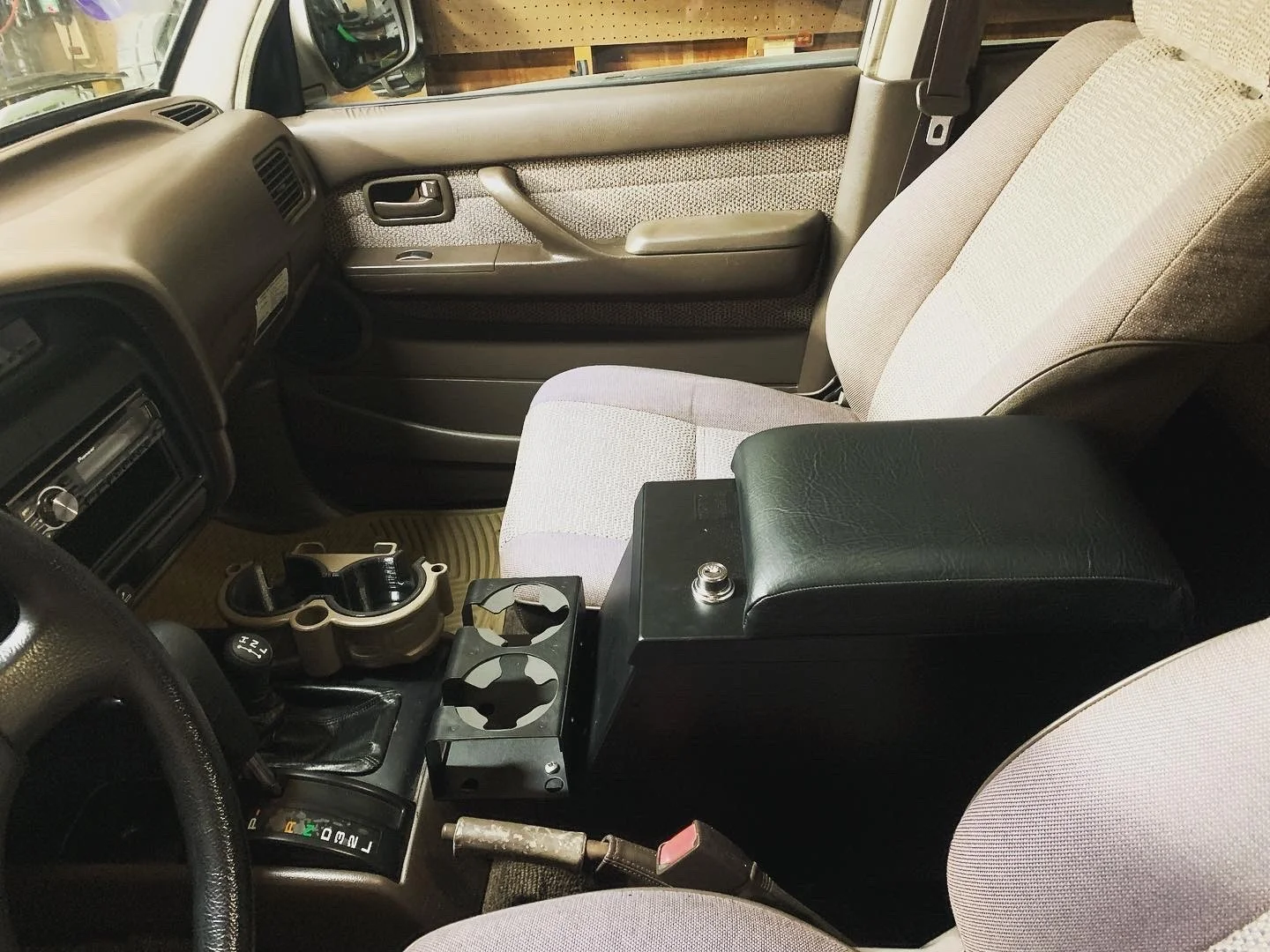

One thing i've alway hate about every 80 i've ever had was the ergonomics, the center consoles are just to low and its even worse in the early models. I bought a Tuffy console and its by far my favorite upgrade, idk why i never did it in any of my other trucks. Plus you can never have too many cupholders ;) i did find a NOS relay under the factory console along with about 1.50 worth of change so that was kinda cool
