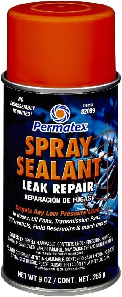

Didn’t you just have a leaking gasket? 😂
Red neck solution:
