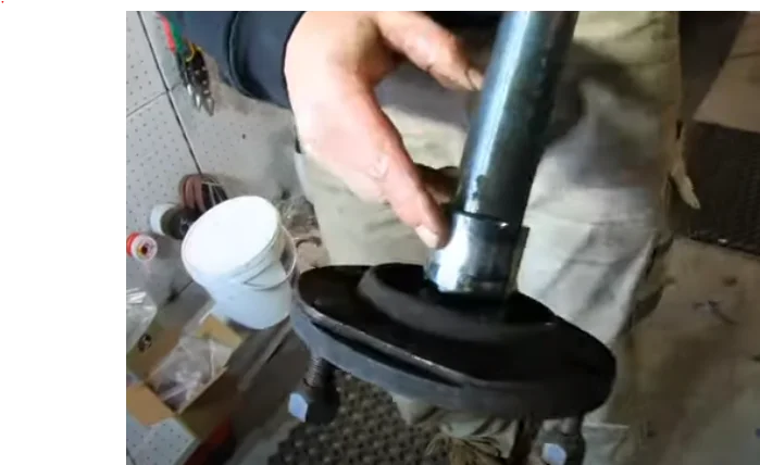

Why does the guy on the 40 Channel have a bearing race or sleeve on his axle shaft, and I don't have that on mine?
They changed sometime after 1970 (not sure exact year) and quit putting the races on the axle shafts.

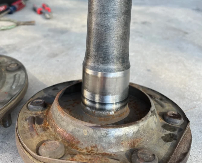

My late 70' production 40 did not have races on rear shafts. Maybe not og shafts but I believe they were.

Blueing is normal, FWIW your splines look great, bearing surface looks good, and it dont take much to spit that cork out so tighten with care.
@peesalot should/can I clean/polish the bearing surface on these axles? If so, can I use 1500 wet/dry sandpaper with oil or water or do I need to use emory cloth?
