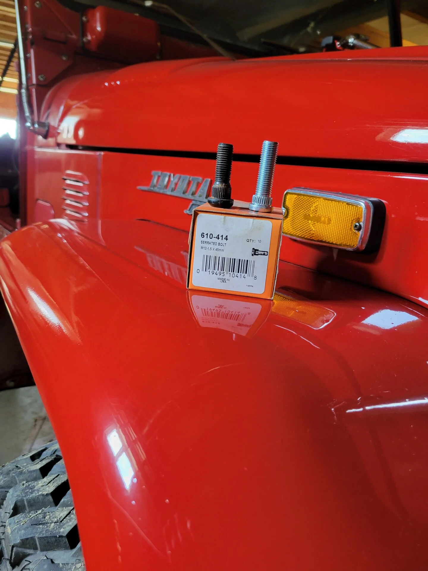

Stk FJ40 wheels studs are 37mm long. Dorman 610-414 and 610-265 are both 44.5mm long. So they are 7.5mm longer than stk or a little over 1/4". You need to do your own research on which studs you want to use. Search here using the dorman #'s and you'll find a lot of info. On both the #'s the difference between the 2 are the knurls. Both knurls are slight larger in diameter than stk. Dormans website has good dimensional info.
My mistake. I thought the length referred to total length. Dorman says it refers to “under the head” length. It is longer, although a smaller hear and serrated shaft, which is as you say slightly larger than stock.
Installed new wheel studs. Lots of thread engagement now. Back on the road. Diff/Locker seems fine… and no sign of any oil leaks!
