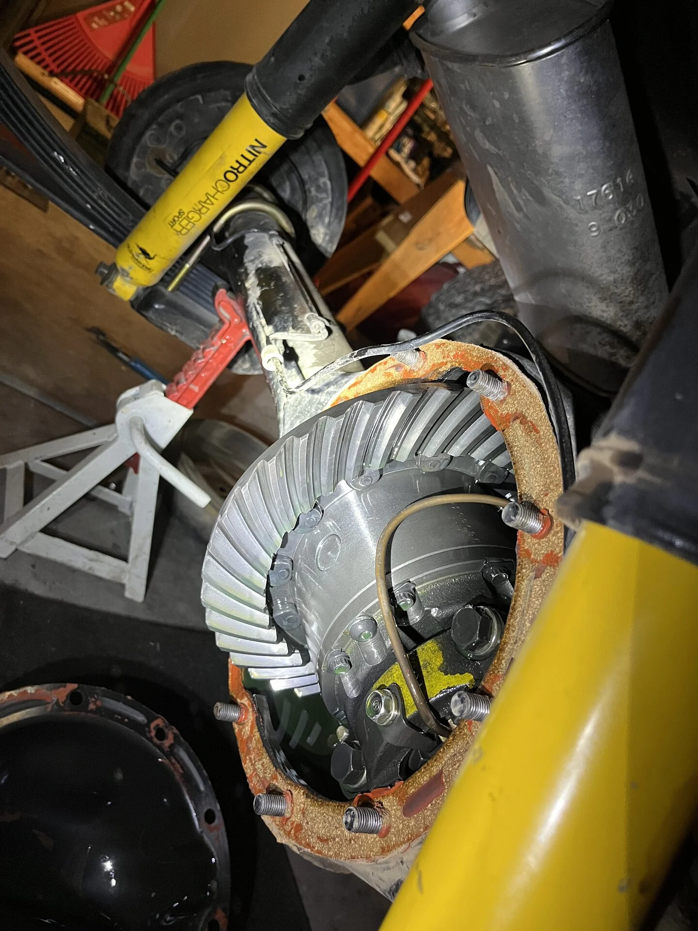

Note the crimped copper tube where it come up from the locker. That can’t be good! I’ve always thought there was something funky with this locker install.

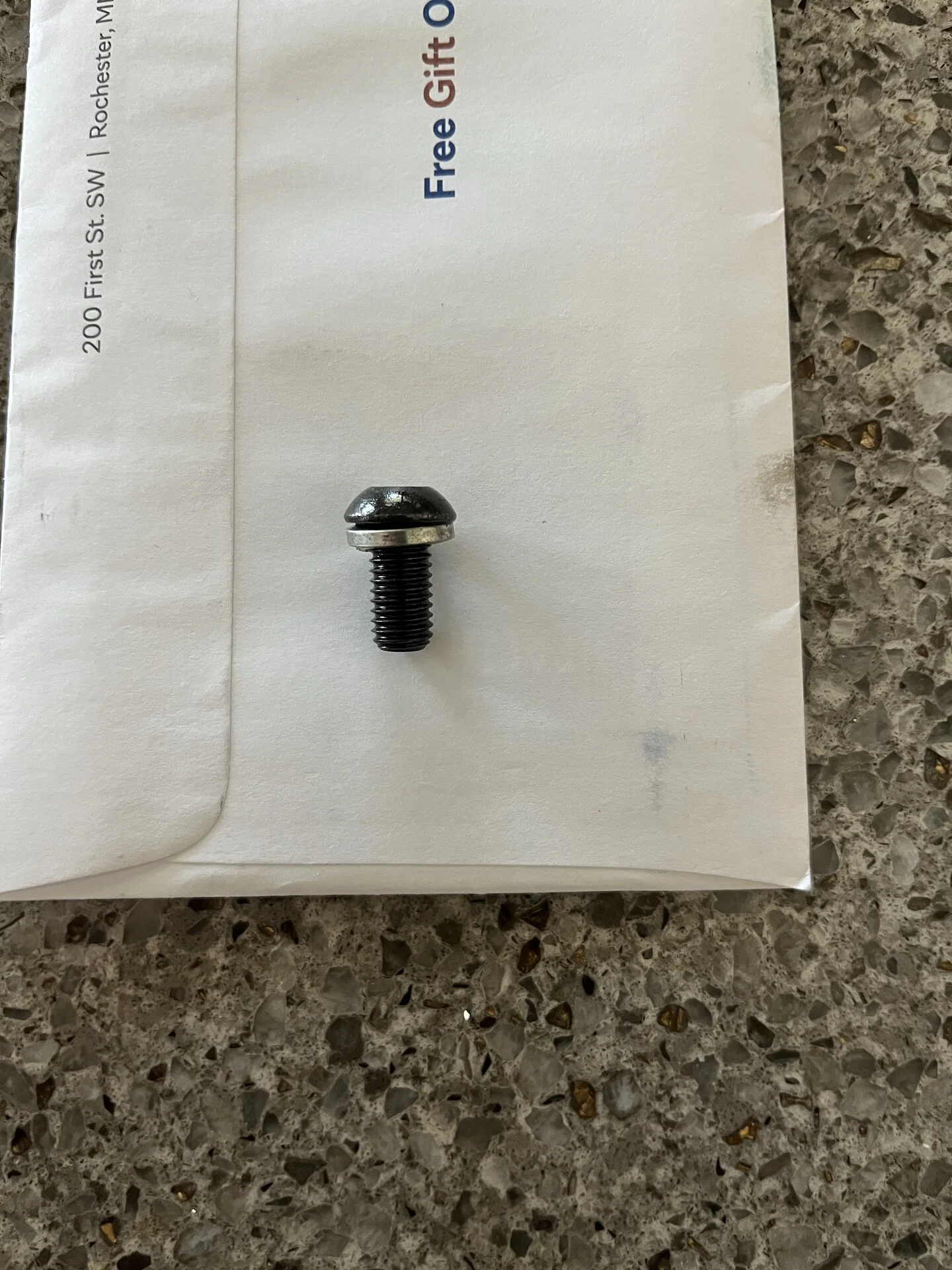

I pulled the rounded hex screw, and it’s only about a half inch long. Not long enough to hold the center pin. So what gives? What do you need to do to get the Center Pin out?
I’m not sure what you mean.

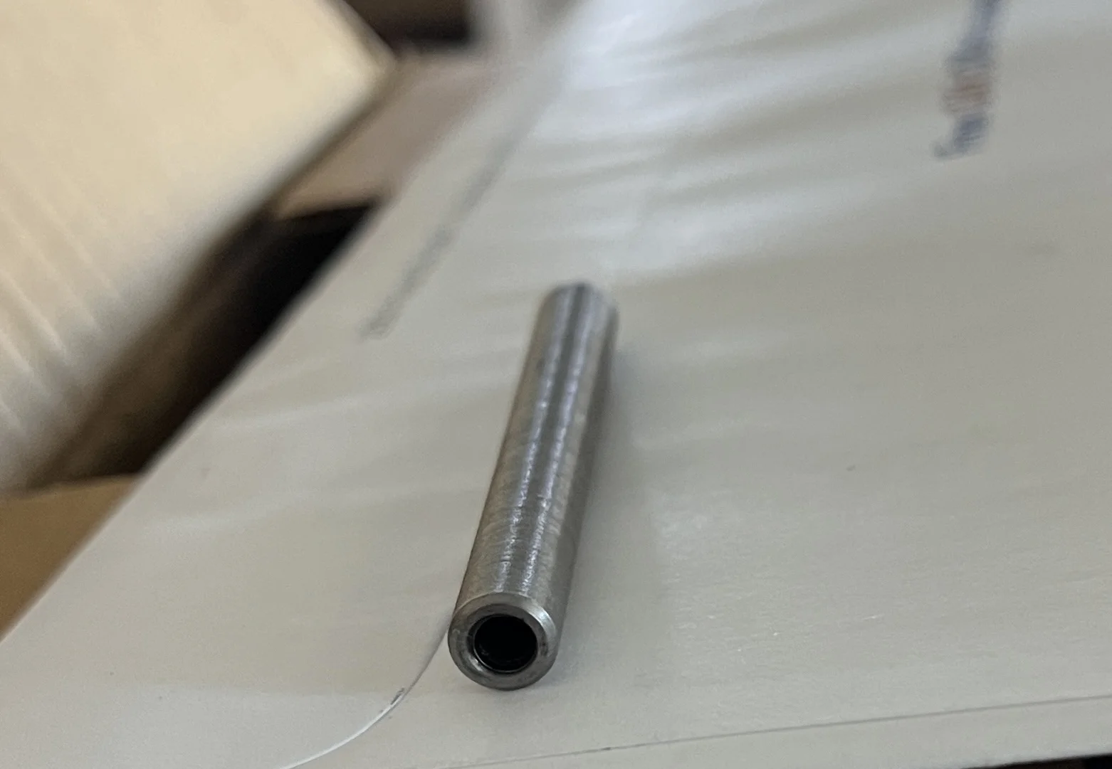

And there it is…. A hollow pin you dig out with a drill bit. The hex screw acts to hold/retain the pin. Impossible to see without a small mirror.

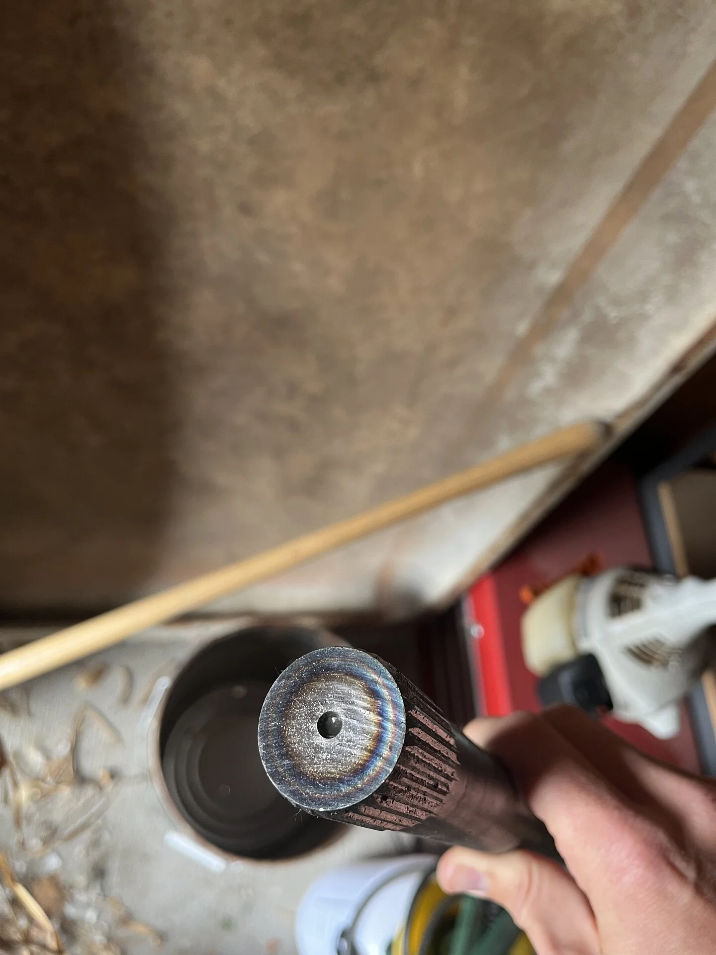

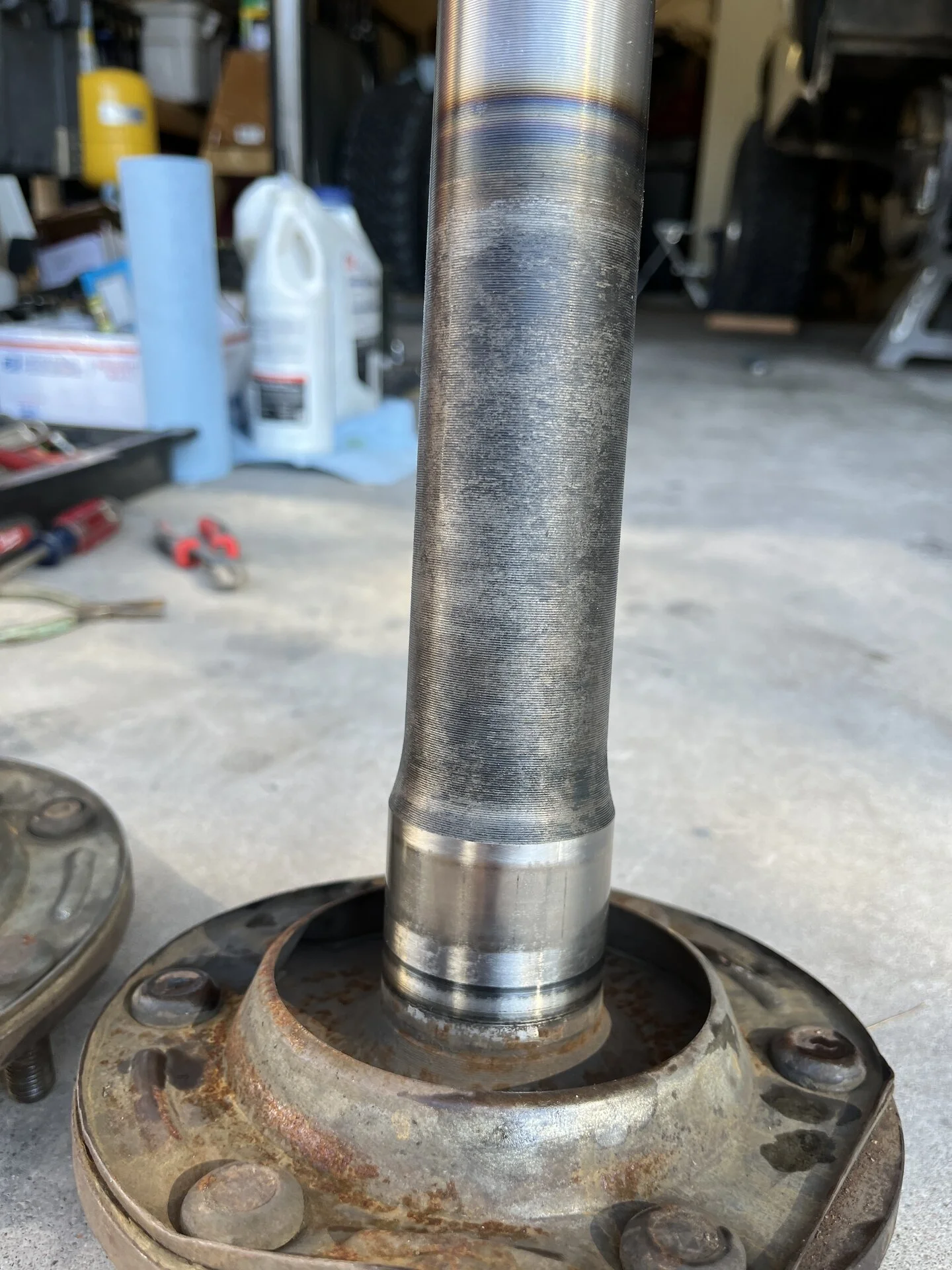

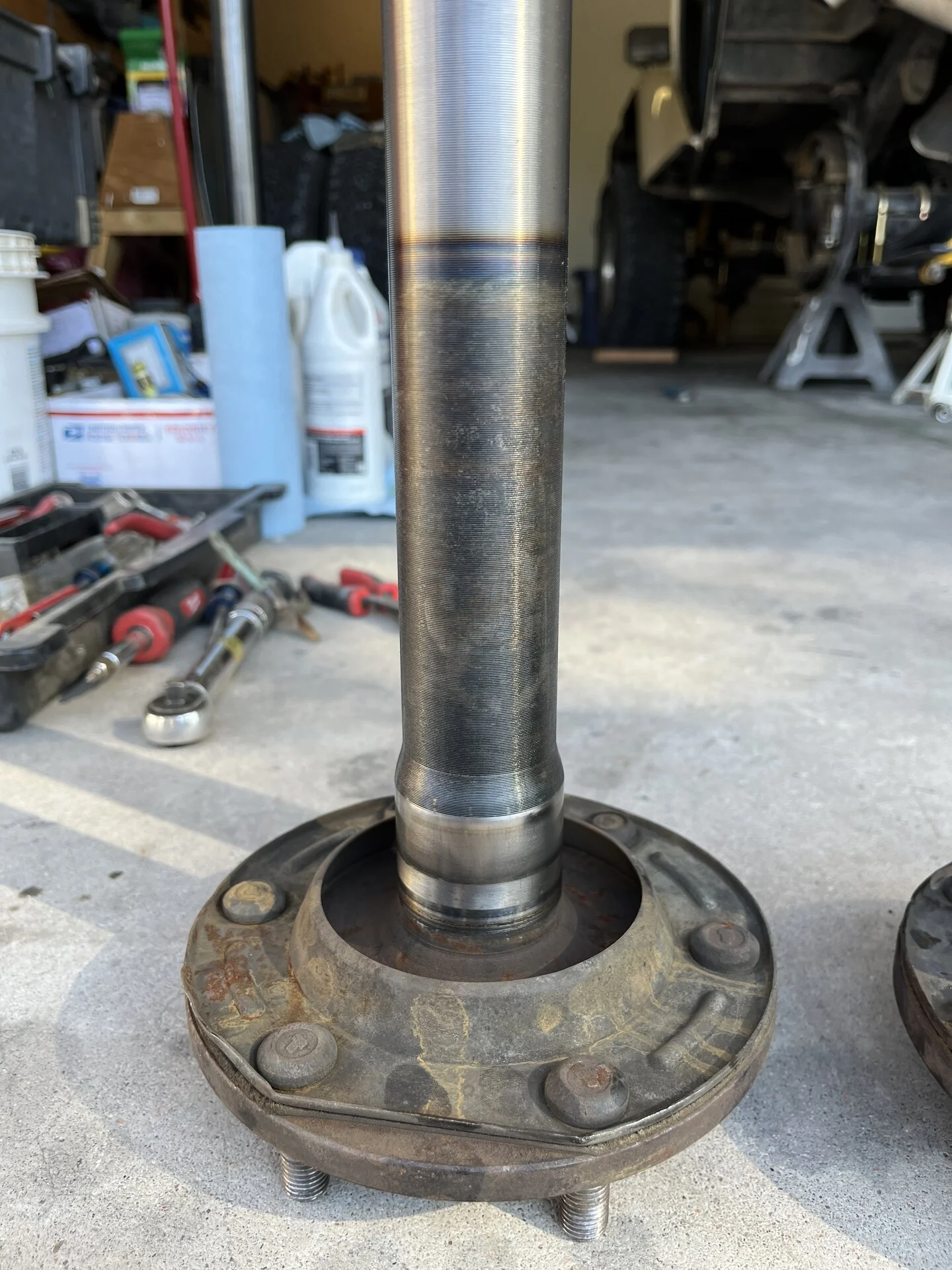

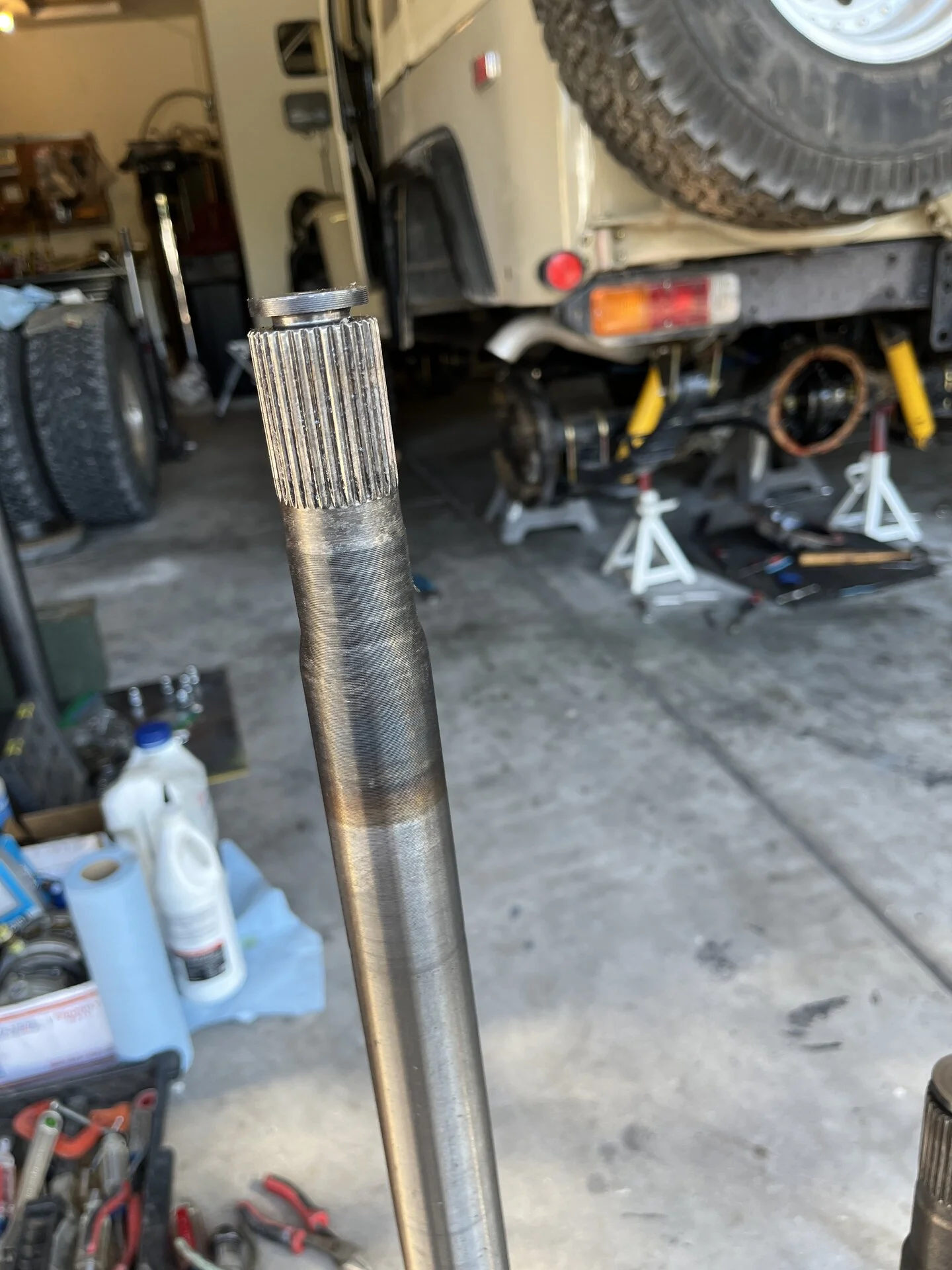

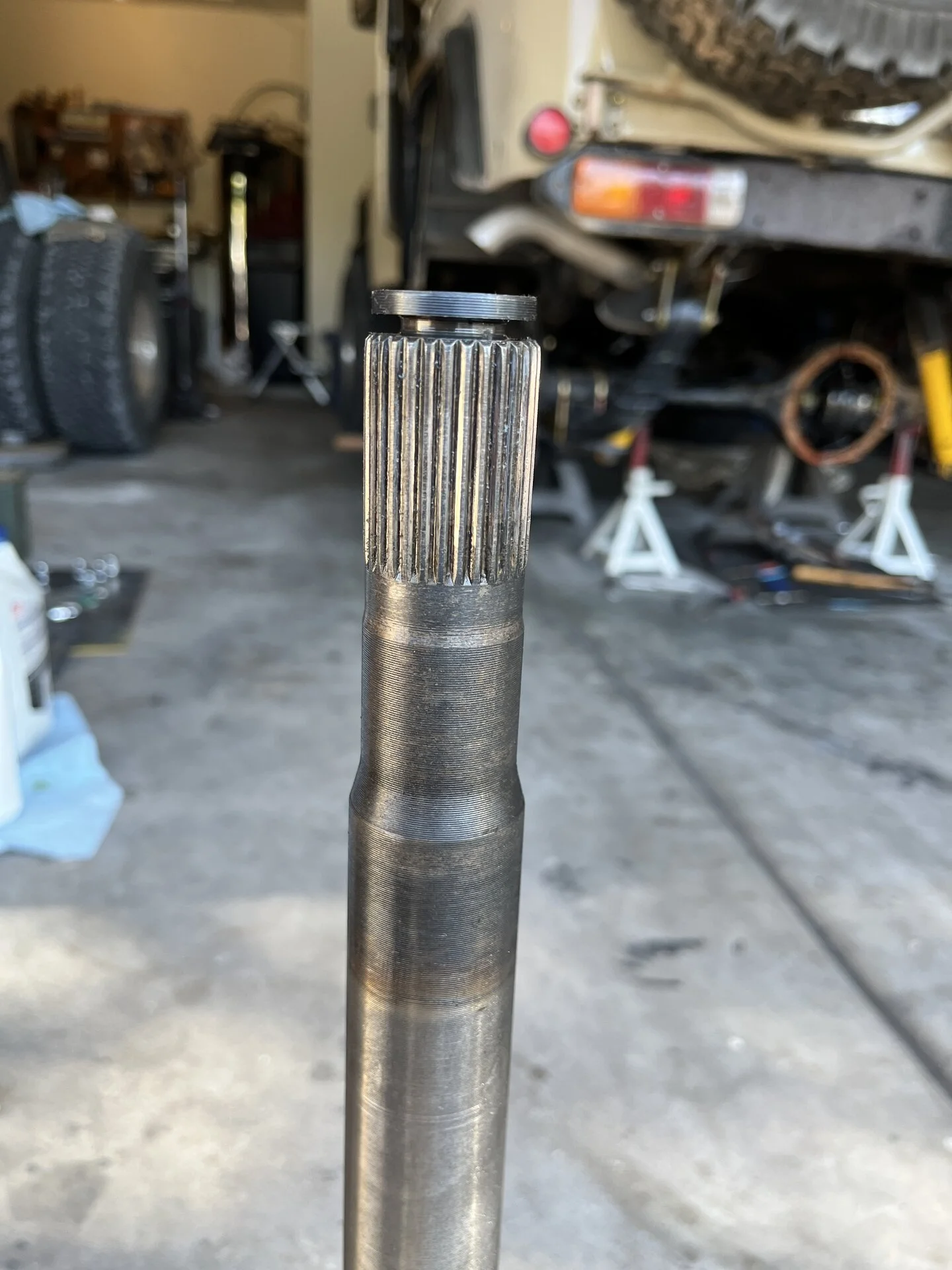

I pulled the axle shafts, and was shocked by the discoloration near the splines and the bearings. I’m assuming it’s from overheating at one time. The splines look decent and the bearing surfaces are smooth. The Diff/Locker looks great. I’m guessing this happened before I got it. Should I be concerned? What is the availability /affordability of replacement shafts?

And there it is…. A hollow pin you dig out with a drill bit. The hex screw acts to hold/retain the pin. Impossible to see without a small mirror.View attachment 3473832
Isn’t there a couple of pins around 1” in diameter that took the place of the original pinion pin that holds the axle spacer block? A magnet will help you get them out since you can’t just push it out from the other end.
Throw some pictures up. It’s probably just the heat treatment applied in those areas.
Just one large center pin. You can literally push out by spinning the hub and pulling it out. Then you take out the block.
