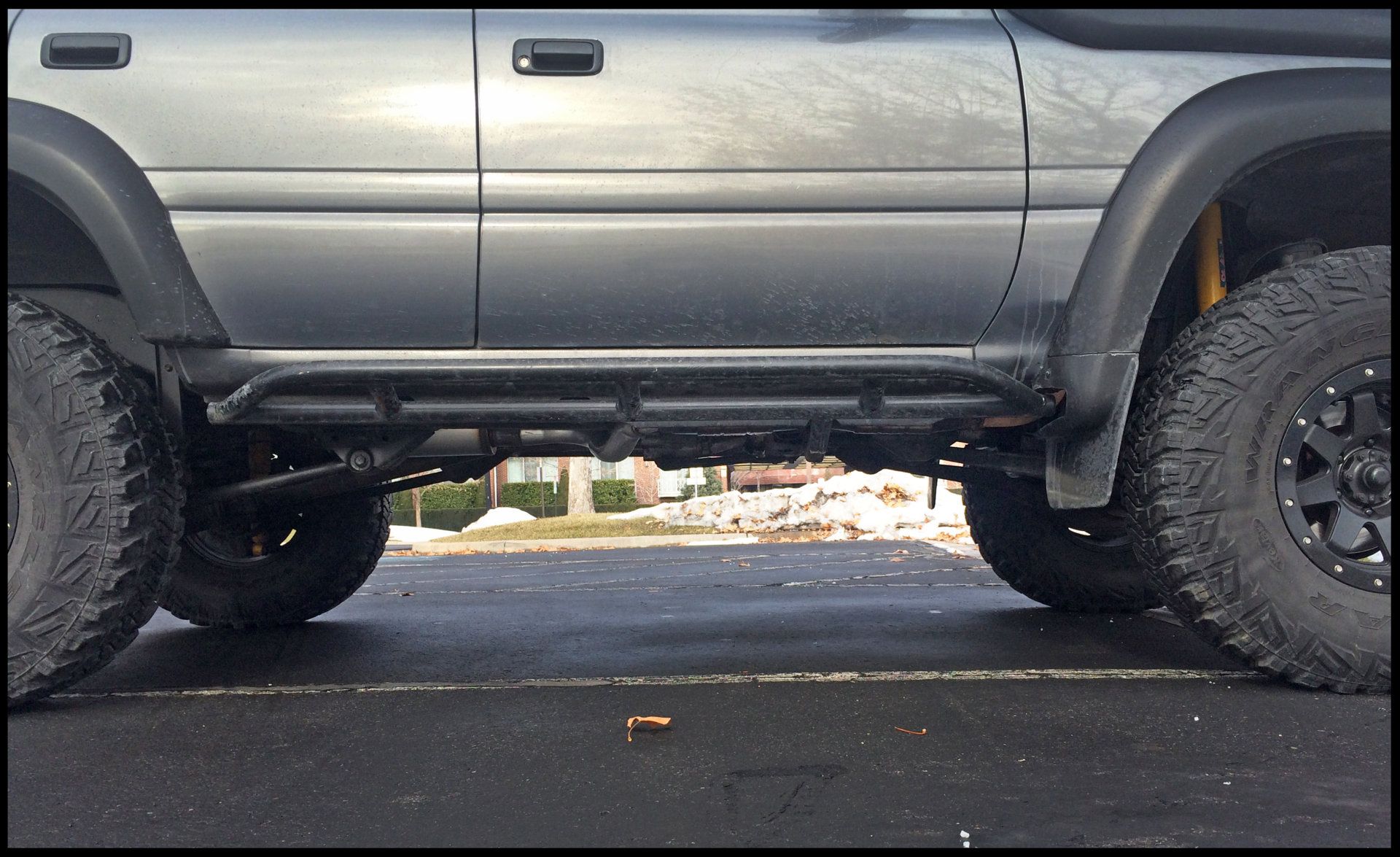

Here are a few I just snapped. Pipes are getting a little crusty now.
This is passenger side profile. The front edge of the stock muffler gets tagged once in a while, but mostly out of the way.
This is the rear passenger side exit point, looping over the rear frame rail and cut just above the rear bumper wing.
Cat protection plate. Bolted to a flange welded on the inside of the slider, to the IPOR skid plate, and a front stringer to a captive nut on the frame rail. Very stout.
