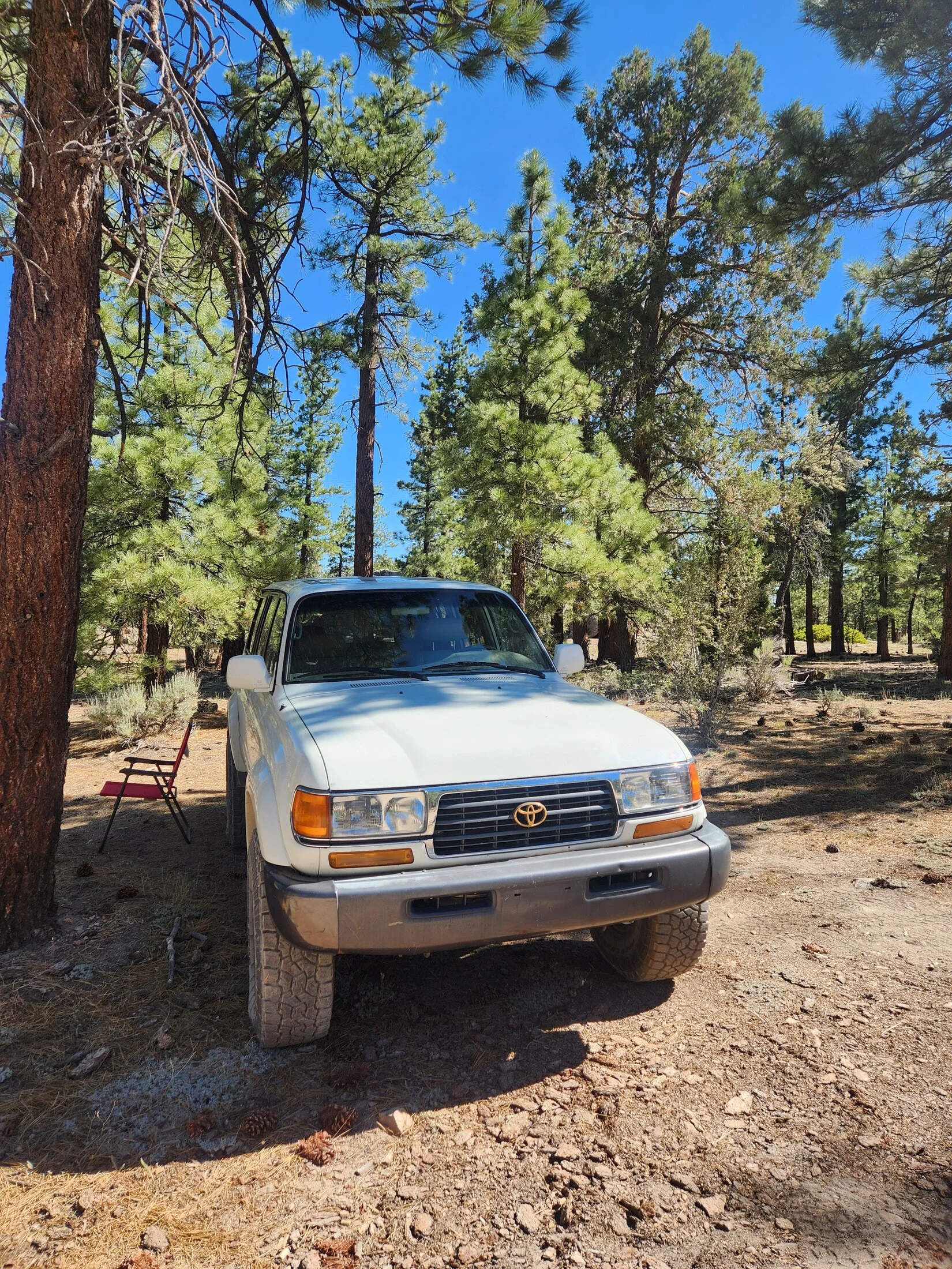

Same P0420? Interesting that your charcoal canister's been triggering that. I have the same pressure and hissing sound everytime i open my gas cap although my cabin dont smell like gas just yet. Might consider replacing that as well. Just got home from a daytrip at Holcomb Valley. So far CEL didnt show up. Although on my way up my temp reached 213F and my AC stopped blowing cold air i thought i was losing coolant. It was around 8am and outside temps maybe in the high 70s. I checked my compressor and the lines connecting to the evaporator (afaik) was iced up so i turned it off. AC was working fine the whole trip (2pm outside temp maybe in the mid 80s) back down to OC though.
