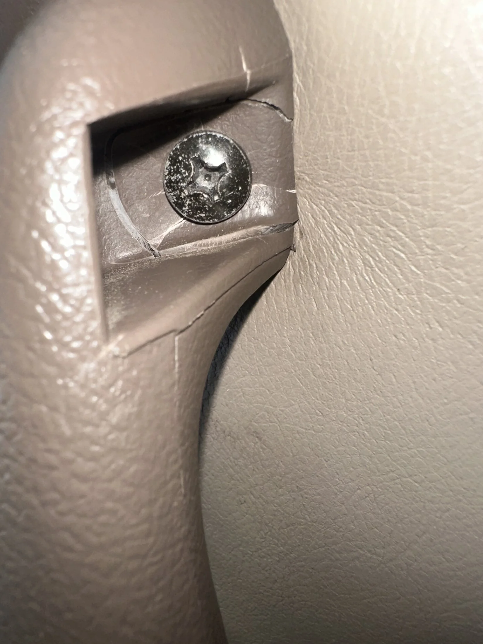

Inside door (pull) broke

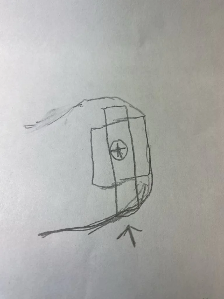

Well, in an attempt to avoid sourcing and buying a new door card and then the hassle of removing and installation I tried a fix. I used a longer screw with a washer that left the screw head and washer sticking out half way into the door pull cavity. I then packed the cavity full of two part epoxy. Hopefully the epoxy will bond to the inside of the cavity and also adhere to the screw and washer. It’s setting up for the next 24-36 hours. Fingers crossed.
Can you post up a photo of how you fixed it?

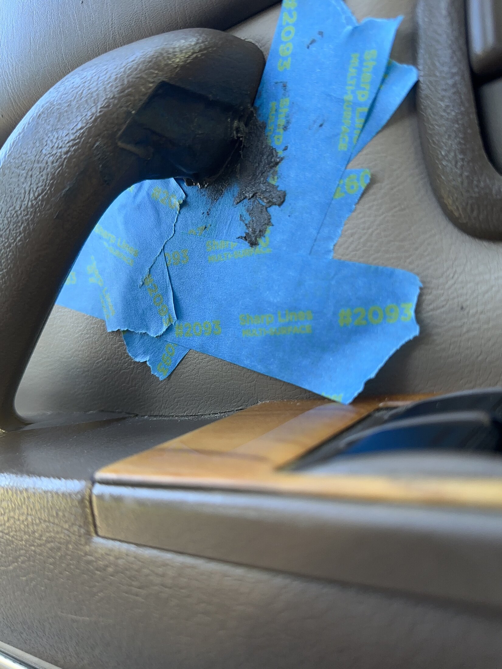

Here’s the fix. I’m letting it fully cure before clean up and removal of the masking tape. Time will tell if it holds. Again, I used a longer screw that extended into the cavity with a washer on the end to add surface area I don’t think you will notice anything due to the position of the cavity under the handle

So the epoxy was put over the screw head and washer (can't tell from the photo)?
I hand packed epoxy into the cavity, insuring it got behind the washer and engulfed the screw. Also by packing it tight I wanted to adhere to the sides of the cavity. I removed the masking tape an hour ago and it seems rock solid.
Well, it’s been over 30 days since I fixed the door handle with Epoxy. Ive used the handle to shut the door countless times each day, so I think it’s going to hold.
