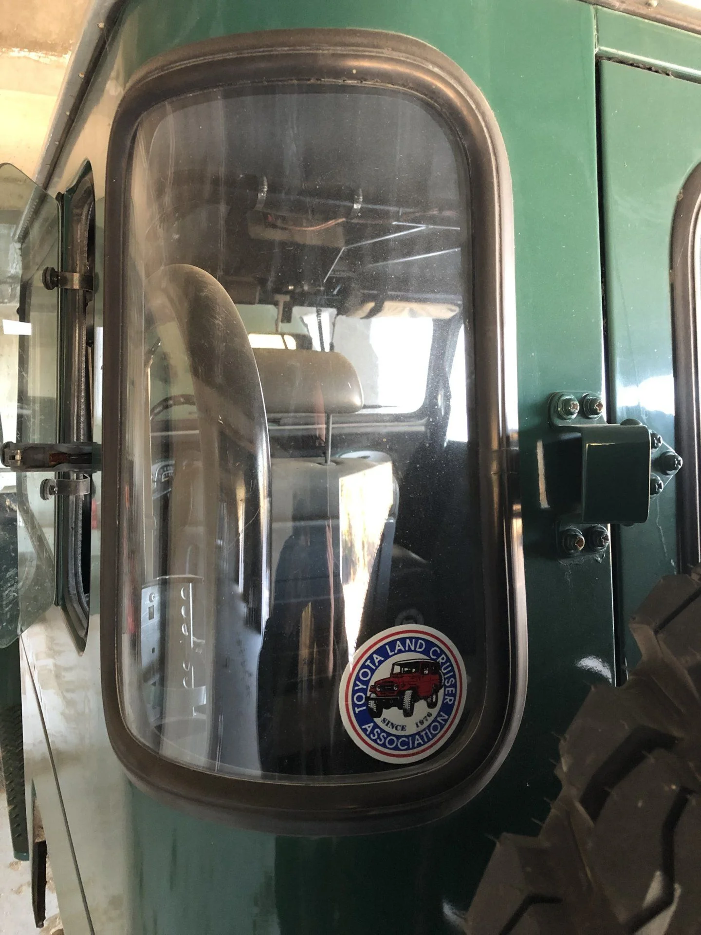

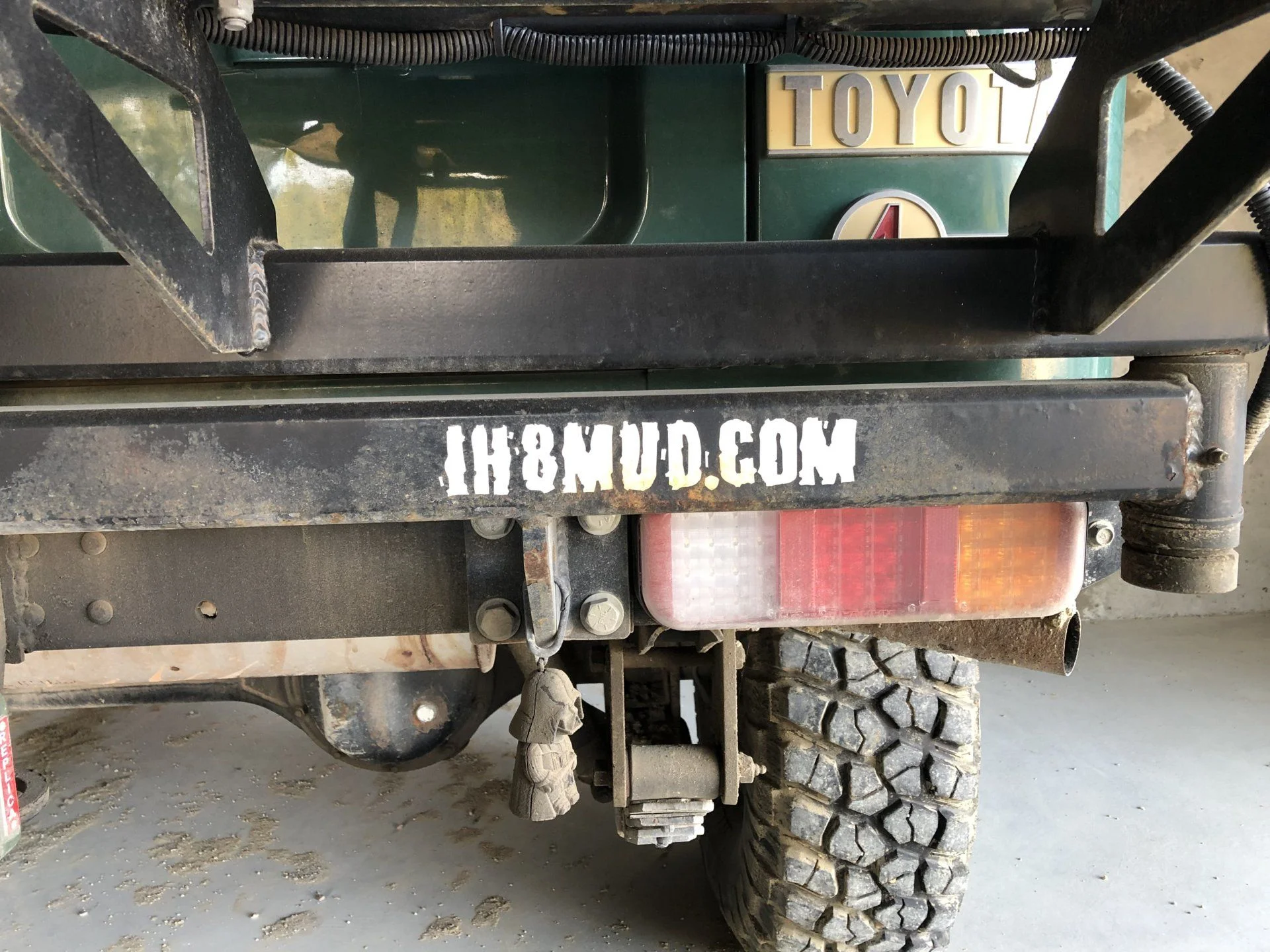

First thing I did was spray the hell out of the engine bay and undercarriage with 50/50 simple green and used a power washer out in the street. It was gross and I didn't get it clean enough. Next I sourced some nice vintage TX plates and got my classic registration. Also applied lagniappe.
