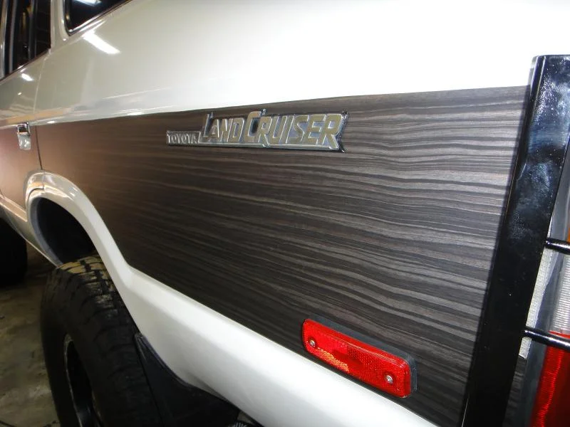

3M Di-Noc architectural wrap. Ebony metallic woodgrain.
Pssh, who would ever want wood paneling on a 60 series ;)
What can I say... You were my inspiration! I have always liked the look of your 60.
As for the wheels... trust me when I say the black is an improvement over the oxidized aluminum.
eBay was the best source. I purchased a 48" X 84" sheet and it came out perfect with one ( do-over door) to spare. Cost to my door was 230 iirc. Basically for my application ( no curves or complex surfaces), it is a peel and stick affair with some heat on the edges and squeegee for bubbles.
The cut outs were the hardest part. There is definitely a learning curve involved. This stuff is very forgiving to work with though and allowed for a bunch of lifts and resticks.

Very cool, do you have a link to purchase? Brown wood grain available?
Also, could you show a close up of tail light protector, and where you got it.
