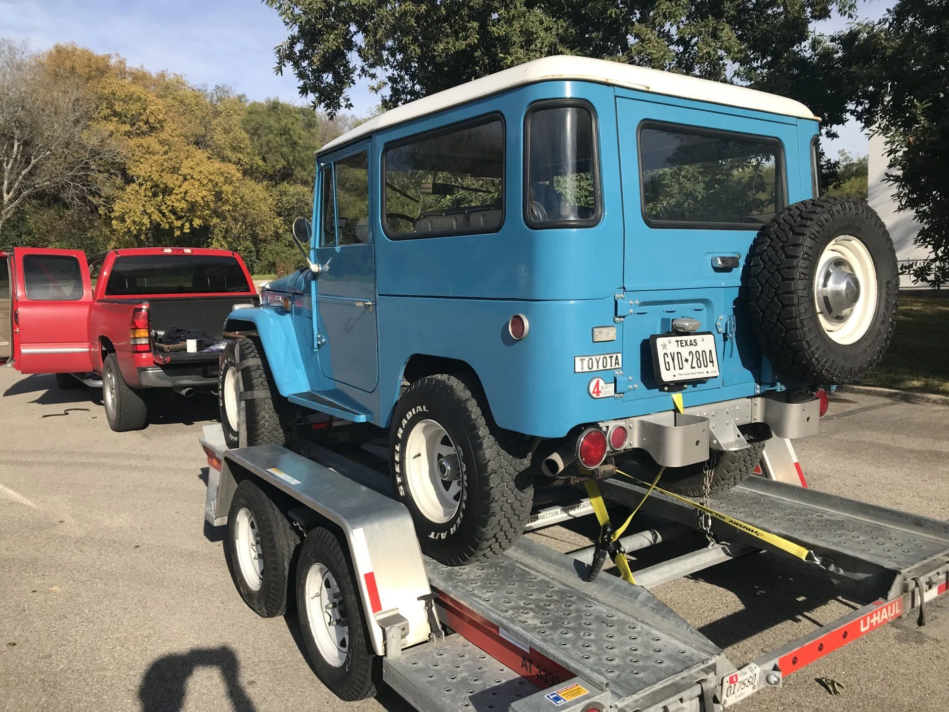

Here it is as bought and transported to Houston.

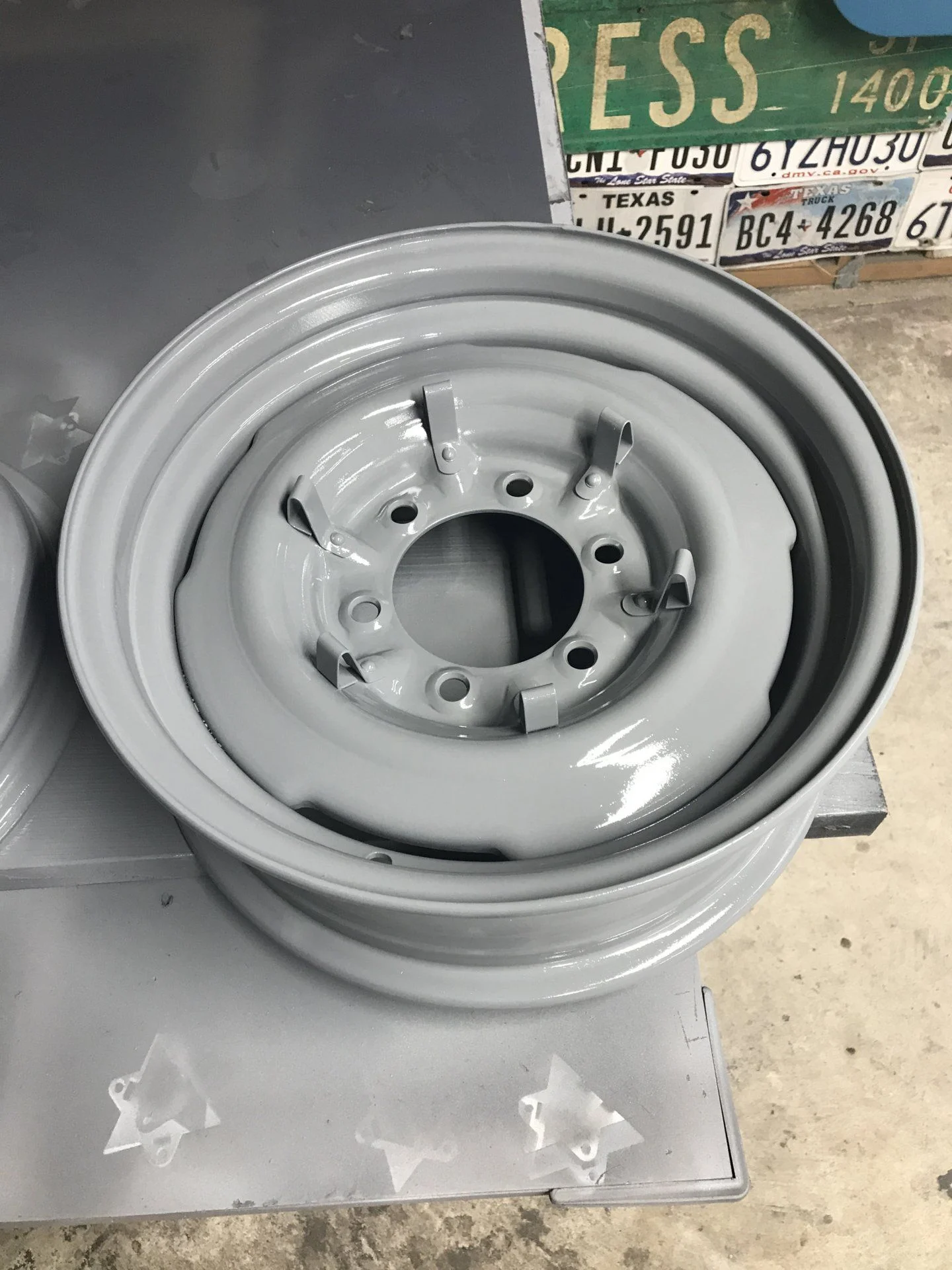

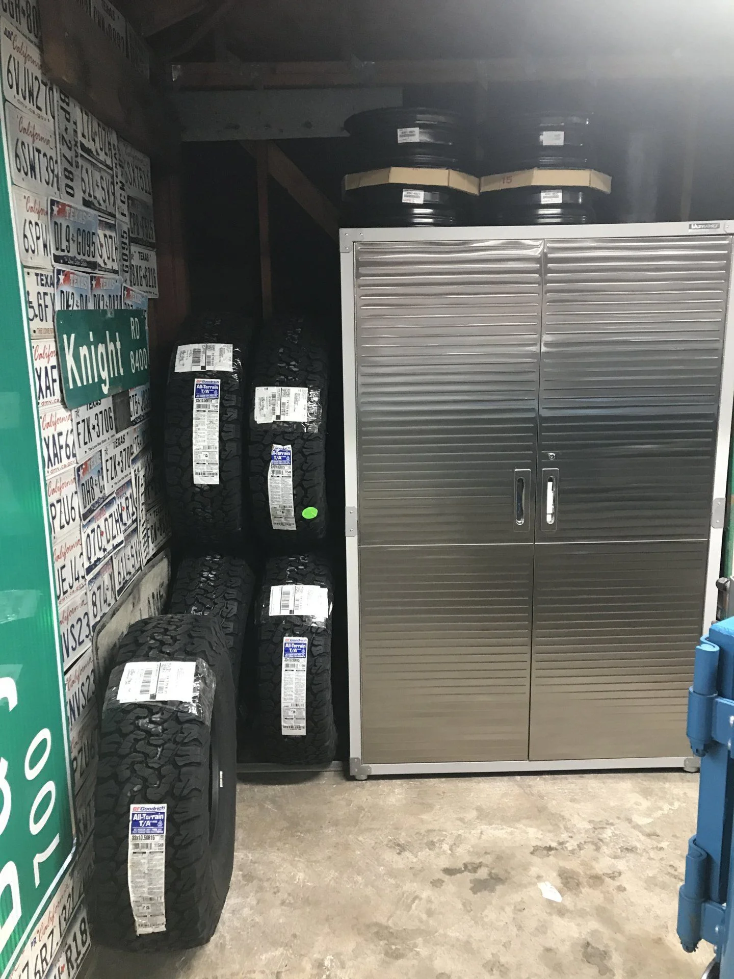

...and Christmas! 5 new BFG KO2 33/10.5/15s with 4 new stock steelies (came with a decent spare). Got them painted up today. Going to mount them maybe next week. 2.5" - 3" lift maybe early January. I've always done OME lifts but am thinking alternatives with the lighter SBC up front.

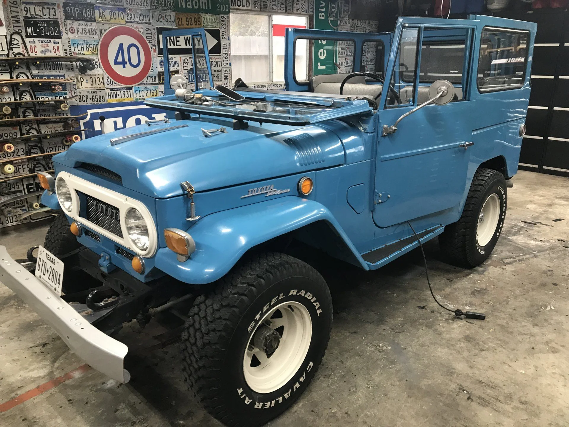

So it begins again. After the Silver 60 sold, I found this 6/69 Fj40 in San Antonio. It has a 350 conversion mated to the stock Toyota 3spd. (WHY????) I am really not a fan of conversions as the wiring is always messy and it is always a treat to see the variances in workmanship on swaps.
I bought this because the paint is 10+ years old (some crazing in paint and some small areas of rust) and hiding very little. Just enough rust to believe it is telling you that that is all there is! Original floors with all captive hardware. Never had a rollbar (only holes in the floor are for the jump seats)! Frame is perfect! Dash is complete and uncut. It was painted a year incorrect Sky Blue but it is growing on me.
The top will need the most work resto wise. Sides and hatch are good but the cap will most likely need a new drip rail.
Here it is as bought and transported to Houston.View attachment 1863154

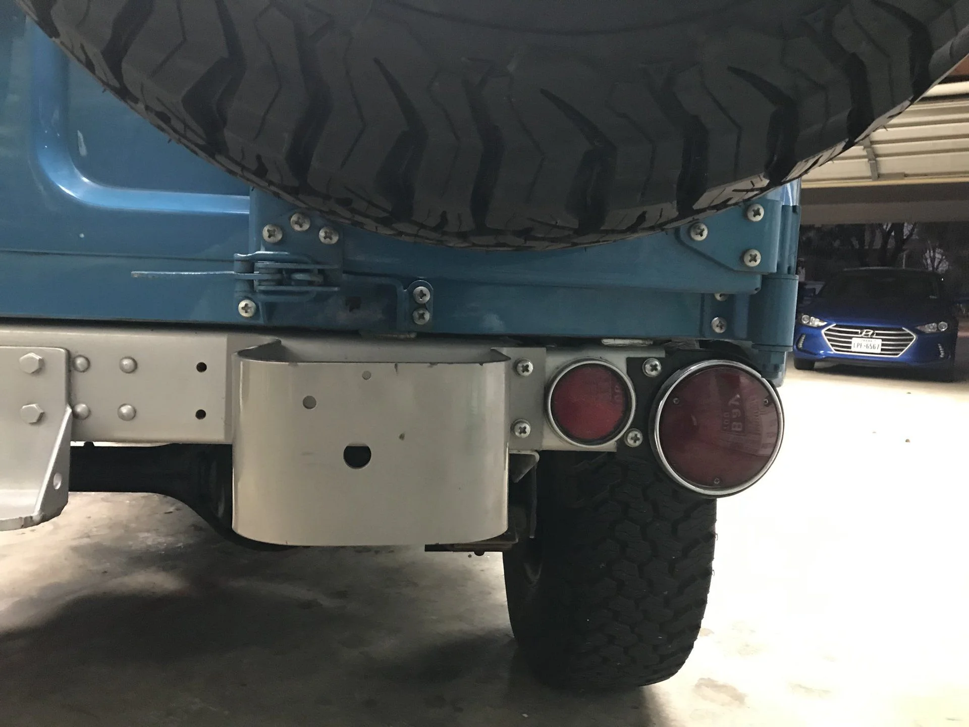

...also on the list of things scratched off the list already include: Backdating the signals to round style (preference) and new bib lights. Also a new dimmer switch and windshield knobs.

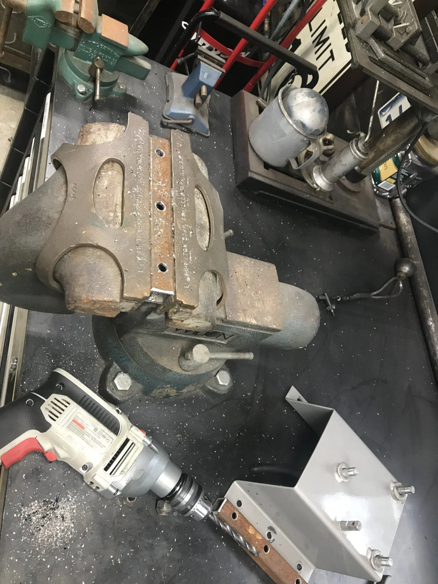

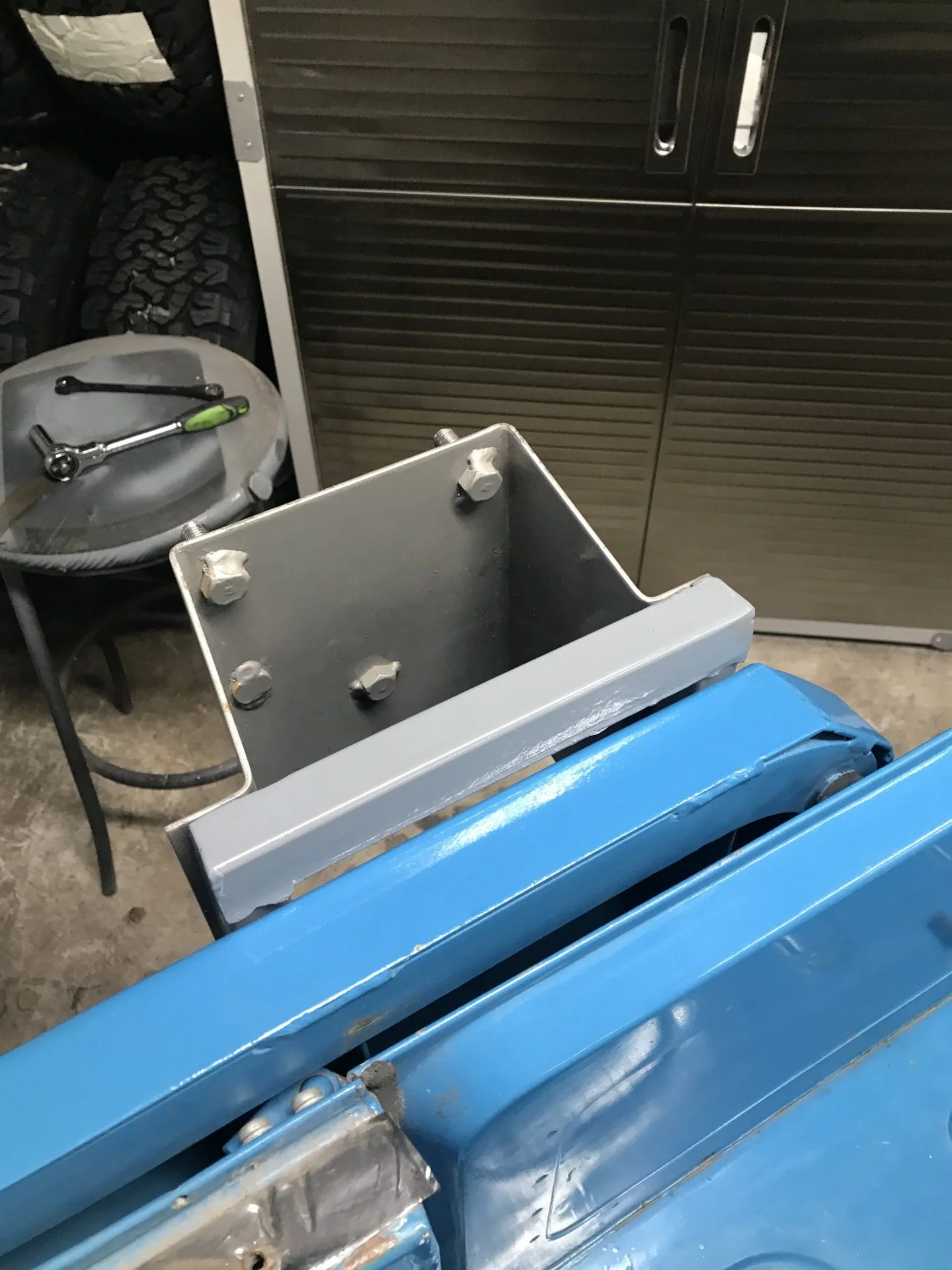

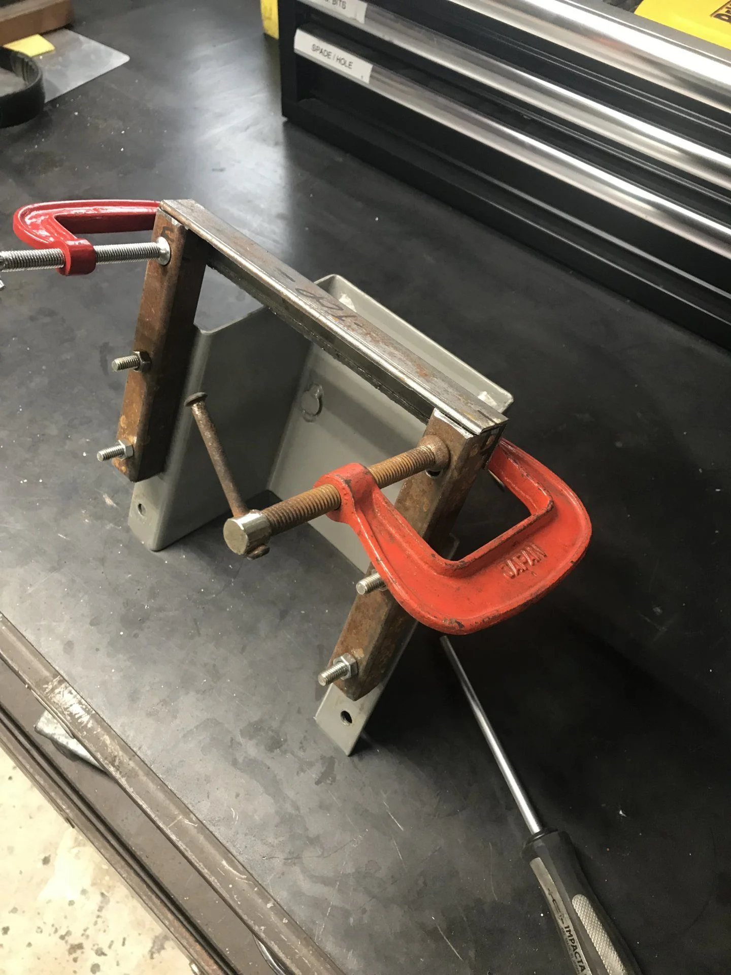

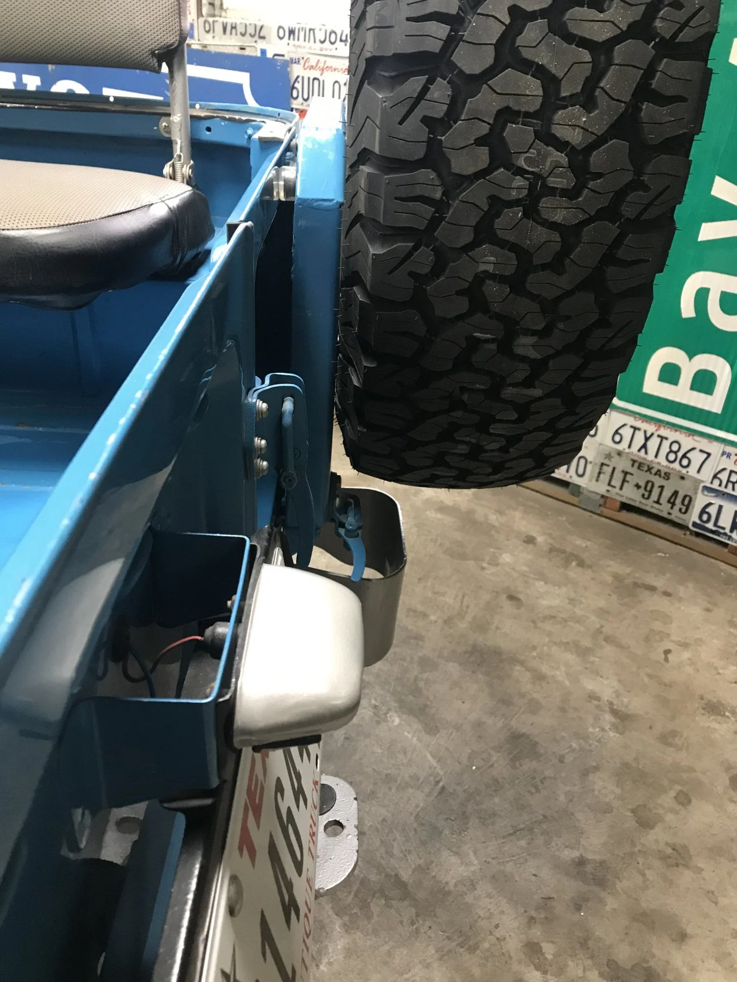

Made me a spacer to mount 33" tires on stock carrier. (thanks @POTATO LAUNCHER ). 1" square tube with a piece of 1" angle across the top. Had to also move it up to clear the latch. Looks good as far as clearances. Going to road test it for a week and see if it needs anything else.
You should just use a spacer to mount oversize tires. Way easier and cleaner.. Just my .02
I did think that a spacer would work to move out past the hindges. But a spacer wouldn't help to move it up to clear the latch. This was admittedly a LOT more work and hassle BUT it was free and any excuse to weld something up is a good thing in my book.

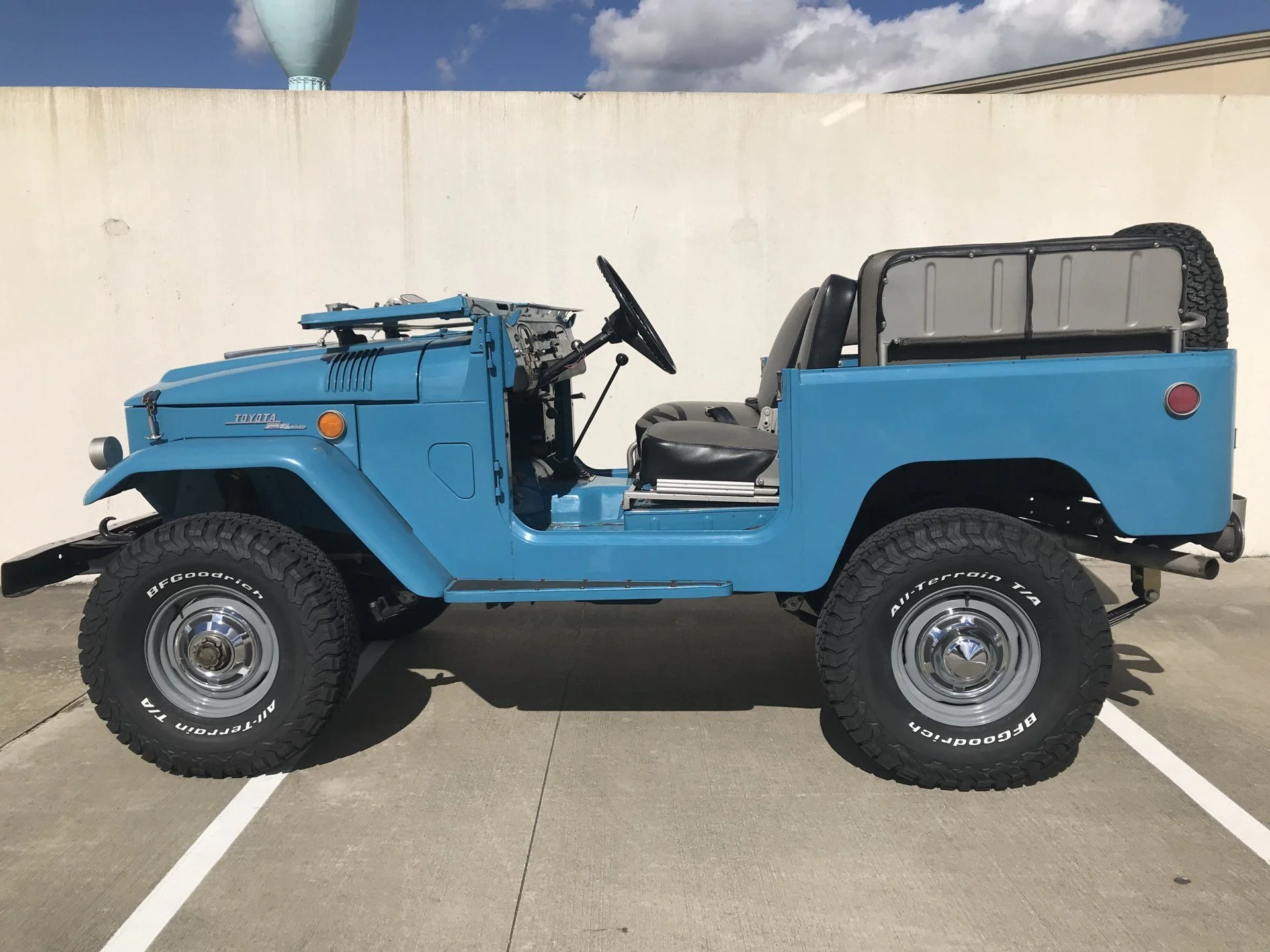

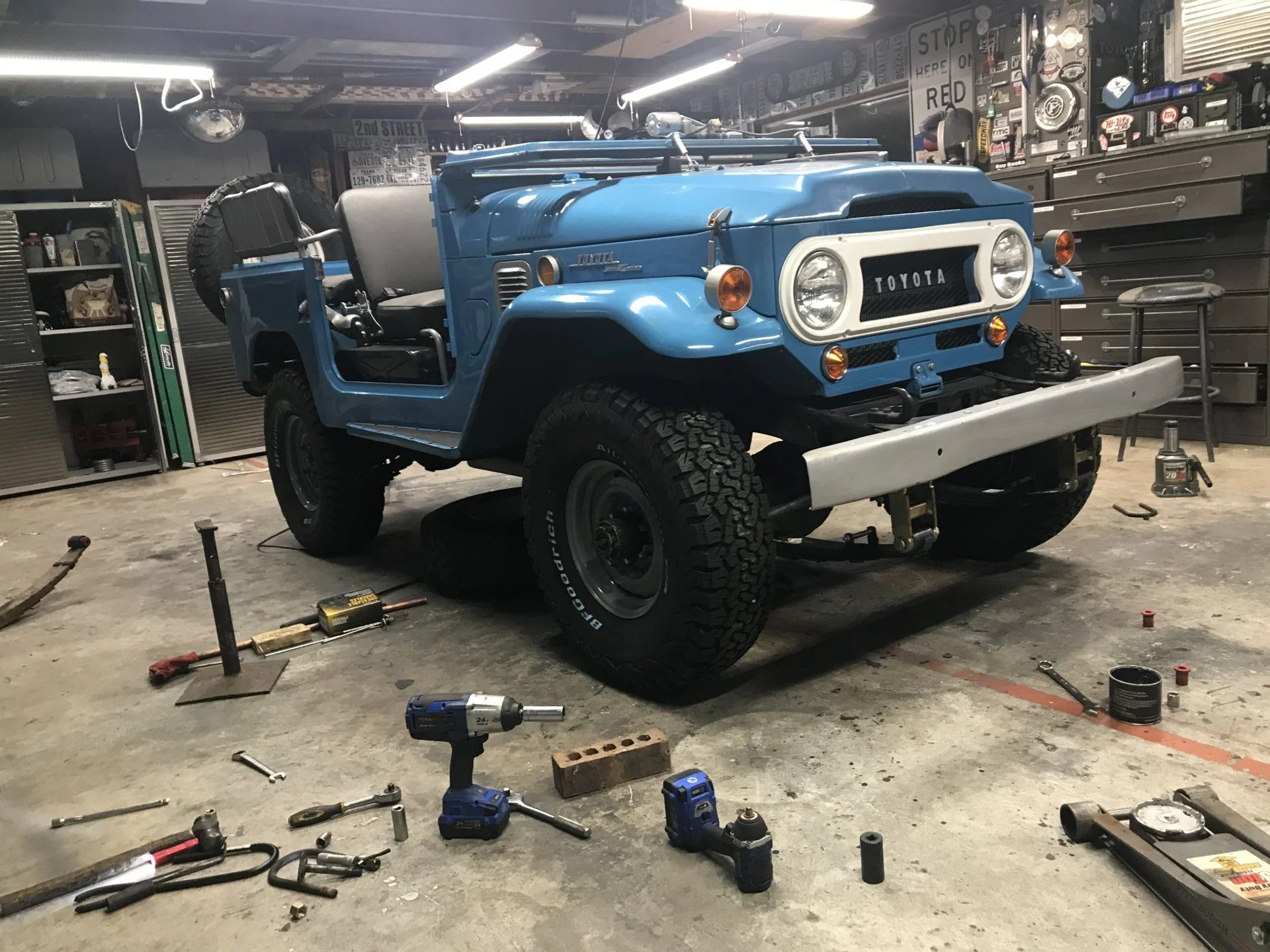

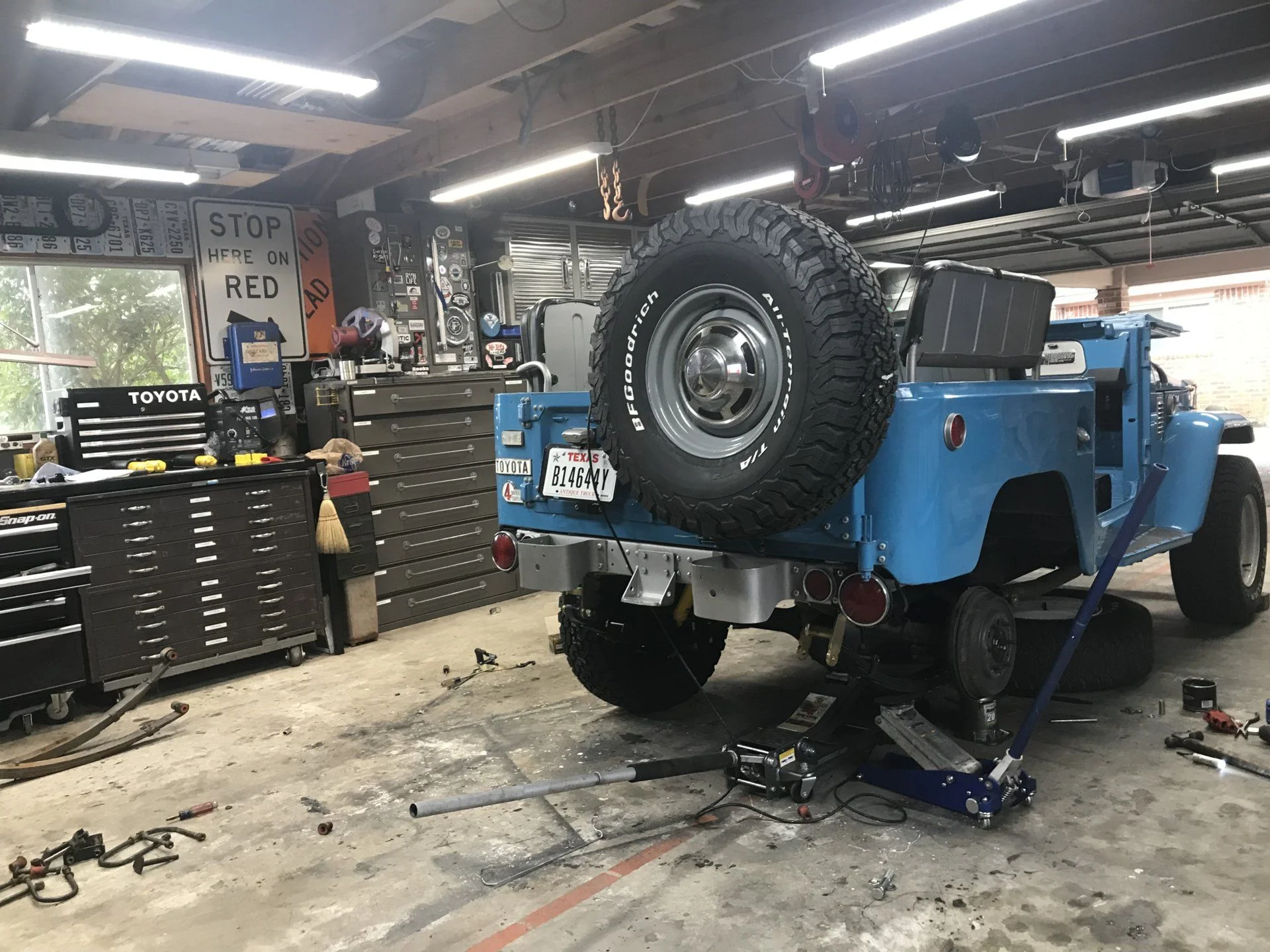

Put a lift on her. OME (light) with HFS 2.5" shackles. BFG 33/10.5 on factory steelies.
1899770
1899772
I love the look. I've done 5 or 6 lifts (all OME). This is the first time I paired it with the HFS shackles. I am a fan of the one piece design and multiple sizes. This girl is TALL!

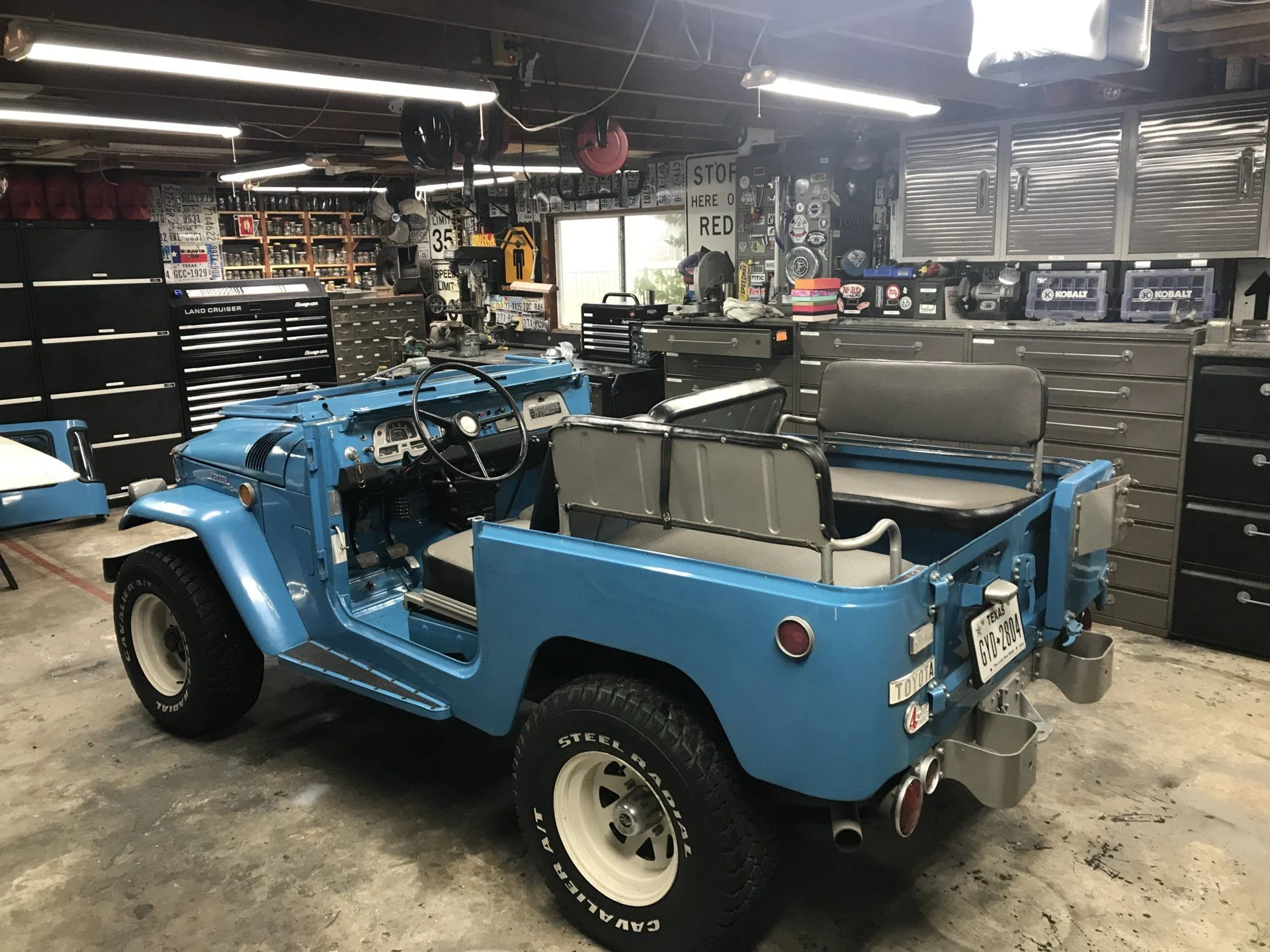

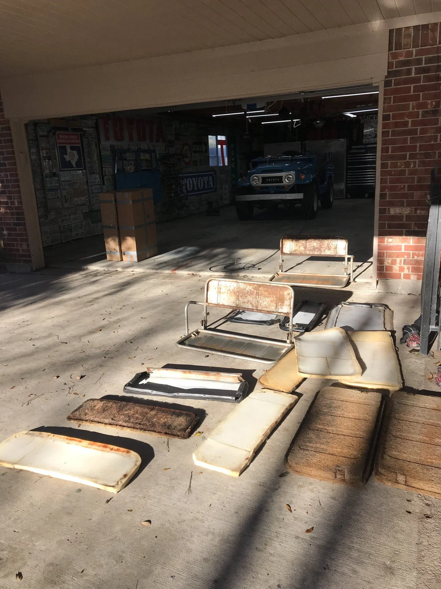

...also tackled some missing pieces. This 40 came with 2 driver side jump seats. One was the correct straight edge, two hole mounting tabs and feet. The other was a 72-74 slant edge design. Found a cruiser yard in Wisconsin (he hasn't heard of Ih8mud YET!) and bought a set. needed to be cleaned up a bit.

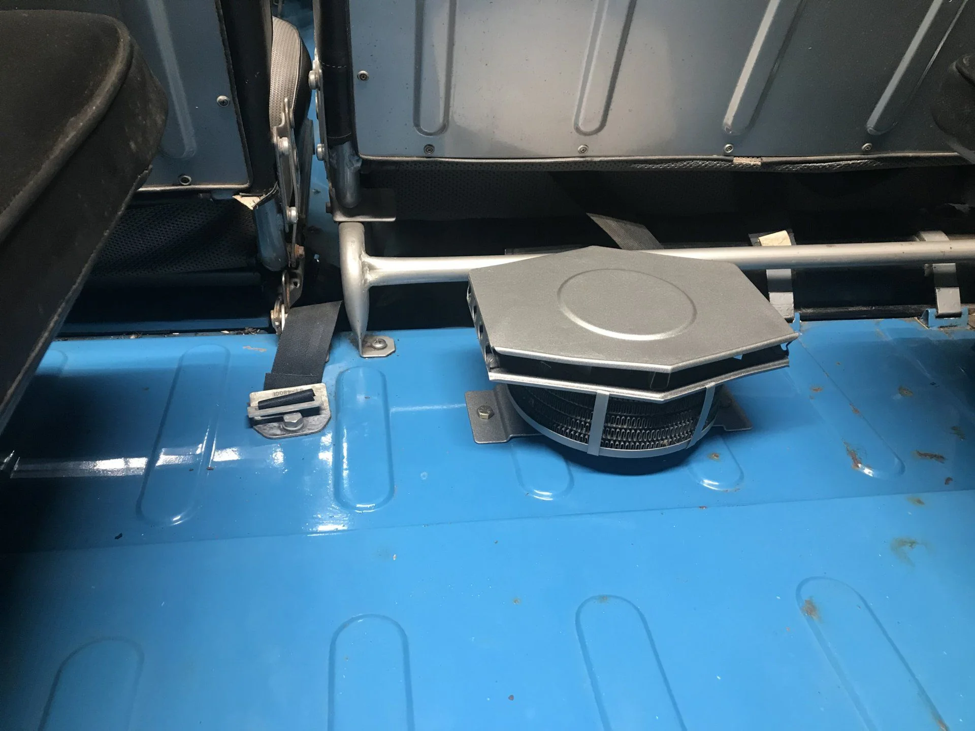

And Brad from WI came though again with a rear heater!
