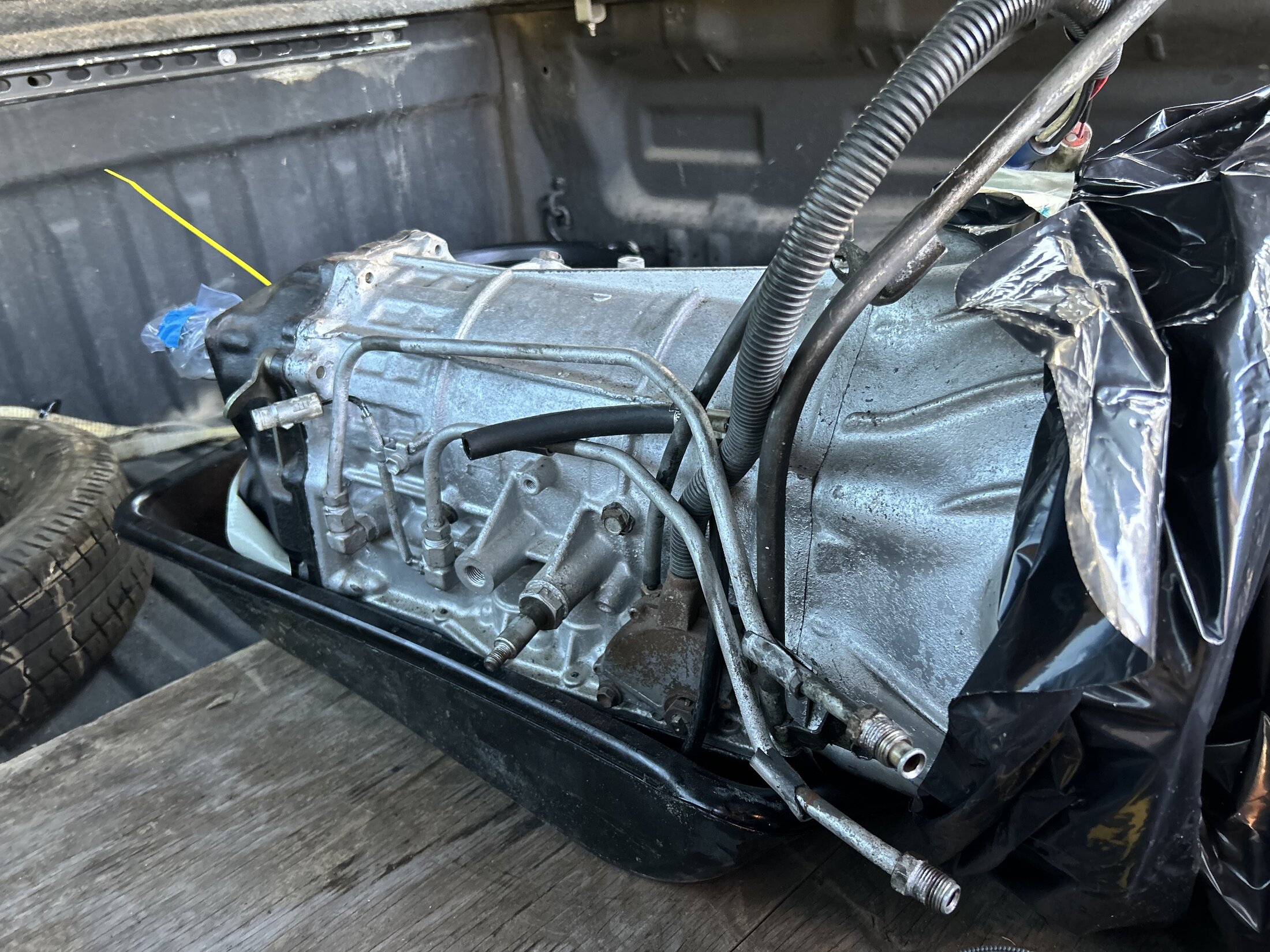

There is approximately less than 1,000 miles on this transmission.
I’m unclear as to why it was rebuilt, just that it was.
It is my understanding that torque converter was rebuilt/replaced. It certainly looked fresh.
Thought I had a pic of the TC.
I would not be happy.

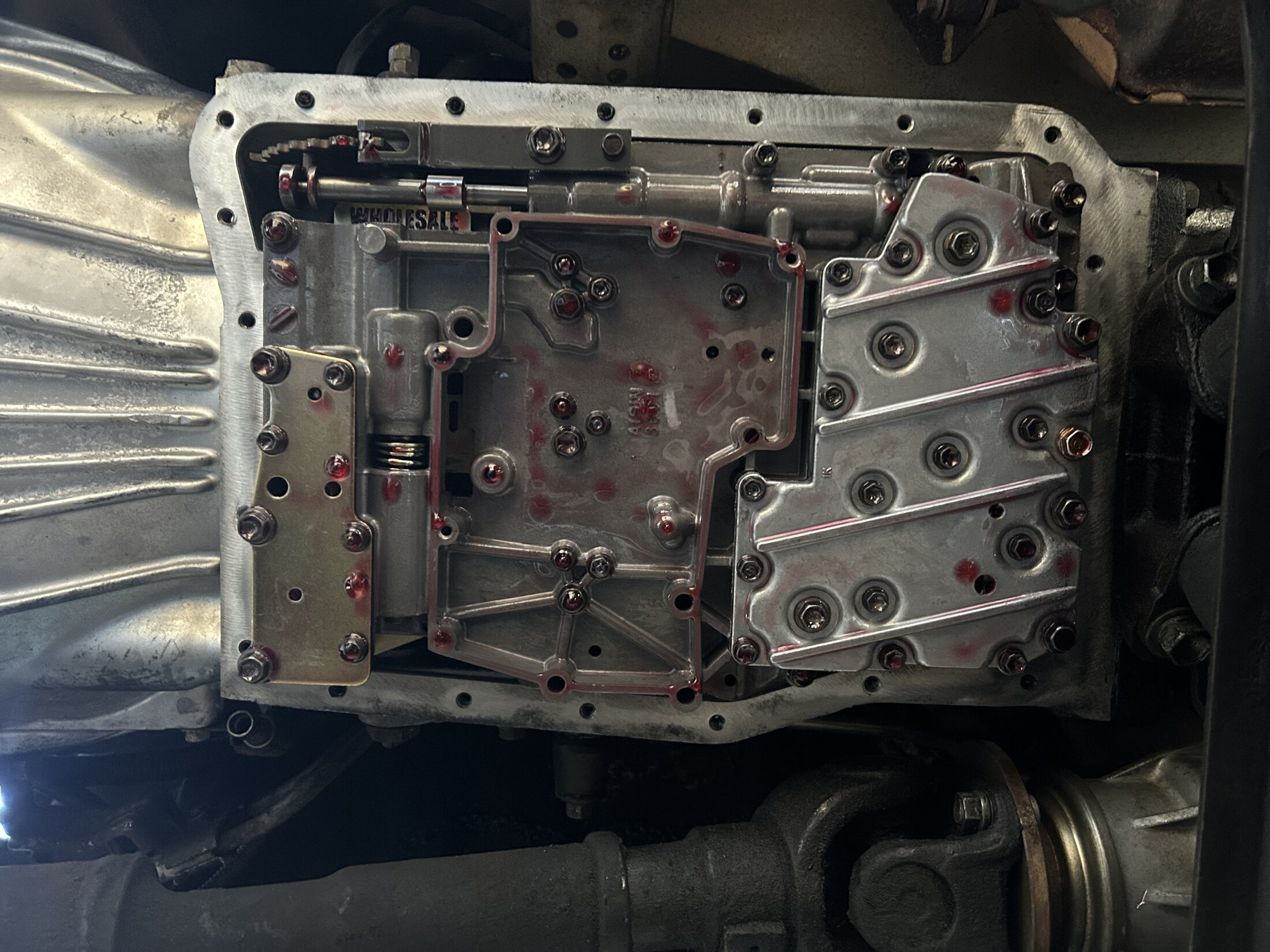

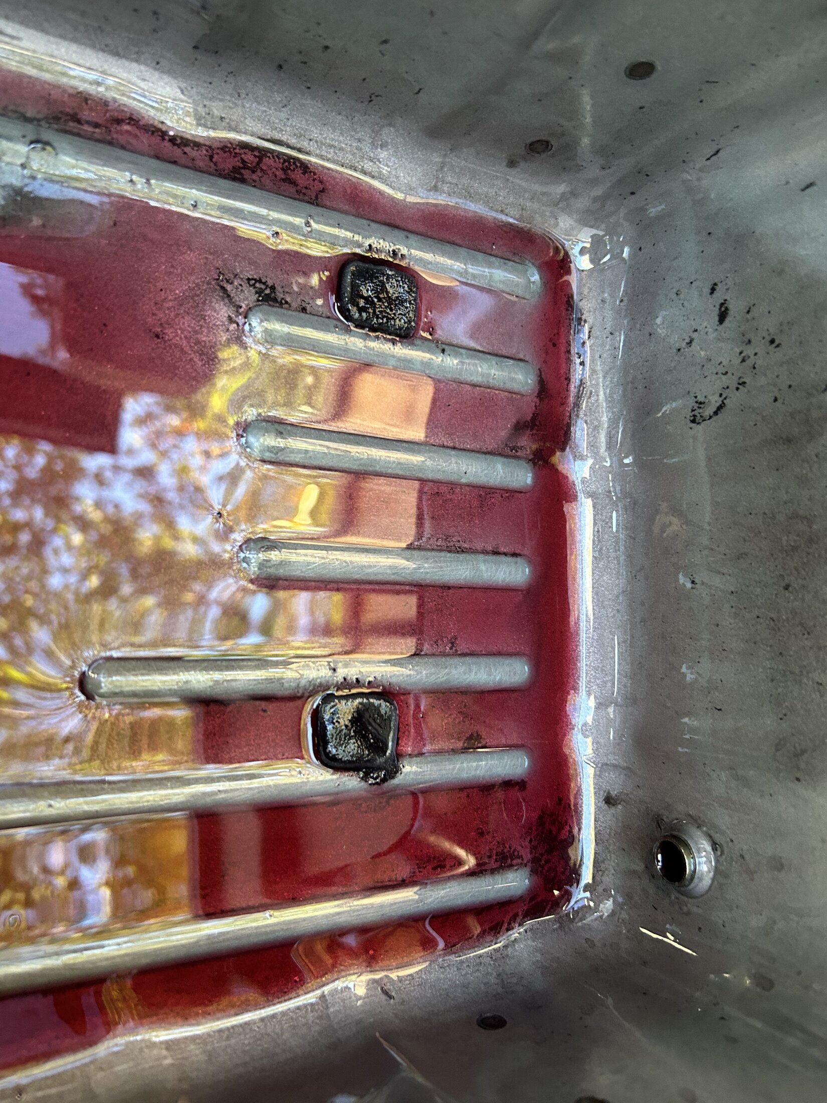

Drained and dropped the pan and screen/filter. More fines on the magnets than I would like. Filter is clear of clutch material and pretty much doesn’t even need to be washed.
I keep coming back to: Is this dumb luck or is there a common issue with the truck causing it to eat transmissions?
Truck has 164k.
BFG 32”
Last tranny gave very little indication prior to crapping the bed.
Ugh…
No, you were screwed on the rebuild. Or whoever paid for it was. That's too nasty for a 1000 mile transmission. It should still be clean.
My guess is that whoever did the work just replaced the clutches, if indeed they did that, and never bothered to clean the parts as they should have. There was also a problem somewhere that wasn't addressed, which is why it's failing to shift.
