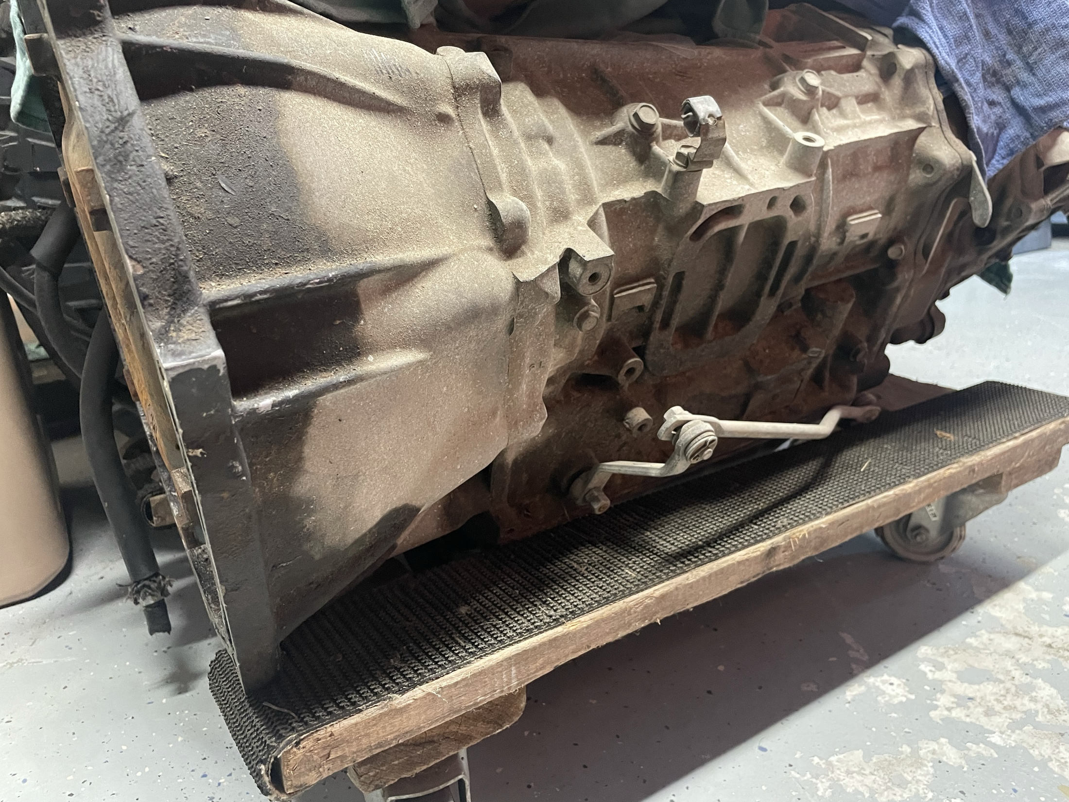

I am wading my way through the A440f manual. Riveting stuff. Trying to align the nomenclature so as to identify the individual parts I am attempting to diagnose.

Assuming we've diagnosed it correctly, it's the TC lockup clutch that's not engaging. I'd look for anything related to that in the manual.

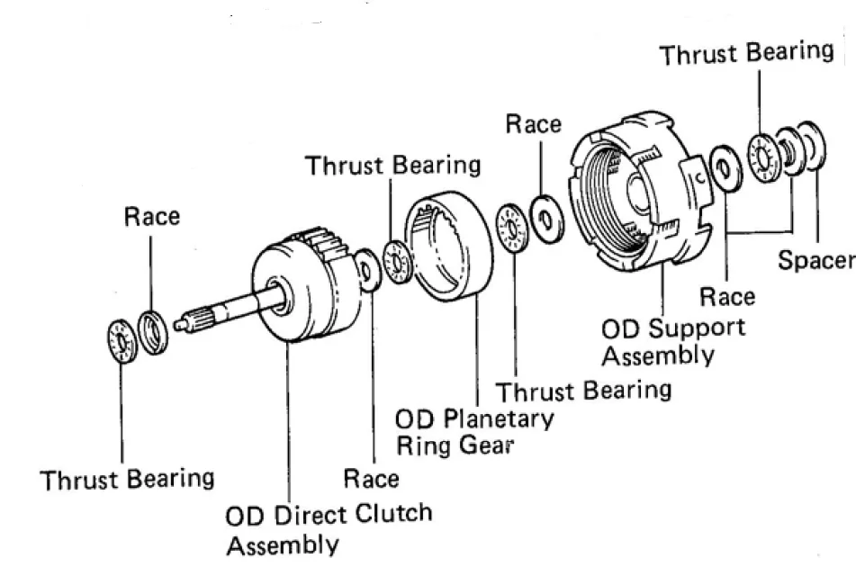

For reference, this is what the overdrive set looks like:
Like all modern automatic transmissions, it's comprised of several planetary gear trains, each having a central gear (referred to as a sun gear), usually mounted on a shaft, but sometimes cut onto the shaft, onto which rotate and engage with several (usually 3 or more) gears (referred to as planet gears, hence the name), which themselves also engage with and rotate within a ring gear. The ring gear also has a reaction arm of some type (referred to as a brake in an automatic transmission) to either allow it to rotate, or prevent its rotation. The planets gears further have a link between them (known as a planet carrier), which serve to cause them to rotate equidistantly apart (so they don't run into each other, and so they equally support the load placed on them).
There are various combinations of rotation allowed for in this design, which is why its so popular (and a true PITA to design). Either the sun can rotate, or not, the planets can sit in place and rotate, with respect to the ring, or the can roll around the sun and rotate, and the ring can rotate, or not. Or any of several combinations of these motions are allowed for.
Within these sets of planetary arrangements the designers have placed clutch discs, which are keyed to rotate with the central shaft of the train, and are interleaved with reaction plates (commonly referred to as steels), which are keyed into the case to prevent rotation. The clutches and steels are further allowed to float axially, along the central shaft's axis, unless they are clamped together by a hydraulically operated piston, at one end of the stack.
The purpose of these clutches is to clamp the various planetary items together, or not, to provide working combinations of gear engagement. Remember, they are stuck onto the central shaft, along with the sun gear. The ring generally has a band clamp around it, which is also opened or closed via a hydraulically operated piston.
Now you know, in theory, what is supposed to happen when a gear is "selected" or called for by the hydraulic program. IF any one of the items in the train doesn't move, or stop moving, when it's supposed to, that gear doesn't "get made".

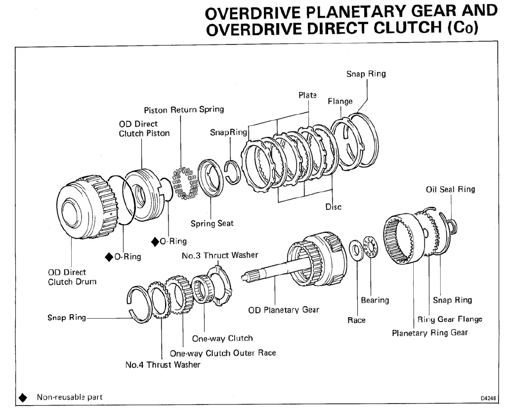

Now that you have the background, here's the OD system:
Starting from left to right,
the overdrive drum serves as a reaction plate for the overdrive piston, which clamps the clutches against the steels, and as a hydraulic reservoir, of sorts, for the piston;
the piston return spring's purpose is to remove the pressure on the clutches when they aren't engaged, so that they don't wear prematurely;
the clutches and steels serve to clamp the gear train and the flange and snap ring are the other end reaction members against which the piston pushes;
the one-way clutch provides a second means of selecting the various planetary gear items to "make" a gear ratio;
the overdrive planetary gear and the attached carrier with the planets, and the ring are what actually drives the wheels.
This is why I can't see anything in the OD set being the cause of your problem, because all that's happening is sliding along the axis of the central shaft, or not, and rotating, or not. Anything that would prevent that would have been obvious to the rebuilder (and, again, I'm giving him the benefit of the doubt here) and, presumably he would have replaced the bad part(s).
The function of the valve body is simply to send fluid to the proper piston in the gear trains so that the required gear is available, based on the output shaft speed.
