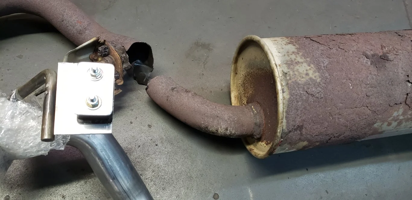

Now she's in need of yet another muffler as the case is falling apart :bang:
Needless to say, Bosal quality is pure sh!te :meh:

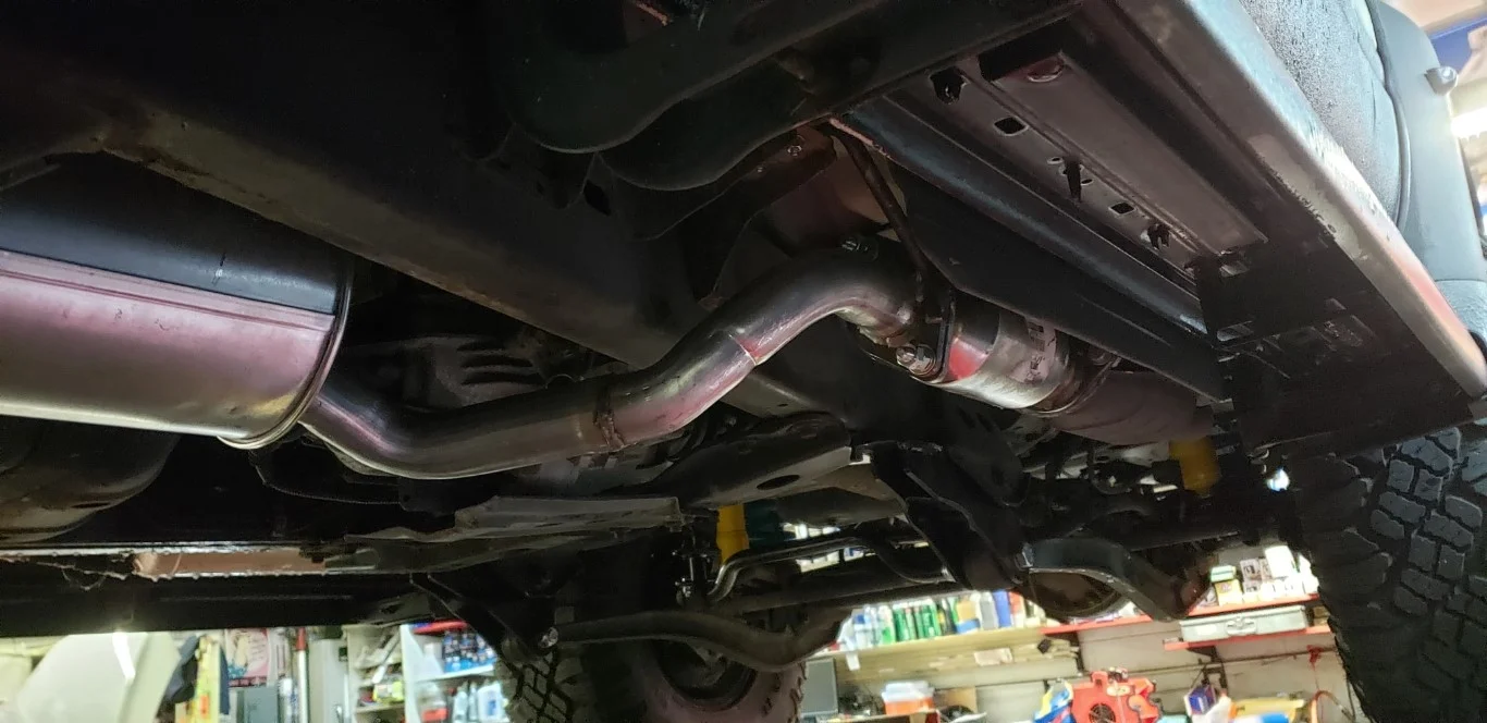

I’m running the Walker 4 years now. I think I got it at Summit. It’s quiet and fits perfectly. I’m on the west coast so it will last a good while but, iirc, you run up and down the East coast where winters see road salt so stainless steel might be the best way to go for you.
The main thing for sound is not to go big on the pipe size and go as big as possible on the muffler size. I custom built a 2.5" mandrel bent cat back with a Magnaflow straight thru perforated muffler that's like 3' long, barely fits in the stock location and goes over the axle and dumps at the rear bumper. It can barely be heard at idle and has a decent sound when getting on it, not loud at all.
I've built custom exhaust systems for other vehicles and the same applies, use pipe size appropriate for your power level (charts found online) and get the biggest muffler you can fit. Bonus quiet if you can fit a chambered style and a perforated style together. My Yukon has that and even with headers is pretty quiet and drone free for the family road trips.
Check craigslist for someone who did a cat back system on a full size truck and is selling the muffler. You can often find almost brand new OEM mufflers that will meet your needs.
I run the Walker quite flow. Not same size as stock but close. Easily fits in the stock location. It's pretty quite.
Walker Quite flow SS muffler (summit racing PN WLK-21481)

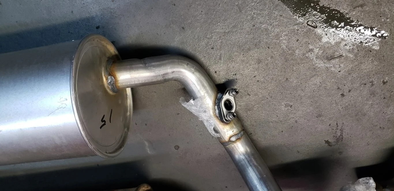

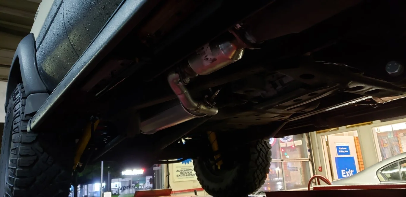

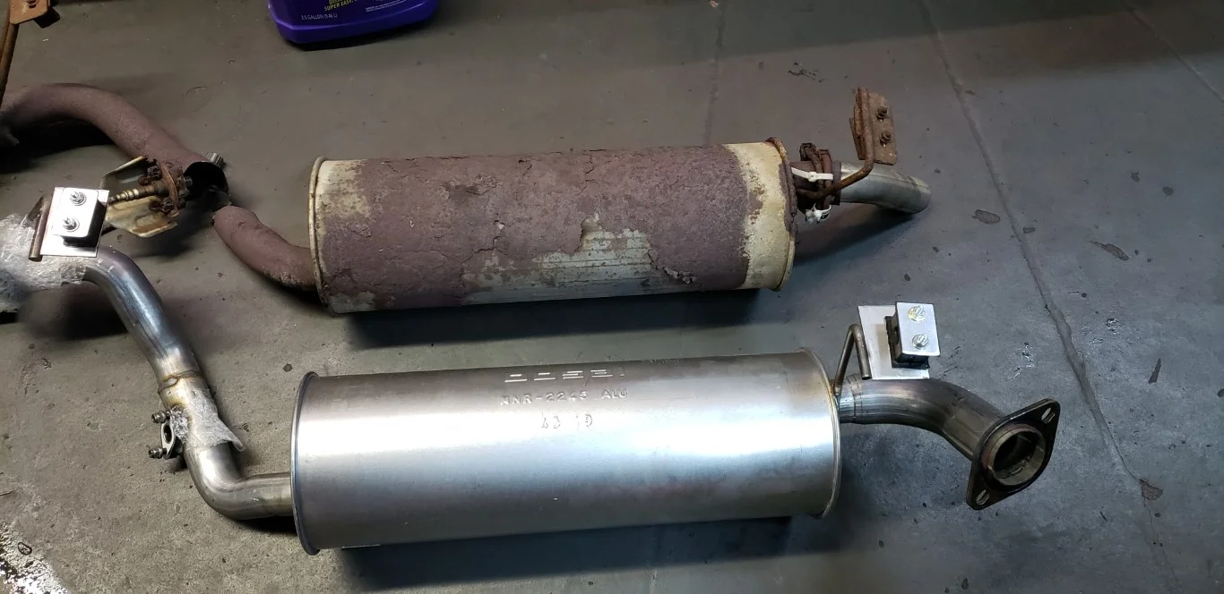

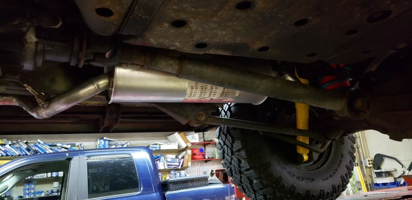

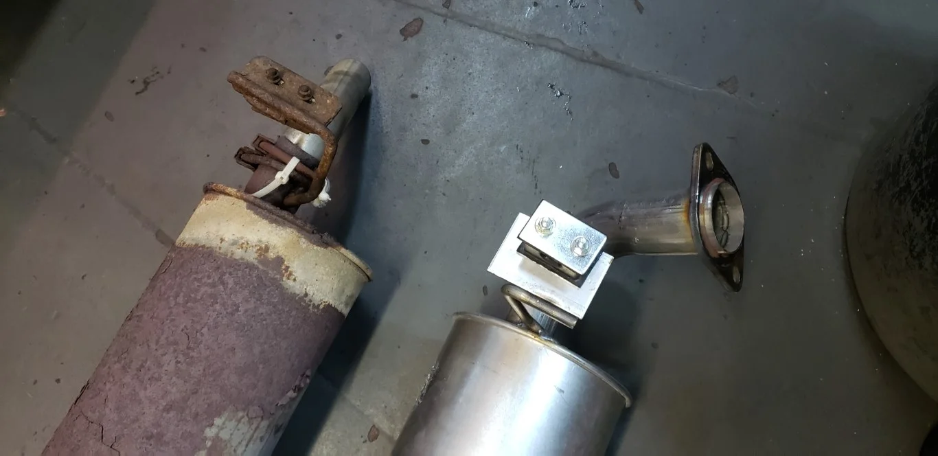

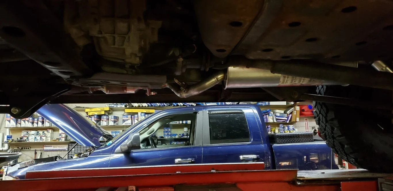

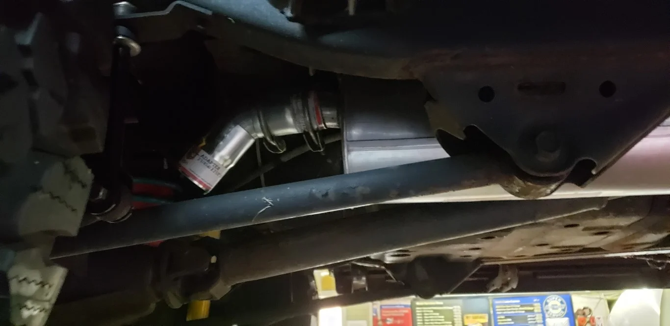

I actually went back to another Bosal muffler and cat
The quality looked to be much better this time around (everything fit without tweaking and the cat was spun instead of flat)
Not as quiet as stock, but no complaints

Sorry been away from the computer for a couple weeks. I've had it on more than three years now and its still going good. I built a custom exhaust from the downpipe back when I added the Walker. It generally follows the factory routing except it passes over the frame instead of under it. You can see what I did in the link in my signature.
