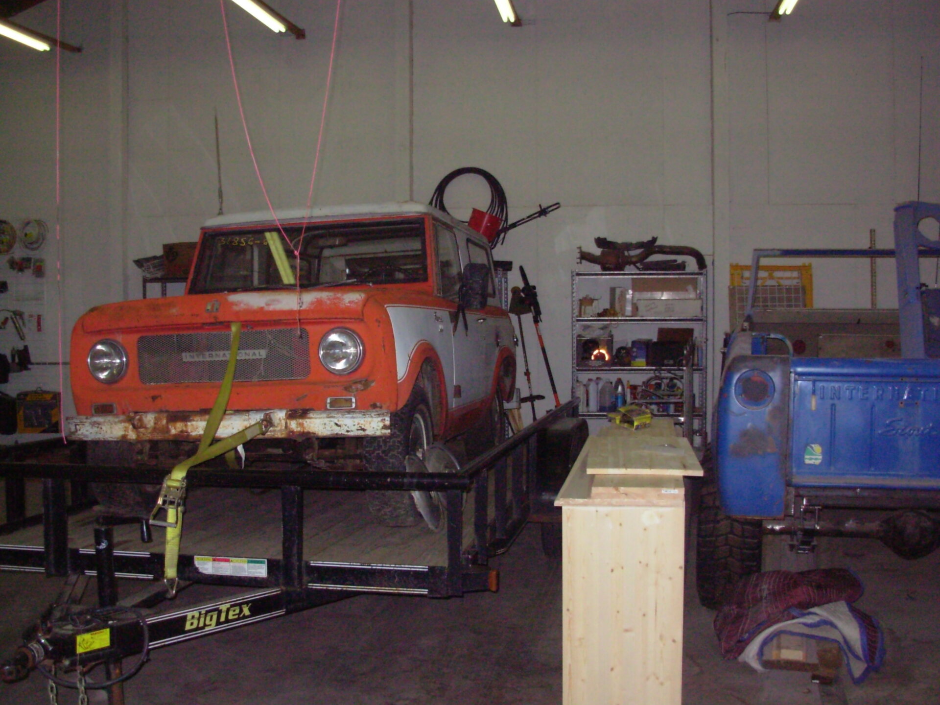

Hey all you Scout guys! In addition to my 80 series Land Cruiser I have had a Scout project that I am working on for longer than I care to admit. It seems I am drawn to oddball off road vehicles. Over the years I've replaced a lot of the rusted sheet metal and gone through several different iterations on the drive train. Originally I wanted to put an Isuzu diesel in it but found that adapter parts were hard to come by and gave up on that idea. I've since settled on a 5.3 chevy with a 4L60E trans and Atlas 4-speed. Decided tried and true was better in this case. Have gone from 3/4-ton to 1-ton axles and finally settled on some Super Duty Axles from a 2005 F350.
Work on the project will still be slow but I am finding more motivation to get after it again. My job is crazy busy right now which is bad for free time, but great for money, so I am buying and stock piling parts for the build. Going to post a bunch of pictures of the work I have done so far and then keep this thread going. Look forward to seeing what others are doing on their Scouts and any feedback you all have for me.
Here is a picture of the two scouts I picked up to mold into one:

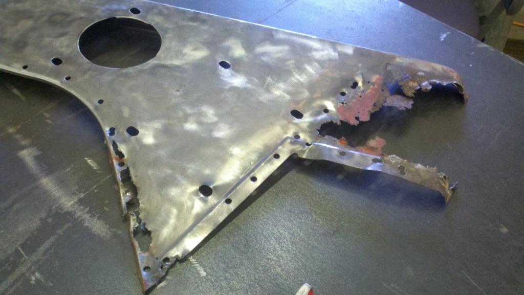

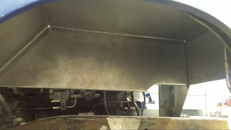

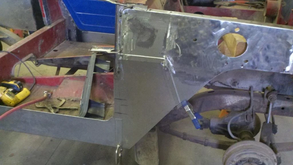

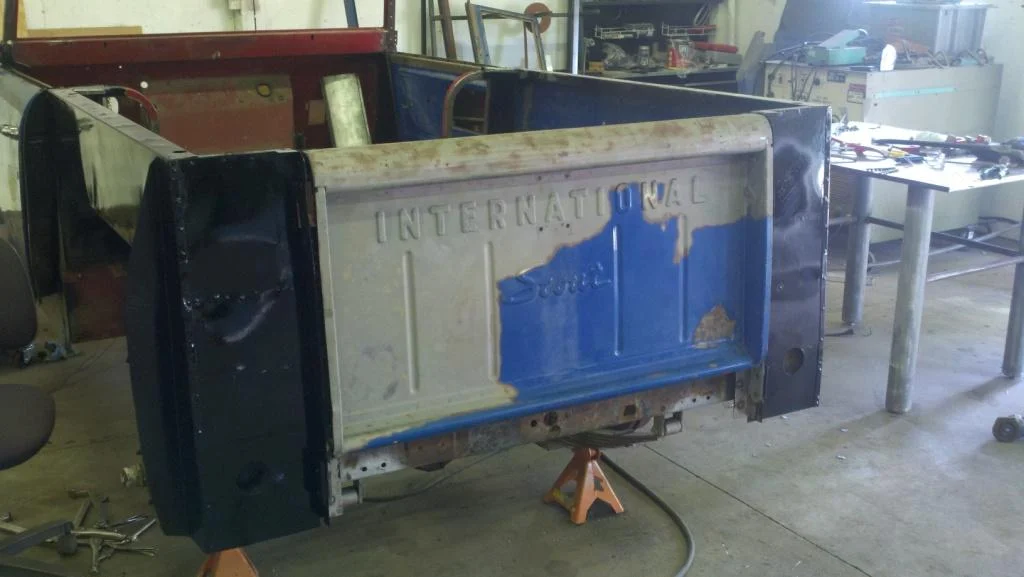

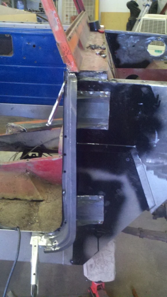

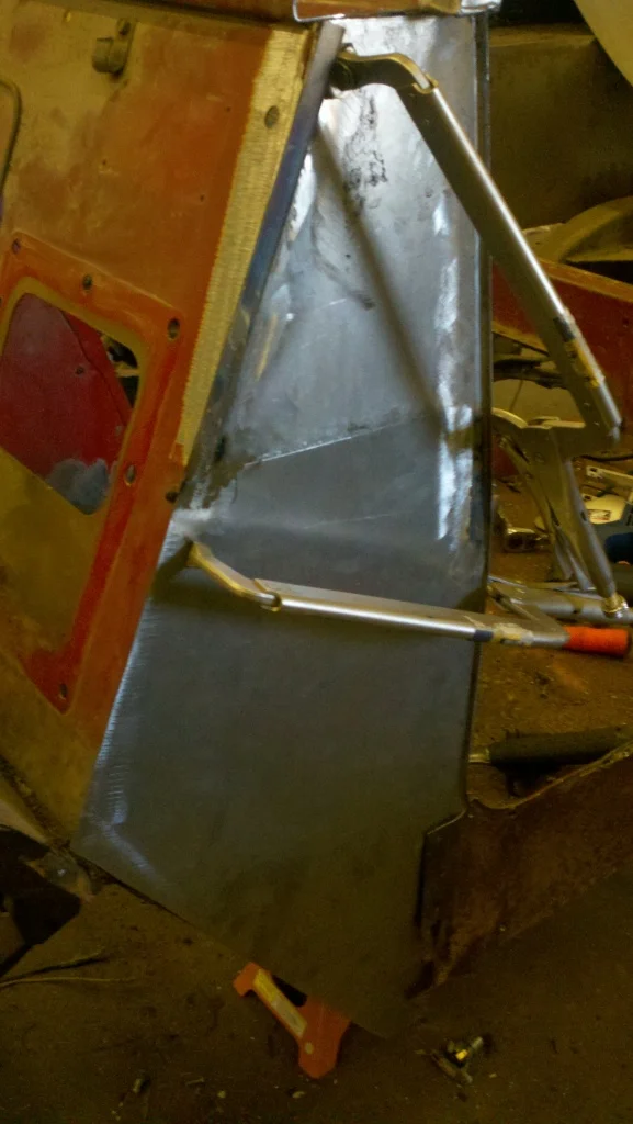

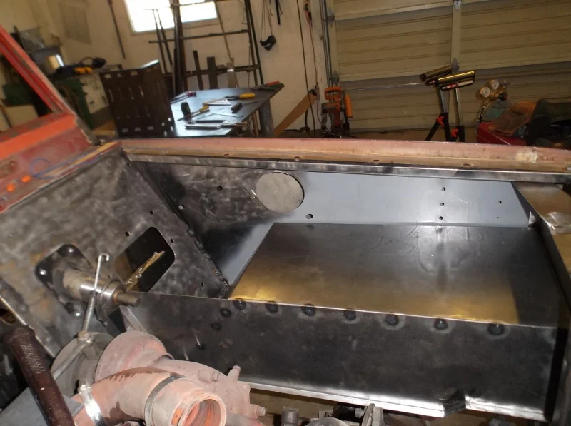

Replacing rear inner fender:

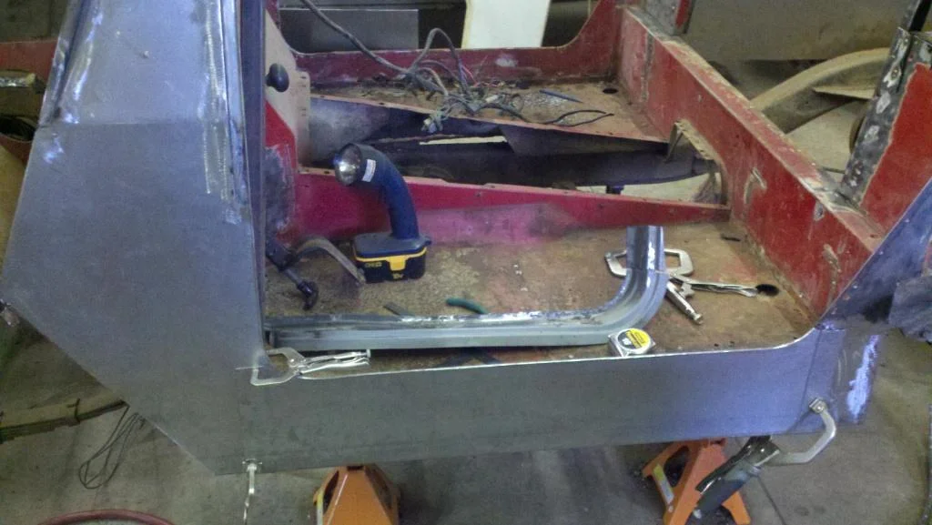

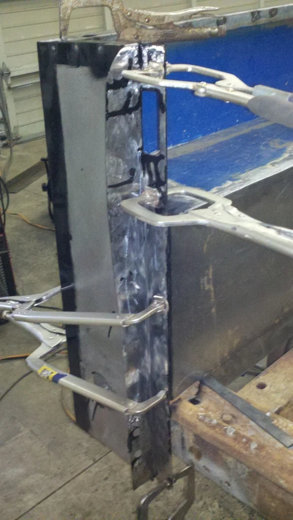

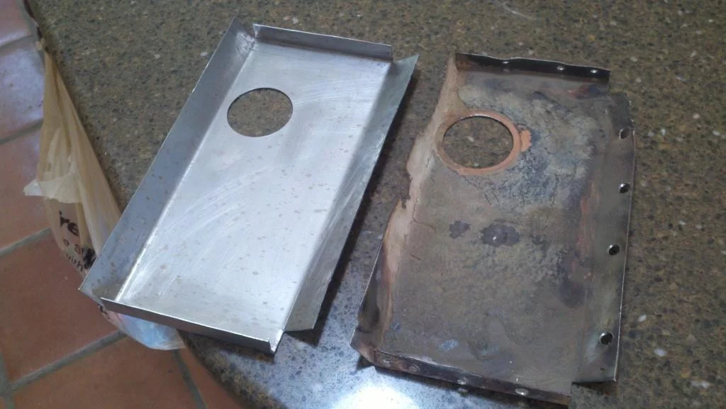

Rebuilt inner rear end cap (did both sides):

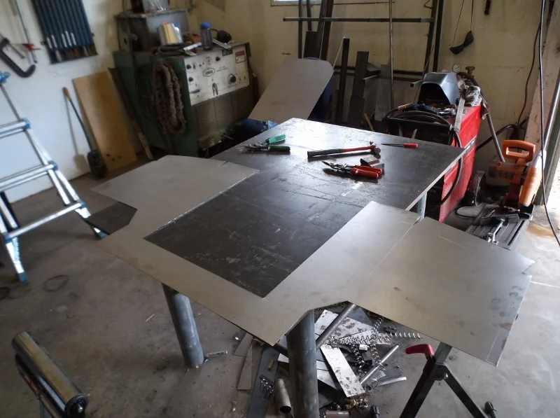

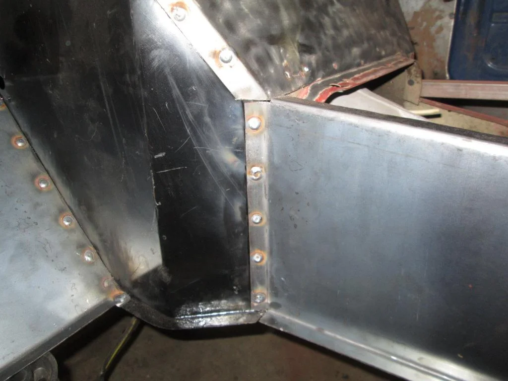

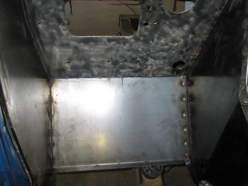

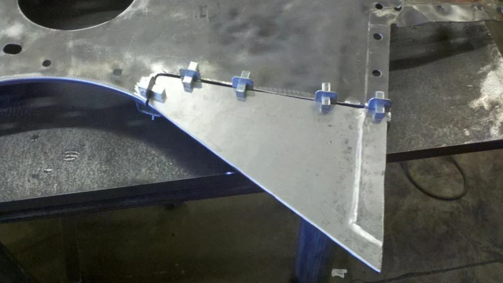

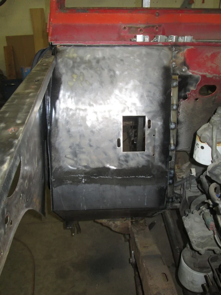

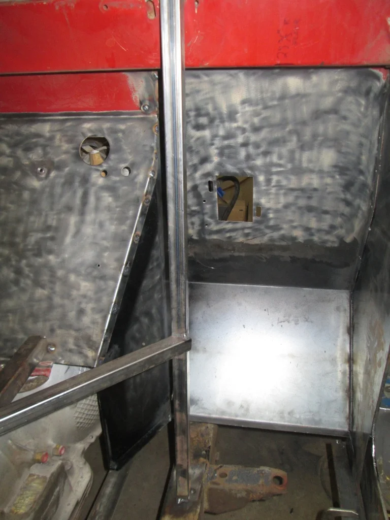

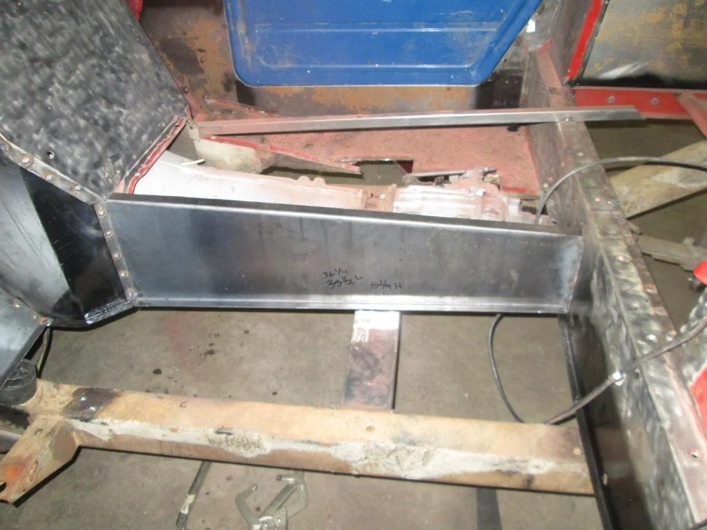

Fabbed up new kick panels (again did both sides):

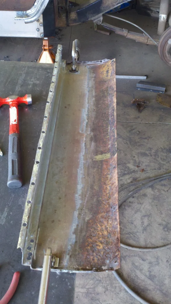

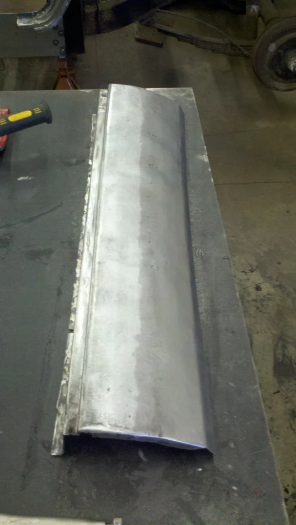

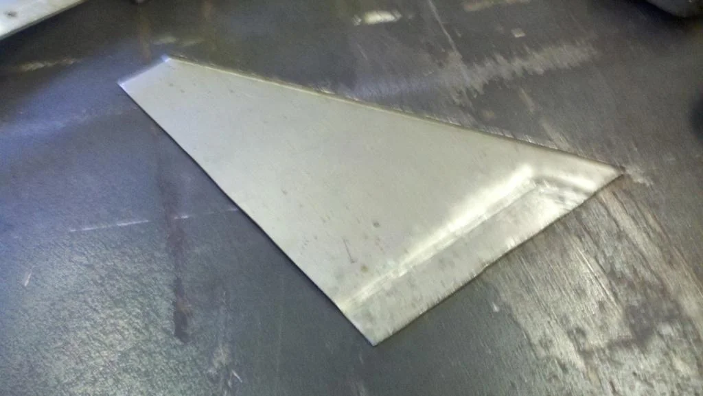

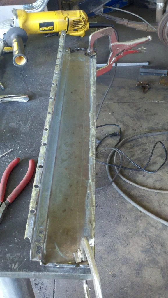

Fabbed up new inner rockers to match the kick panels. I believe I still have a pattern for these. I found the SuperScout Specialist panels did not fit my 800. Too short and not tall enough.

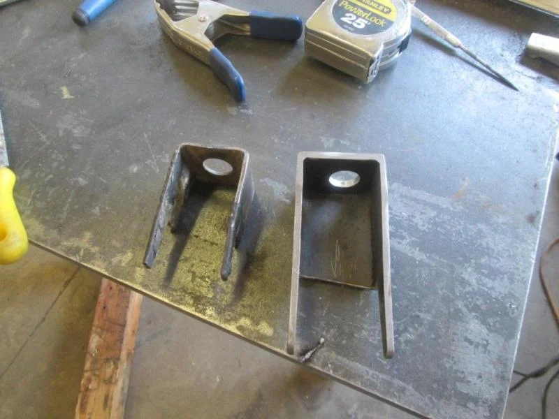

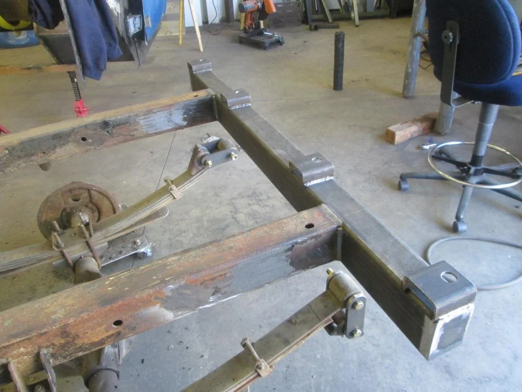

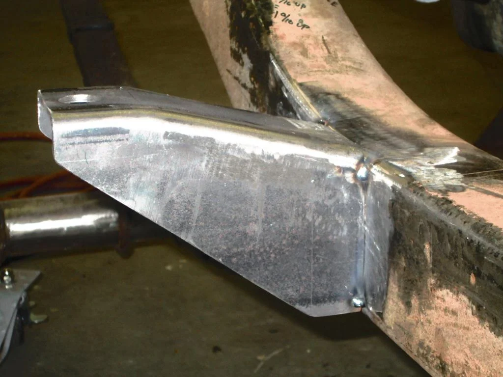

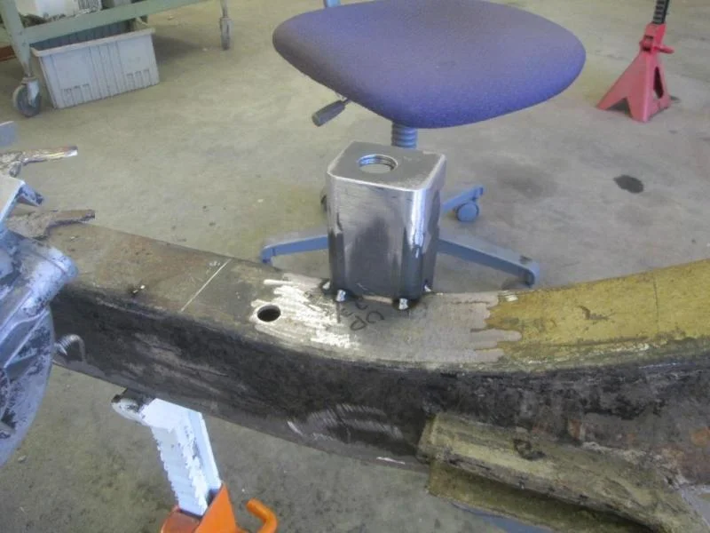

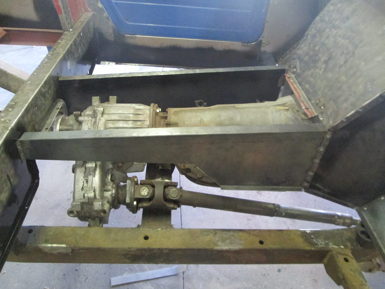

Rebuilt all of the locations for the body mounts. Factory mounts are flimsy and I needed a one inch body lift to clear the engine and transmission (at the time this was for the Isuzu) so I decided to build that extra height into the mount. On the center mounts I ended up going with a wider foot print so I offset the hole to keep it lined up with the body.

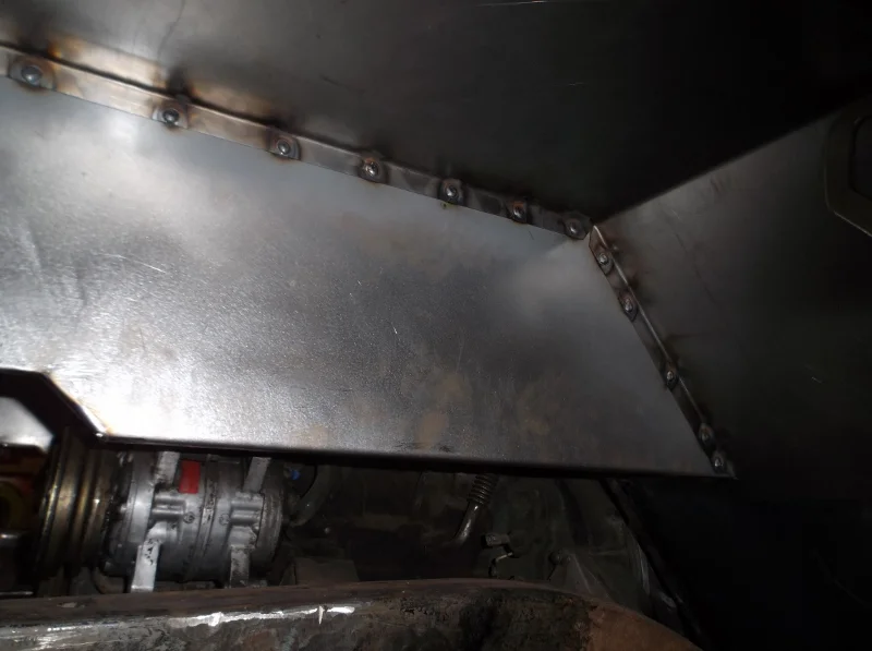

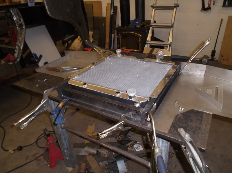

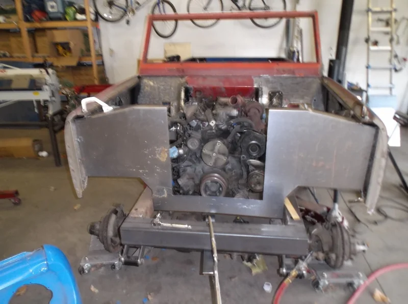

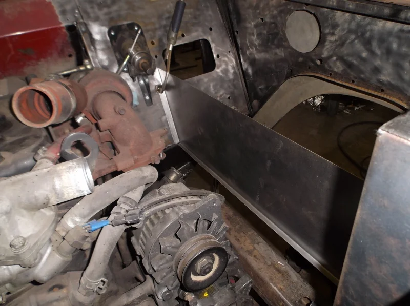

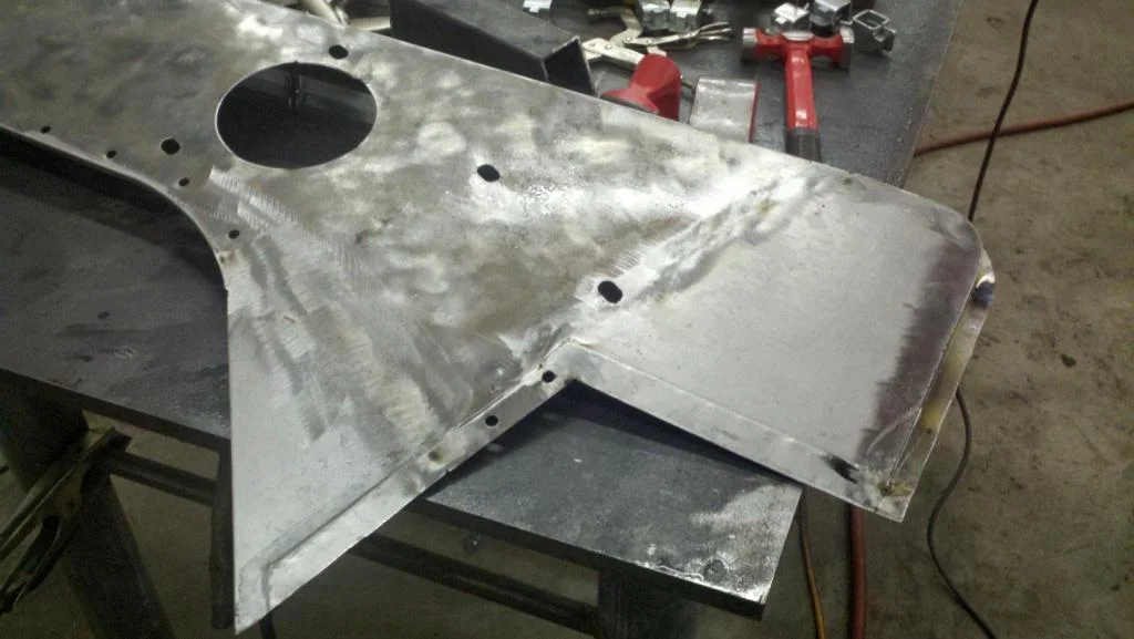

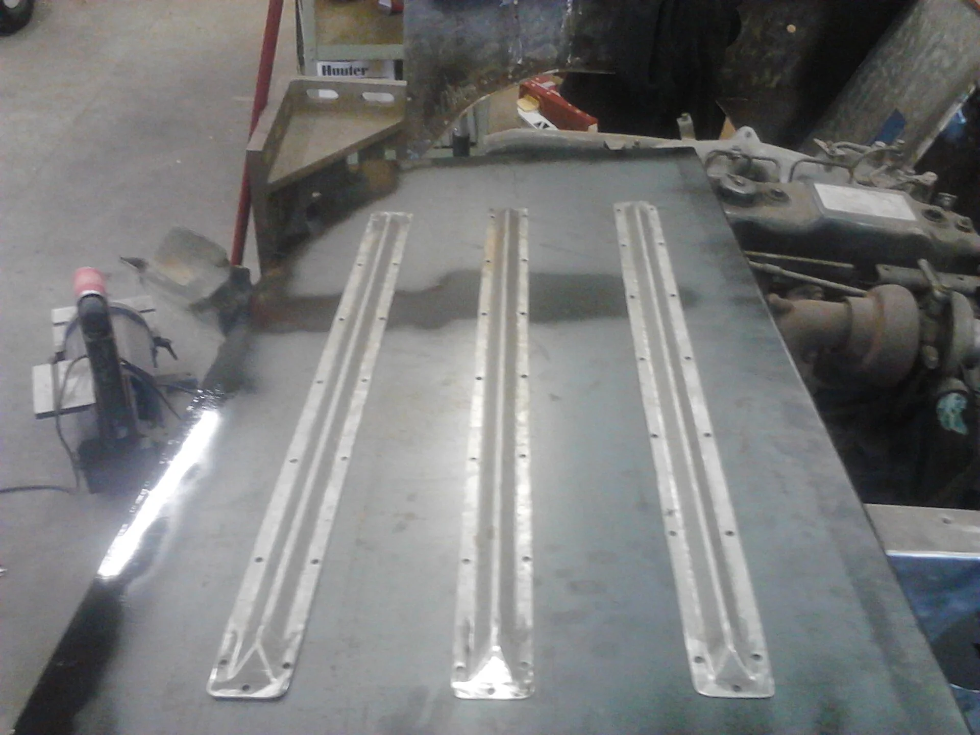

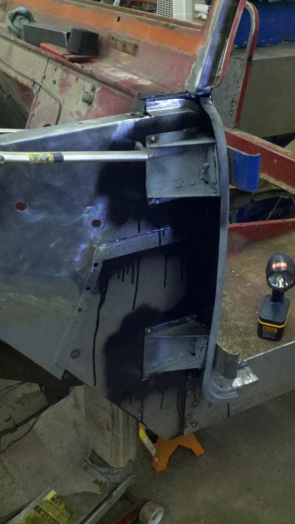

Here I made new front bulkhead. I positioned it as far forward as I could to give me the maximum amount of room in the engine bay. This was designed around the radiator and intercooler for the Isuzu engine so it's going to need some modification to fit the LS radiator. At least without the intercooler in front there should be plenty of room for an AC condenser :cold:

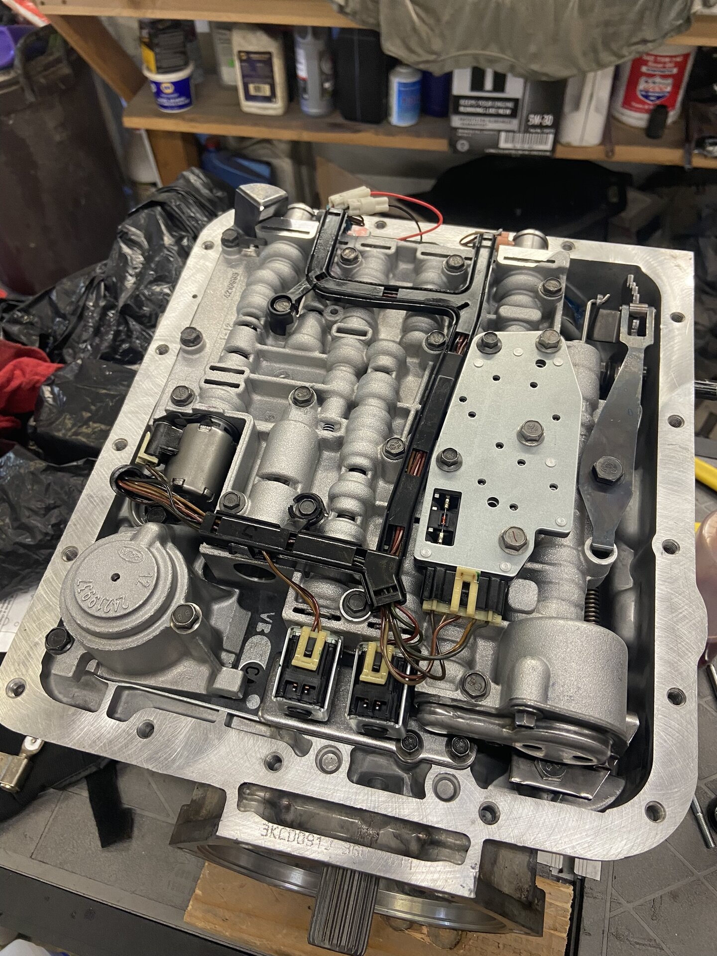

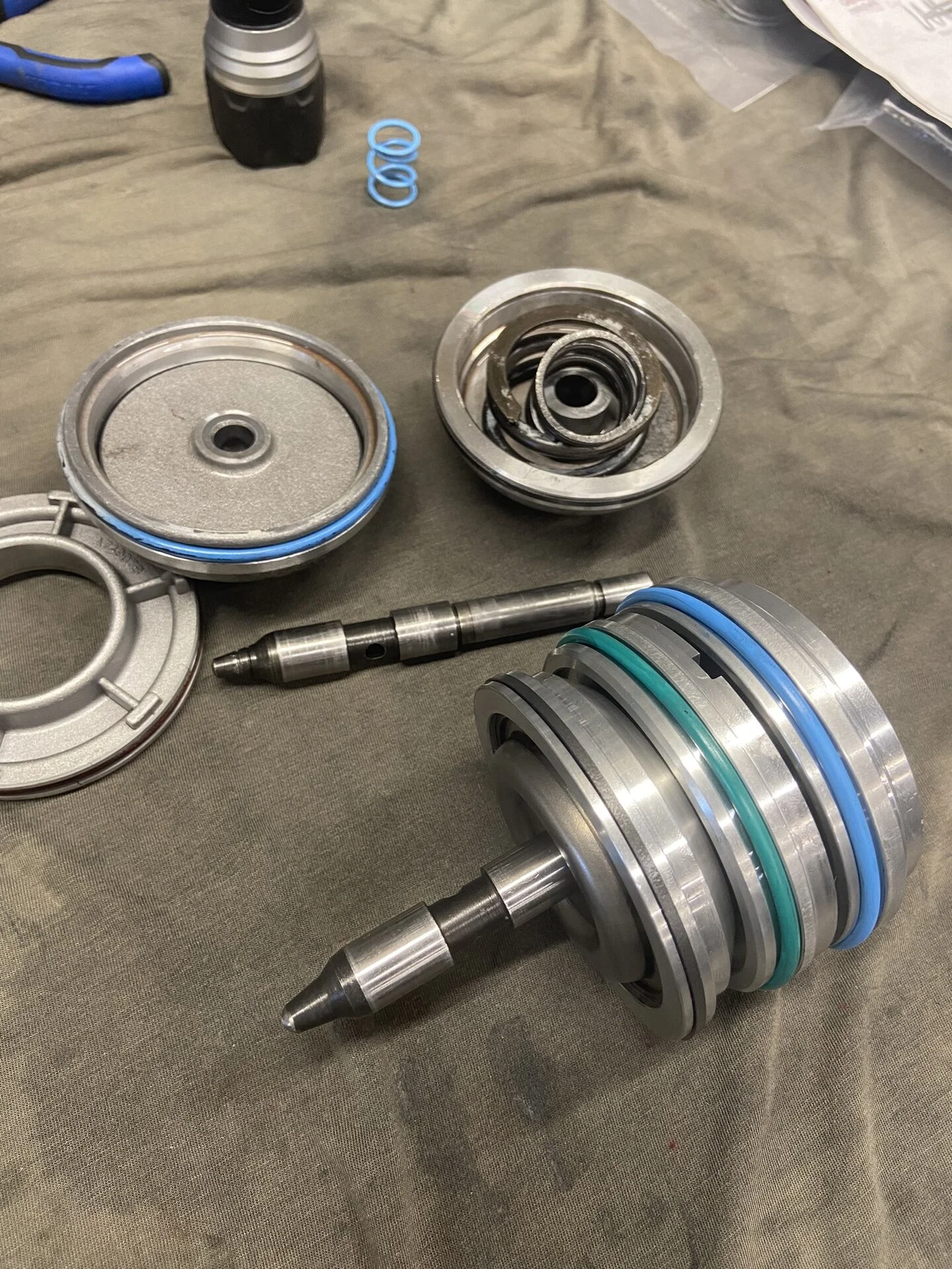

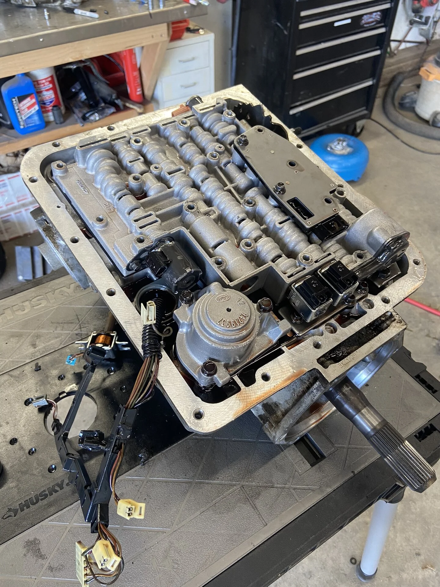

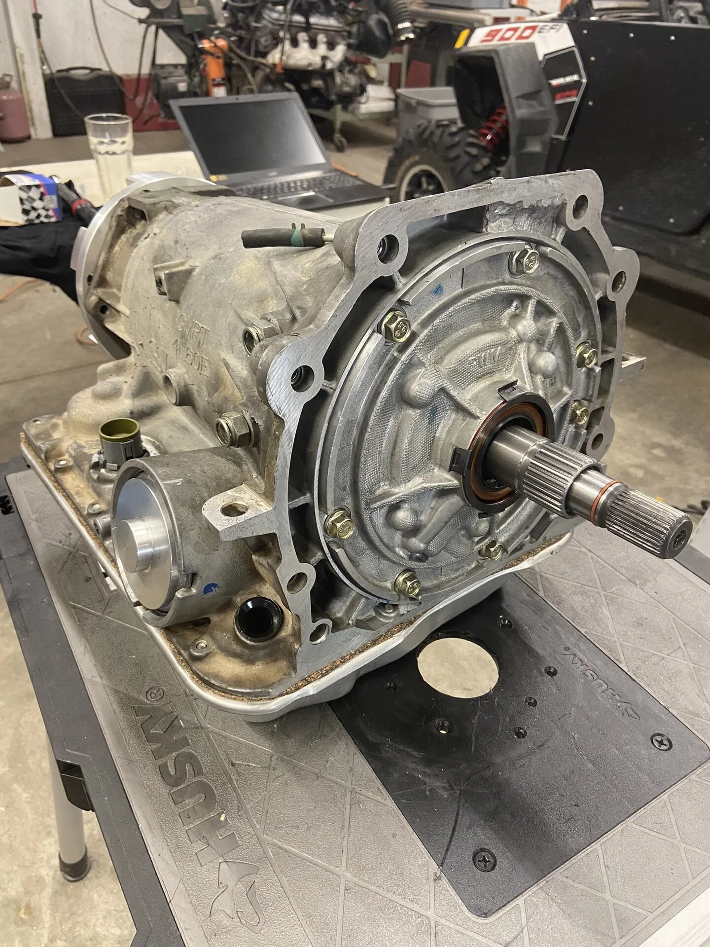

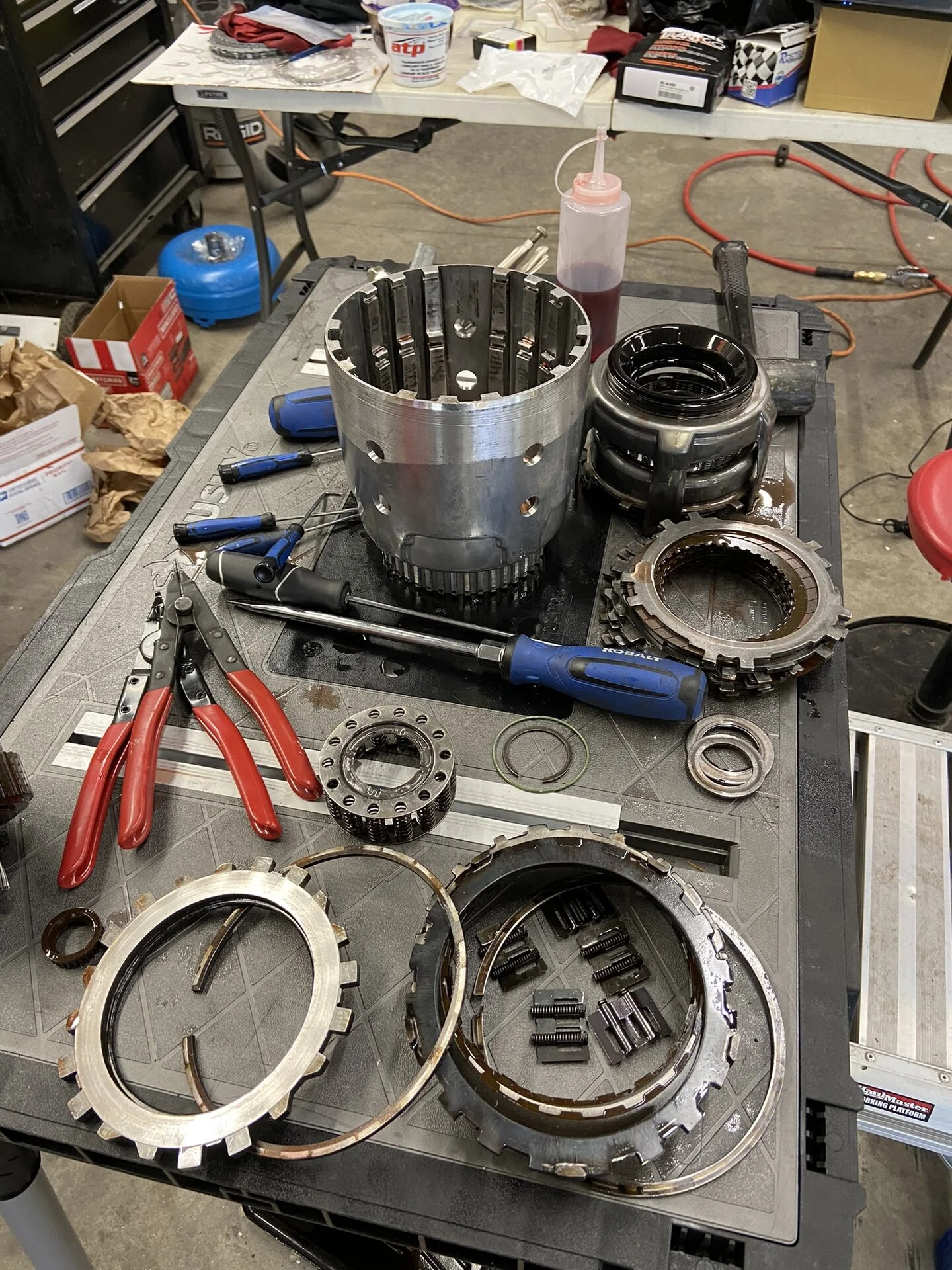

Full rebuild on the 4L60E. Upgraded a lot of parts, installed a shift kit and put 4L65 internals. This thing should be really stout now, easily handling up to 500hp. This was my first auto trans rebuild. Uses a step by step video from Transmission Bench. The work was not overly difficult, just a lot of steps. Did this during COVID shutdowns so finding and getting parts was a pain. Had to fabricate a few special tools and kept running into worn items that the rebuild kit did not come with so that added time to the work. It's done now, sitting in the shop. Hope it actually works :)

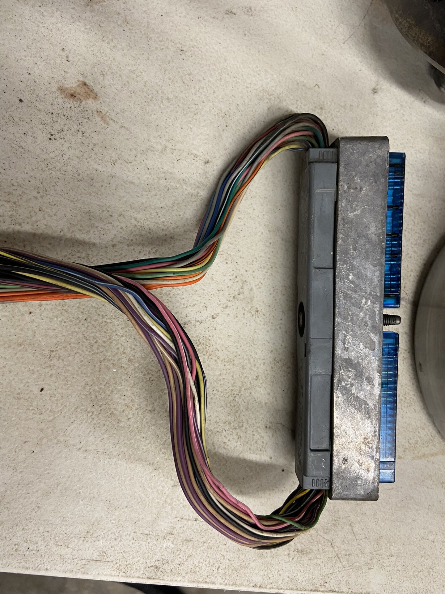

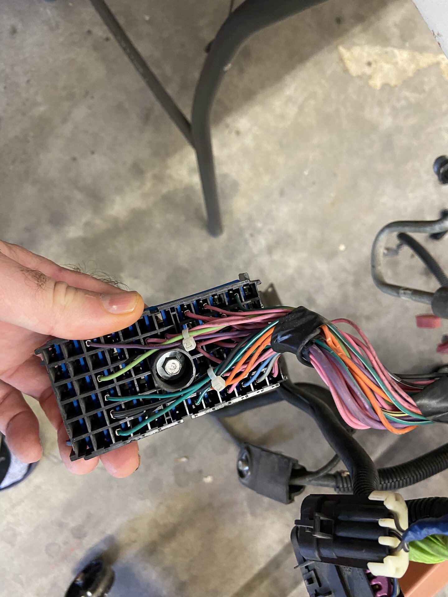

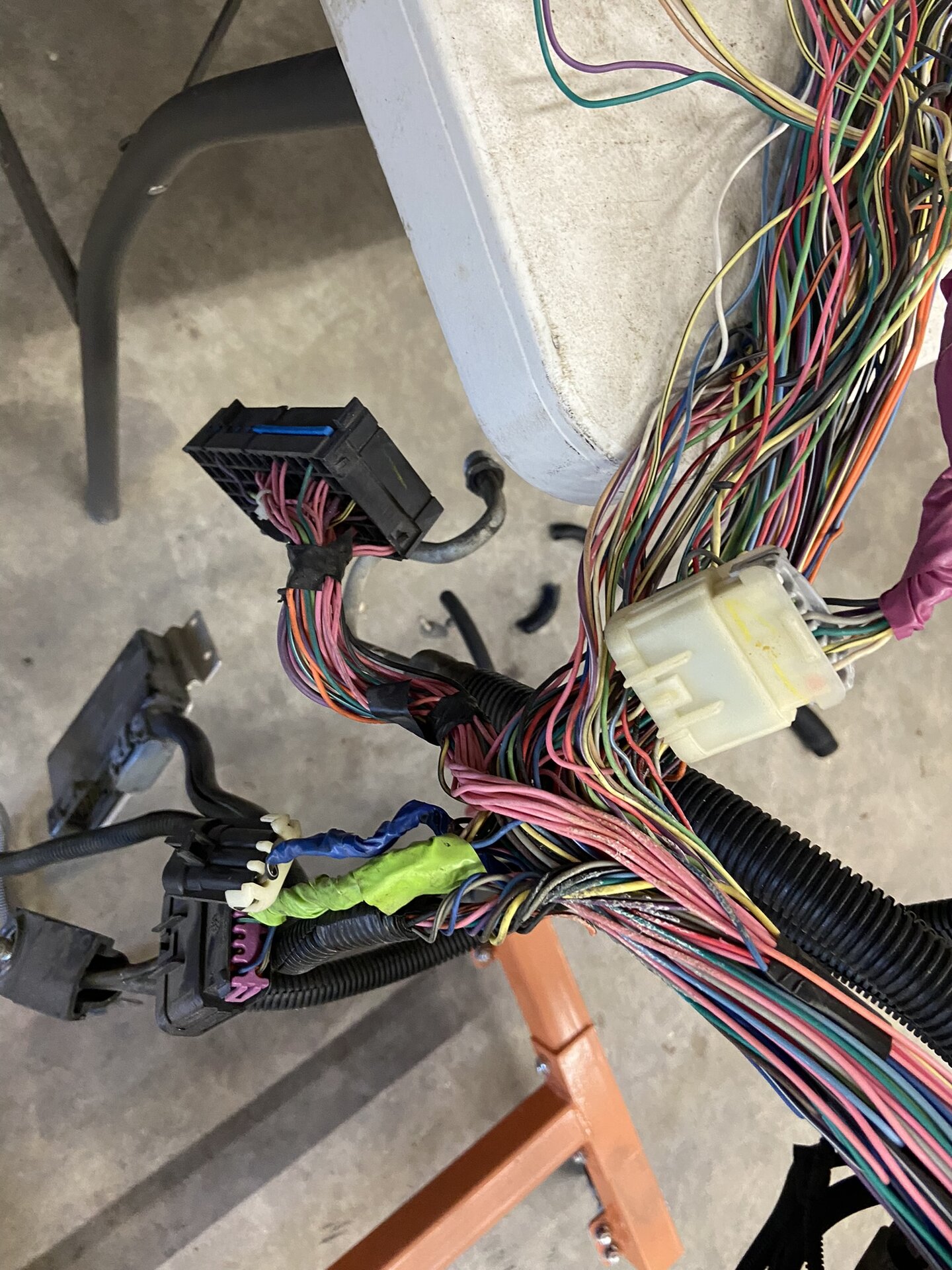

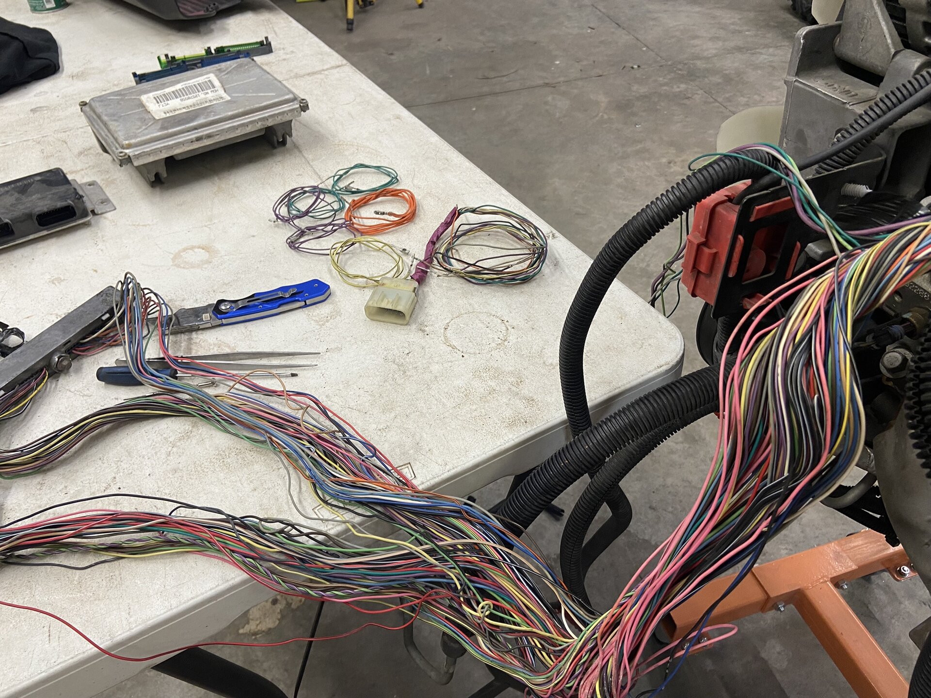

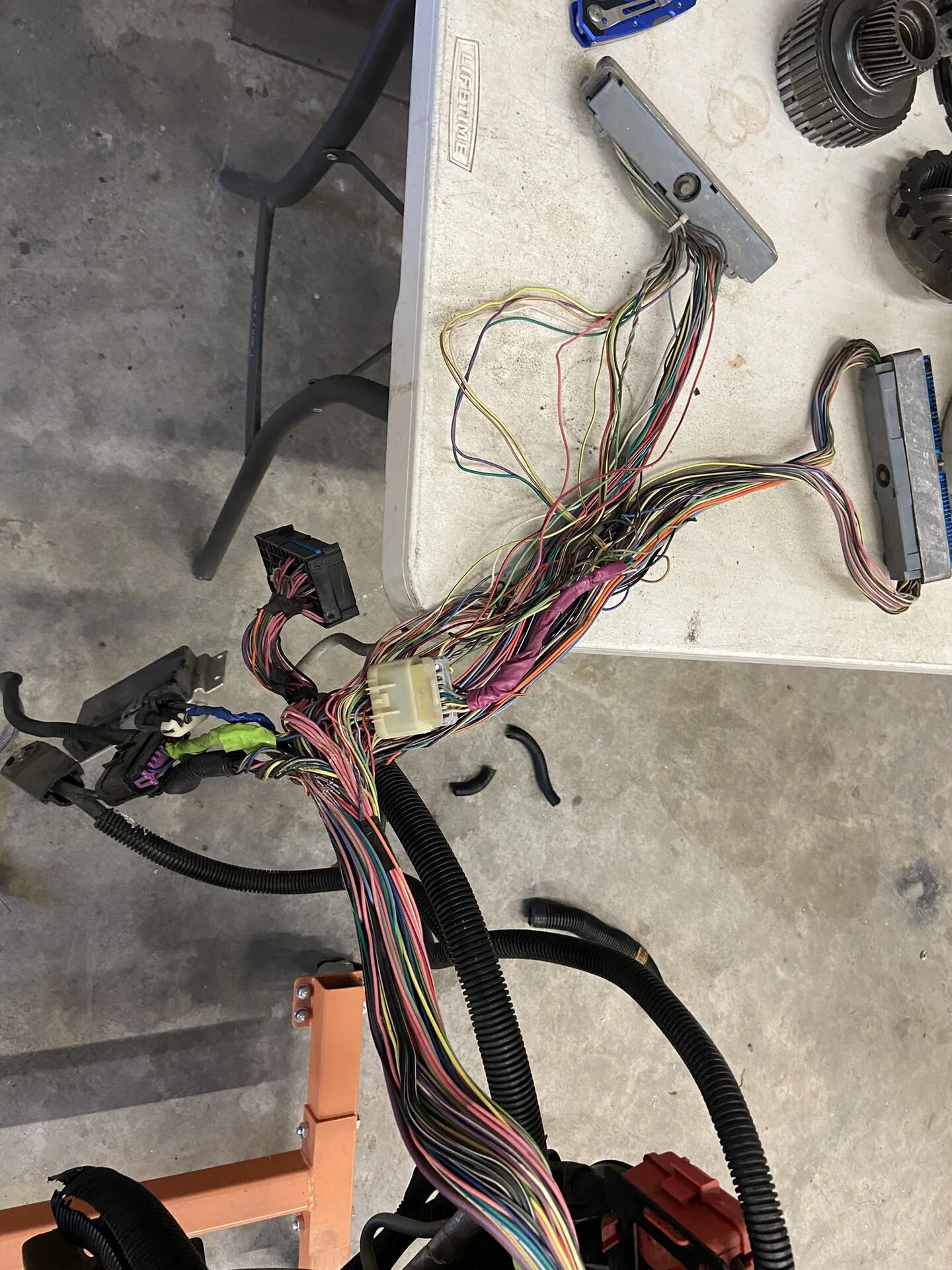

Stripped down the wire harness on the 5.3 to only what I will need to make it run. Going to try to make the factory ECU and harness work. May have to buy EFILive to program it or send it out to a shop. I am leaning towards the EFILive option since it will also program my tow rig.

Thanks! Some of these are my second try at repairs. The first time I tried to just cut out the rusty area and weld in new metal. I wasn't happy with how that came out so I did it over and tried remaking the whole panel when it made sense to do that. Much happier with the results.
