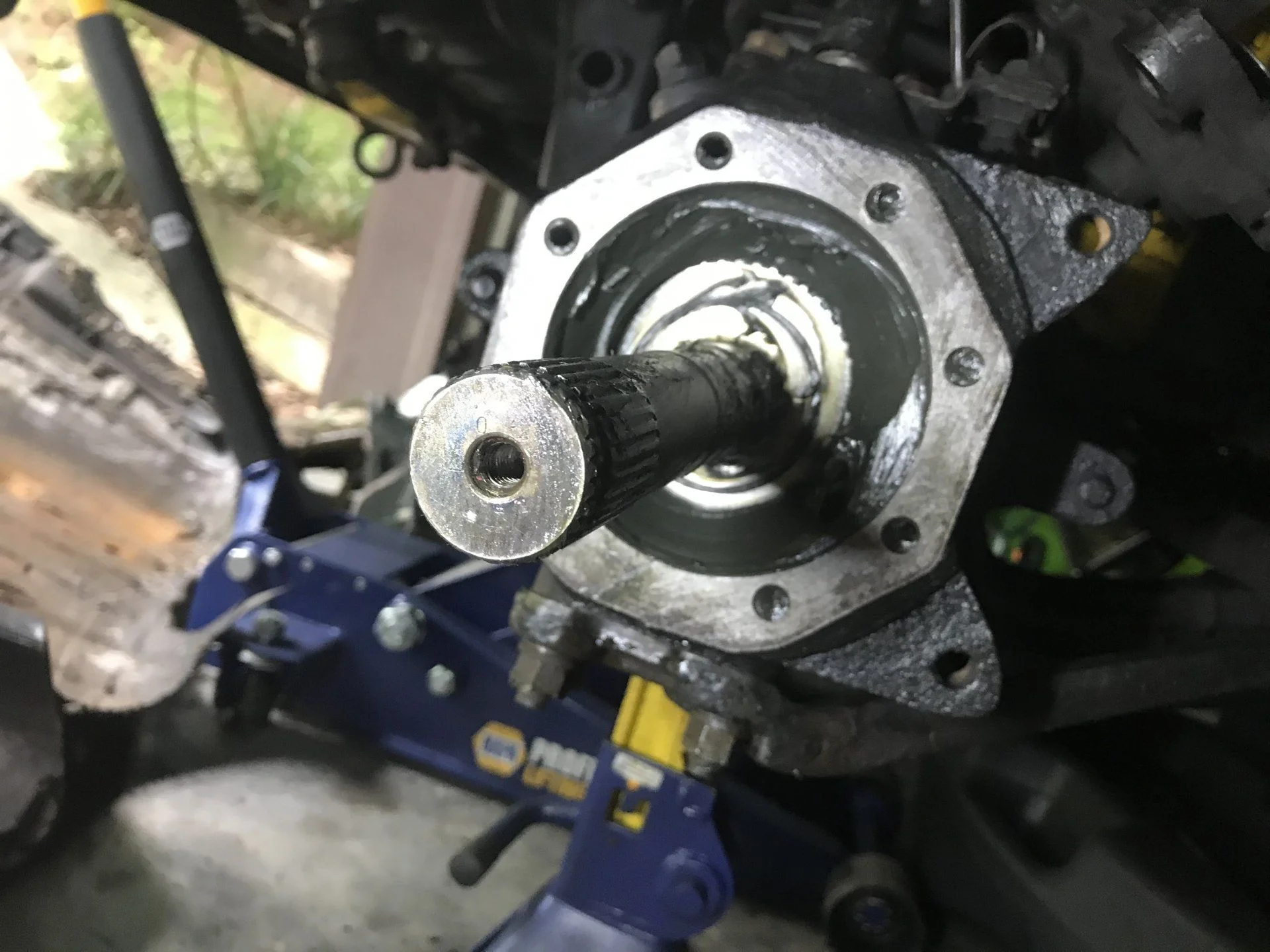

Prior to Cruisers and Mud, I’ve only changed fluids in vehicles and never worked on much of anything else. Thanks to you guys, I’ve rebuilt the PS Pump, replaced the steering box and cooler, rebuilt the knuckles, added the cdl switch, and removed that terrible wood grain. I brag about this place constantly, and I’m sure my wife, coworkers, and church friends get sick of hearing about it...but you guys have saved us a ton of money, thank you.

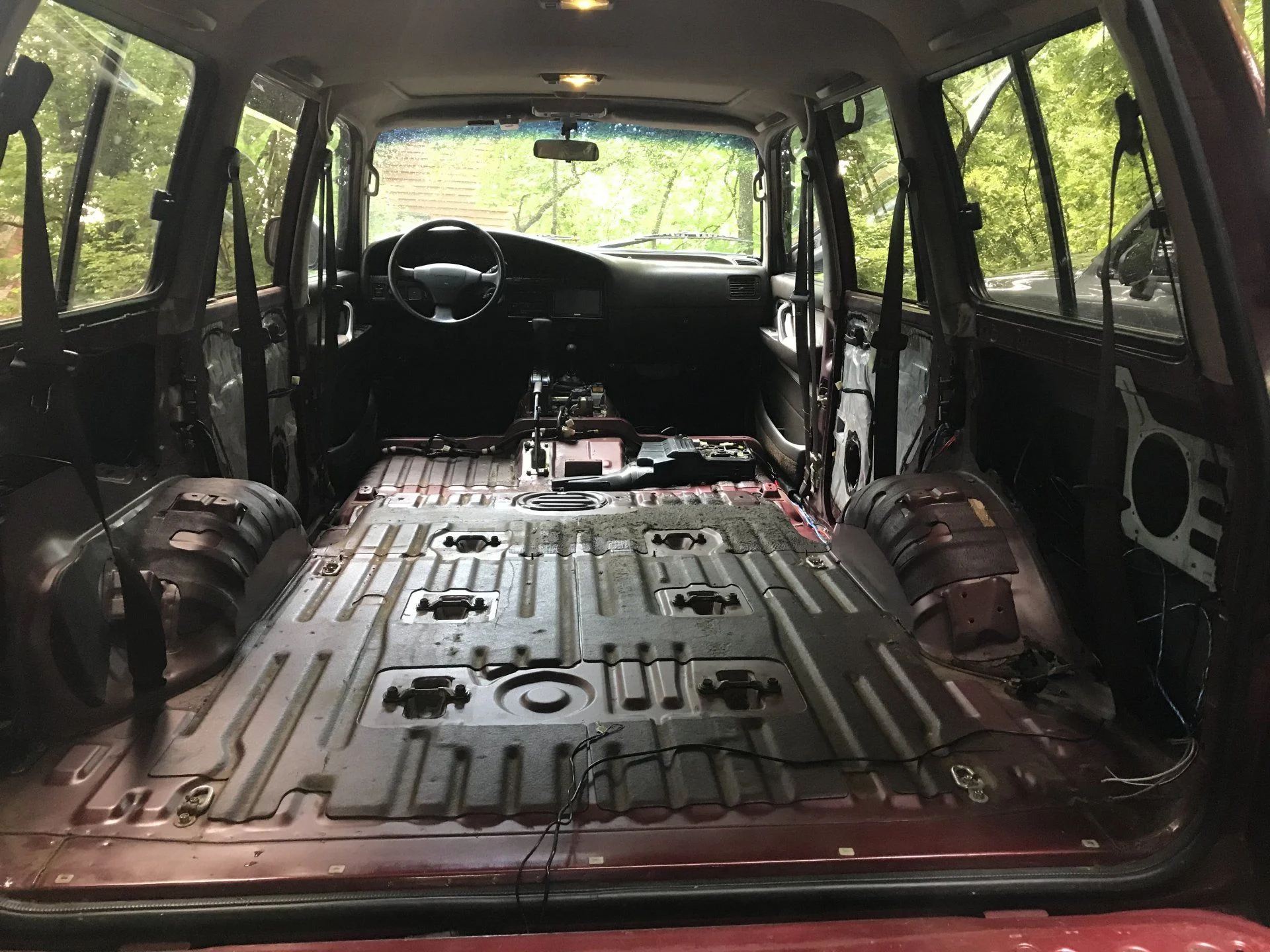

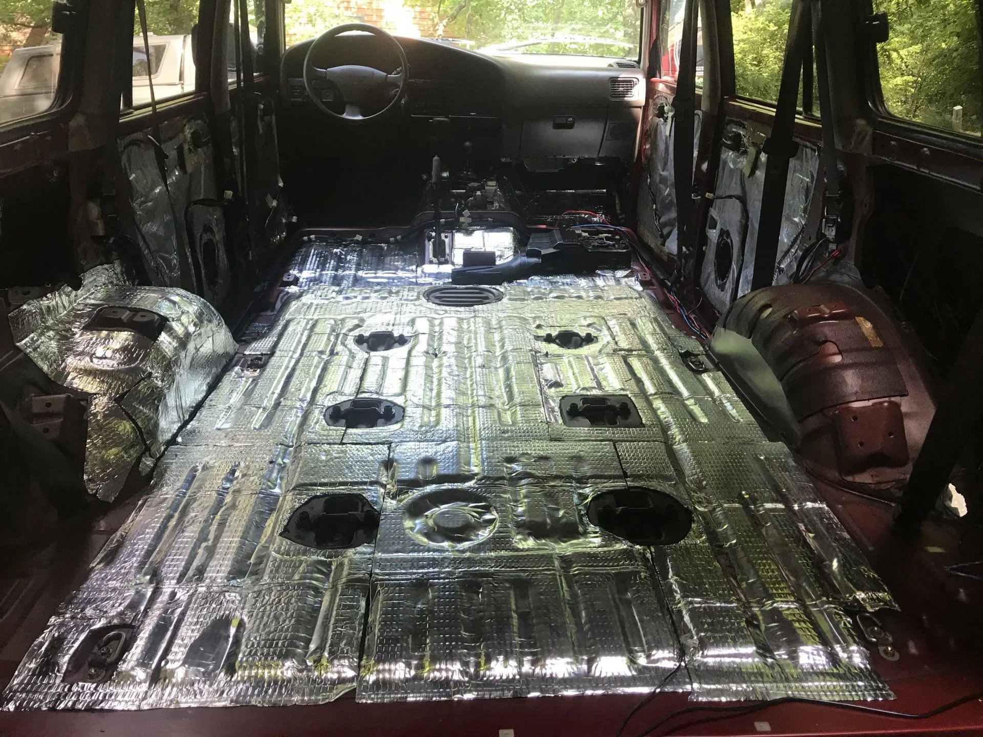

Also we stripped the entire interior, pressure washed the carpets, (something I recommend to anyone who buys a used vehicle) and added Siless, the cheap Russian Federation alternative to Dynamat. So far so good! Wasn’t able to get a picture of the closed cell foam layer, but it’s a much quieter ride now.

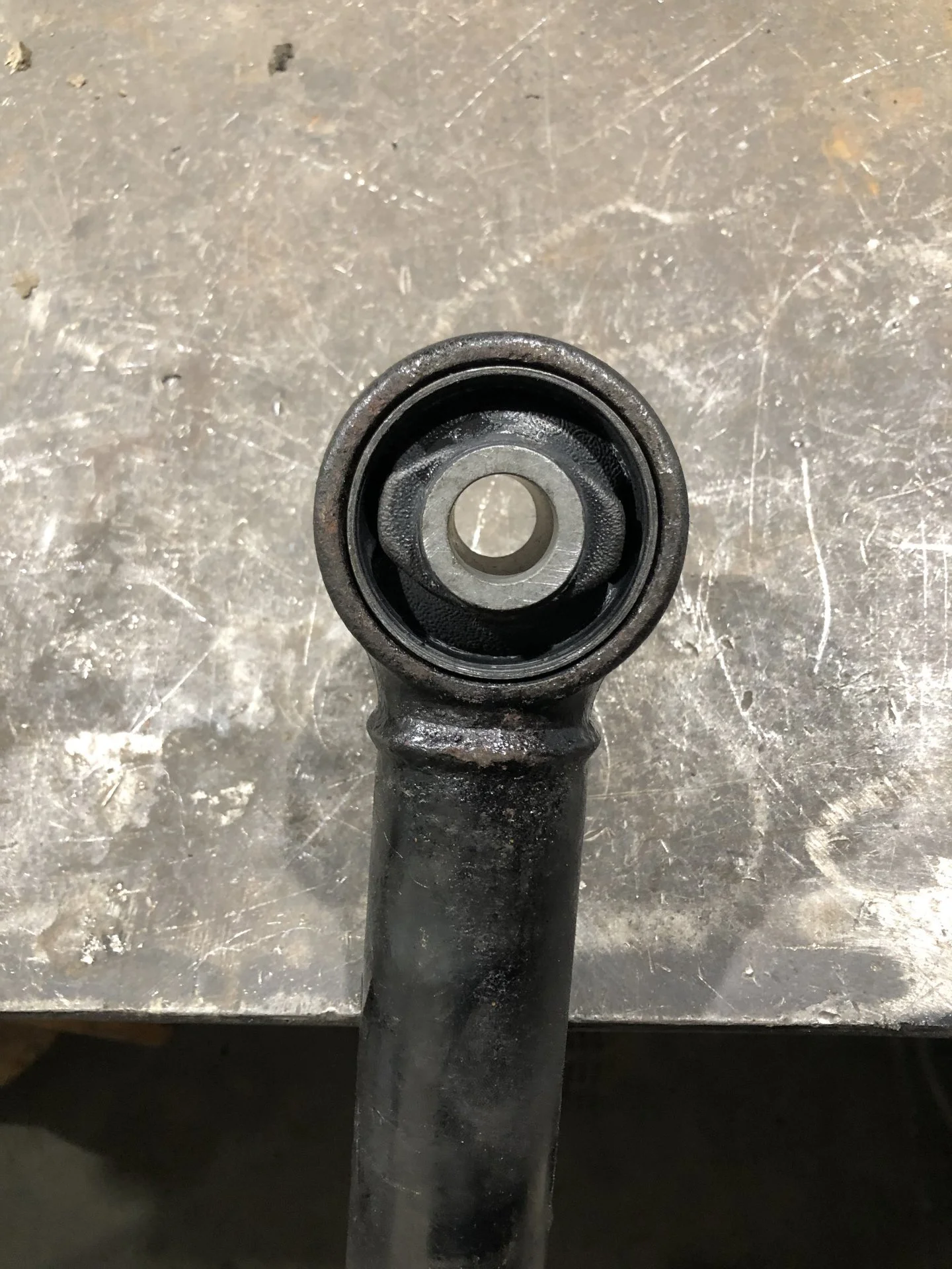

Looks good. Did you pack the knuckle completely full of grease? Should be packed about 75% full.

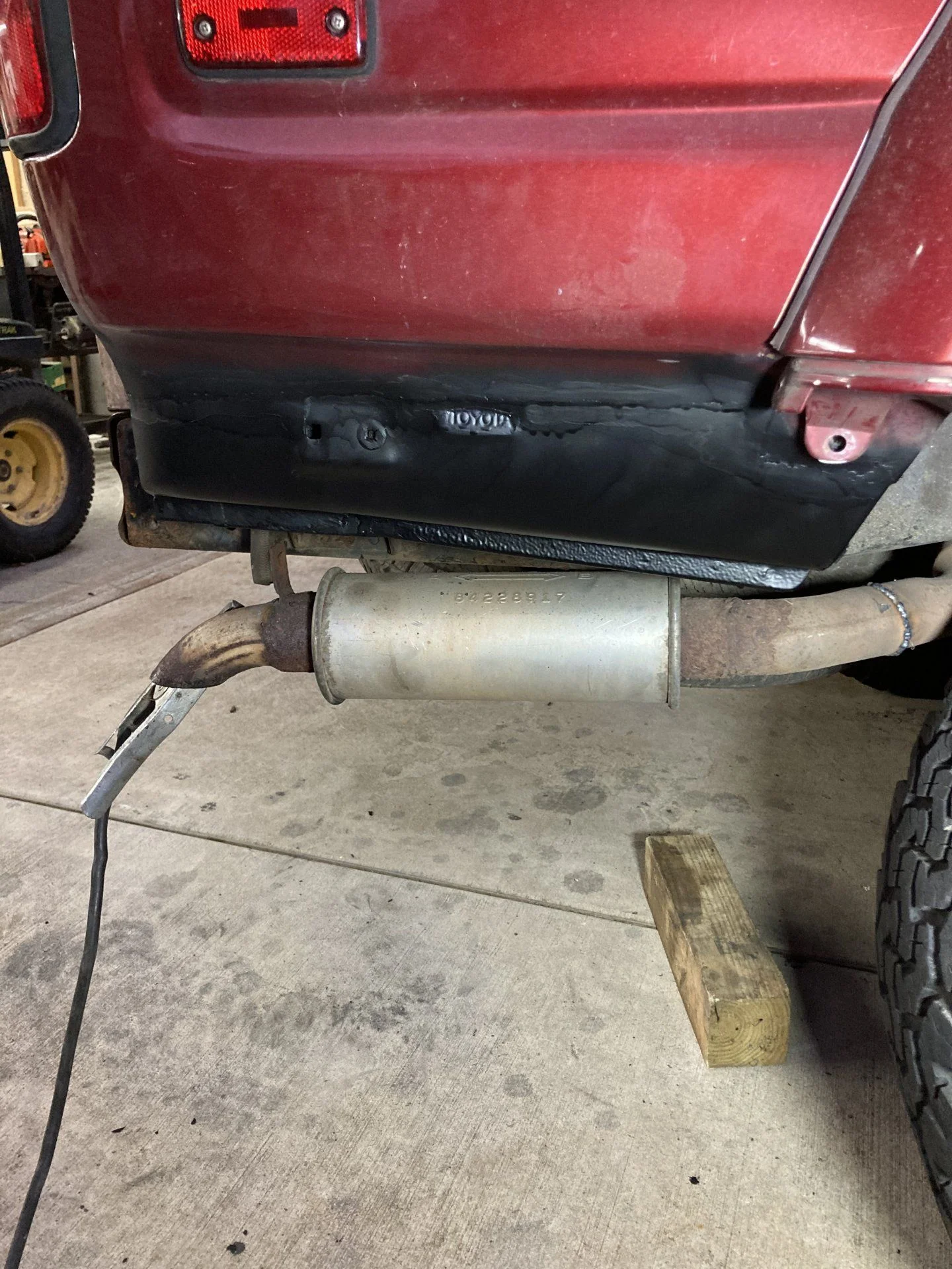

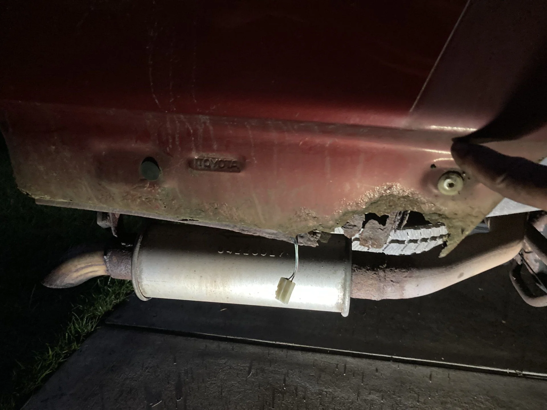

So last weekend I was installIng Joeys QPM and accidentally dropped a ratchet down into the “rust bucket” and I heard it hit the ground...I was as confused as you are now. I crawled underneath and there laid the ratchet on the ground surrounded by a bunch of rusty metal chips. *audible sigh*. This rig had some surface rust underneath when we bought it last year, but wasn’t terrible. Apparently there’s a reason for the nickname, because I missed this spot being behind the bumper and above the muffler. I went to a local Toyota junkyard and luckily there was a totaled 80 with unmolested buckets. I have 0 welding experience nor a welder, so I let a guy I work with tackle it. I think he did a phenomenal job.

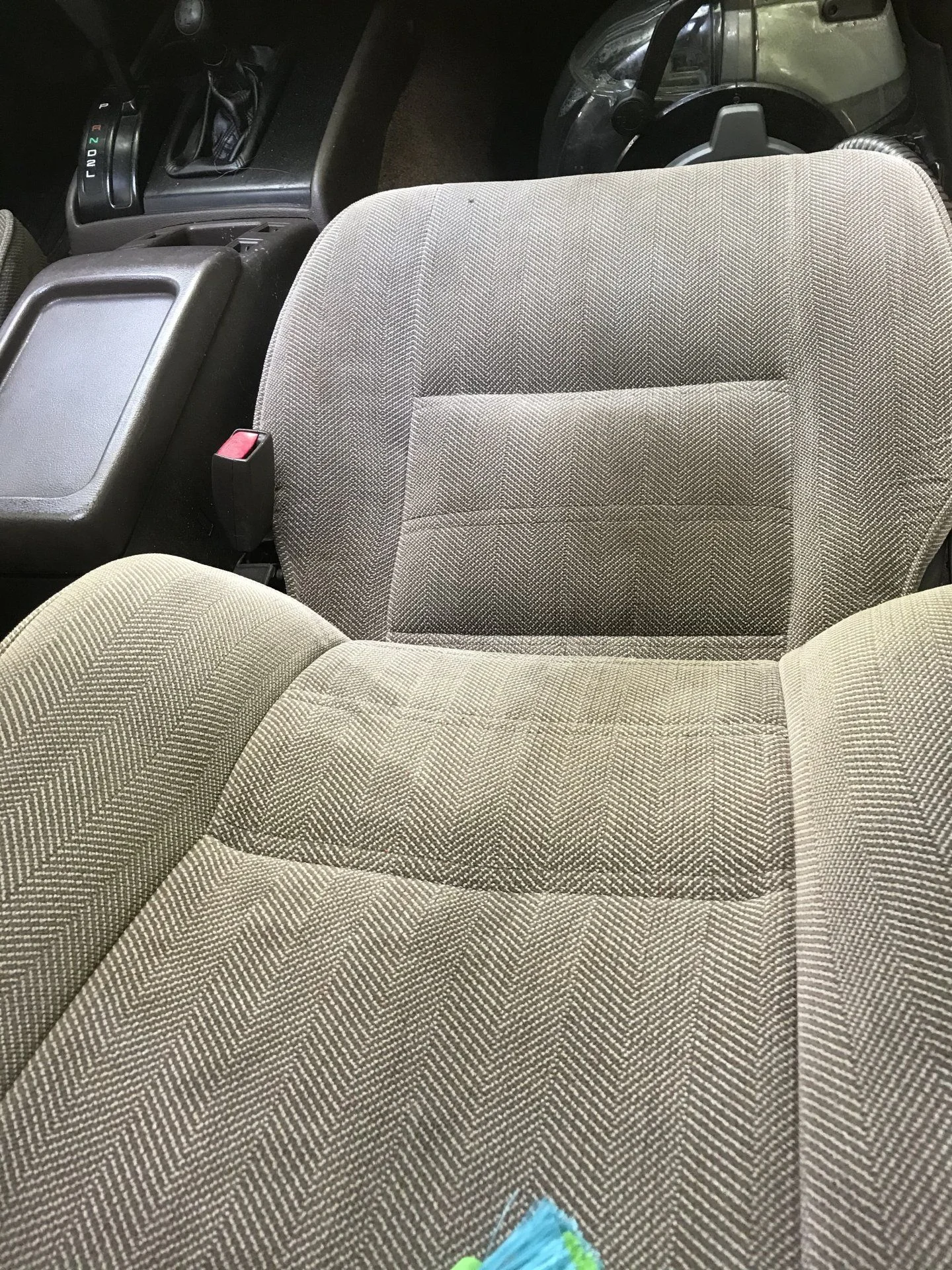

The only thing that hadn’t been cleaned up to this point was the seats, so we rented an upholstery cleaner to see if it made a difference. We didn’t expect much with brown cloth, but were pretty surprised. Did half the seat to show the difference.

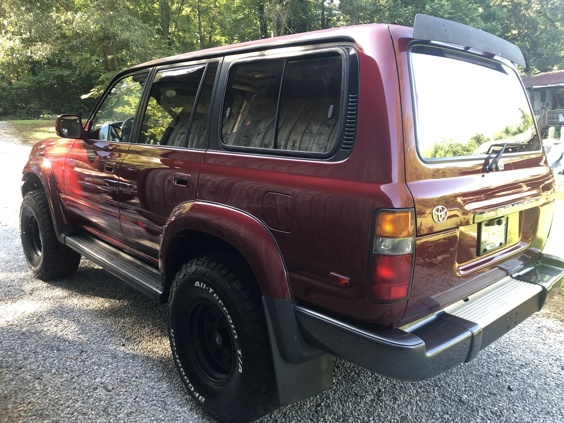

It’s been a while since I updated. We recently moved to Nebraska, and after finding out that a paint job will run at least $10k at any respectable painter, I opted to leave our 80 back in TN to be painted. This is the picture we just got. I’ll fly back home and drive it back in less than a month. We’re stoked!
Since the last post, it’s gotten new pads and rotors and rebuilt calipers all the way around, wheels and tires, leveled out the stinkbug stance, and headers courtesy of @ACC Toyota. We also ordered all new window runs and seals from amayama and sent them to our painter since he was taking out the old ones anyways. I’ll update with pictures again once we get it back.

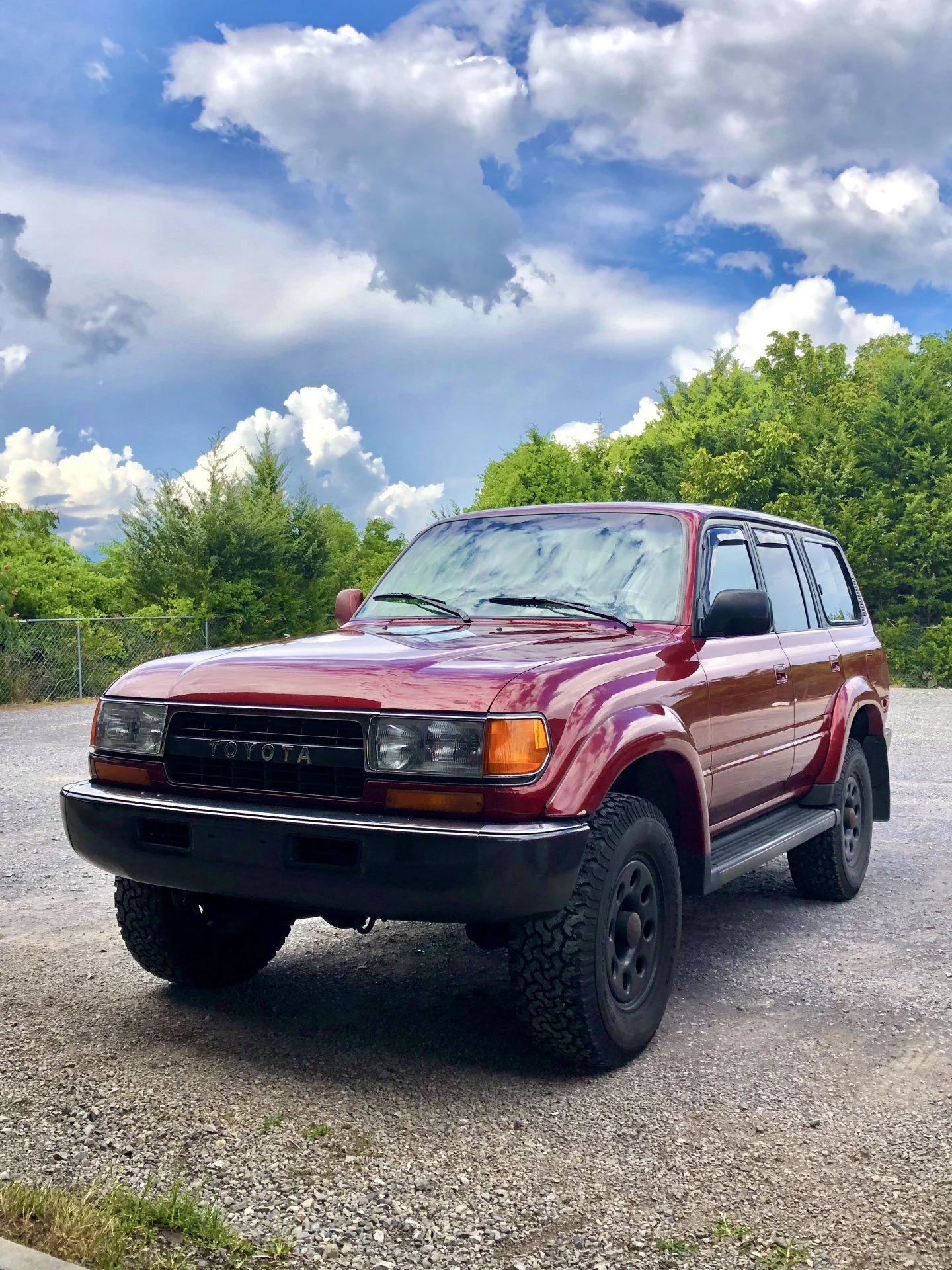

Back in TN for the week, our 80 is like new!

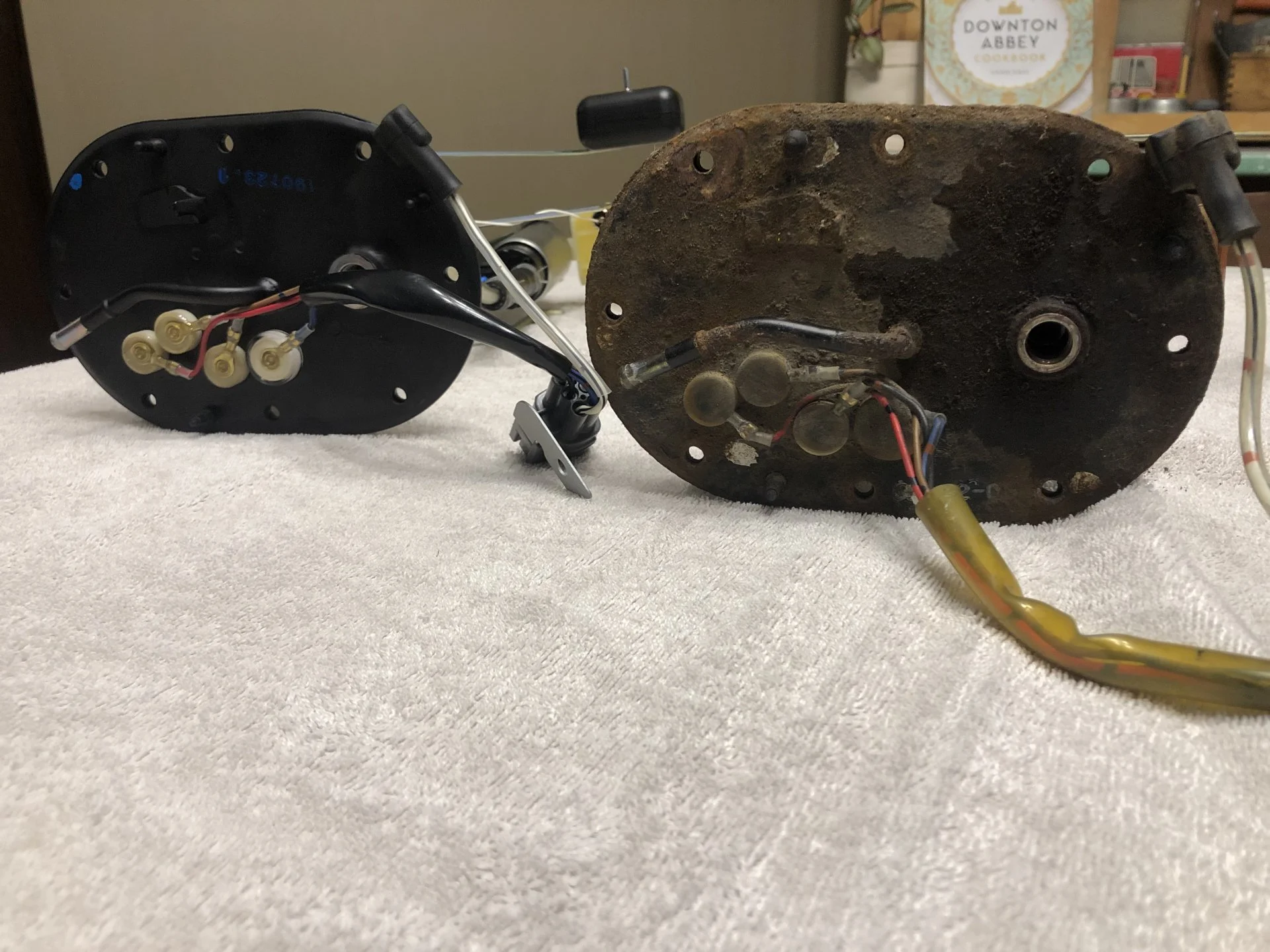

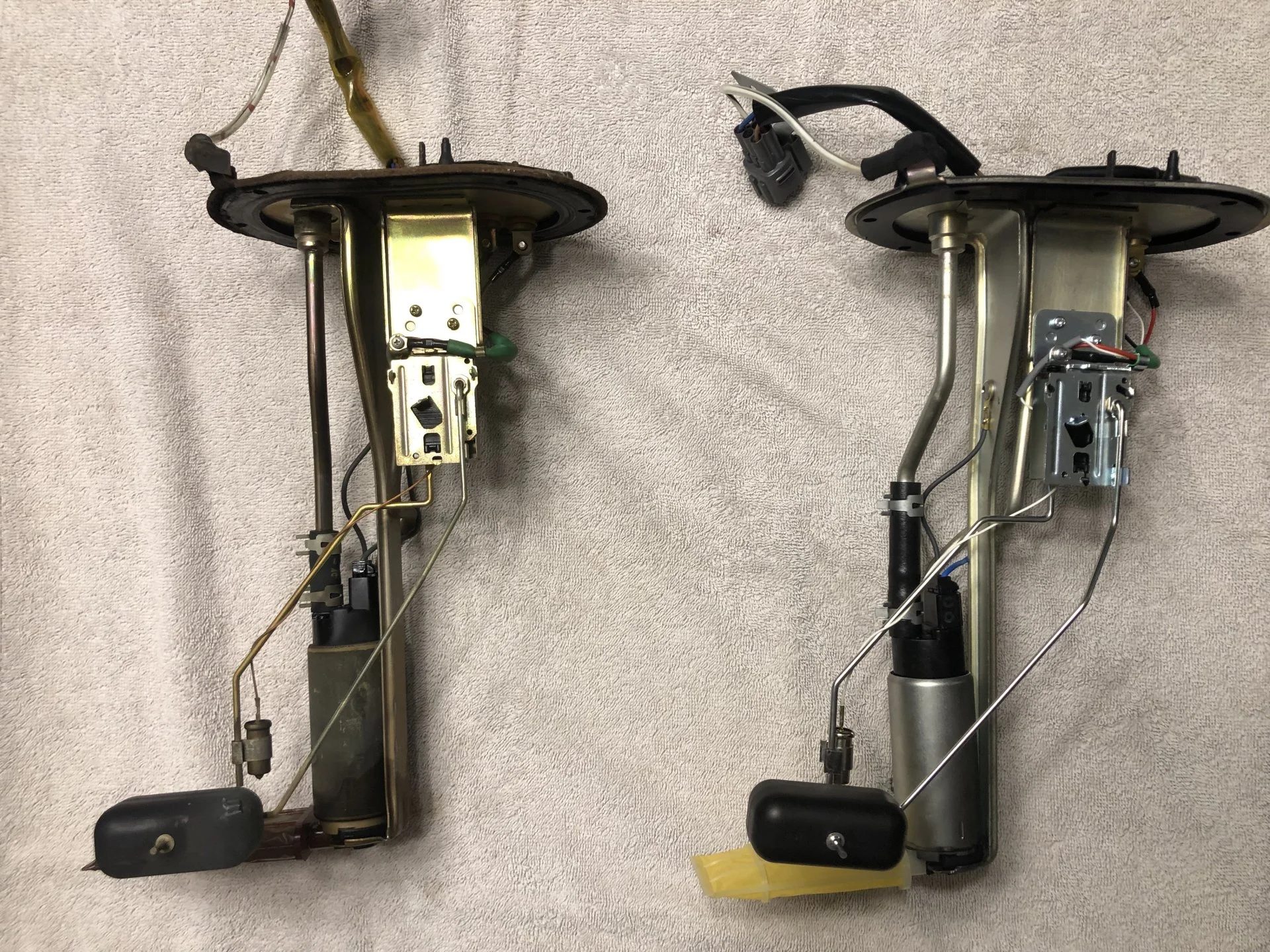

The plan is to drive it 18 hours back to Nebraska this weekend. There has been a lean code and a slight hesitation on start up, and I knew the lid to the fuel pump was pretty rusty, so I figured the rest of it was. So I replaced it all fearing the worst. Turns out it was just the lid, but the less rust the better, so I didn’t mind too much. Idle is noticeably smoother now.

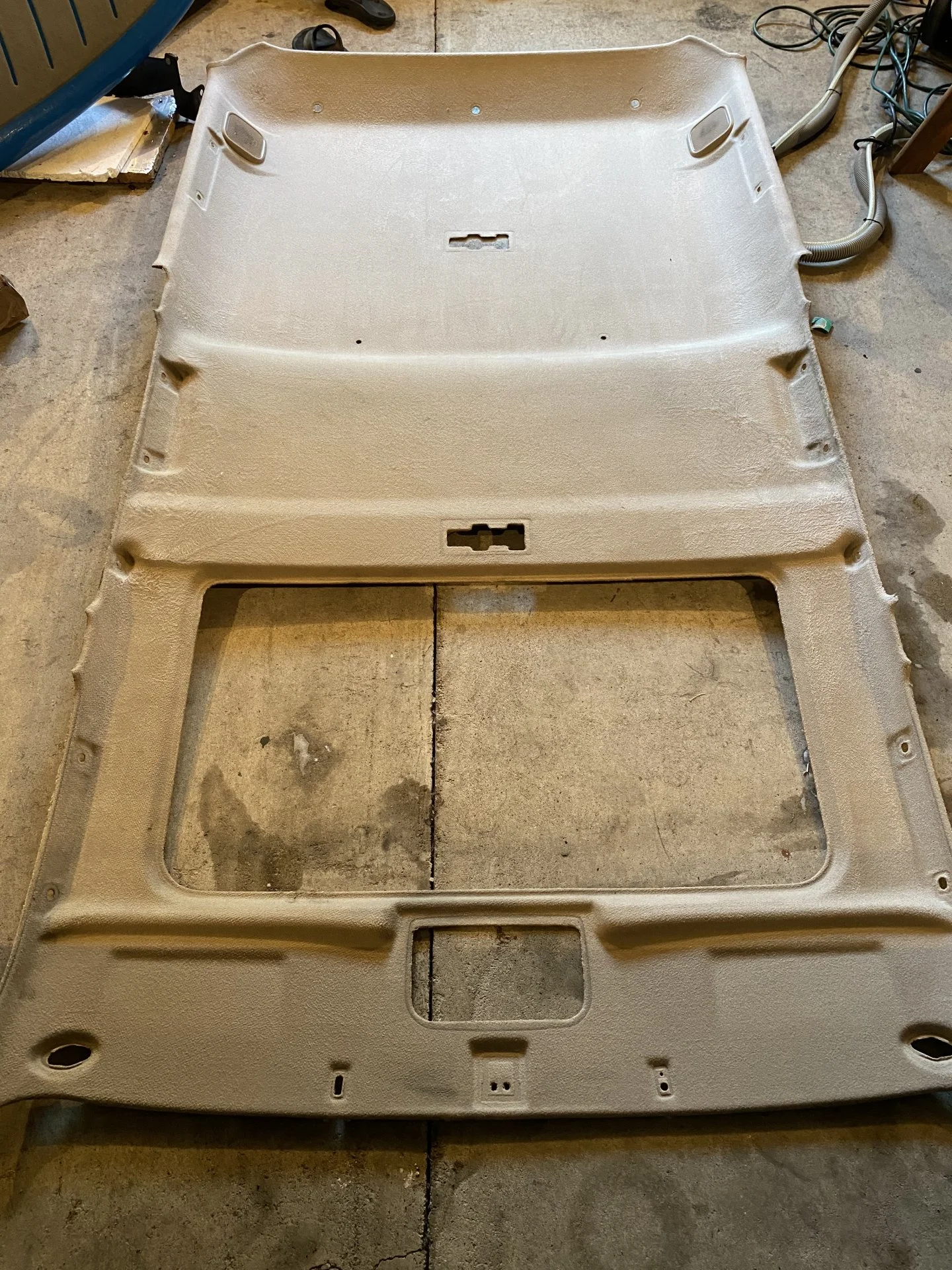

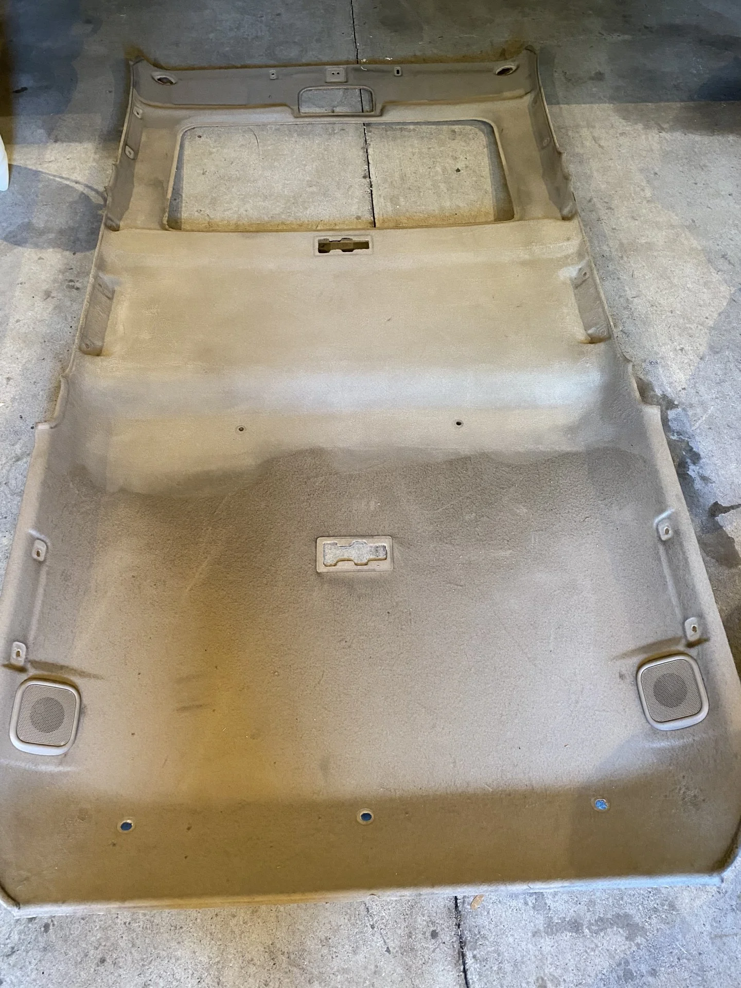

Our headliner is really starting to sag in the middle, and I read on here from @ZeGerman that with a little modification, you can put the cardboard headliner from the 95-97 LC’s. I got a great deal on a headliner that was in good shape, but absolutely filthy. I rented a carpet cleaner from the local hardware store and went to work.
Before (with a little test clean spot in the middle)
After
I did run into a tiny problem while cleaning. The brushes really made the fabric pill. I took a small disposable razor to the headliner and pillars and they worked like a charm.
I’ll add sound deadener when I get around to putting all of this in. I’ll probably tackle it after the engine swap.

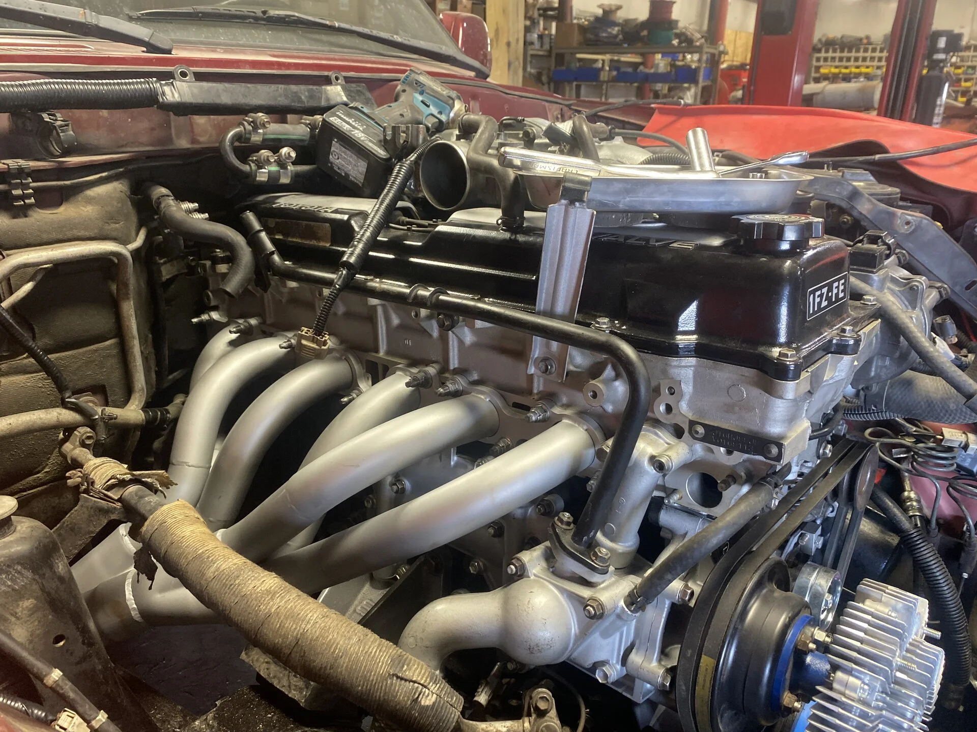

Took me a couple of weeks to tear it down and put it all back together. This thing was disgusting. Everything is practically new now. Powder coated the intake, oil pan, and valve cover. Had a local gun shop cerakote the headers
This is where I left it this afternoon. I’ve still got a couple of days ahead of me. I’m not as fast as some of you goobers. I’m waiting on a timing chain tensioner, I miiight have it put back together before then. I’ll keep y’all posted. Hope this thing runs as good as it looks!
