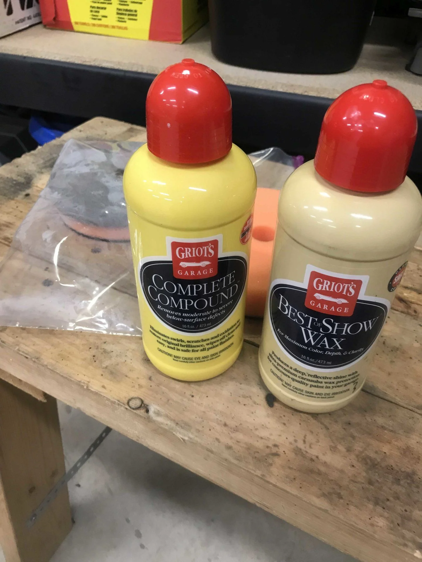

After a good cleaning, try Griot's Garage Complete Compound with a DA orbital polisher and a orange Lake County Force pad.
Oh my, what a difference it will make.

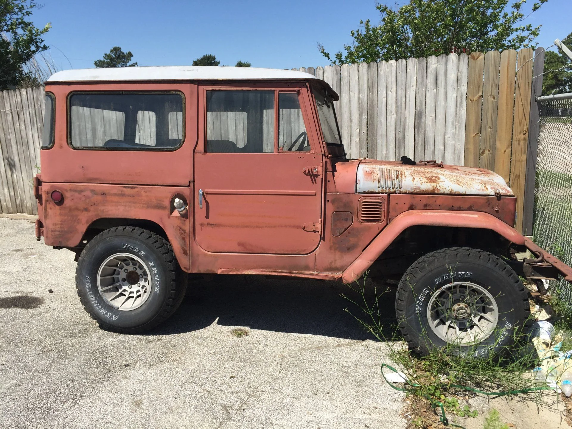

Yeah. That’s a perfect candidate for CLR and Scotchbrite on the main red part then do the Griot polish.
On the roof as said above, look into Goof Off on that. Get it back to white.
That truck will end up looking new.
Thanks very much.
We don’t have Goof Off in the U.K. Are there any other alternatives?
It’s basically strong paint thinner.
The theory is the OE paint is way harder than the overspray so you can rub the new paint off and not damage the original.
I recently used acetone to remove overspray on a 2003 Chevy tahoe. It worked perfect. Didn't harm the factory paint at all. Acetone evaporates quick so you'd have to work in small sections. Not sure how it would work on a solid painted area, I was just dealing with overspray:meh:. I just used cotton towels soaked with acetone so as to not scratch the paint.
I'd consider the hard top paint chipped or scratched at a minimum. Solvents and the fiberglass top, or epoxy seal, might not work well together. Acetone is really hard to keep from being exposed to. I've had a few headaches, in the past, from it.
Duplicolor Wimbeldon is an approximate white that might get you back to more of a factory look, however, rattle-can is borderline heresy, particularly, on this thread.

Thanks. I don’t mind if the white roof is not in perfect condition. I just want rid of the red paint. In any case, it shouldn’t look too perfect as it wouldn’t be in keeping with the rest of the patina.
What I meant was the chemical onslaught would be fine on painted steel, questionable on painted fiberglass and epoxy.
Heck no it’s not. I’m a big fan of rattle can.
