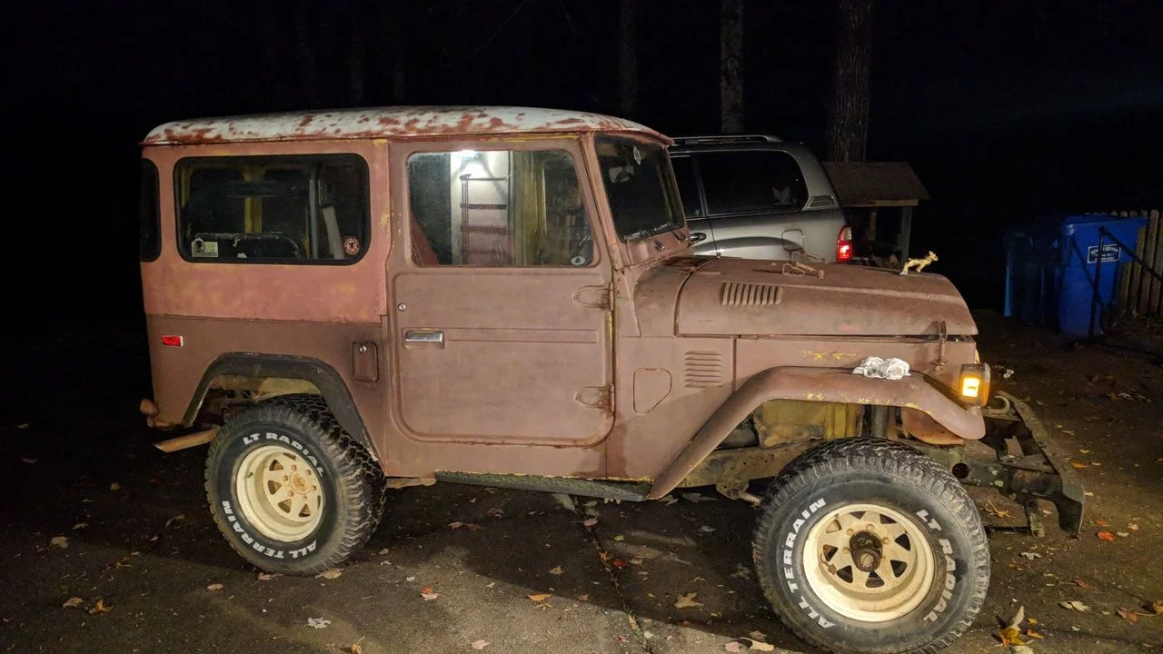

My fj55 started like this
And now looks like this. Rough but pretty cool.

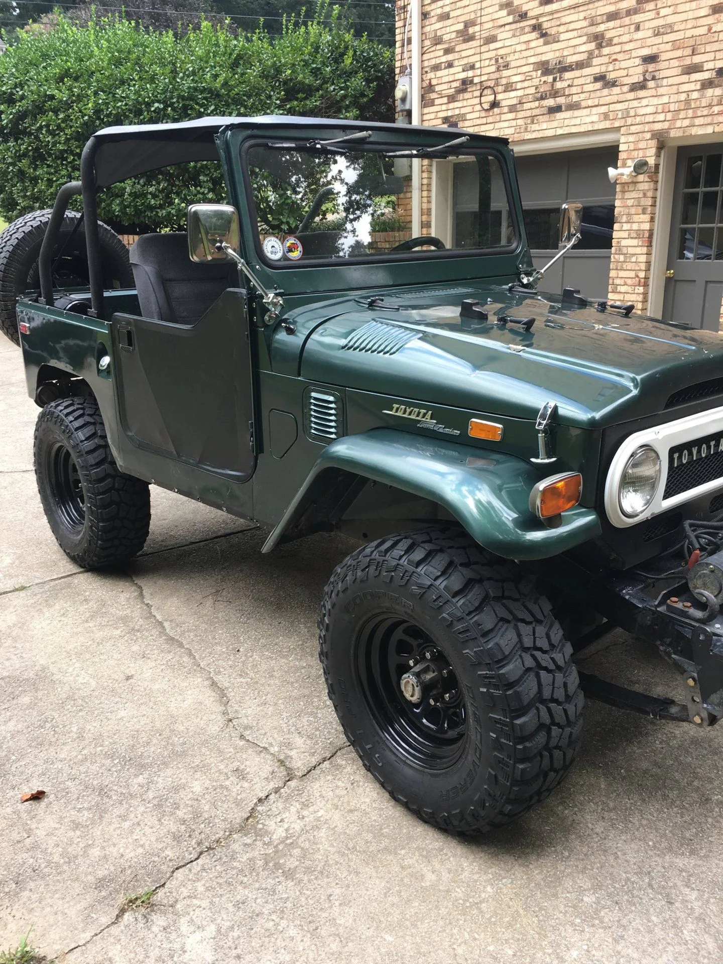

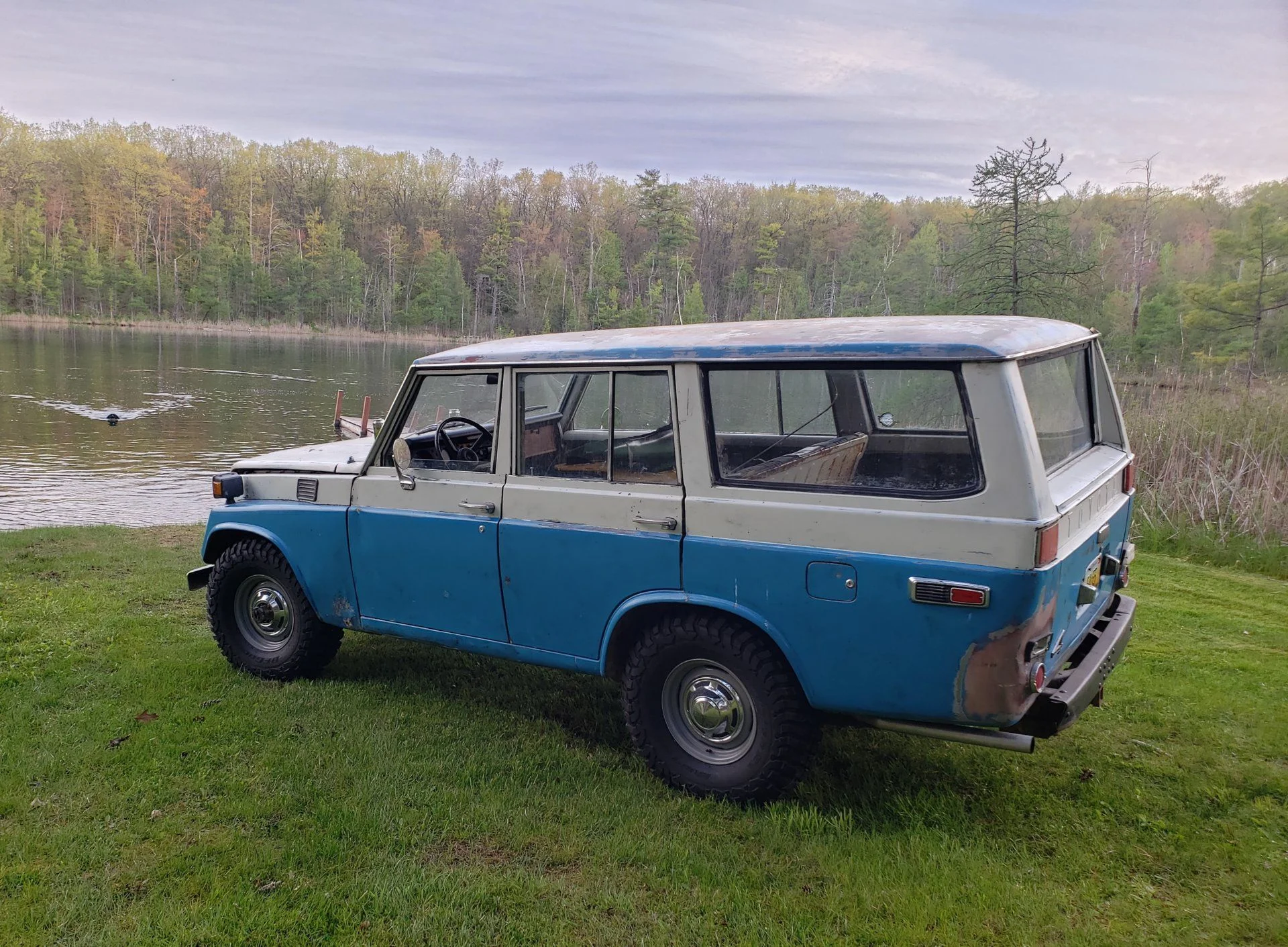

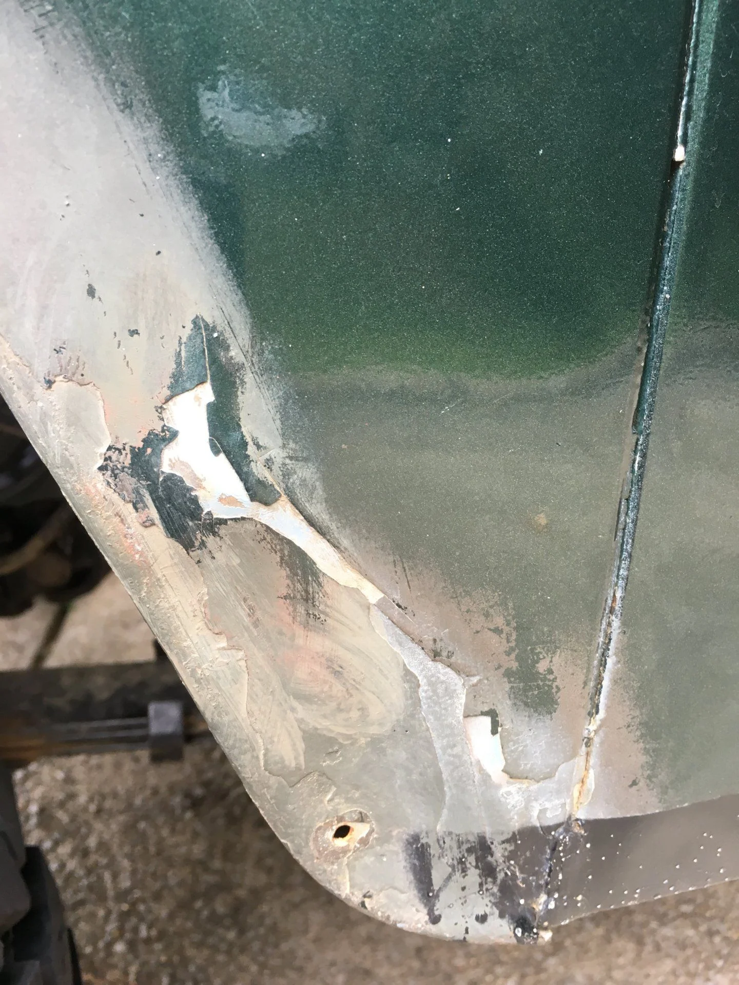

My 40 was repainted at some point in its life, but the quality was not very good. You can still see bits of the factory blue paint around knobs and on parts of the body where the respray was not done well.
I really like the green, but have no idea what color it is and it would be very hard to match (to do touch ups etc).
The stock blue color is one of my favorites and I’d love to see what it looks like underneath, but I’m not sure how or if it’s even a good idea to try and tackle such a job. I would have to go through the green paint and primer to get to factory blue. Any thoughts or suggestions?
How long did you leave the Easy Off on?
I experimented with a small section for a short period, like 6" x 6" and scotch brited almost immediately to see how things went. By the time I was rolling, I would spray the whole truck pretty well then start the scrub.
Then I would hit just the red paint all the way around and repeat.

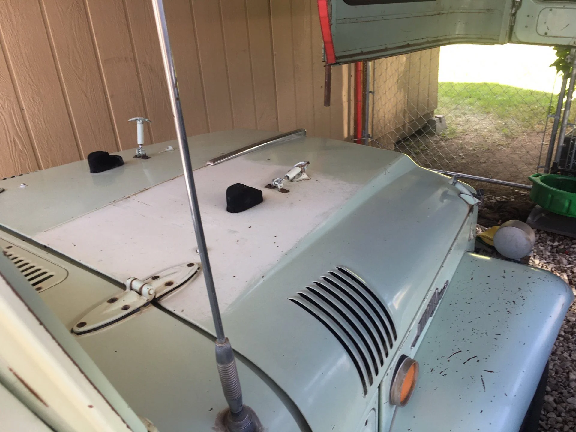

@parrot looks like you have enough good paint to skip the oil and go the polish/wax route
That was my thinking too. Just getting the oxidation off has done wonders. Even the wife and kids are saying "Hey!" after encouraging me to get it repainted in the past. I just quote them the sage words I've leaned here; "It's only original once."
I've never really polished anything. I have access to an orbital buffer. Should I use that or better to do it by hand?

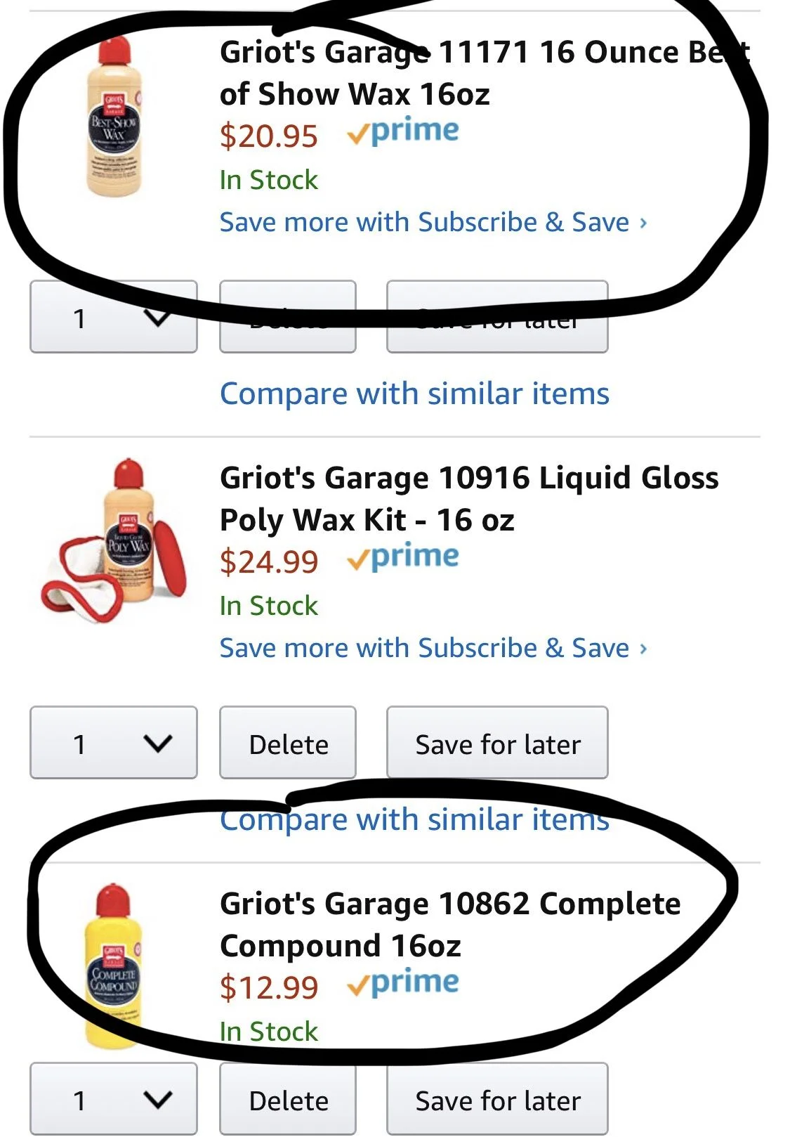

Orbital. Get some yellow label Griots and some correction pads then follow with wax with orbital.
If you have open bare rust spots stay away from them. If you get wax in there or on the small spots if found Fluid Film does a good job of removing the dry wax in a rough spot

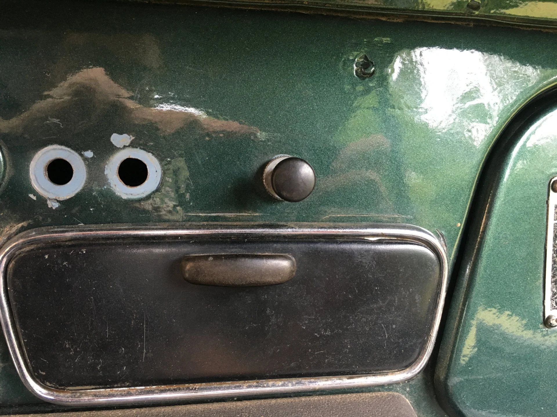

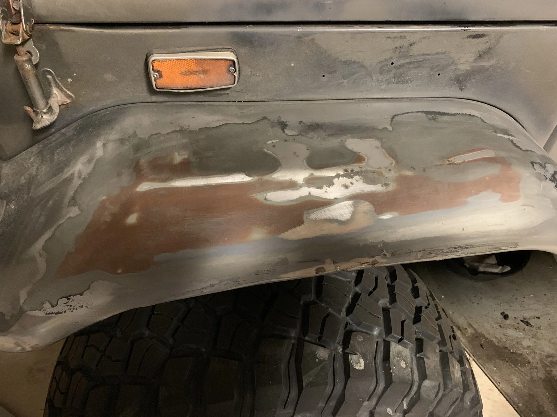

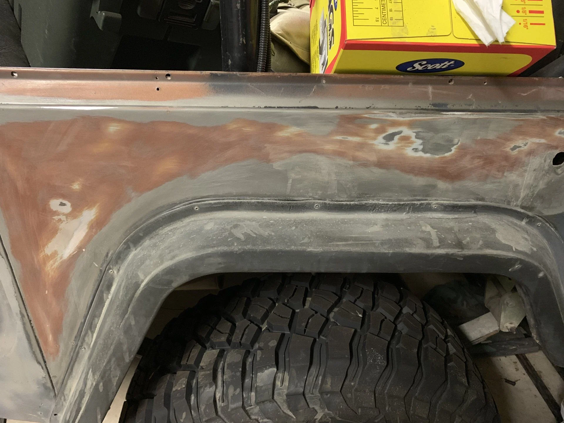

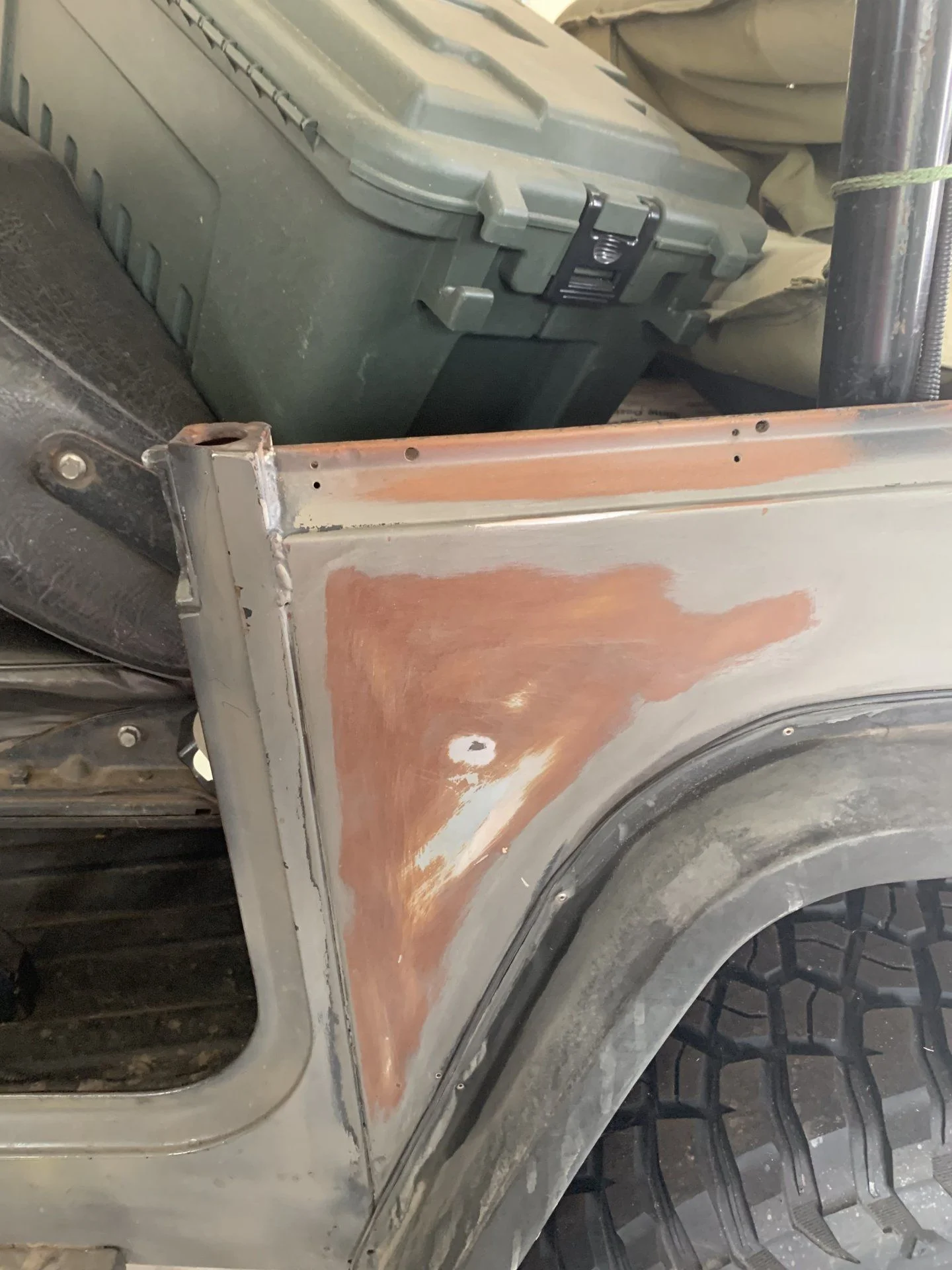

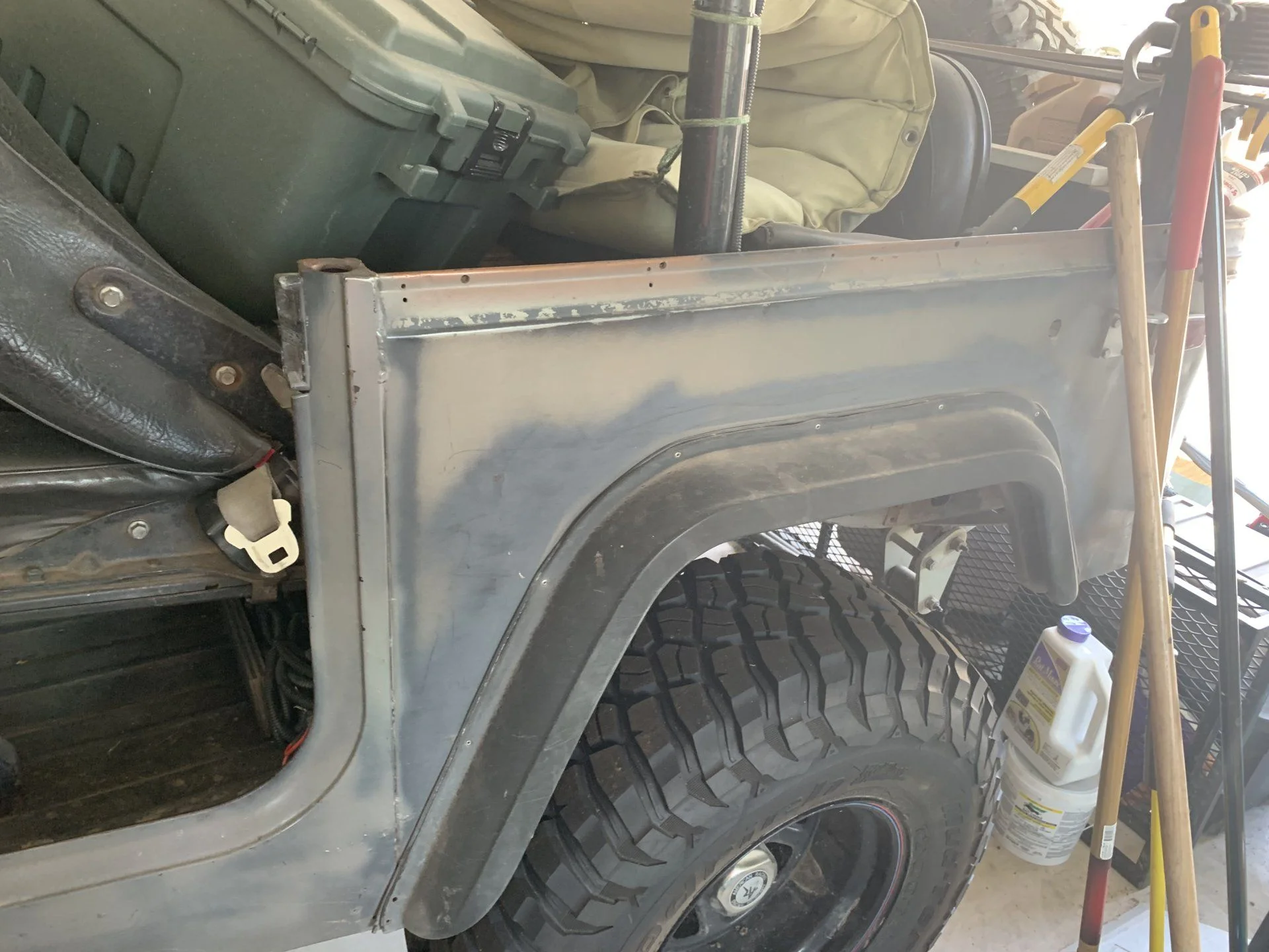

Okay first off this may be my favorite thread but I have some questions I’ve had my 40 for a year and after replacing the PO blown 350 and using it for a deer season it’s time to address the paint I have been going back and forth from rattle can to bed lining until I found this amazing thread. I follow you on IG 89 and love the stuff you’re doing. Now I wanted to see what I had I knew I had either Pueblo brown or orange Pollux or a bronze but can’t find a bronze in the 74 paint codes. The dash fuel door and glove box show it’s more bronze. Wel I tried goof off and scorch brite but it looks like I burned thru some original and the black the PO did over the gray comes off easy but not sure if I’m doing it wrong the grey doesn’t come off too easy did I screw up and any pointers are appreciated.
Here is the dash color as well and I have no idea if it’s orginal or not
I wonder if I’m burning thru the paint to fast because it wasn’t orginal and it was a repaint looks like 2 or 3 coats of a gray I did use a orbital with 800 and worked down to 320 and I think that was too aggressive I’m going to give this half of it a good try and then possibly just rattle can.
On the exposed metal should I match it or treat it and leave it?
