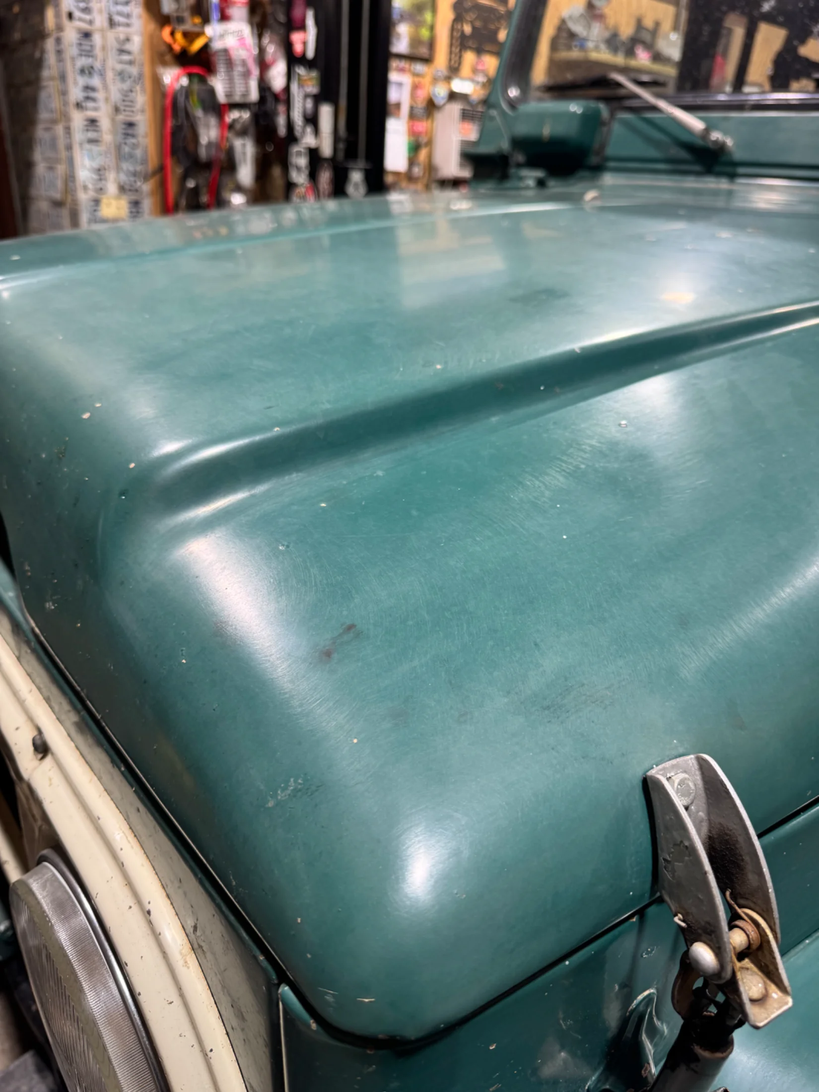

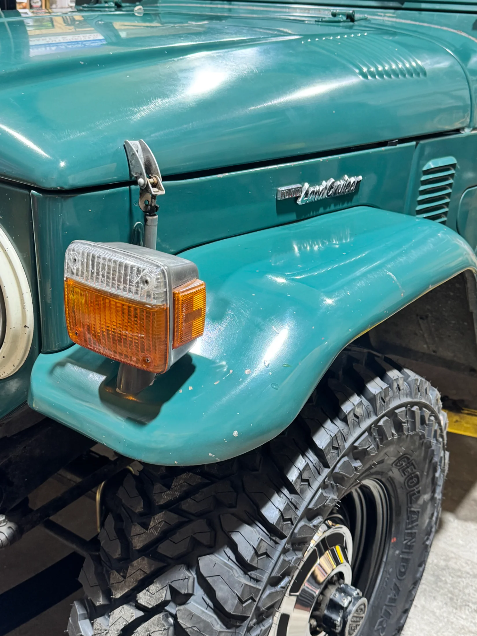

This one owner California truck is in the shop. Owner bought it new when he was 25. Going to work on making the original paint pop
After
Working your magic again, looks great. I see the owner has yokos. I bet I'm not in the minority of folks in the LC community that purchased a set of those because of how awesome they present in your threads. I think you need to collect a check from mr. yoko for the free adds. They look just right on 40's IMO.

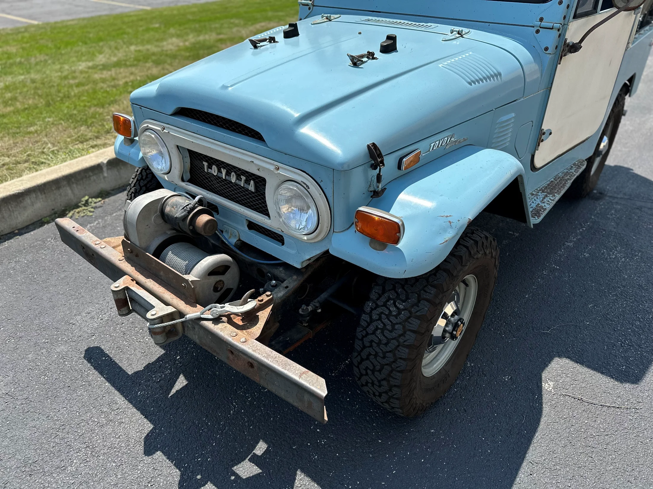

OG Capri blue paint on the '72 I would like to get looking better.
Thinking of going straight to buffing with a DA orbital with orange pad with the Griots complete compound and then finish with the griots best of show. Looks like someone did a CLR scrub w/ a scotch brite pad or something similar on the paint as there are a lot of fine scratches I would hope to remove.
To the Patina Pros ..Look like a good candidate to go straight to buffing?
May experiment with CLR scrub on the front bumper.
Yes, paint feels pretty smooth in most places. No oxidation I can see in person either. Will report back soon when I get a chance to do some work on it.

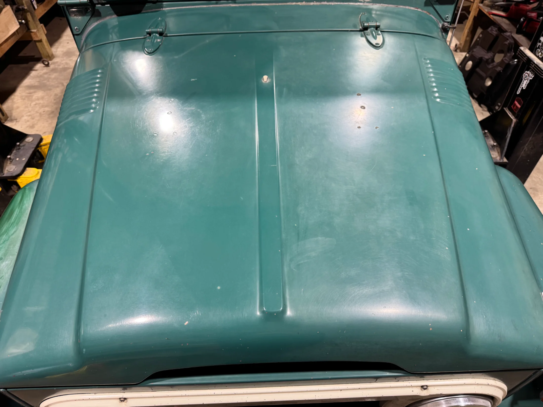

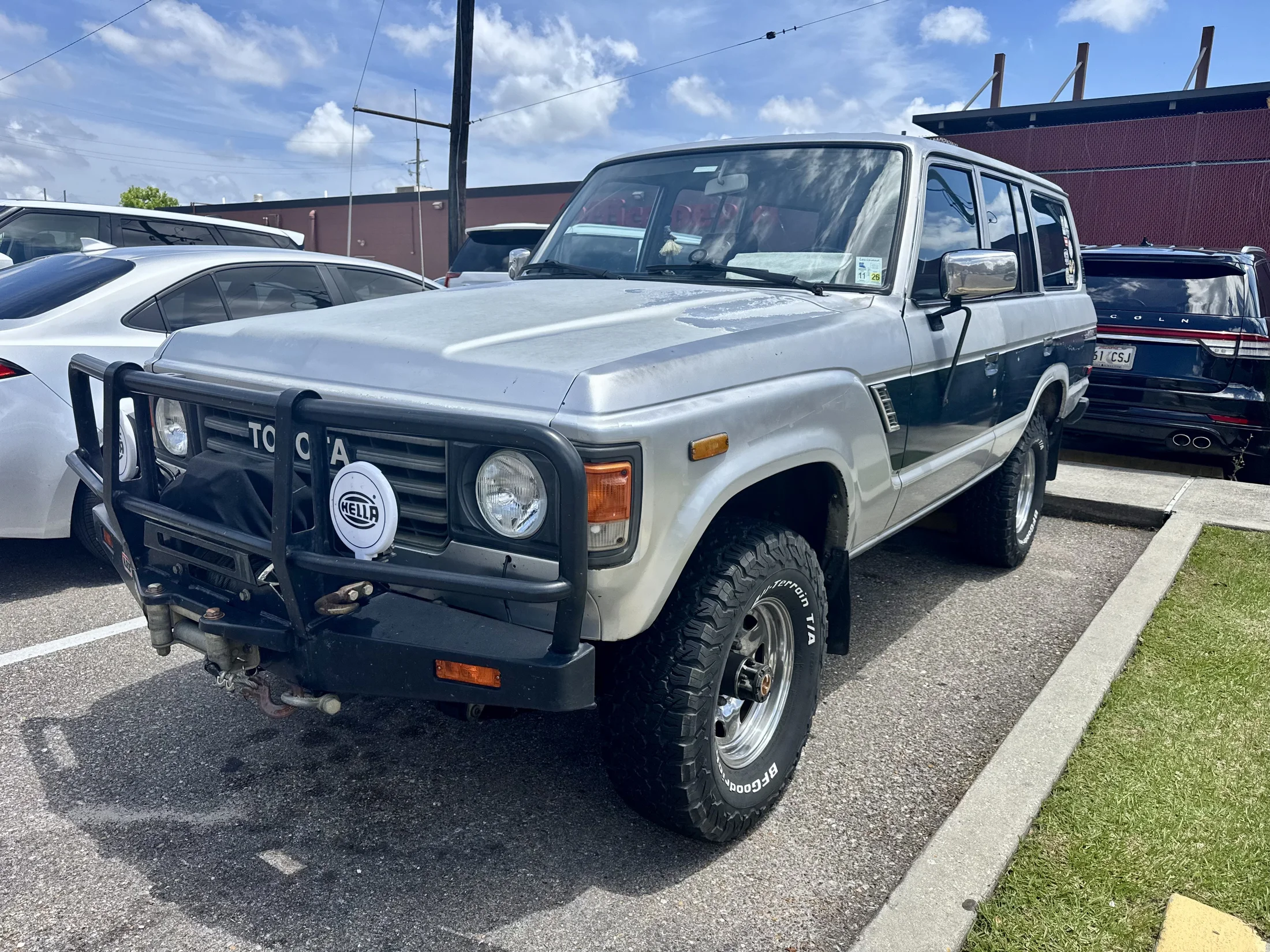

Found this thread and have been reading over it trying to figure out what is the best option for mine. The clear has failed on the hood and just below the belt lines on the door. It’s also peeling on the green (you can see if you zoom in).
Should I skip the CLR scrub and go directly to fluid film or just use my orbital on the paint without clear to see how that comes out?

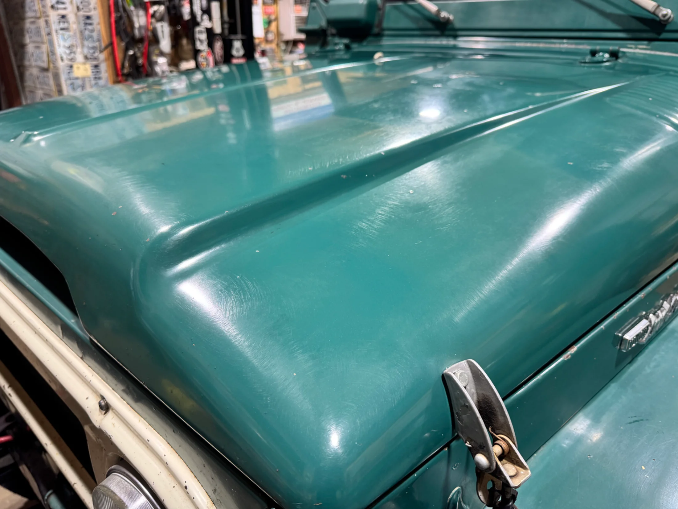

Patina preservation is underway!
I have just done the step with the orange pad and haven't applied any wax yet. I love this old paint, it's amazing what you can get out of it with a little effort. The reflections are crazy to see. Trying to remove all I can like badges, lights, and trim.
Now a question to the group, this is a well preserved example of a FST 40. I wasn't expecting the paint to clean up this well. Do I replace all the removable parts like the hood hooks, badges, lights with new OEM to freshen up? Or put the worn originals back on? I am 50/50 here. The originals are nice (and will be kept regardless). But I also like the pop of some fresh new parts on a polished up patina body.
Hood pad removed, original Capri Blue paint hiding.
Hood before. Hooks and pads removed. No polishing done yet.
2 passes with the Griots compound and orange pad on the fender, apron, hood, bezel, and below the soft door. Only pieces not done in this photo yet are the windshield surround and soft door pillars.
Left - B pillar polished, Right - soft door pillar untouched.
Cleaning up nice! Had to test fit a new OEM badge I had on the shelf. Very happy with the results so far.
