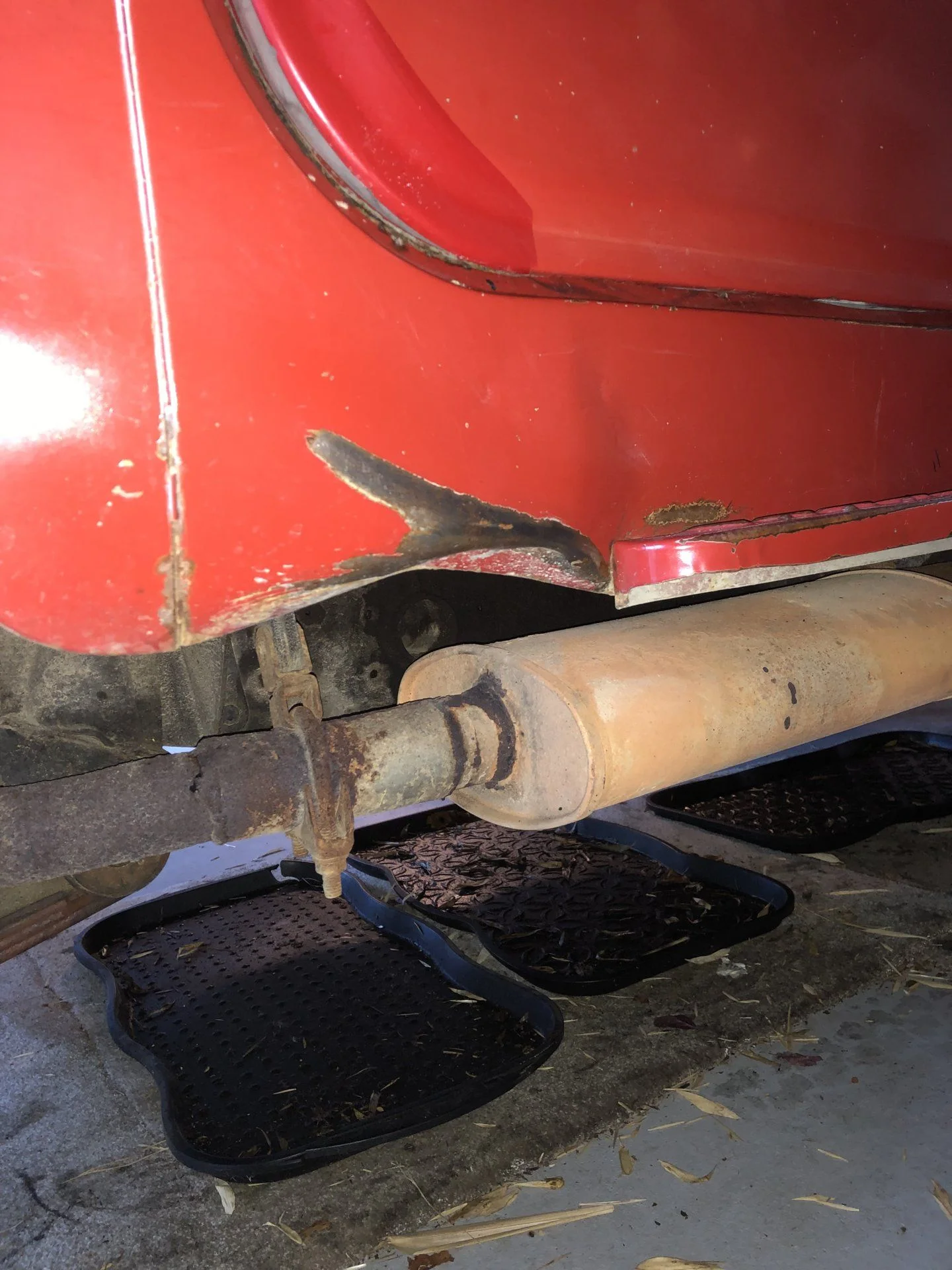

Previous rattle can job of shipping damage:

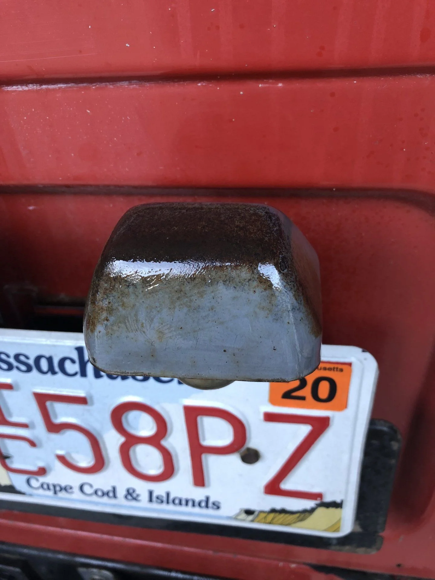

Fluid film on license plate holder:
The rattle can clear coat did a great job of rust inhibitor. I plan on doing the fenders at least, as I use them as tool holders whenever doing engine work.
Just keep a light coat of Fluid Film on it. Don’t prime that.
Keep it thin and it won’t pick up dirt as bad. I keep it heavy under all my trucks. Yeah it picks up dirt but when you pressure wash it off it leaves the cleanest frame and undercarriage ever
I’ve pretty much stopped using Boiled Linseed oil and gone all Fluid Film
I’m totally against this. You are basically painting over rust which gives rust a wonderful medium to grow.
Oil is the way to go if you want the look.
Have you tried Coconut oil yet? Seems to be a trend in boating now that you can buy it in bulk from club stores and Amazon. May be suitable for the gel coat on the roof at least.
Like I said. I’m really moving to Fluid Film for everything oil related. It is amazing stuff.
If it’s got a good layer of paint or gel coat, I use polish and wax though. No reason to have dirt attracting oils on solid paint.

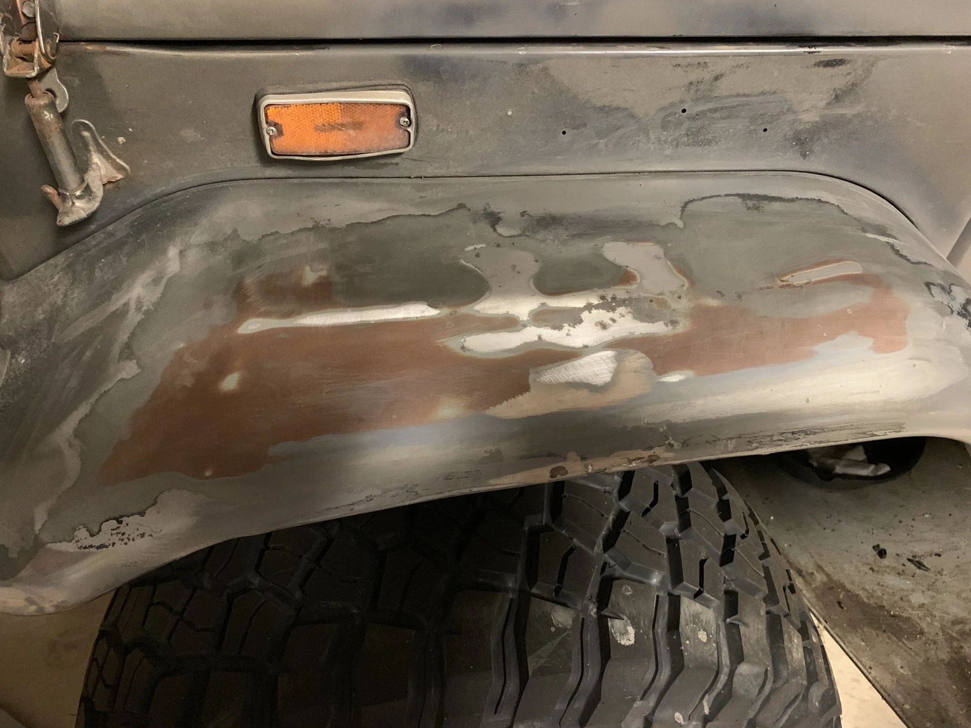

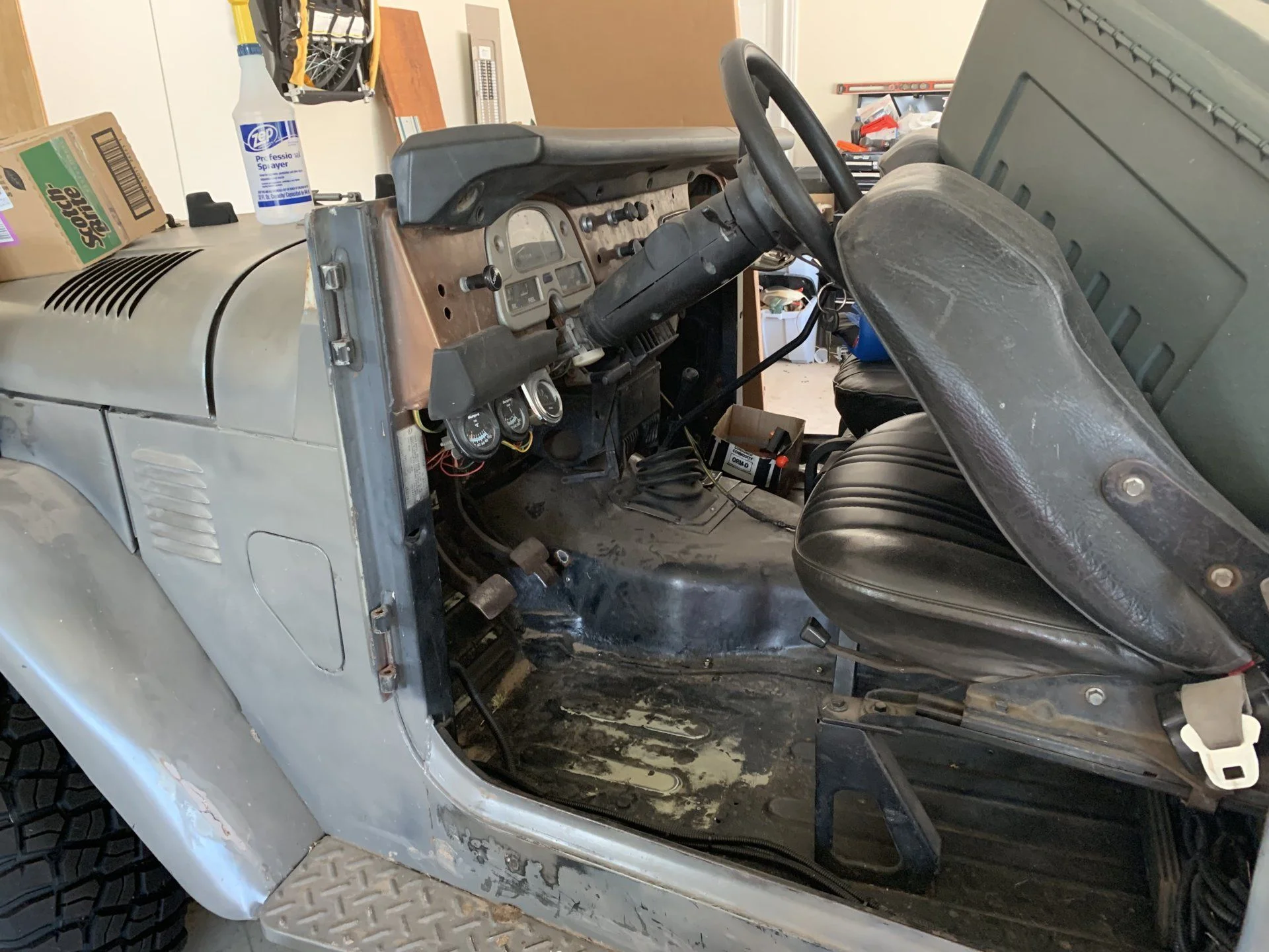

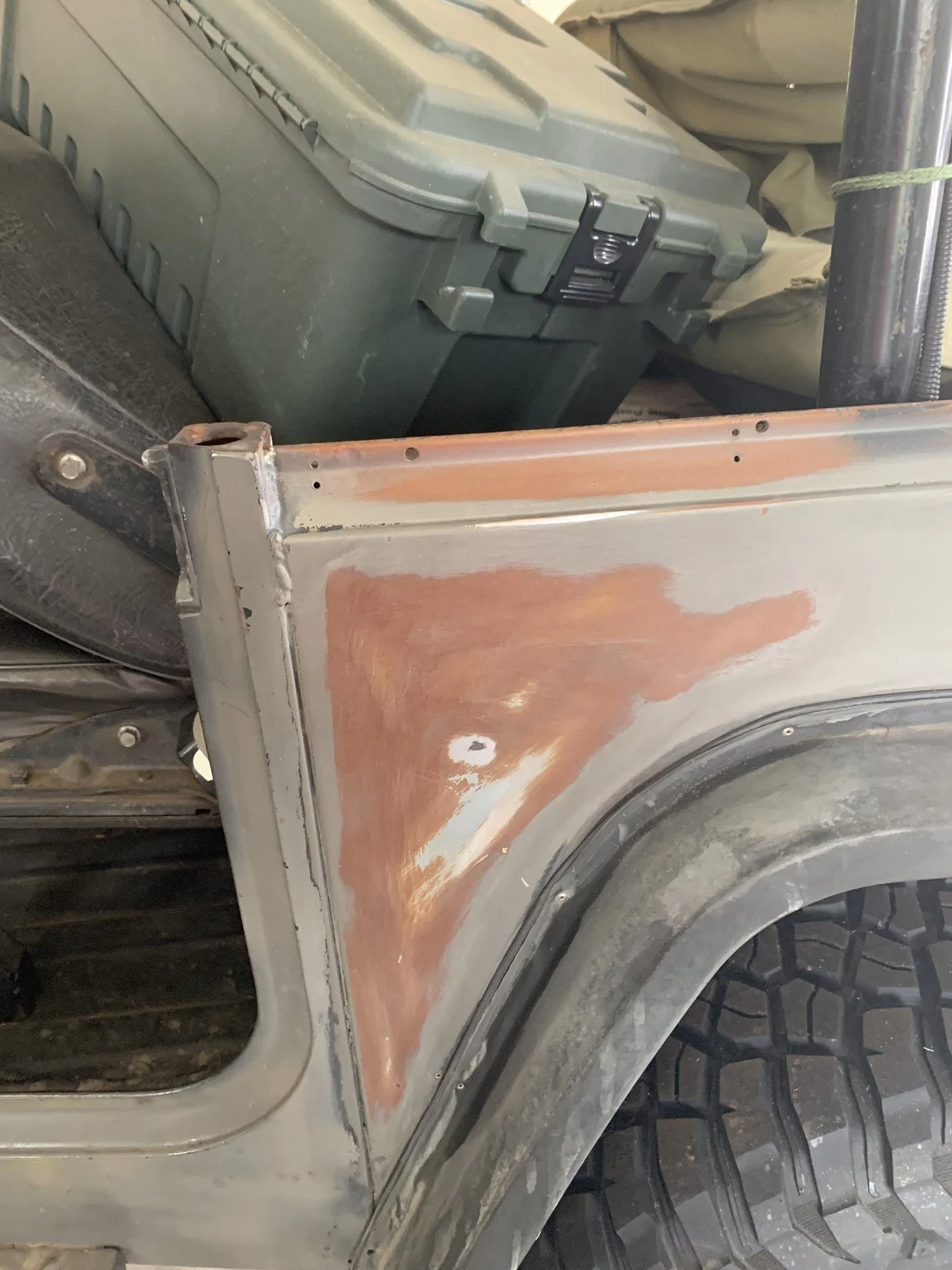

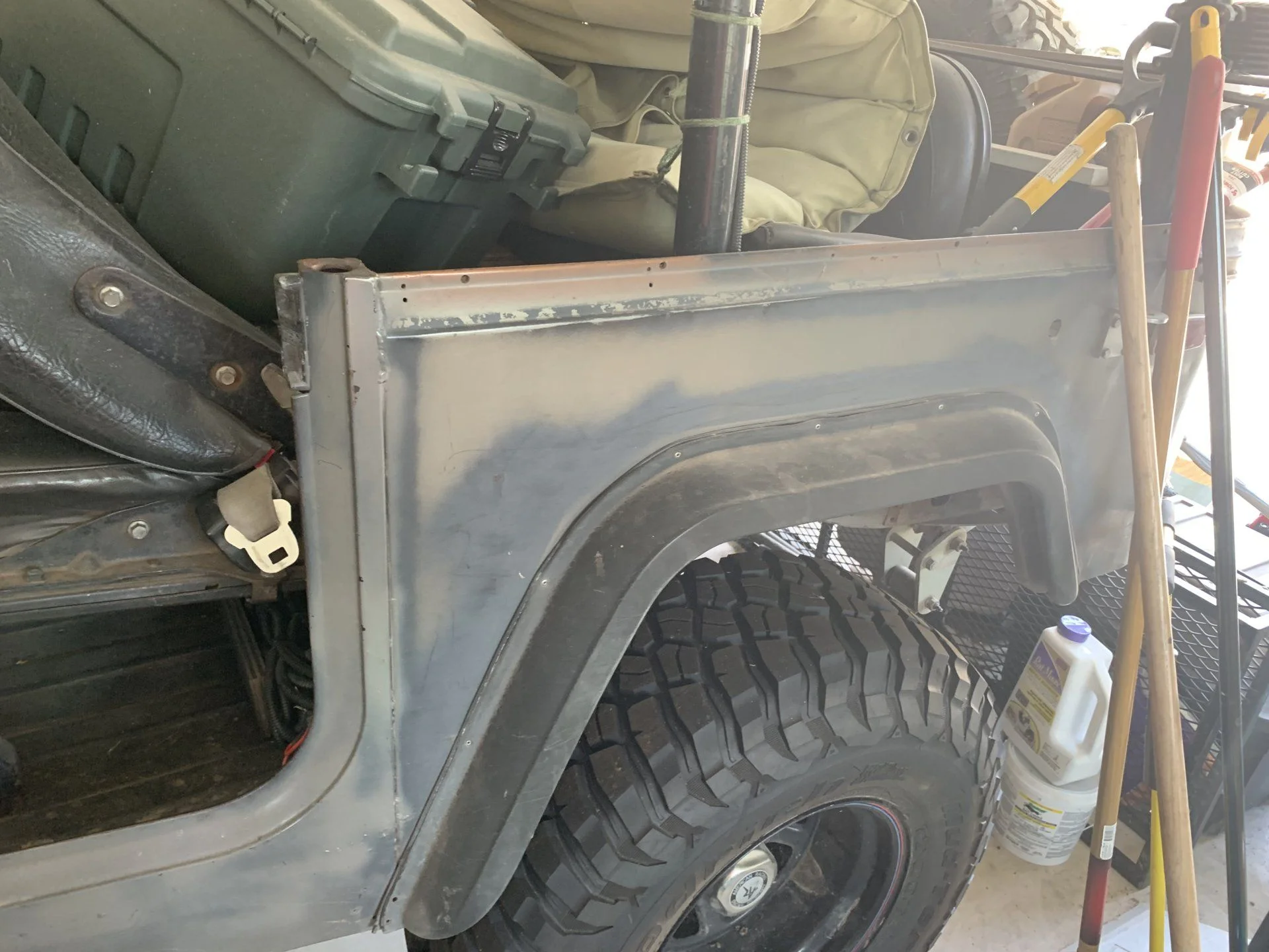

Okay first off this may be my favorite thread but I have some questions I’ve had my 40 for a year and after replacing the PO blown 350 and using it for a deer season it’s time to address the paint I have been going back and forth from rattle can to bed lining until I found this amazing thread. I follow you on IG 89 and love the stuff you’re doing. Now I wanted to see what I had I knew I had either Pueblo brown or orange Pollux or a bronze but can’t find a bronze in the 74 paint codes. The dash fuel door and glove box show it’s more bronze. Wel I tried goof off and scorch brite but it looks like I burned thru some original and the black the PO did over the gray comes off easy but not sure if I’m doing it wrong the grey doesn’t come off too easy did I screw up and any pointers are appreciated.
Here is the dash color as well and I have no idea if it’s orginal or not
View attachment 2048251View attachment 2048252View attachment 2048253
I wonder if I’m burning thru the paint to fast because it wasn’t orginal and it was a repaint looks like 2 or 3 coats of a gray I did use a orbital with 800 and worked down to 320 and I think that was too aggressive I’m going to give this half of it a good try and then possibly just rattle can.
On the exposed metal should I match it or treat it and leave it?
I hadn't checked back in a while so hadn't seen this post. I think it would be best to stay away from sanding on the truck because you just can't avoid taking off a lot of the original paint. That sure looks like Pollux Orange which would be sweet. Try all of the other suggestions: Easy Off, Laquer thinner , and urethane bumper stripper. Once you get a system down that works on a small spot you'll be off and running on the rest. That primer looks thick so some form of stripper might get it but you will have to be ready to neutralize it super quick so the stripper doesn't take it all off! (Pun intended)
Simple Zep Citrus Degreaser should work to neutralize?
That should work. Those strippers are water based so lots of water along with it too.
I guess the way I visualize the task at hand is that you can count on a poor bond between the original paint and the offending top coating(s). You are looking for the best way to break the top coatings off without destroying the original paint. The good part is that the factory paint has been on so long that it is rock hard and not easily softened. The newer layers should soften first (to be removed), but the trick is finding what works best.
Going to start next week.
First round will be Easy Off Over Cleaner and scotch brite/gas pressure washer.
Secondly I’ll try some air craft paint stripper and pressure washer.
Got Zep degreaser on standby. I don’t have a lot to finish since @Ben edwards did 80% of the vehicle already.

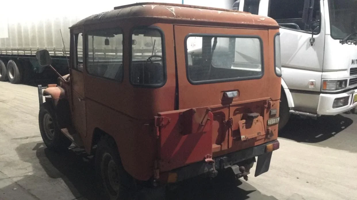

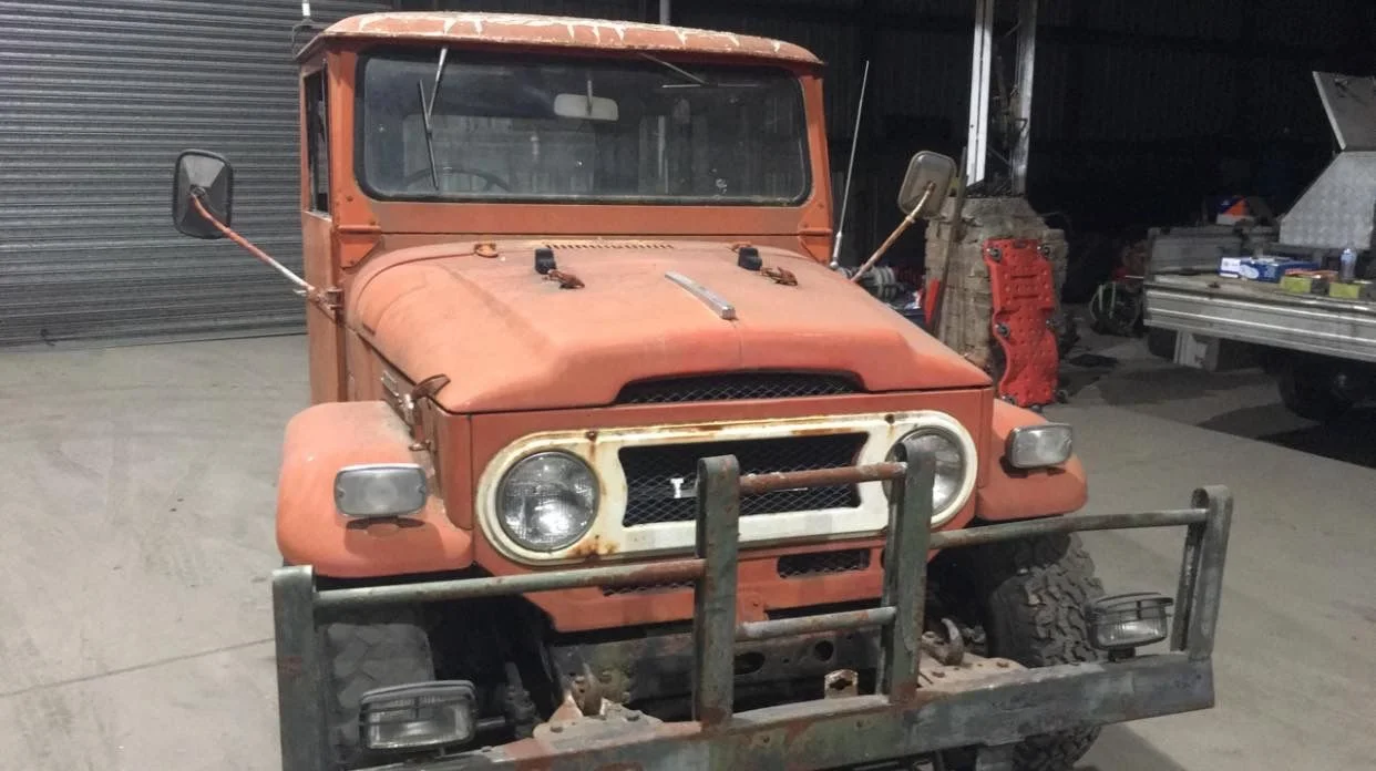

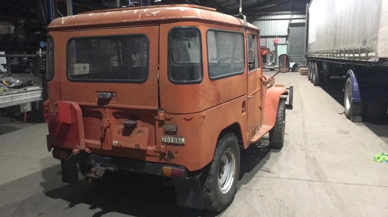

Wngrog - what do you think I should do to preserve and enhance this one’s patina ?
Cheers
That's a beauty!! I'd flip the bezel, power wash it and start buffing that thing out. You'd be surprised how good it will come back.
I'd also ditch the red roof. Try some lacquer thinner and a scotch brite on a tiny section and see if that cuts it out. It should since you can see the white under all the flaking red paint.
Cheers. I don’t really understand why it has a red roof, if the original colour was white with a red body... I take delivery in a couple of weeks.
