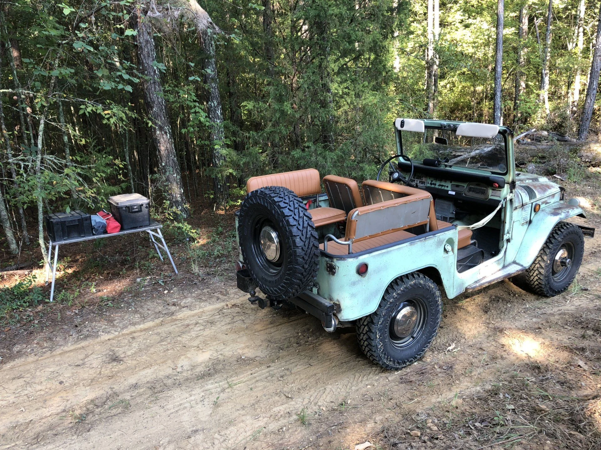

I keep retyping my “formula” for old Patina preservation so I decided to make a thread so I can just link my response to how I preserve my old Land Cruisers the way I do.
For the last 3 years I have been learning how to preserve Land Cruisers in their original state. Protecting their original finish where able to let the worn paint and dents tell the story of the vehicle.
It all started when I found this 1968 FJ40. I immediately fell in love with it and wanted to keep it as close to the same as I could yet build a “sleeper” interior and drivetrain that made it a true driver as well.

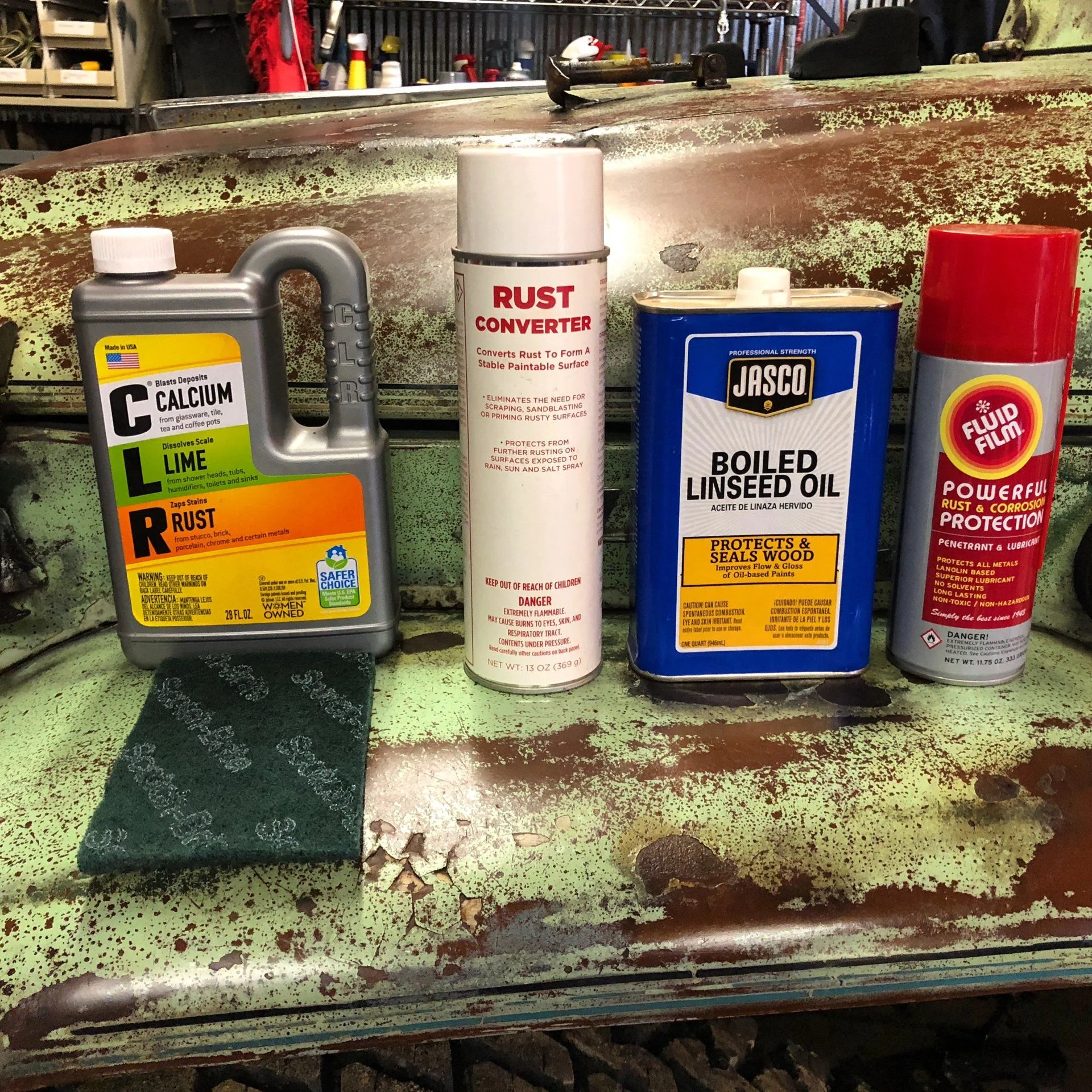

These are the tools of the trade I’ve come to use and love.
They are all used separately and then reapplied as needed.

After a proper wash, I don some rubber gloves and start scrubbing the paint with CLR (calcium lime rust) that is available at the grocery store, via a green scotchbrite pad.
I work a section at a time. CLR then rinse it with water. The CLR will allow you to remove the oxidation and find that OEM paint that might be hiding

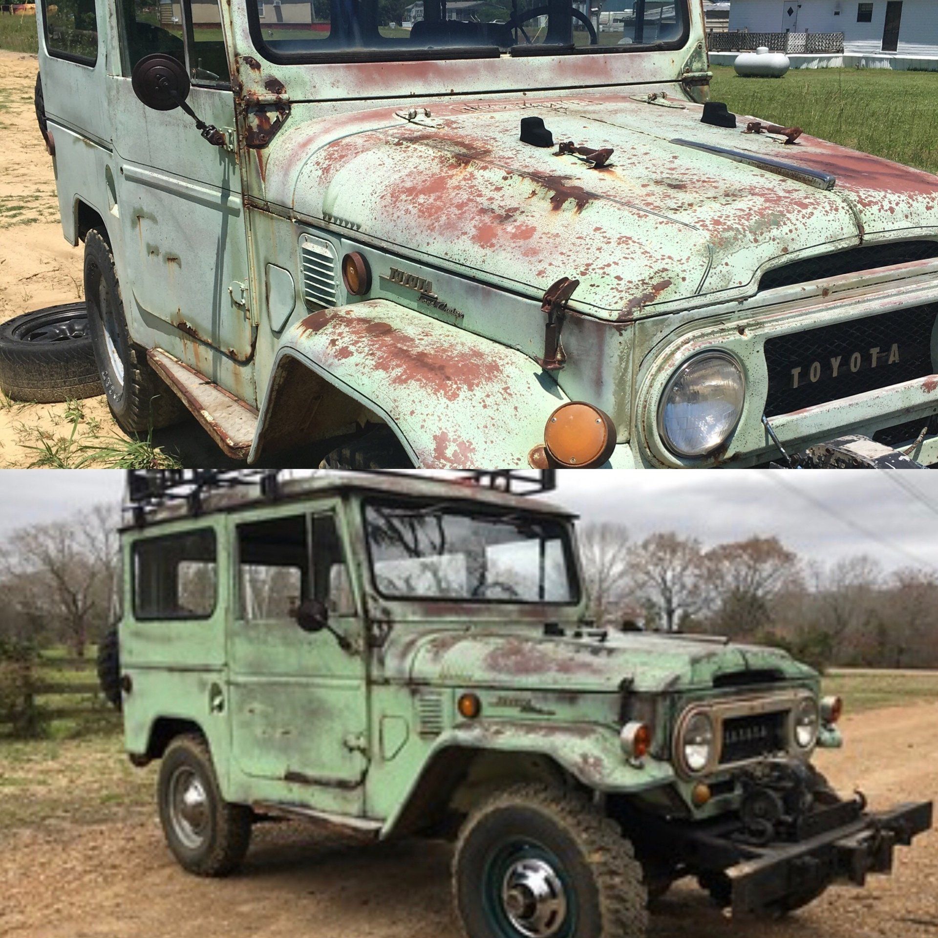

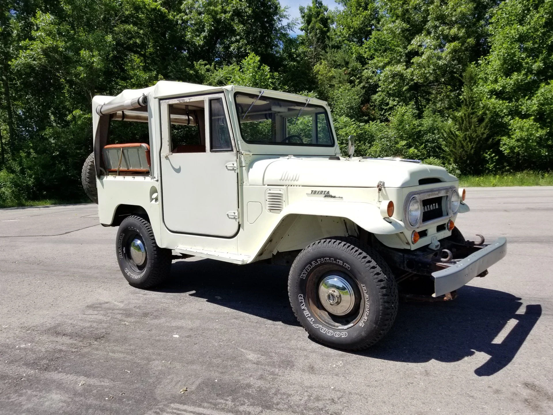

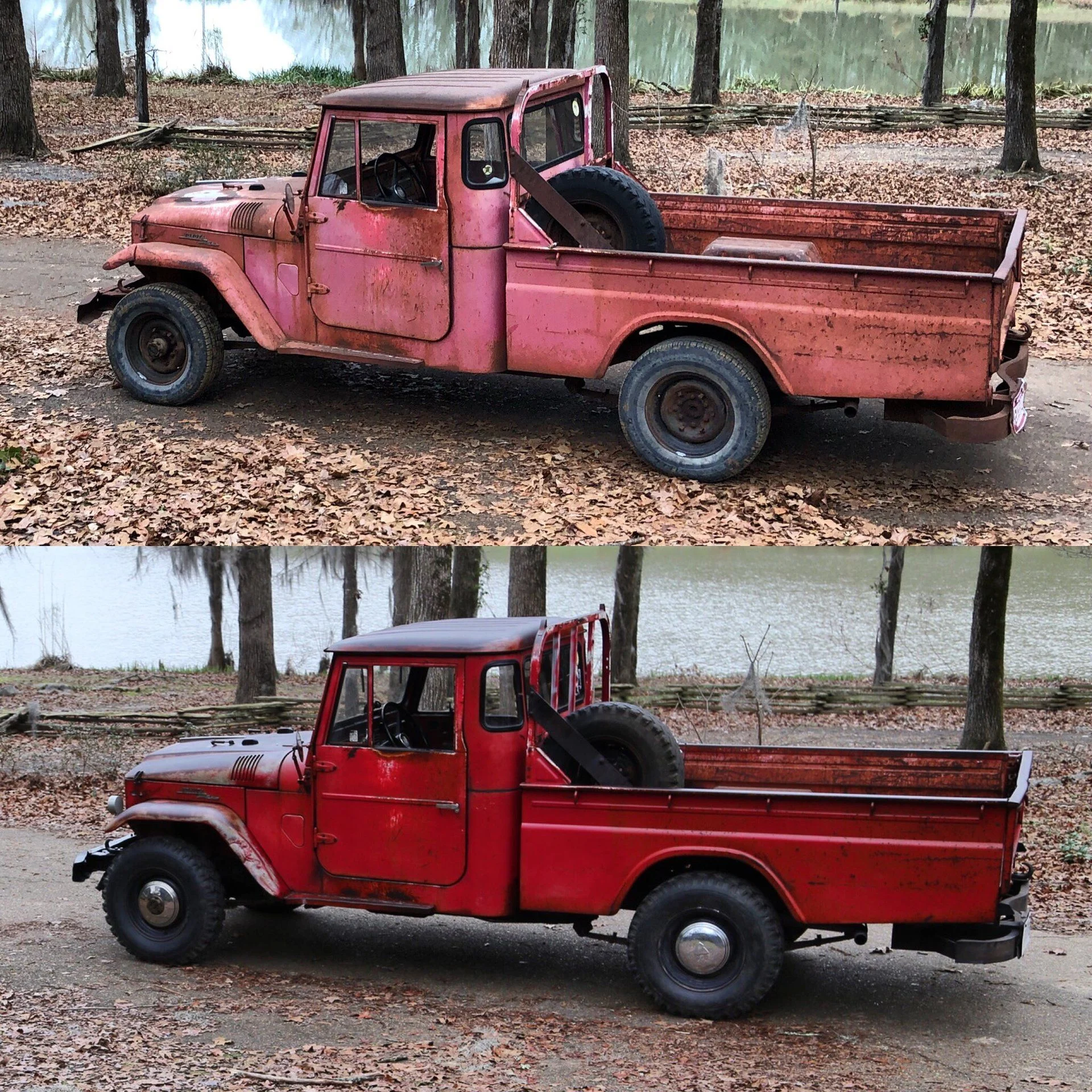

Here is a before and after of my 40 and 45 to see how much color I was able to pull out
IMPORTANT-If you have good, solid paint that will scratch, go very light with the scotchbrite. This will scratch paint. CLR can be applied with any towel or pad. This is for those that have years of oxidation, rust and overspray to get down to what’s there. Use your brain and pressure accordingly. In the case of good solid paint under overspray or oxidation use 0000 steel wool instead of Scotchbrite

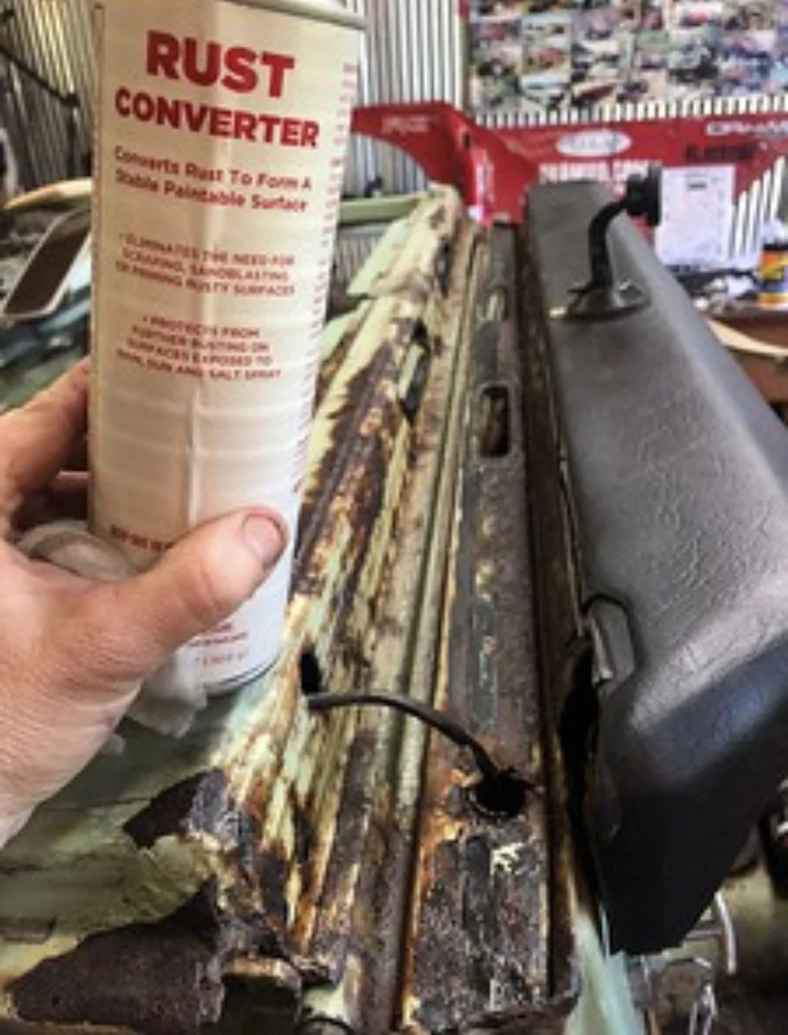

Once I get the paint and exposed rust as clean as possible, then I treat the exposed rust with Rust Converter.
This stuff comes in many flavors but this is the brand I use with great success.
Ps. Make sure you have a respirator because this stuff will Choke you.
www.theruststore.com
The converted metal turns a black color.
Before/after

If you have as spotty paint as The Goat 45 and Project Patina, if you overspray this too heavy on the paint it will soak in and convert through the paint making permanent darkening. I’ve learned to keep the Converter on the bare metal areas as much as possible.
Also, if you DONT want to have the rusted areas turn black you can skip the Converter all together and just use oils.
I really like the Converter steps on frames axles springs bumpers and floors. Also hidden places as above under the gaskets

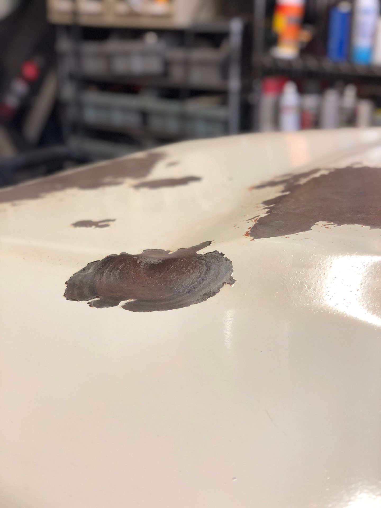

At this point I use boiled linseed oil and rub a heavy coat into the exposed/treated rust and a thin coat on the rest of the truck.
After it soaks in a bit I rub as much of the BLO (it’s got to be boiled Linseed oil, not straight linseed oil) off the paint as I can. I use paper shop towels

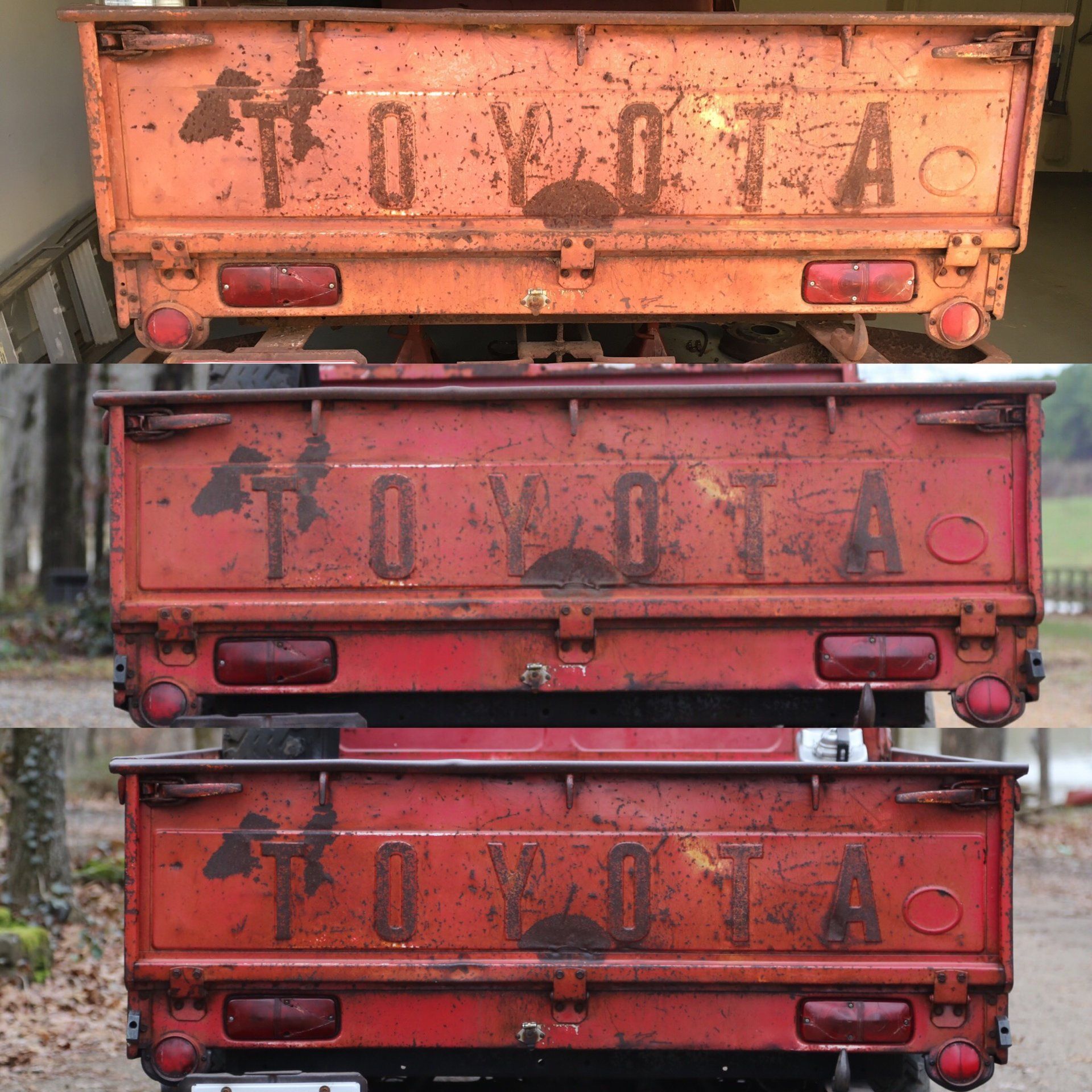

Here is where you can see the difference really well.
Top-Before
Middle-Post CLR scrub
Bottom-Rust Convert/Boiled Linseed Oil

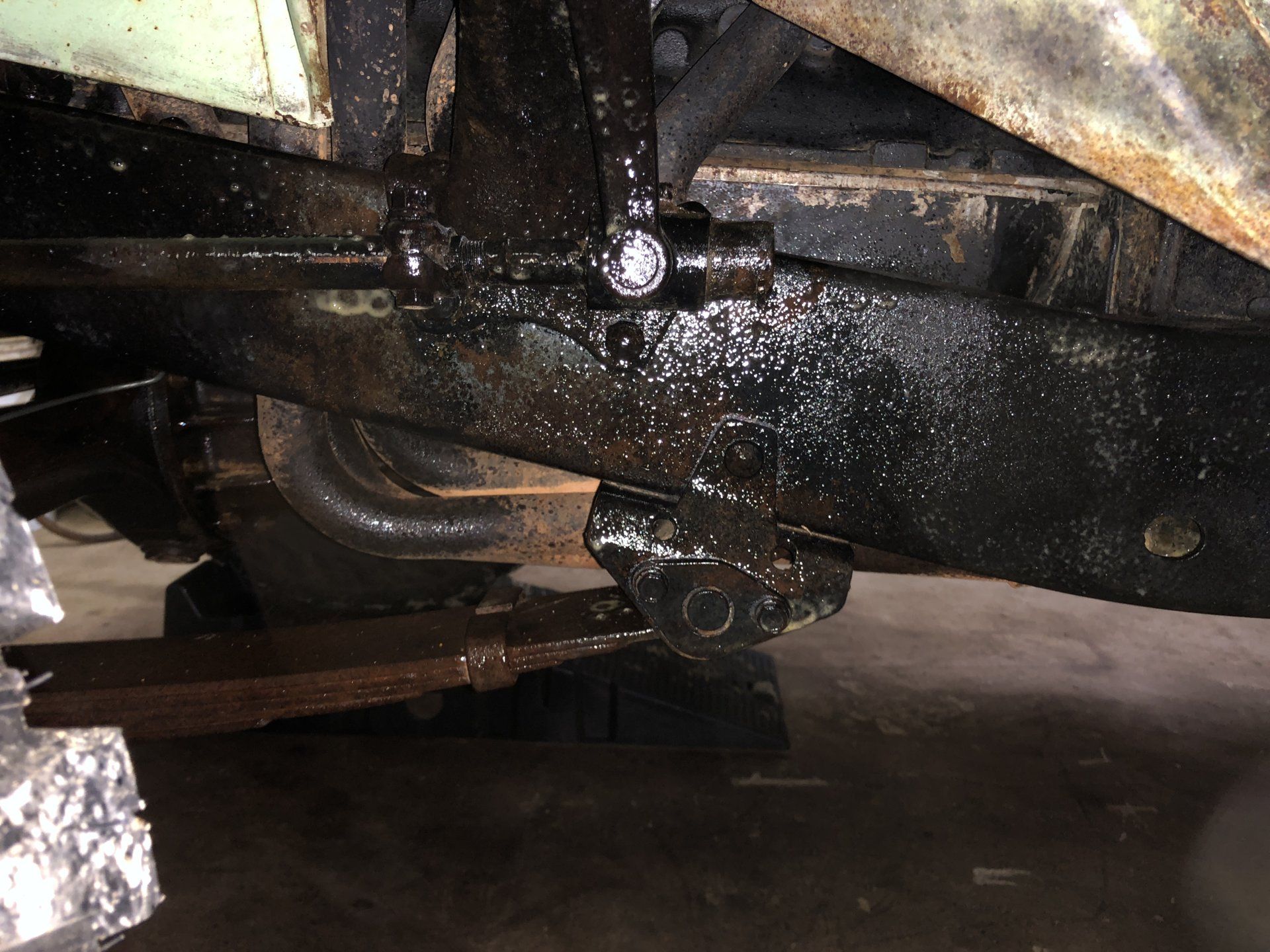

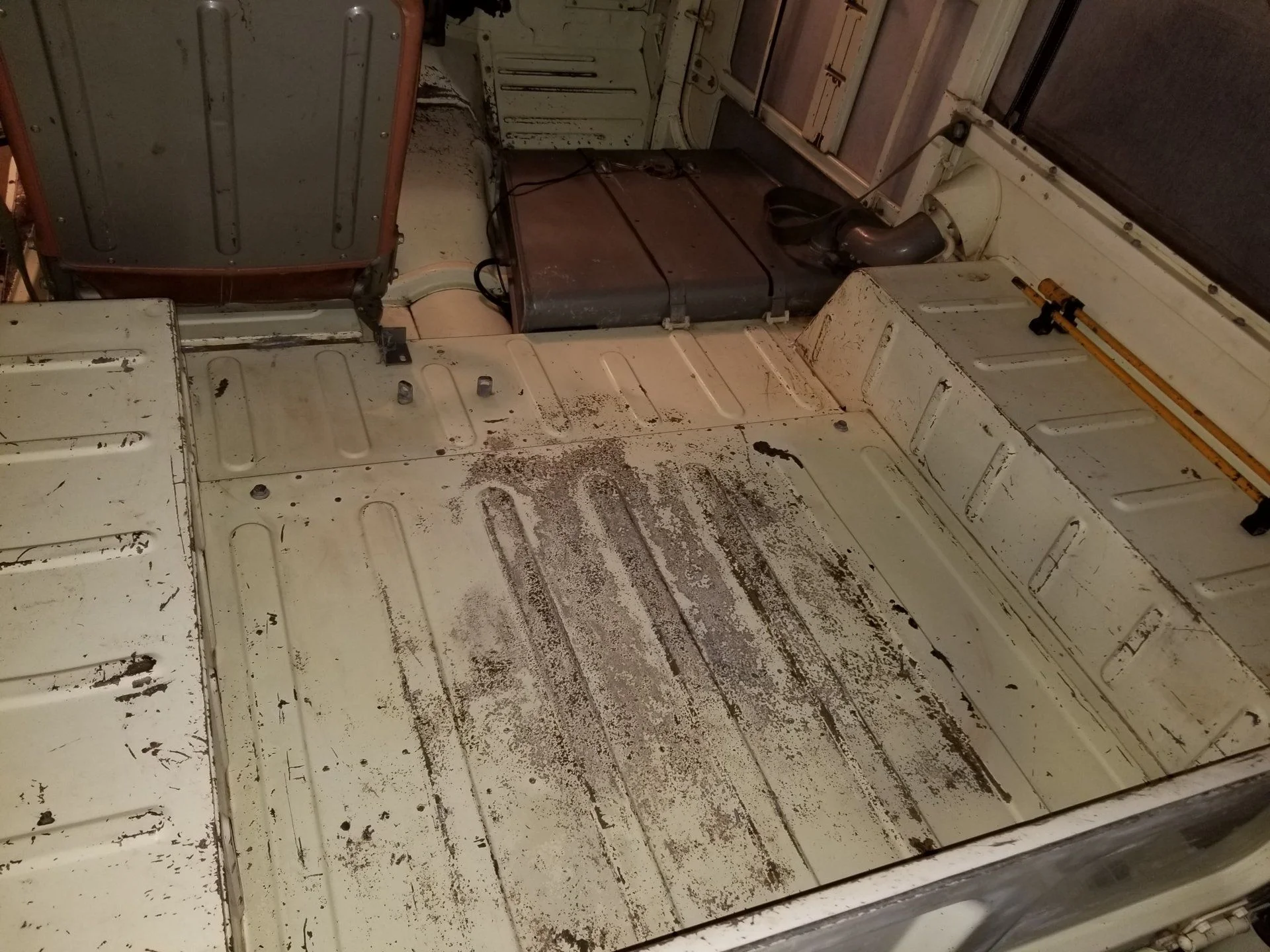

The underside is a little different process.
The obvious first step is to clean the underbody frame and axles as good as possible and then hose it all down with rust Converter.
I fill in holes created by rust after I convert the rust to keep them from filling with dirt and mud later. I use automotive expanding foam and metal body tape among other things.
Once the Converter kicks in I turn to my favorite stuff, Fluid Film. This stuff is a spray film that coats and soaks into your metal to form a protective petroleum based film.
It does not dry out like the rust Converter. It collects dirt over time but a quick blast with the pressure washer and the dirt goes and the fluid film mostly stays.

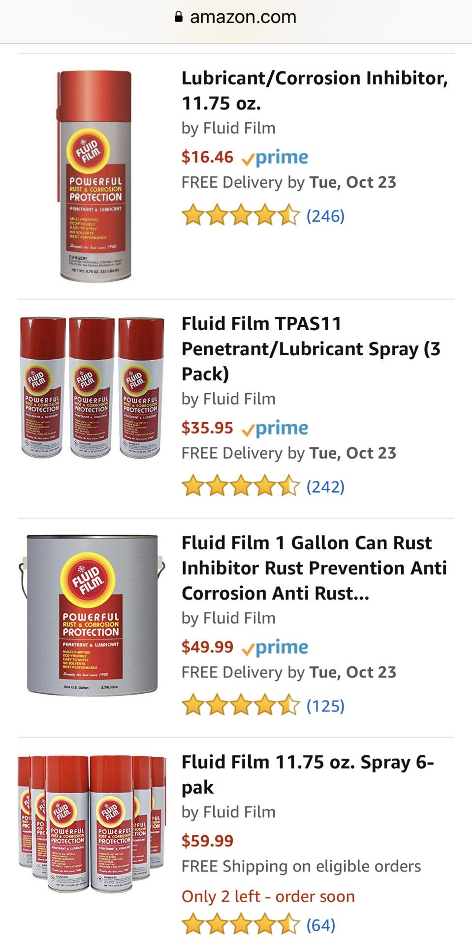

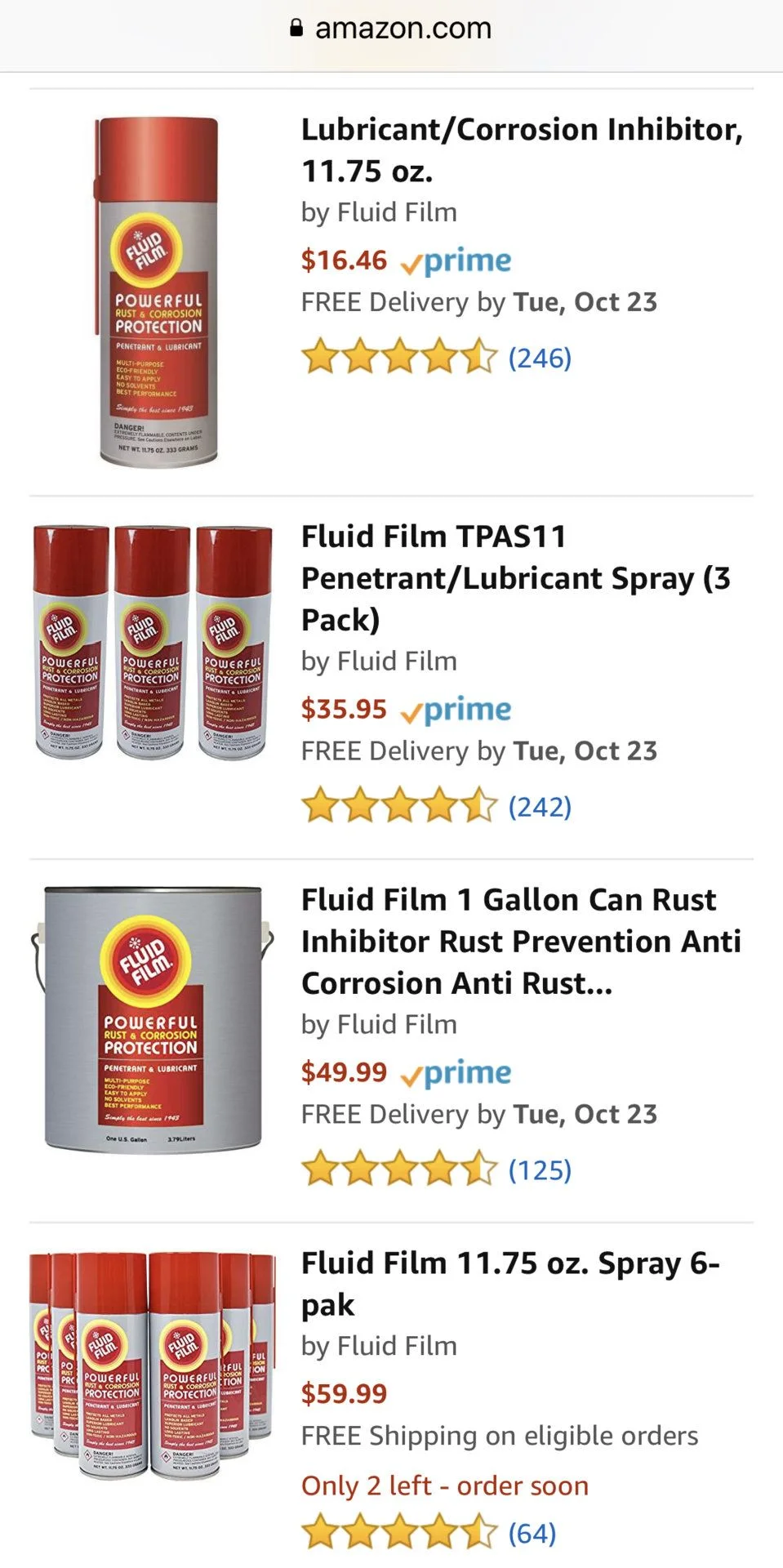

It takes about 3 cans to do the underside of a 40 or 45. I get mine at Lowe’s or Amazon. It’s about $12 a can. It also comes in gallons to use in sprayers.
Edit for correct price

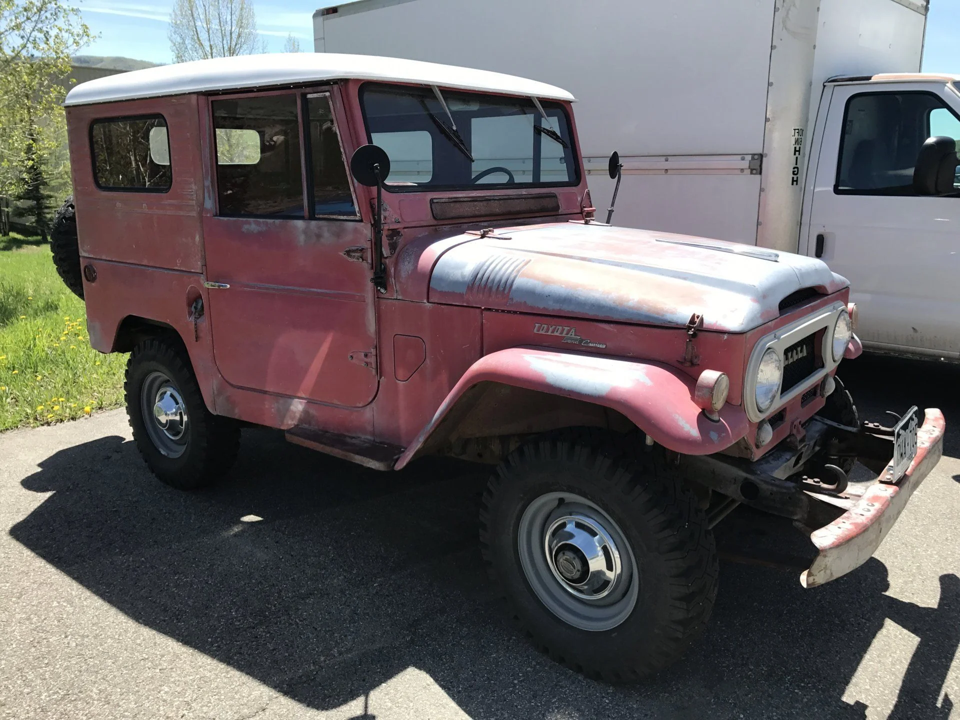

Sure. To each his own. I love a nicely painted Cruiser as much as the next guy but the world has plenty of pretty painted vehicles. I love to see a good story saved if able.

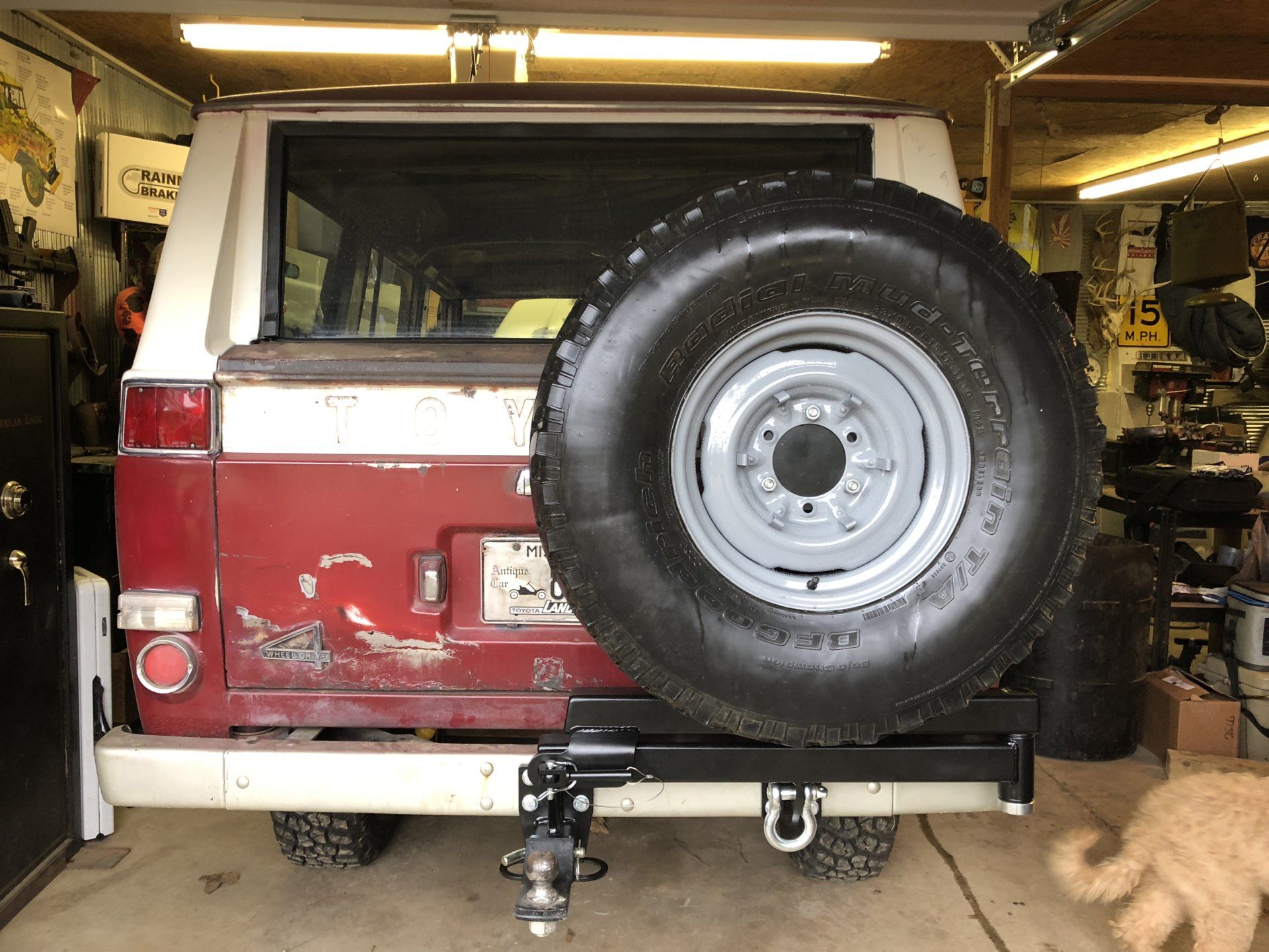

That said I can’t stand chaos. My 55 was chaos.
On it I polished out the factory paint as best as I could and then used BLO to preserve the exposed rust.
Then I rattle canned the chaos colors to match what was left of the factory red and white

I wish I could find fluid film for $4 a can, usually $10 or more for spray cans and $50 a gallon! It's wonderful inside doors, pinch seams, crossmembers, etc because it never stops moving and will creep to cover and soak everything. One drop placed on a piece of rusty metal spreads out and saturates a surprisingly large area.
I have however taken to spraying a hot mixture of mineral spirits, tacky bar and chain oil, and paraffin wax on underbody parts though as it holds up better under a DD. The mineral spirits evaporates leaving a waxy/oily coating that seals everything up and beads off water, even after several years. It's cheap to make too. It just doesn't flow/creep as well as fluid film. I wonder if you warmed up some boiled linseed oil and sprayed it underneath if it would work just as well?

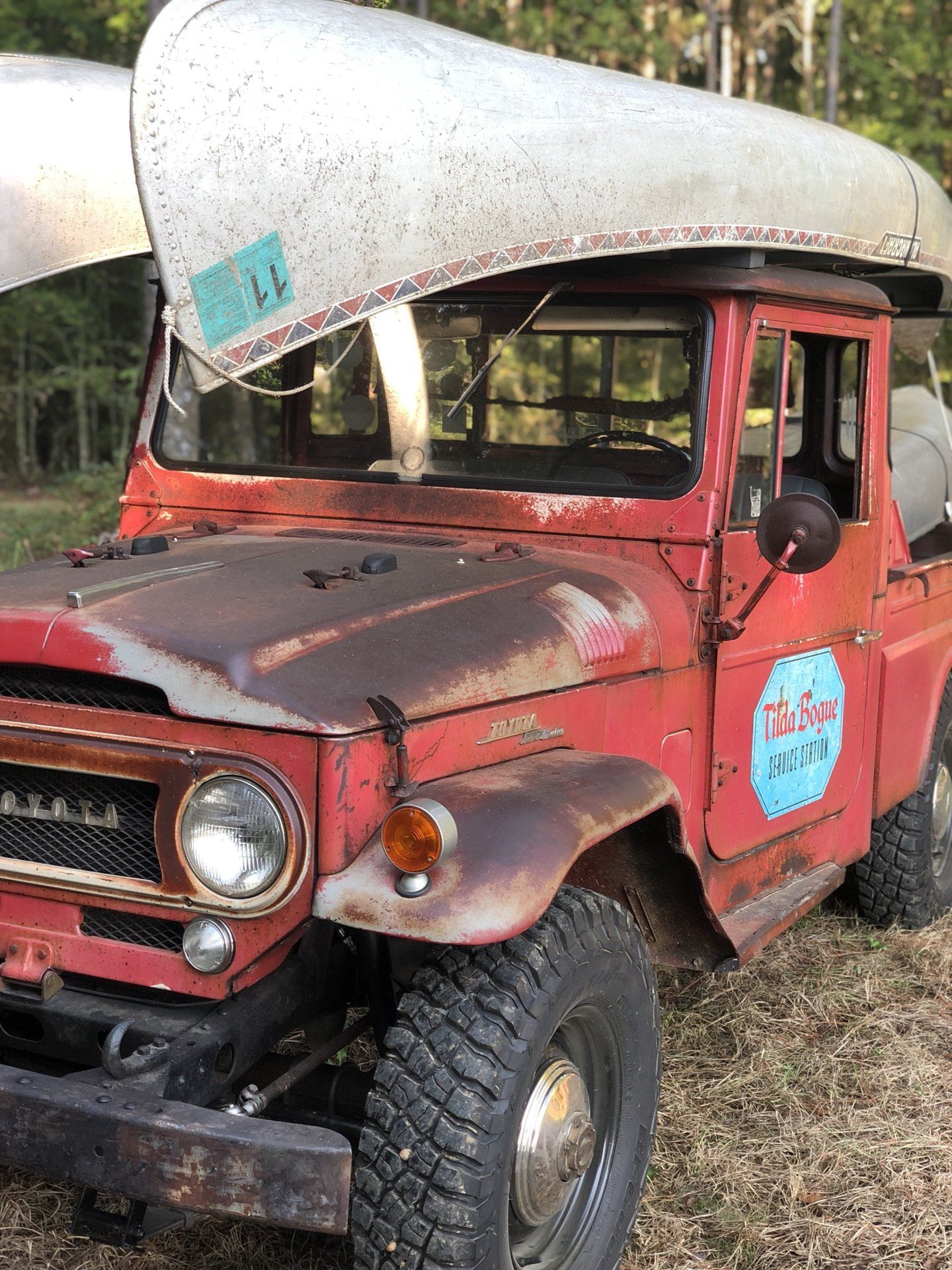

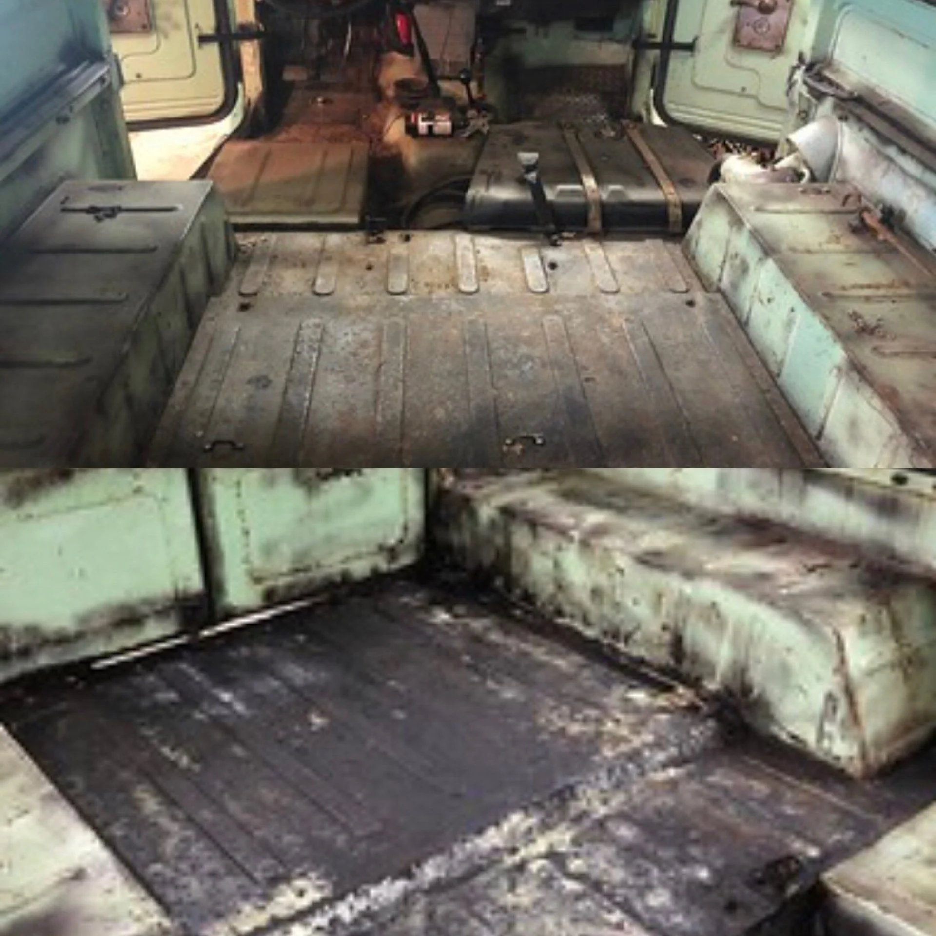

I would clean car, use CLR, wash and dry, buff vehicle, and rub Penetrol on rust areas. It will looks great. If you park outside or wash regularly you may need to lightly apply every few months. It takes 5 minutes to do this.
You can purchase Penetrol at Lowes or most local hardware stores. This is how I cleaned and treated my 1967 with original paint. See before and after photos below.

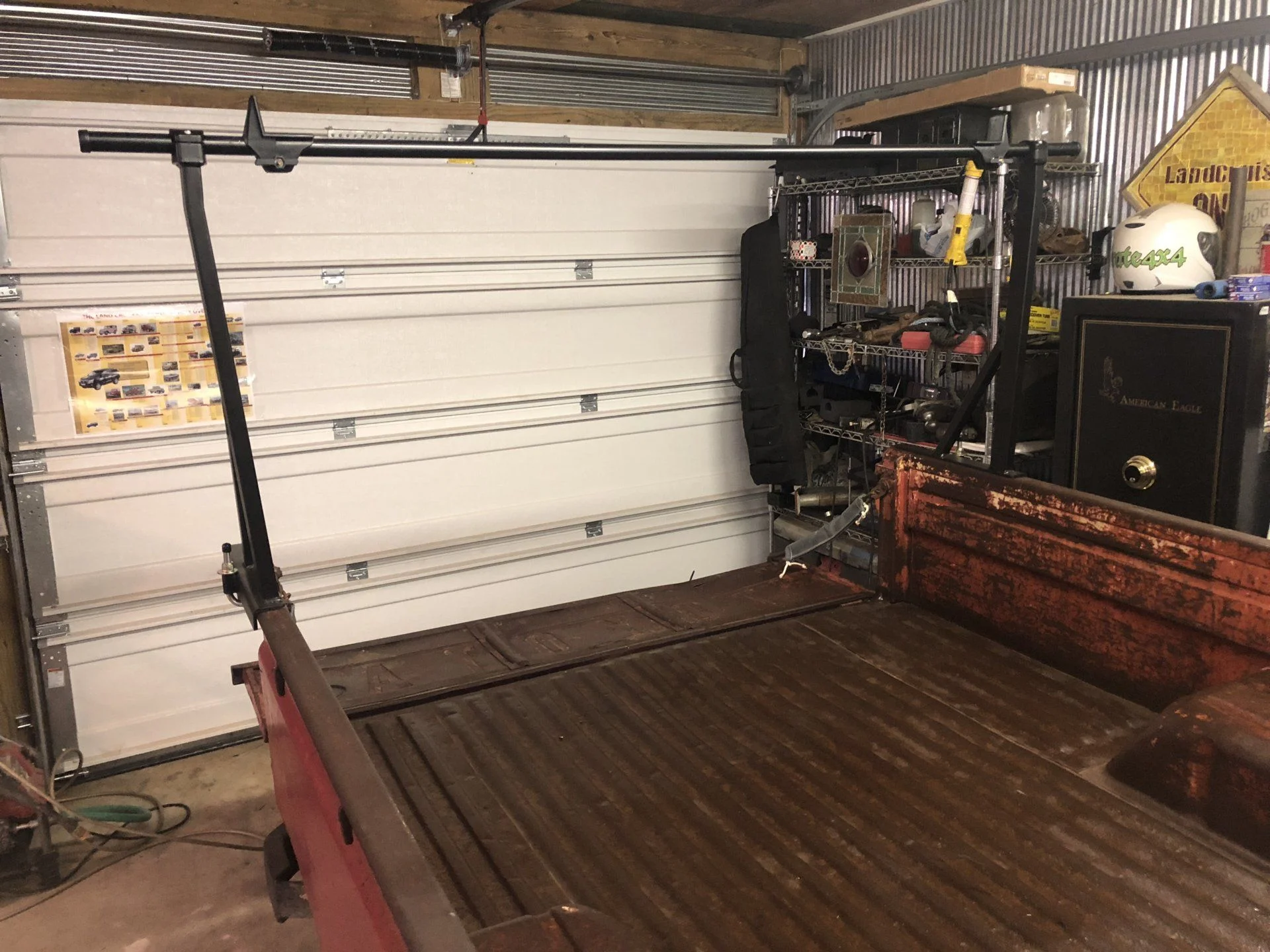

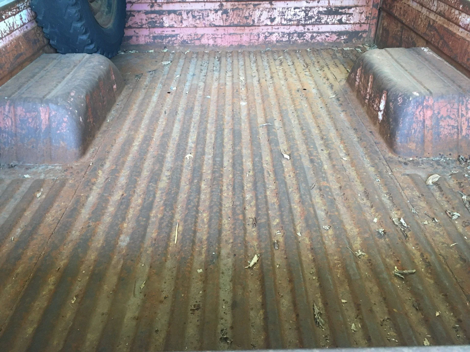

One place on the external body I found Fluid Film works better than BLO was the bed of my FJ45. It was so pitted than the BLO soaked up too fast. The Fluid Film soaked in and left a nice non sticky protectant
