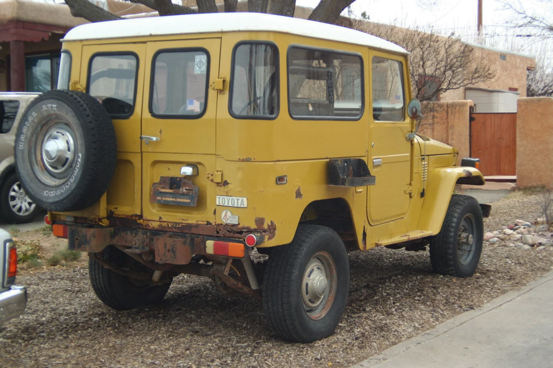

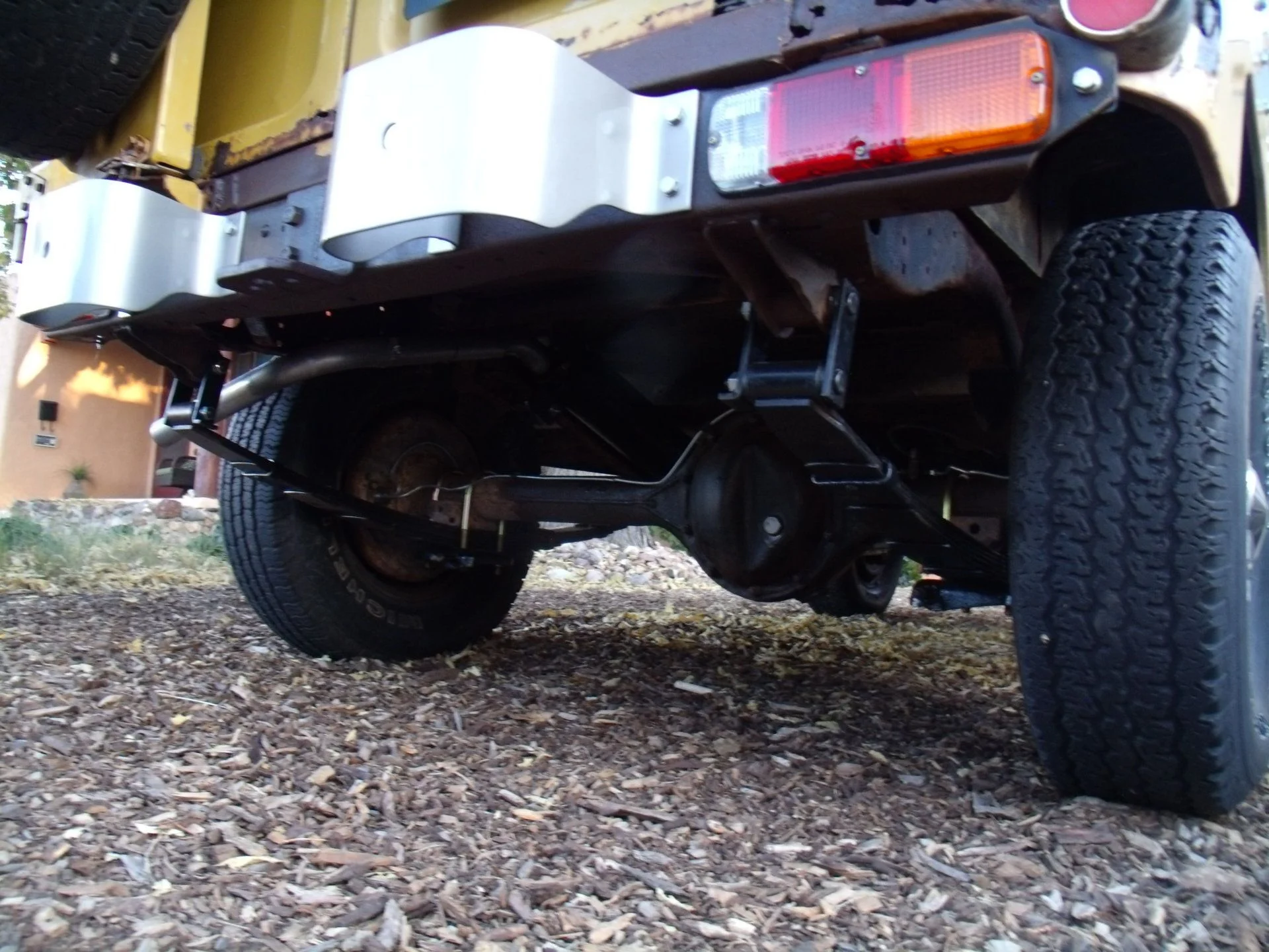

The BLO just picks up every bit of dust here in Albuquerque. Any hints on something that won't be a complete dust magnet?
Thanks,
Mo
Not if it’s an oil. Dust sticks to oil. That said, I’m able to get much thinner coats of Fluid Film onto the painted areas with FF than BLO
As for the frame and underside, you are supposed to let the dust and dirt collect on the Fluid Film. It’s amazing how it soaks into the rusted metal and all the grime and mud falls off with a good pressure wash.

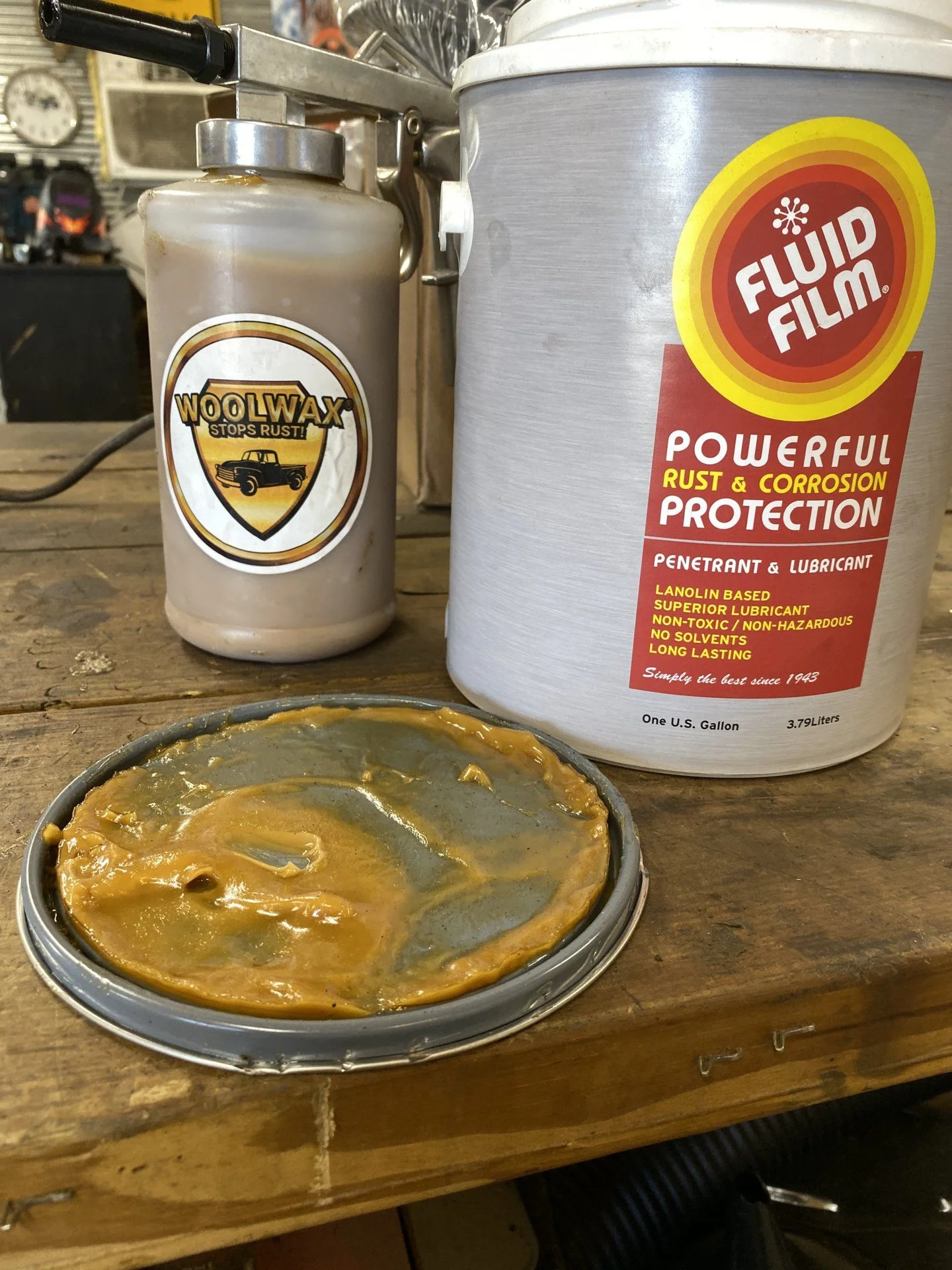

I bought this sprayer rig on Amazon for my mass hysteria over Fluid Film. It came with an FAQ that people always ask me so I will just post them here
Any noticeable difference in applied product between rattlecan fluid film and bulk FF applied w/ sprayer? I ask because rattlecan psi is a bit less than 90psi (for gun application per the above info) so was wondering if they’re actually different product. I’ve got some cans of FF, yet to apply but it’s going inside window frame areas and rocker panel areas with hose attachment. Also on surface body rust areas after the ”patina“ rust starts.
I can’t tell. It was weird how thick it was in the can. That’s why it has to have a high PSI.
I coated the rear axle on Weenie 3 and barely used much. I’ll say a gallon is a bit overkill but I plan on doing both of my 100s as soon as my lift gets installed.
This kit came with a long nozzle for the cans and rubber plugs where you can reach inside. It sprays 360*
