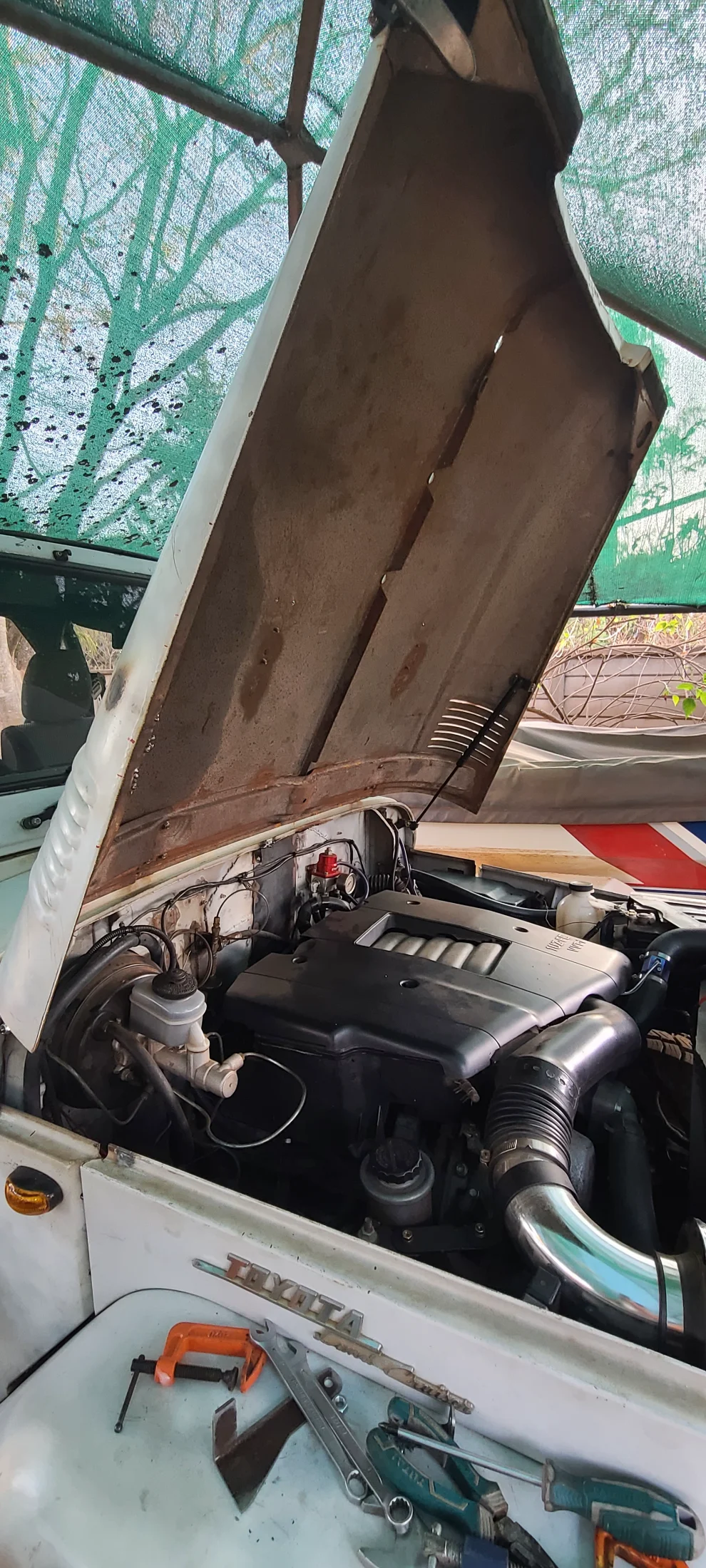

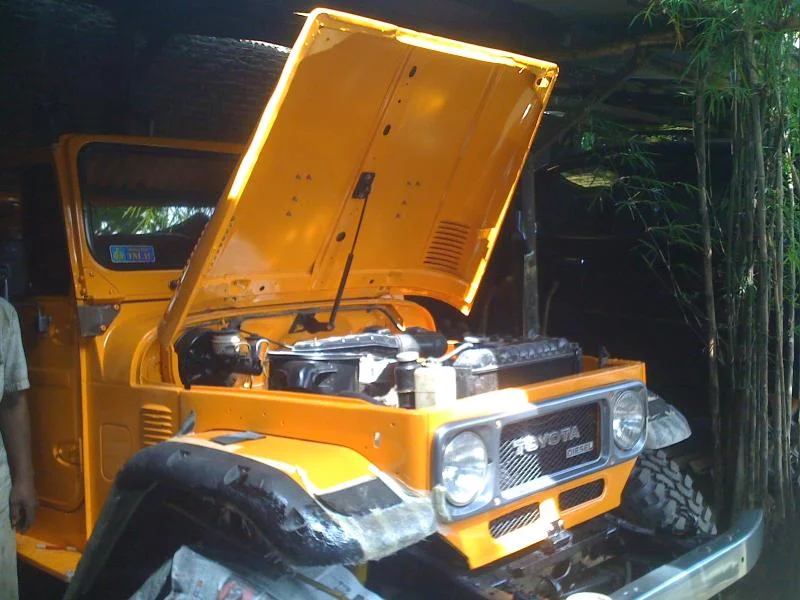

Here's how I did my gas stays. Did some math, then welded some brackets onto the hood and firewall where the math said to put them.
Alternatively could be bolted brackets. I was just in a position where I didnt care about paint. Bolting to the under side lip of the hood is easy enough though.
