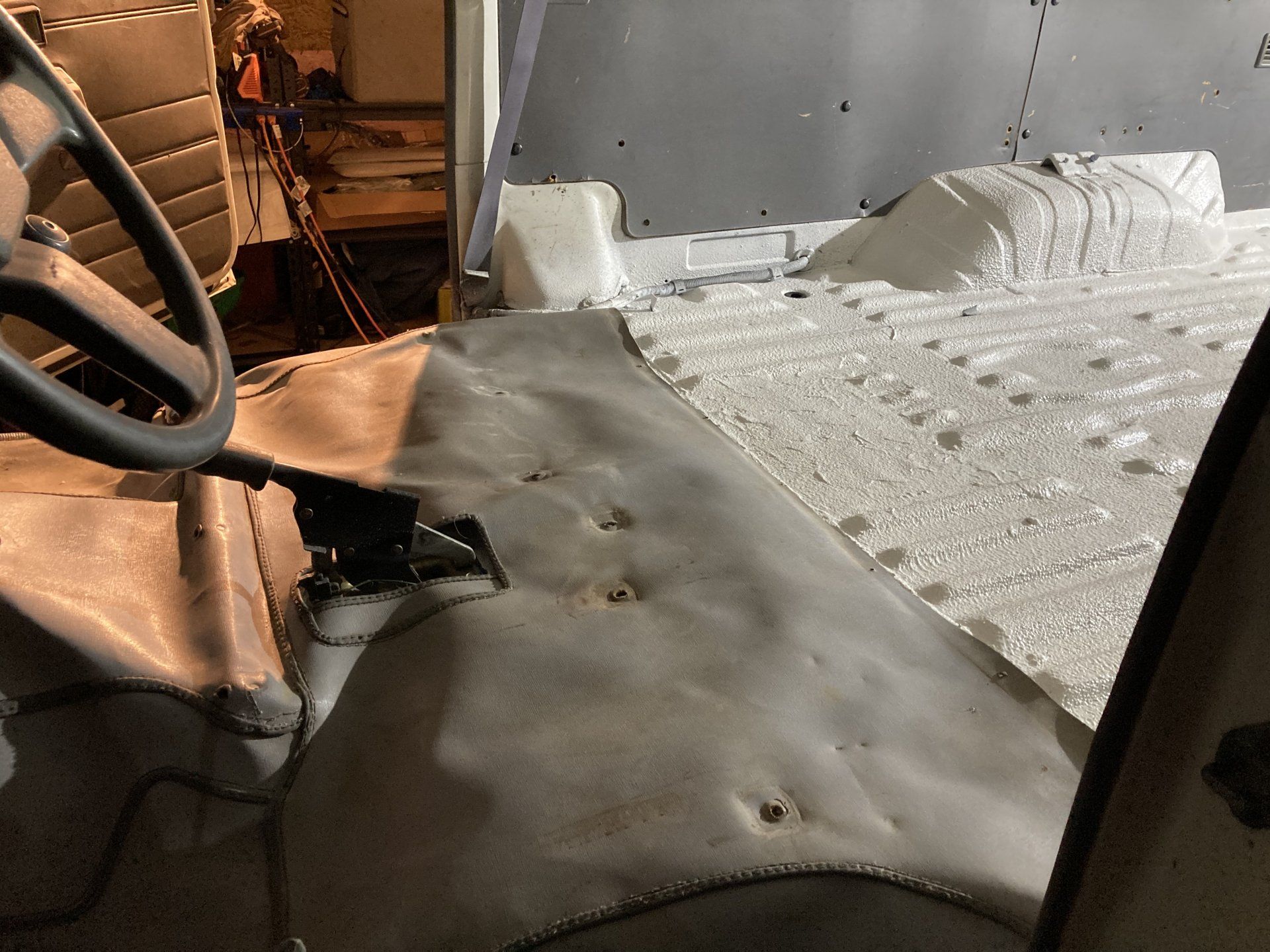

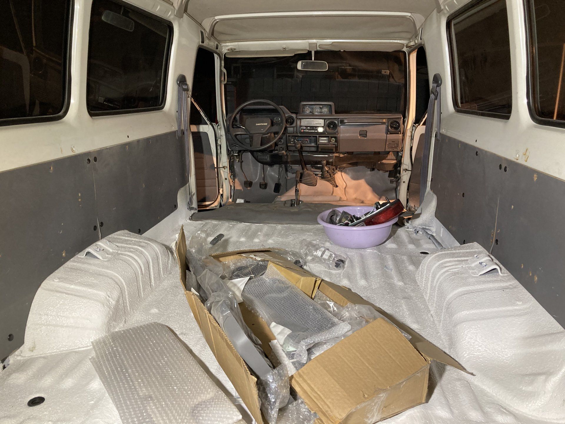

Threw the original panels back in with some cheap plastic 8mm diameter interior trim clips, started throwing the original carpet back in, and shoved some piles of replacement parts back in the Troopy.

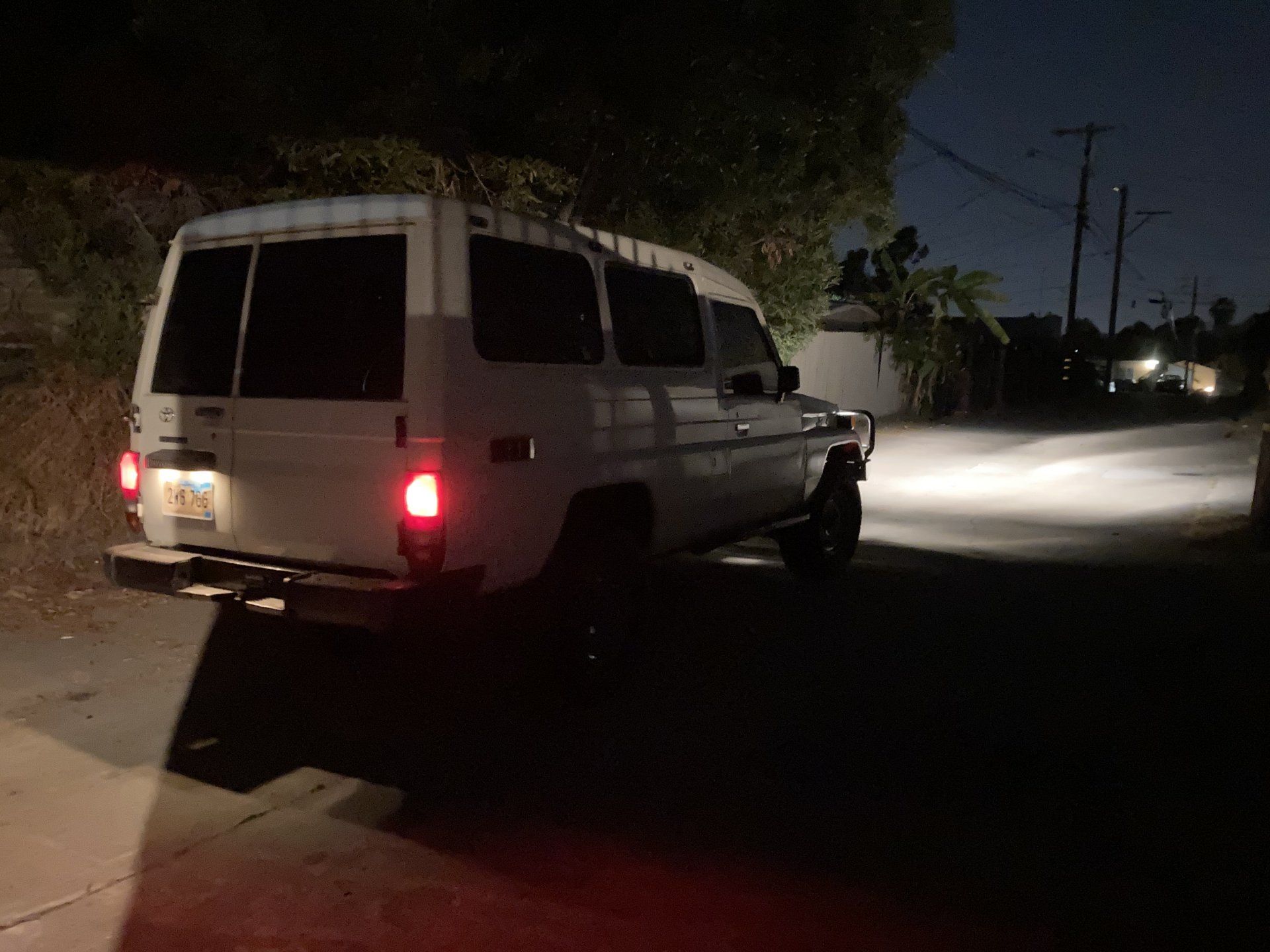

Then went for a late night cruise. First time driving it for more than 5 minutes since March. I did notice after driving it on the highway that my hubs were a bit warm. They were still able to be touched by bare hand, but warmer than what I think is normal. I'm hoping it's just the new bearings breaking in a little.
Definitely noticed the Spectrum doing it's job on the highway when I could barely hear most other car's tire sounds that are passing by me... And I still haven't touched the doors.

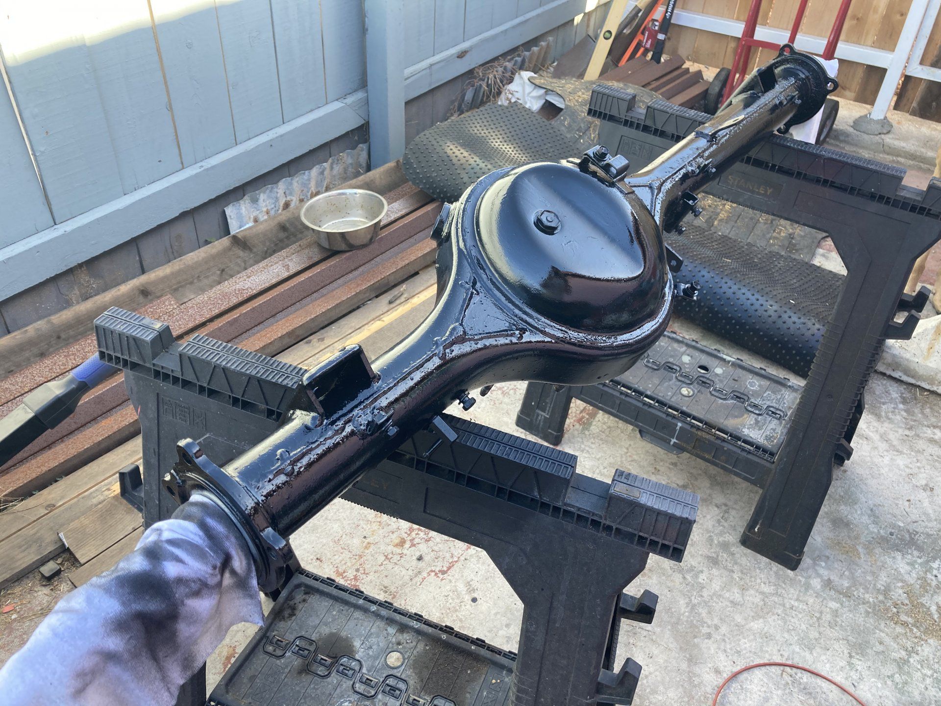

Happy 2021. So I finished the whole front end and couldn't stand the sand-blasted-surface-rust-axle-housing as well as having new brakes up front, but not touching the rear so I tore out the rear axle.

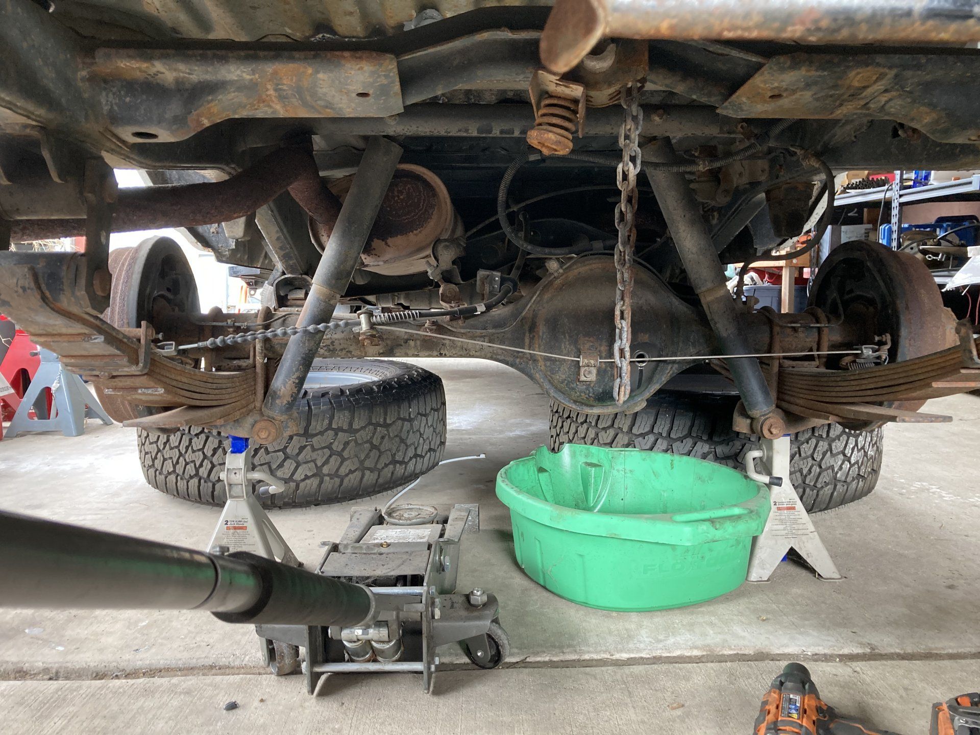

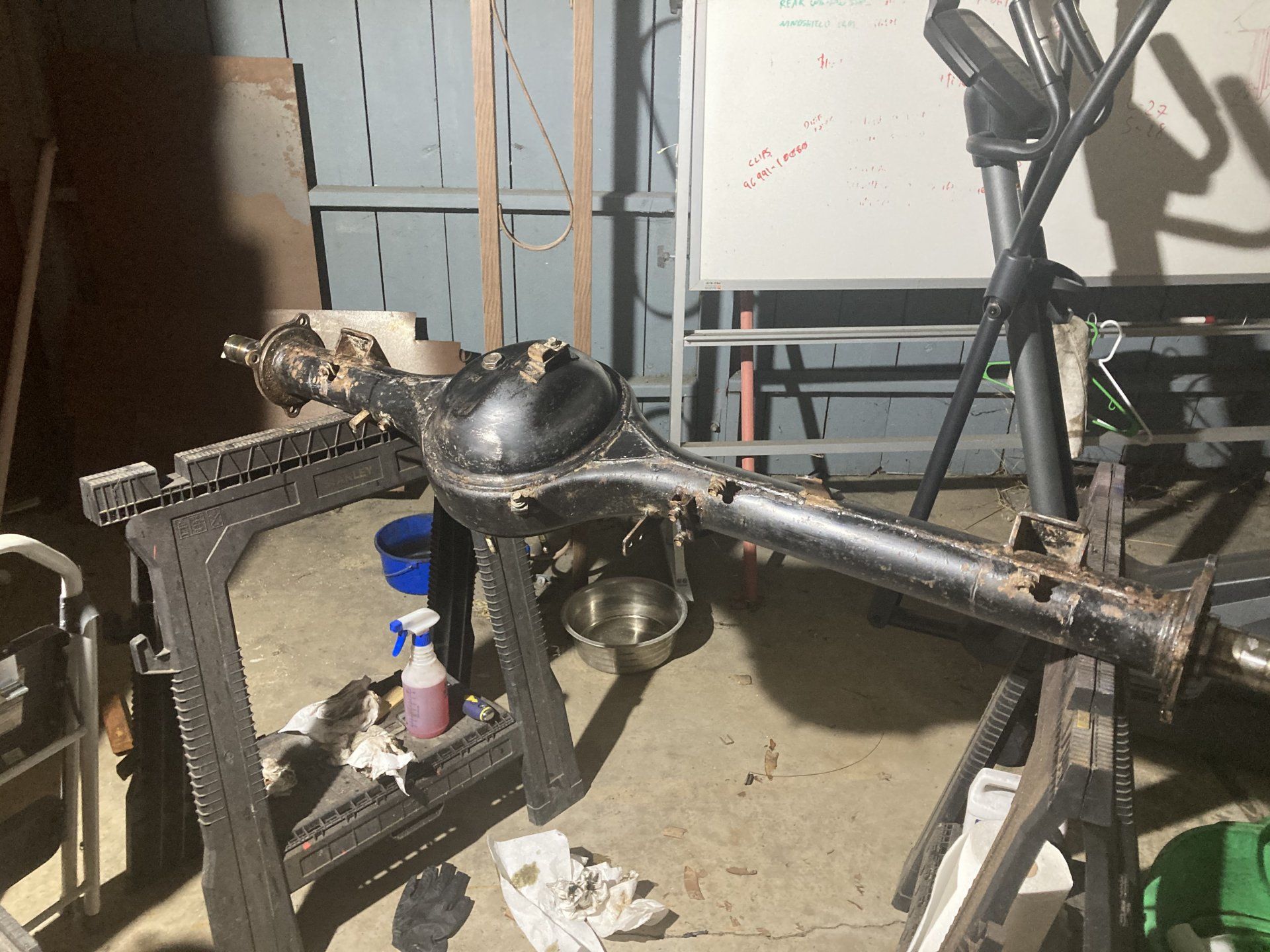

The rear diff ring gear was worn down as well, so i'm glad I pulled it out and took it to a local shop. The previous owner also put in a non-Toyota diff-lock sensor, so i'm glad I was able to replace it with 84222-12010 OE part. They also cut the original female plug that goes over it, but I have a harness from a 3rd gen 4Runner diff lock that should work... I still haven't spliced the OE harness back in though. So for now, the rear diff lock flashes continuously as if it's still "locking", even though it's working.

Angle Grinder + 40 grit sand paper + POR15 + POR15 top coat
Now it's going to bother you that the chassis is faded and dirty with two shiny, repainted axles...

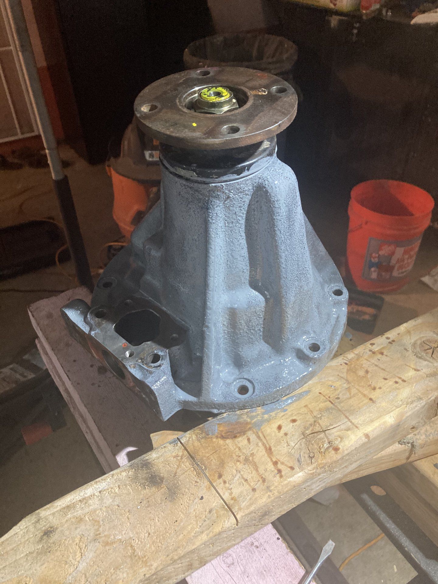

During the diff rebuild I came across an issue with the 9" rear differential bearing races being a little different than a standard 9" 80 series rear differential. The bearings are the exact same as a US model 9" e-locker rear, but the races (at least in this particular 75 series with an e-locker) were ever so slightly taller. Photo below is the old one after it got rebuilt.

32012J/IB-N was the one I needed, 32012J was just the normal one.

Maybe someone can enlighten me more on it, but I found it interesting. Took a week longer to rebuild the diff and I left the axle housing like this:

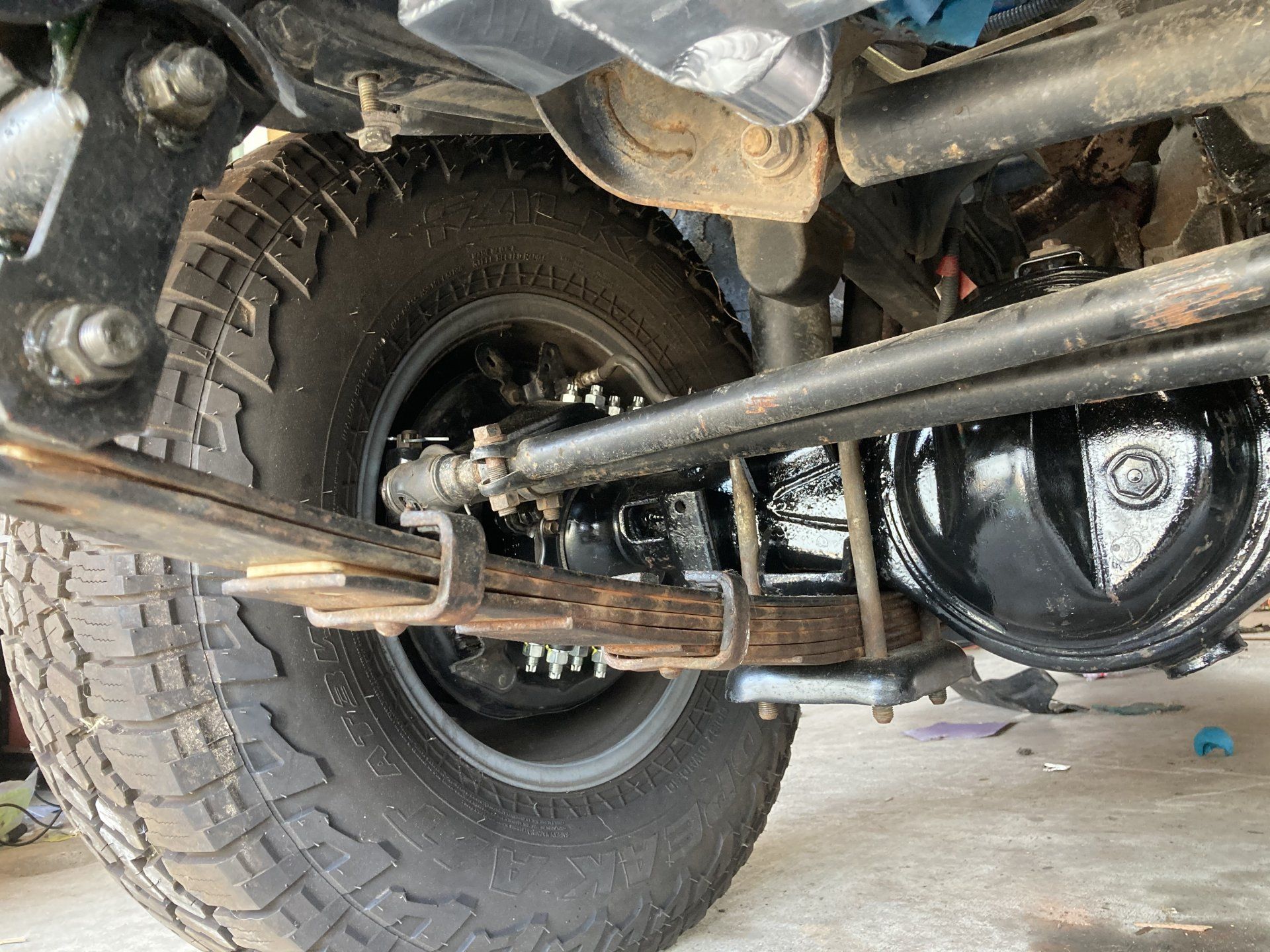

Snapped a bolt before a trip, and broke 2 of my extractors. Thankfully Cruiser Outfitters came in for the rescue and happened to have a spare lower leaf spring/shock mount in stock.

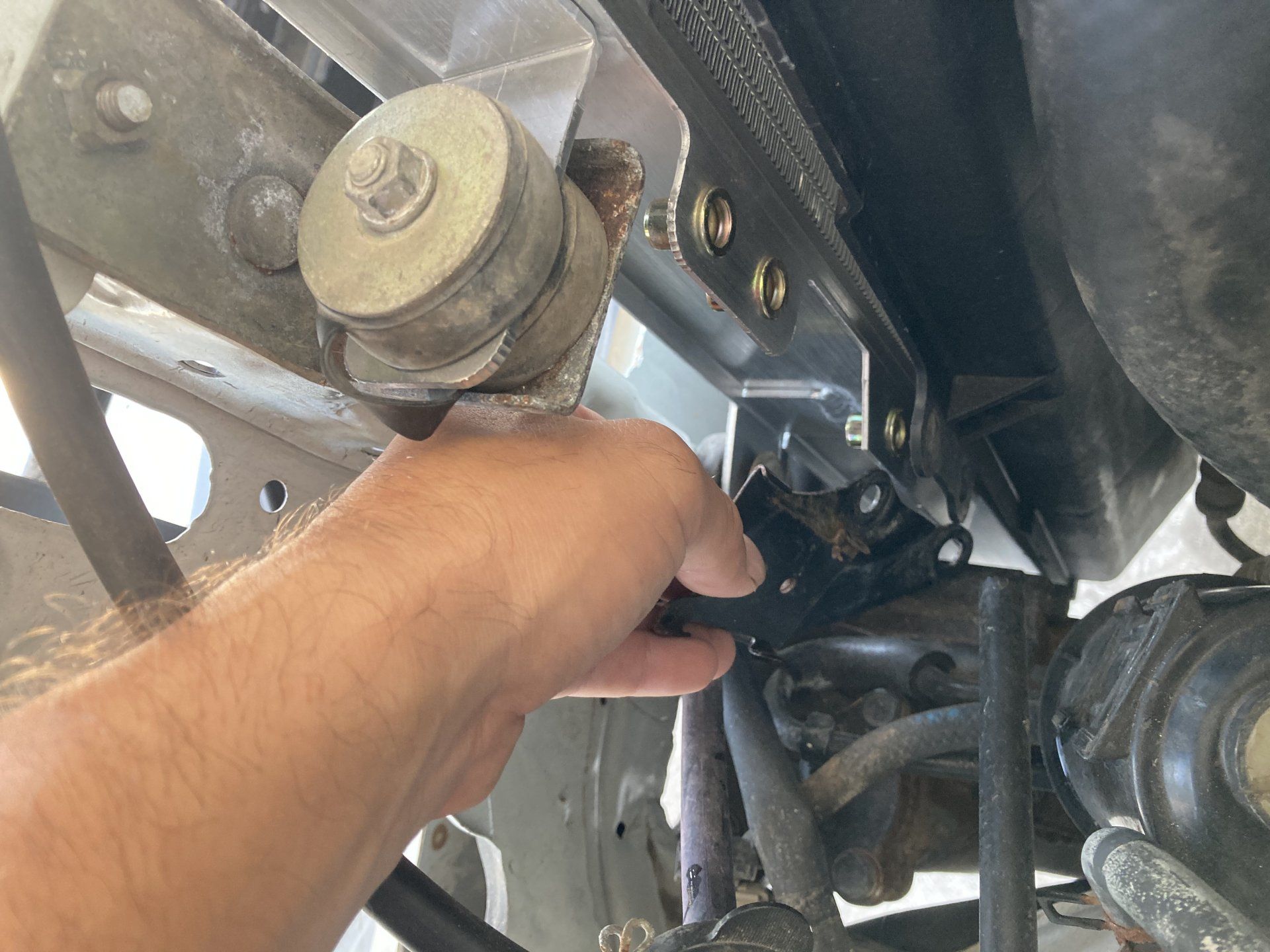

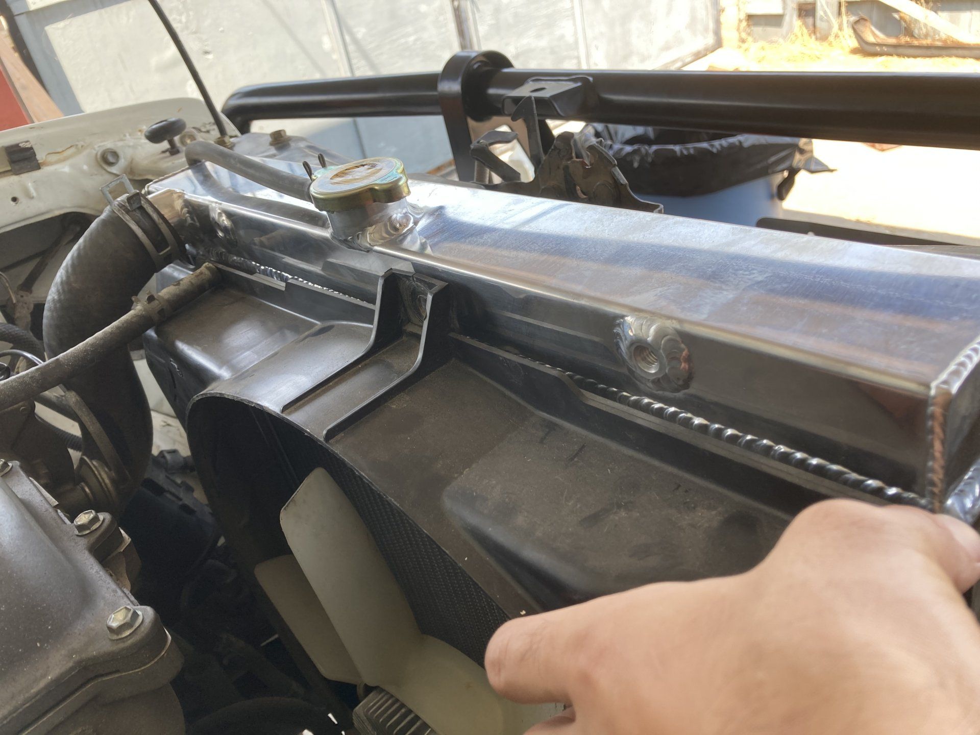

Got tired of an exhaust leak "tick/woosh" that would get really annoying when going down a grade in gear with no throttle. Brought it to Ed Hanson's locally here in San Diego and got new resonators and 1 performance Magnaflow muffler (one of the types that you can see all the way through the muffler from inlet to outlet) with the goal of keeping it as quiet as possible. And wow, for a NA 1FZ-F, it really helped the engine to breath during acceleration.
For guys with 1FZ powered 70's:

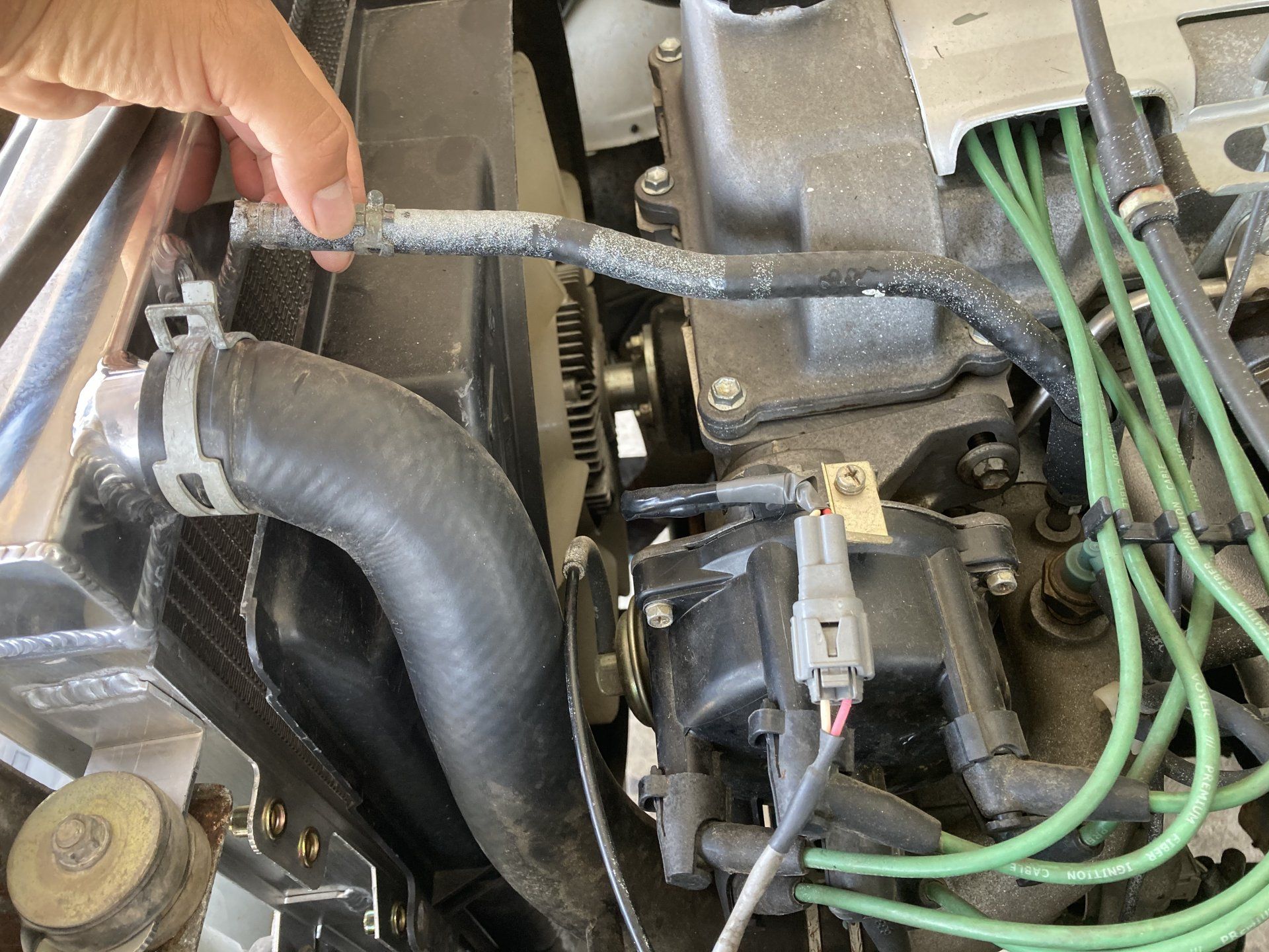

Consider just getting a new OE radiator or fix the old one (if you can) when it breaks. The aftermarket ones can be odd (I honestly could only find 1-2 Chinese brands)
Things that are odd:
1. The second small tube of coolant leaving the engine doesn't have a spot to attach to radiator
2. The charcoal canister (I think) bracket bolt holes are missing/not aligned
3. The radiator shroud holes don't match up
4. The main coolant inlet doesn't have the right angle to the engine (see harsher angle in photo above)
Probably cost me $300 after shipping etc. to get this one. I wish I had just paid the $2-300 extra to not have to deal with all of the extra stuff. Debating on just getting a new OE one...
