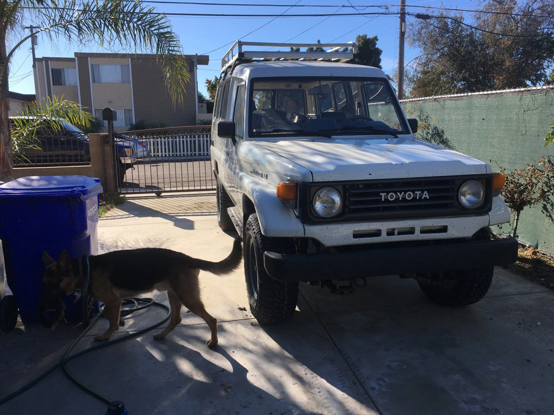

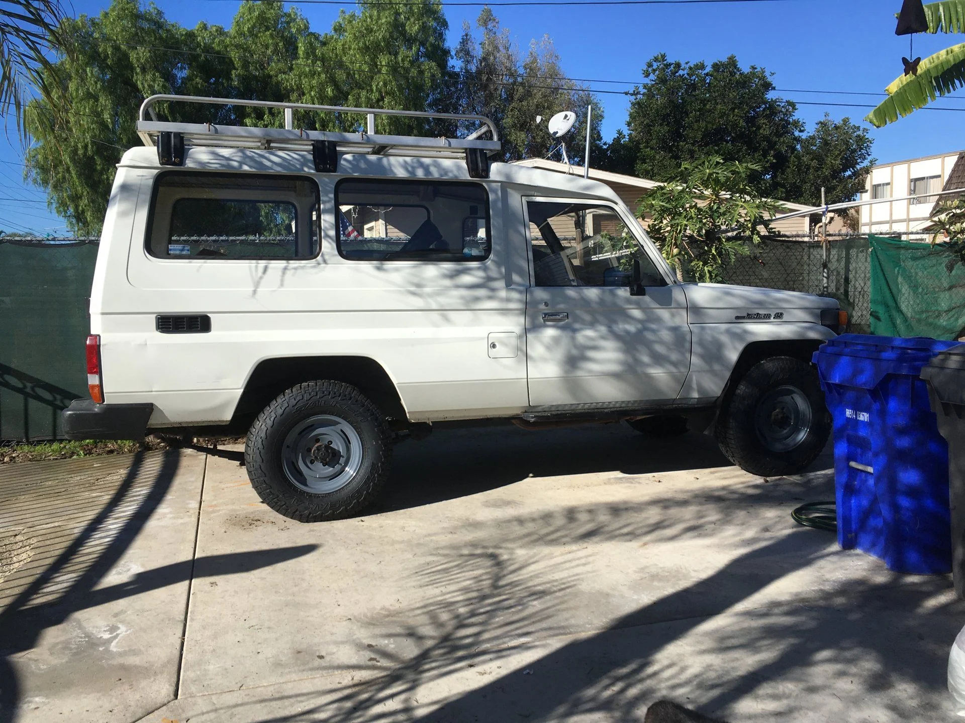

New guy here down in SoCal. Just got myself a LHD FZJ75 Troopy from Turkey. It's got about 80,000mi on it, FR and RR factory lockers, and runs super smooth, looks great, and has minimal rust. I've had and driven 100 and 200 series LC's before, and this is my first personally owned 70 series, and I'm loving the raw machine feeling of it so far.
(Quick Phone Photos of it)
This is my dream personal vehicle, short of a VDJ78 (wanted one since I was 10 or so), and plan to use it as the "weekend warrior" and "road trip" vehicle of choice. I'm going to use it to get up to Oregon in 3 days to see how she does.
