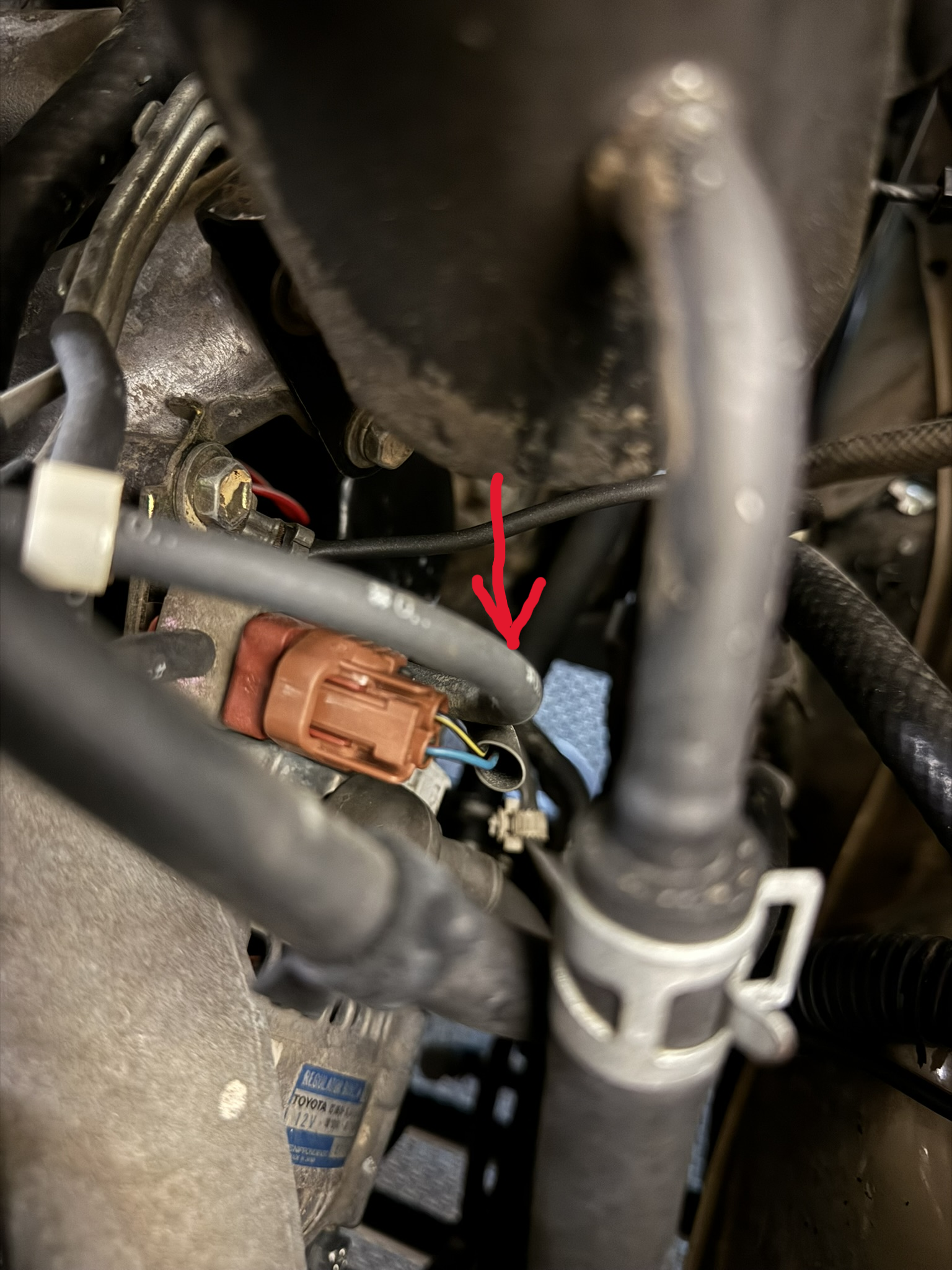

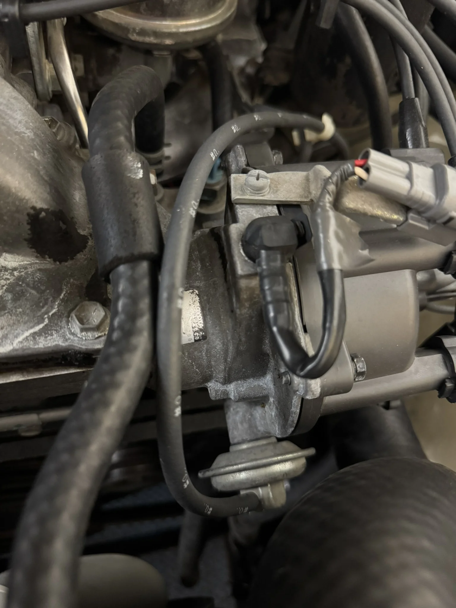

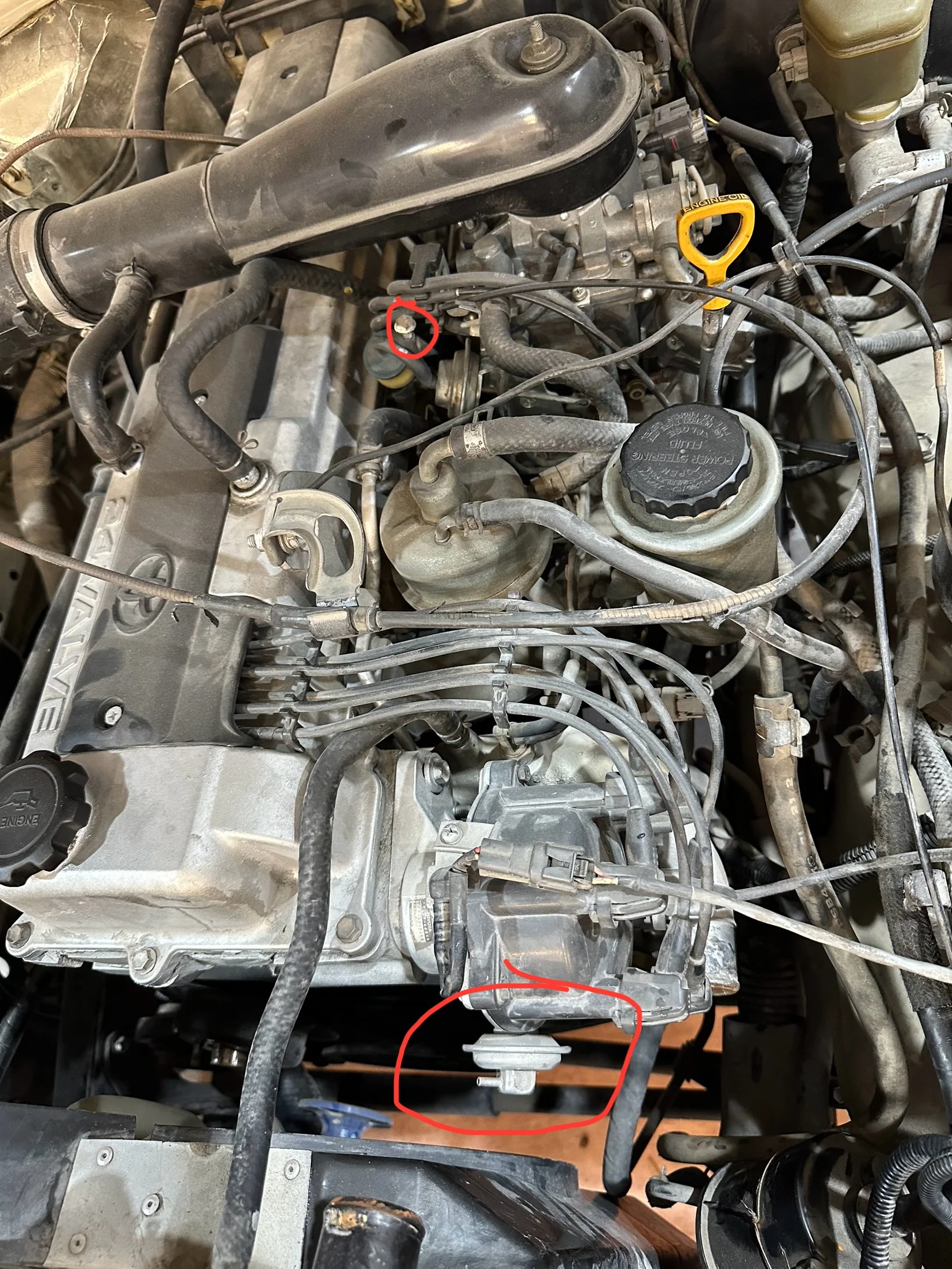

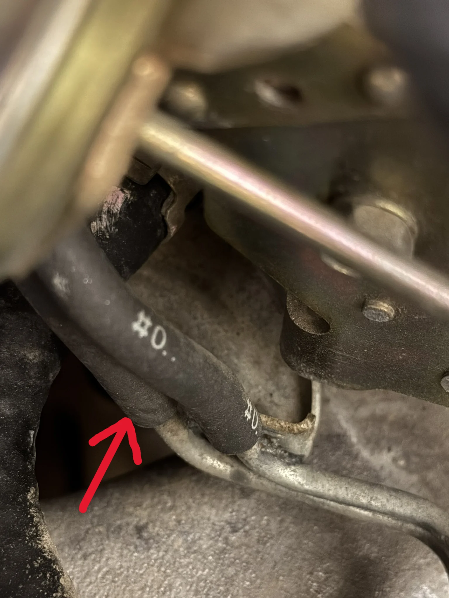

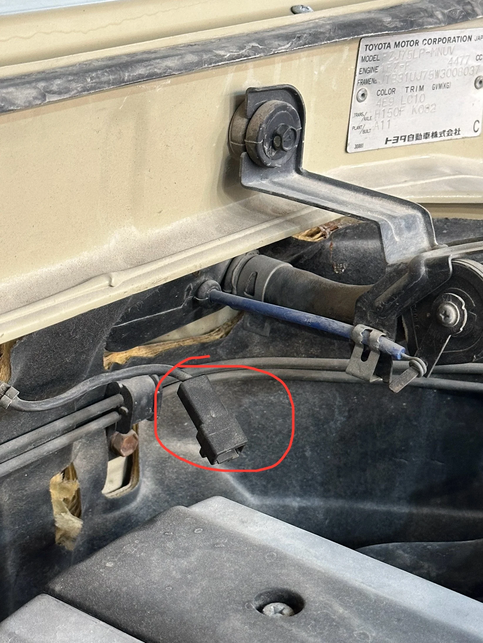

2) I noticed that there seems to be a vacuum hose port on the distributor with no vacuum line attached. Is that normal or should there be something there? I also see another vacuum hose up on the carb with a little bolt shoved into it. I don’t notice any major performance issues, although it does seem to fall on its face under heavy acceleration (3/4+ throttle) sometimes. Pic below.

Difficult to take good photos but hopefully these will help somewhat. First off, I do not have that plug as far as I can tell.
It's difficult to tell where that plugged hose in your next photo originates from your photo but there is a VSV under there with a few lines coming off. One goes over that diaphragm looking device and connects to the left hard line which is located to the right and underneath the device. Here's my attempt at a photo of the other end of the hose.
The last photo of yours is the vacuum advance on the distributor and that could be the cause of your issues under acceleration. That hose goes into a VSV which is located behind and below the back right side of the distributor. Here's an overview photo of the hose and an attempt to show the VSV end - not a good photo though.

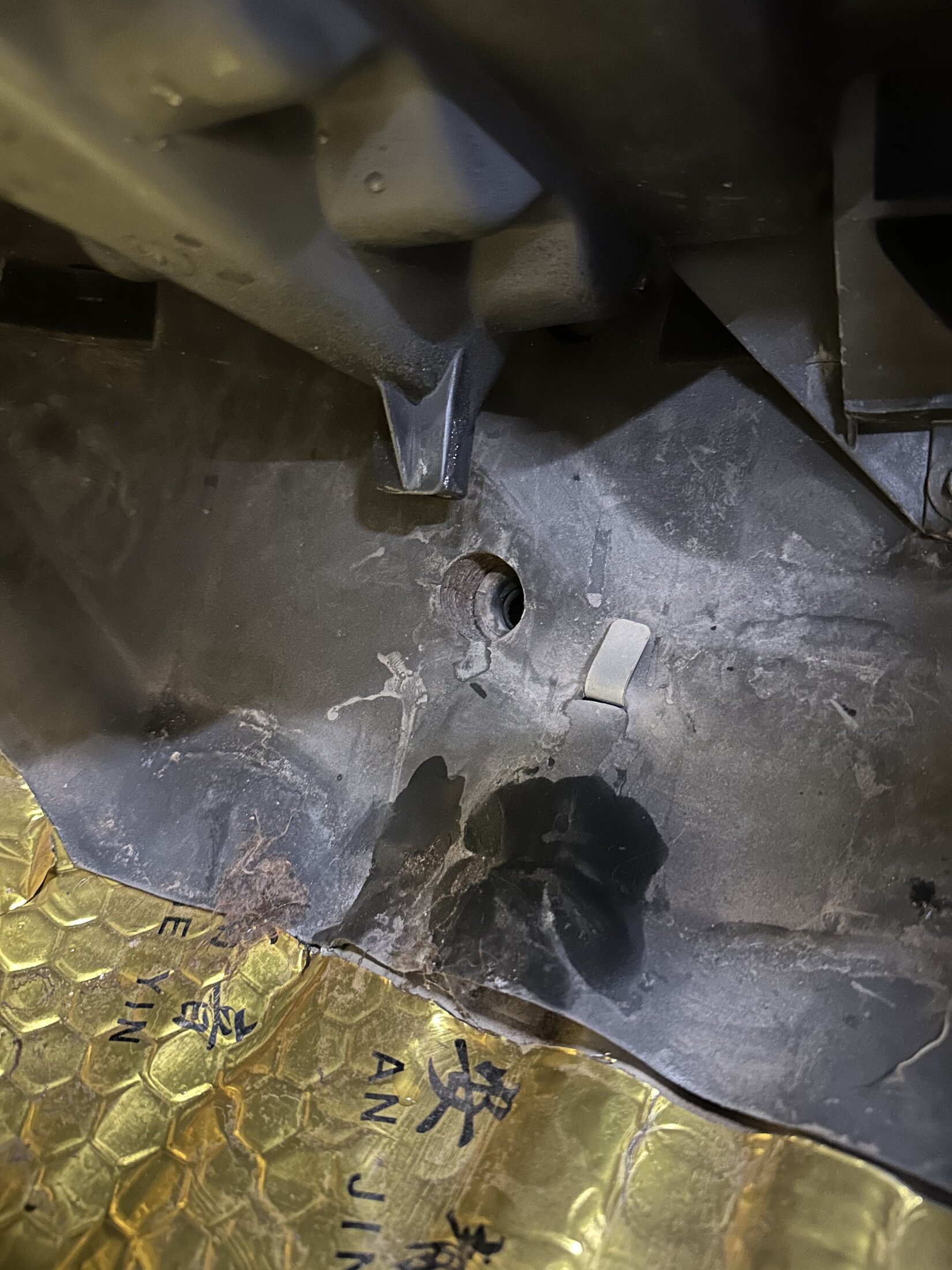

1) discovered that the AC drain hose is missing and it’s just dripping straight into the cab…not ideal. Huge puddle on the floor, soaked backside of mats. I’ll leave the windows open overnight to dry it out. Will try and rig up some vacuum hose to drip out the hole as intended.

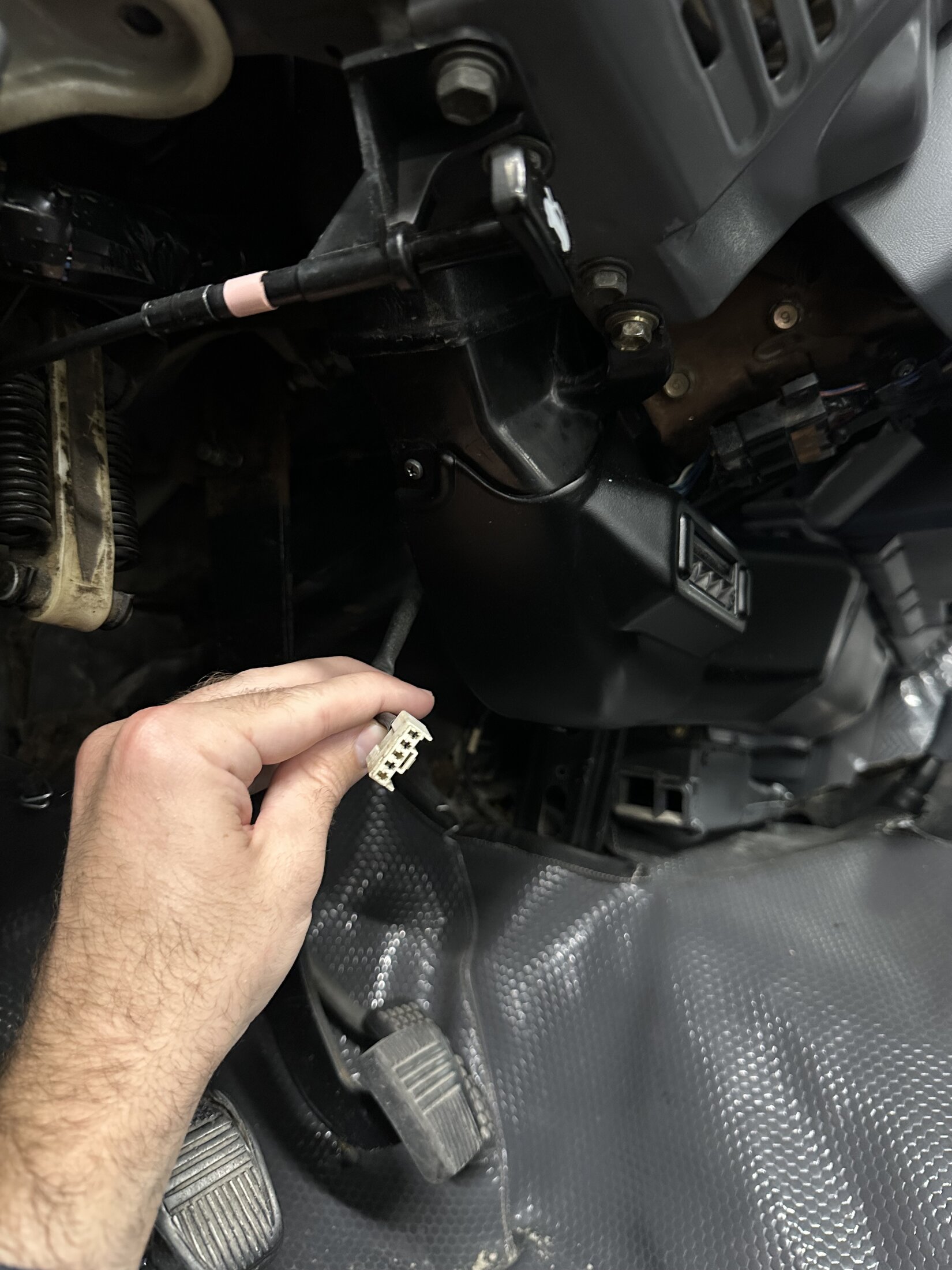

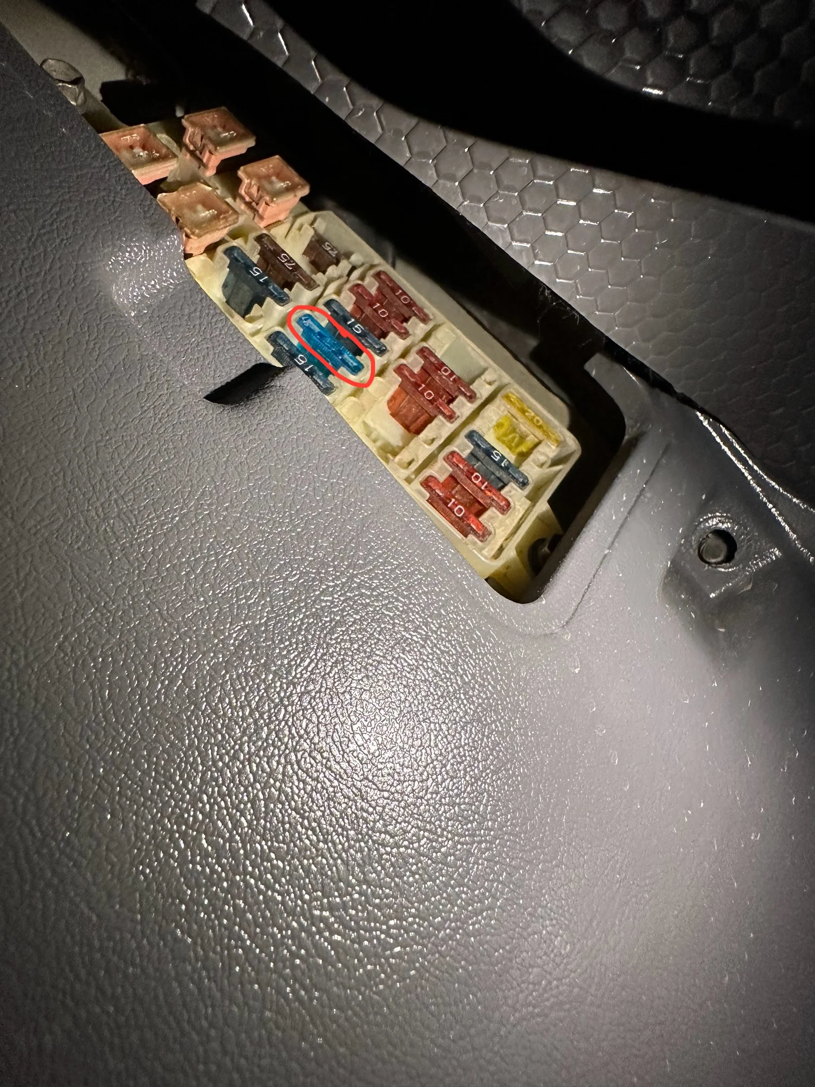

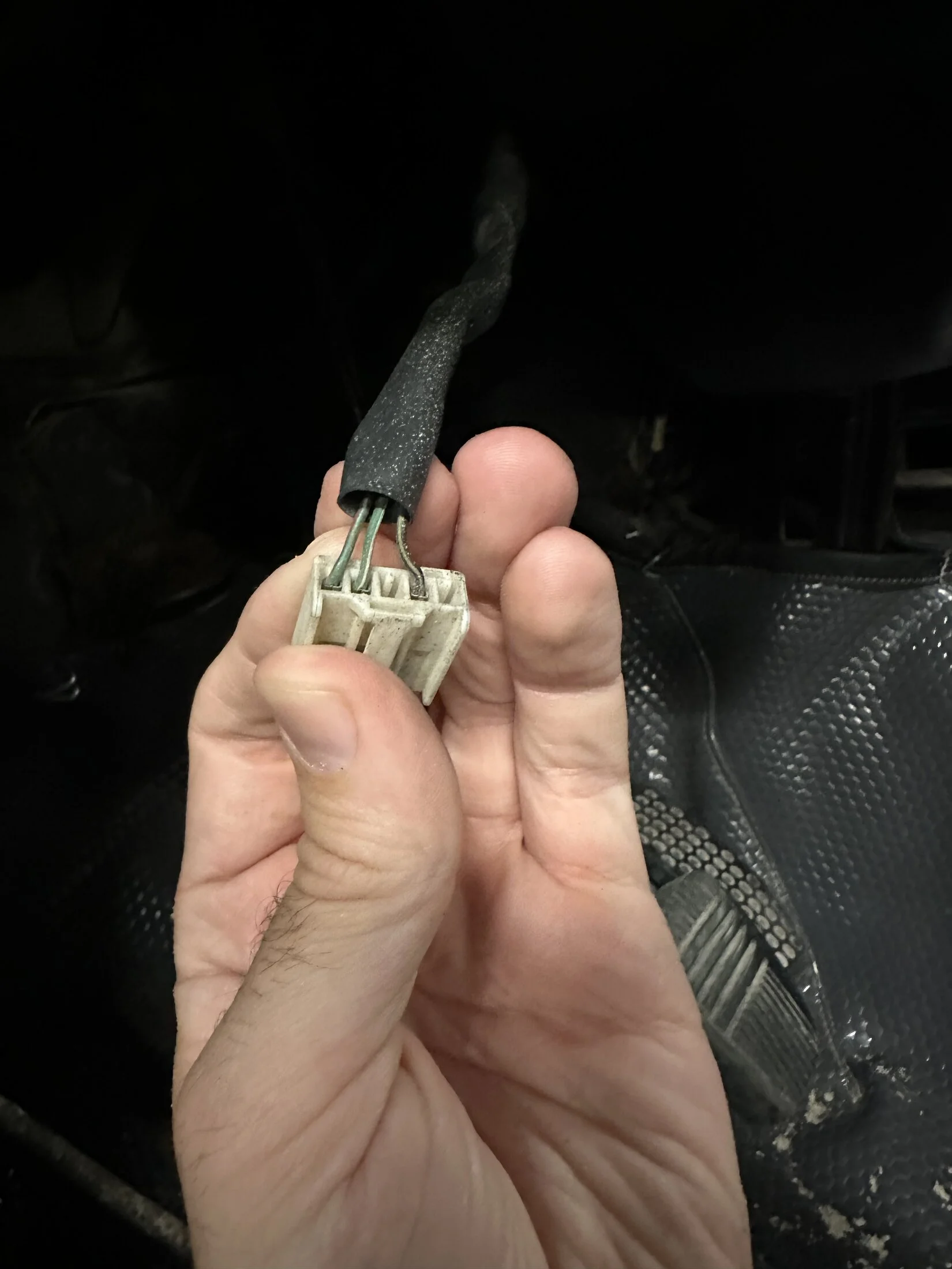

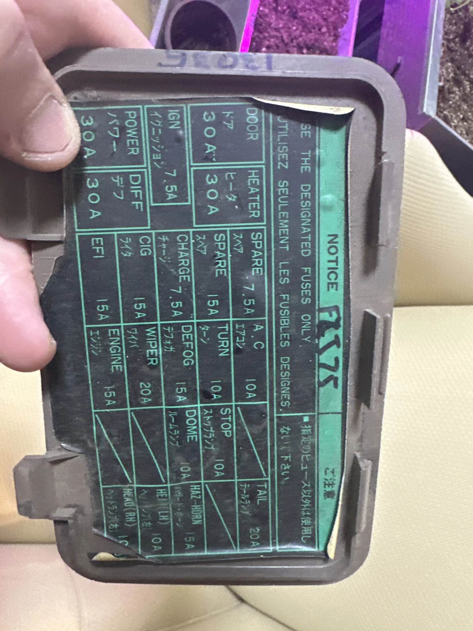

2) The windshield wipers don’t appear to be working in any capacity. None of the functions of that stalk work. While looking for any obvious culprits, I spotted an unplugged harness coming from underneath the steering wheel and a blown 15A fuse (circled below). Anyone happen to have the fuse diagram or know what this connector is for? Emergency flashers work, horn works, headlights work, blinkers work but flash quickly for some reason.
View attachment 3923543View attachment 3923544View attachment 3923545
That would be your wiper fuse. Not sure about the harness.
2) The windshield wipers don’t appear to be working in any capacity. None of the functions of that stalk work. While looking for any obvious culprits, I spotted an unplugged harness coming from underneath the steering wheel and a blown 15A fuse. Anyone happen to have the fuse diagram or know what this connector is for?
That would be your wiper fuse. Not sure about the harness.View attachment 3923633
Thank you! Will try a new fuse tomorrow and see if that fixes it.

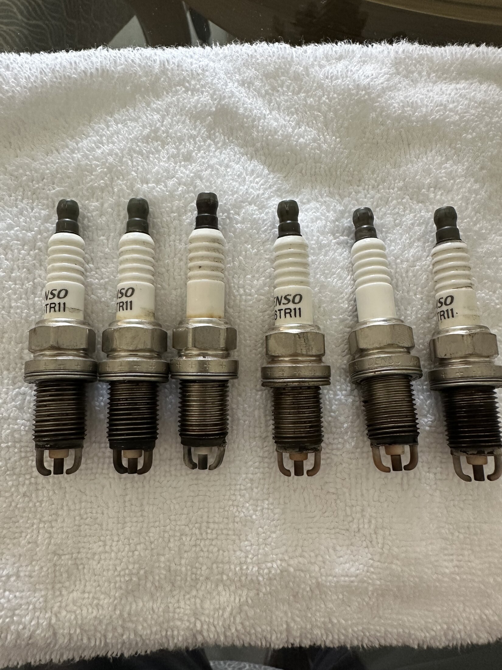

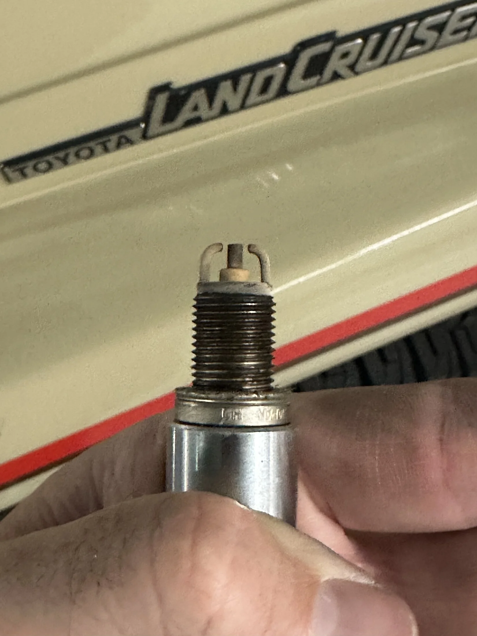

Had a couple free hours so replaced all the plugs and wires. Thankfully it went smoothly, no rust or super gnarly looking plugs. All plugs pulled out were the originals (I think?), certainly Denso.
Cylinder 3’s plug was probably the worst looking, any thoughts? Looks like it was running a bit lean?
Cylinder #4’s plug for comparison
Hello,
It is better to use Denso K16R-U sparkplugs. Part number is 90919-01176.
Juan
Thanks Juan, that’s what I replaced those R11s with. Going to test it out in the morning and see if the new plugs and wires help out with my stumbling under hard acceleration
