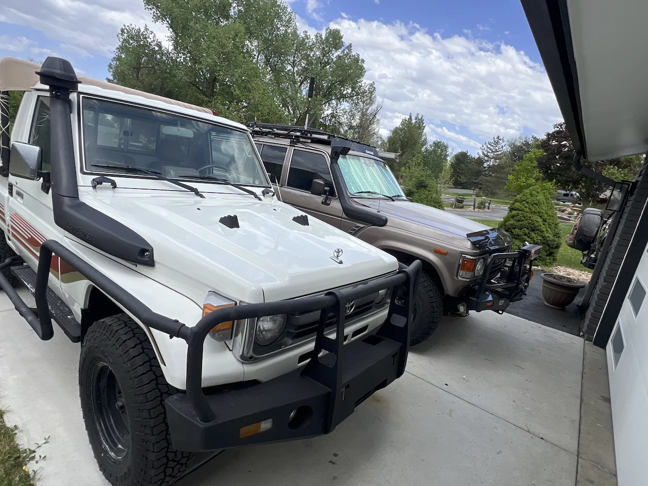

1998 Middle East Spec FZJ75, 1FZ (carb), 5-speed (150f), HD suspension, LX trim package. It was obviously a work truck as they are in the middle east and not coveted like we covet them here. a decent respray, some bondo, but a solid, solid rig. I intend to use it as a pickup while I refurburate her. :-)

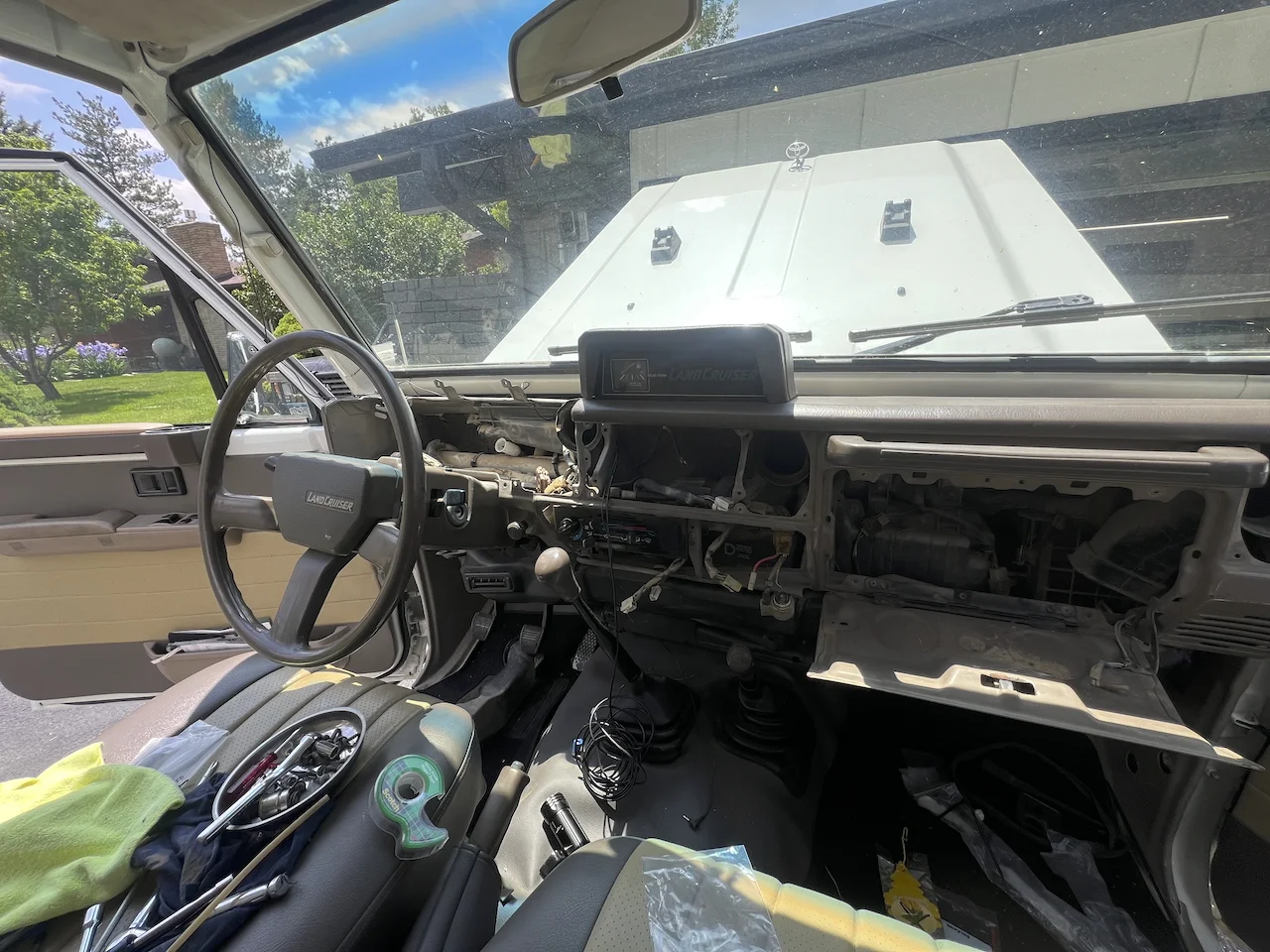

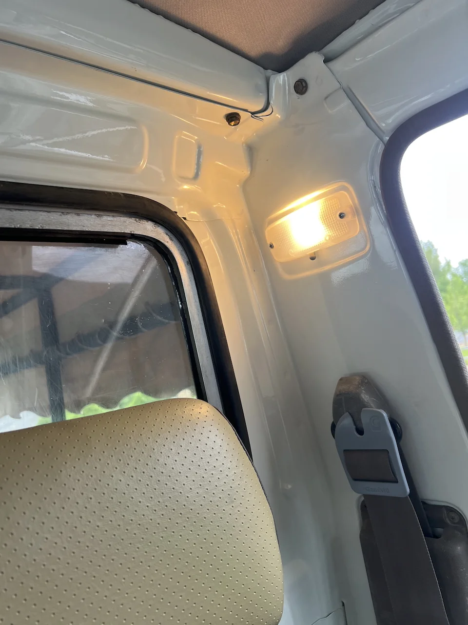

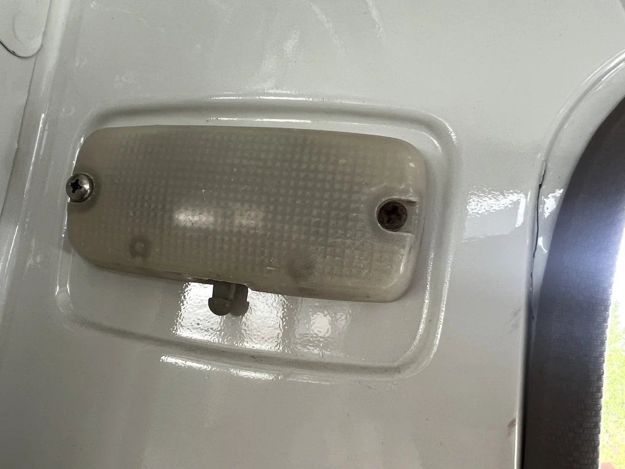

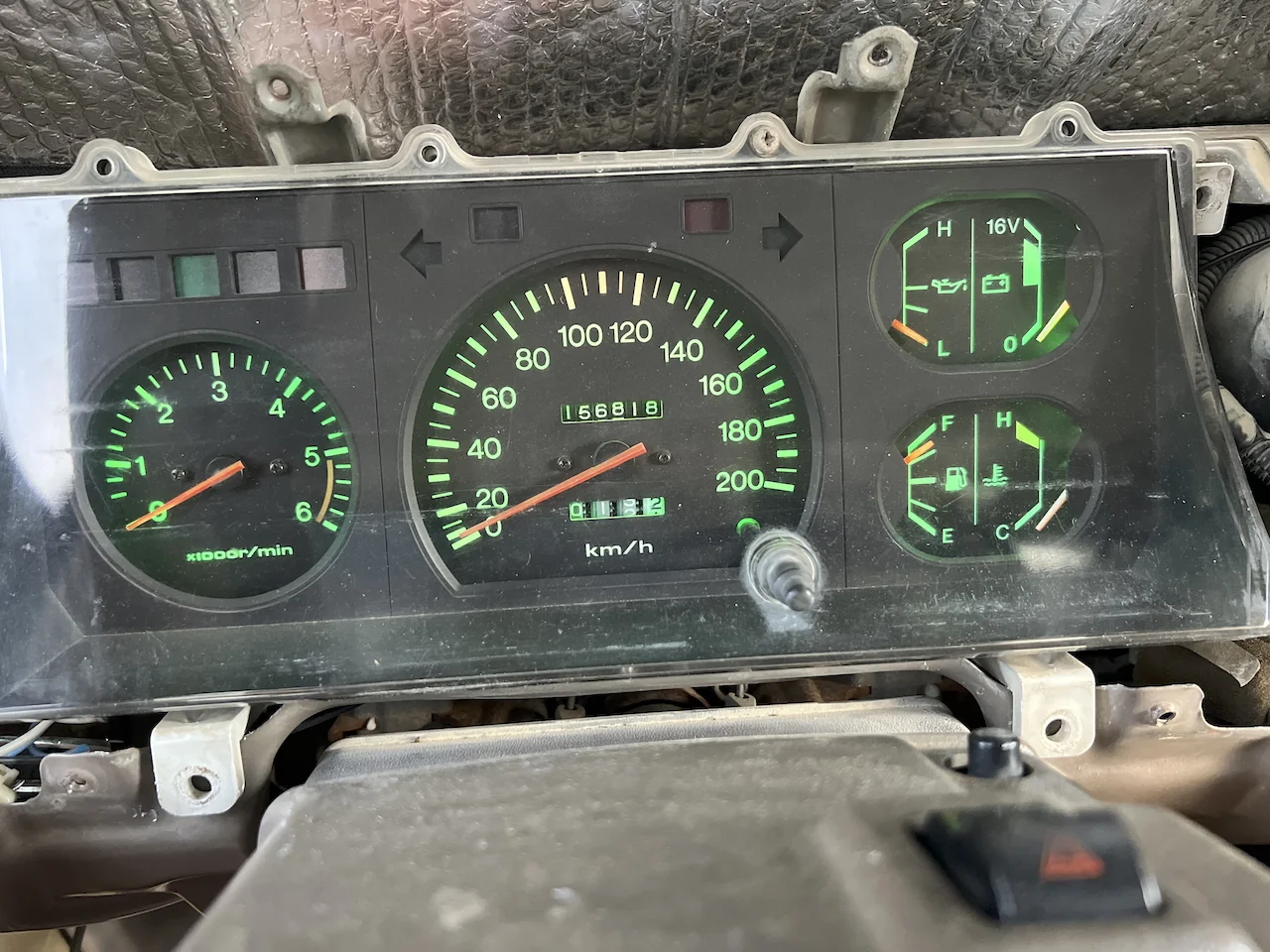

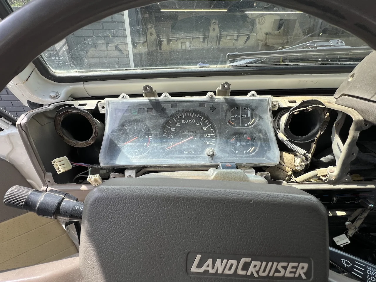

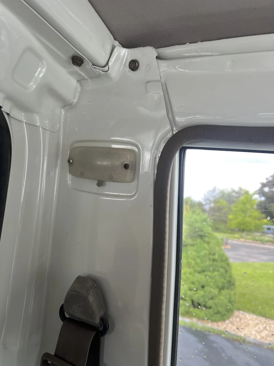

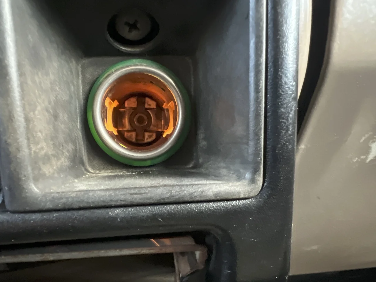

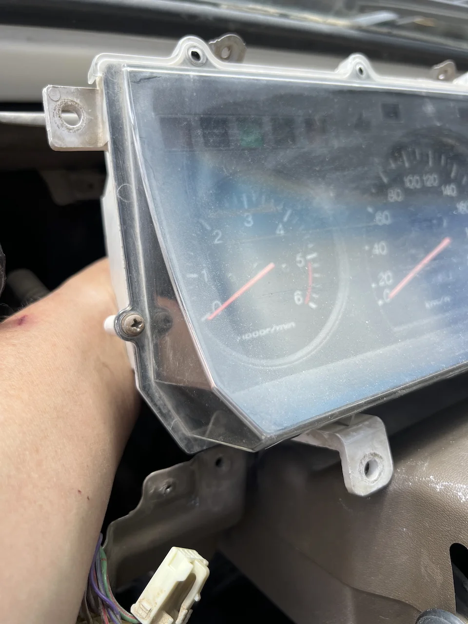

I started to poke about and fix other little things like the intrument bulbs and dash illumination, Cig lighter and replaced the interior light. easy stuff and good instant gratification.

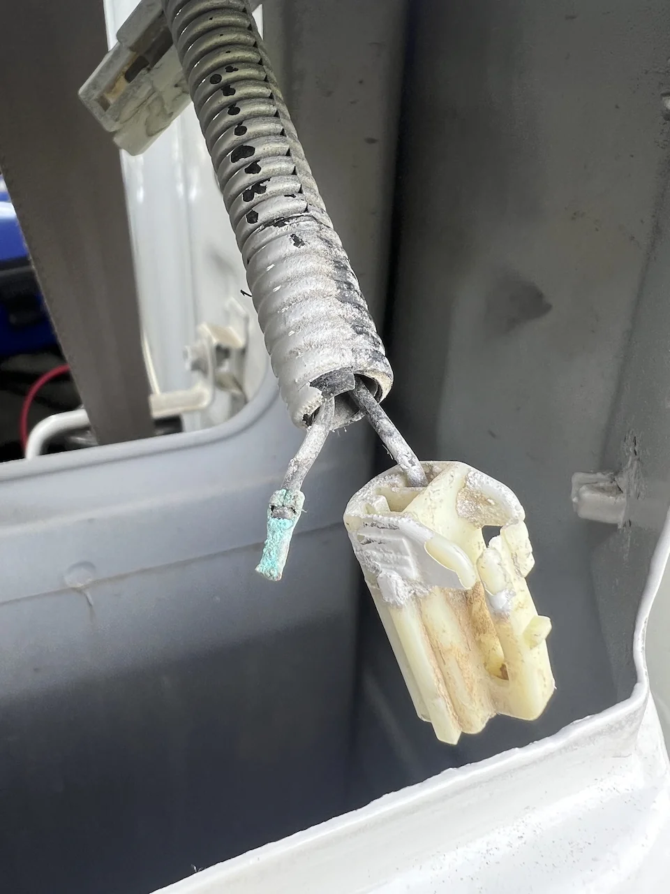

the wiring was quite corroded and dropped into the bowels of the body. what I thought was a 15min. fix was not. :-)

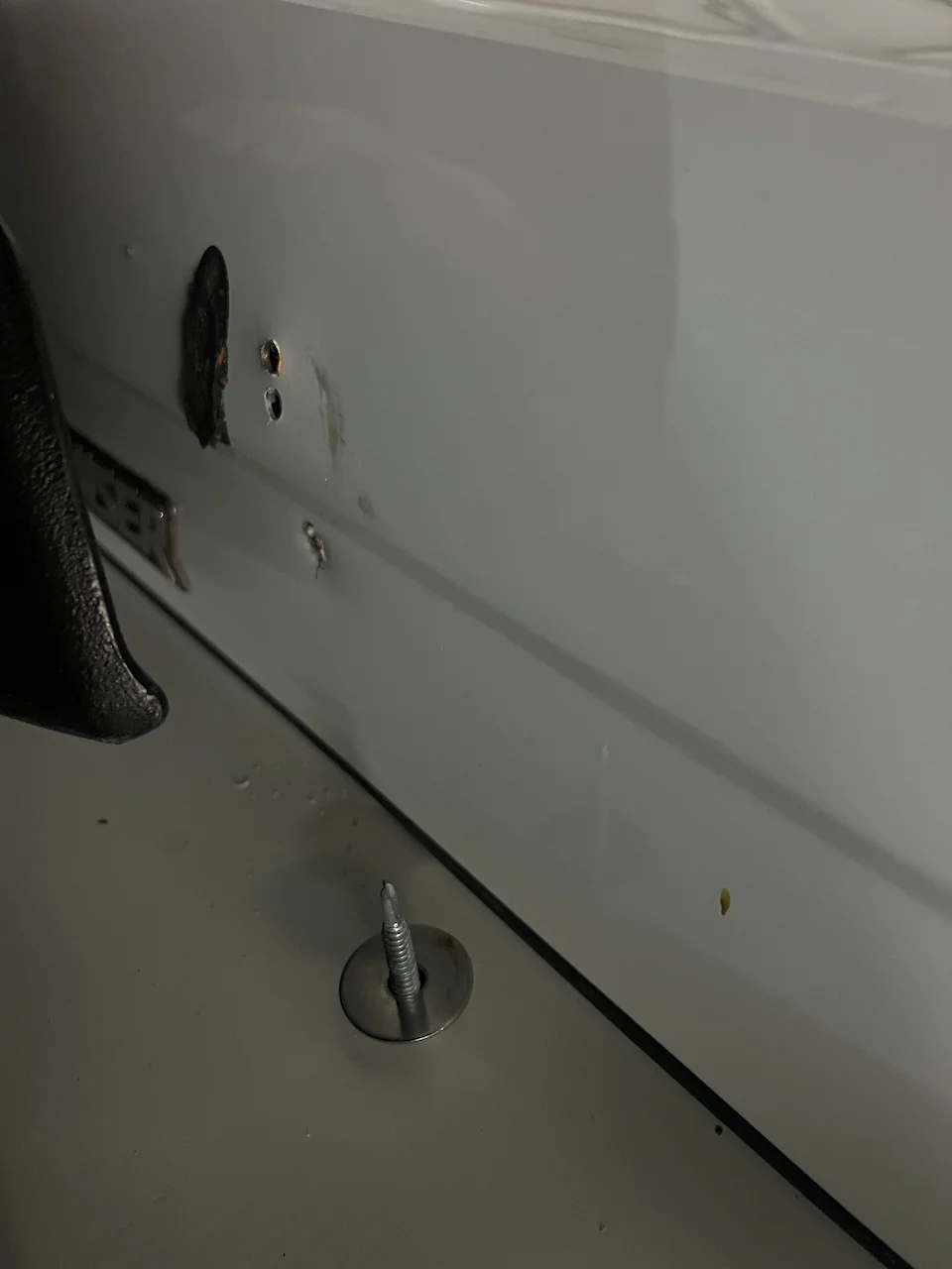

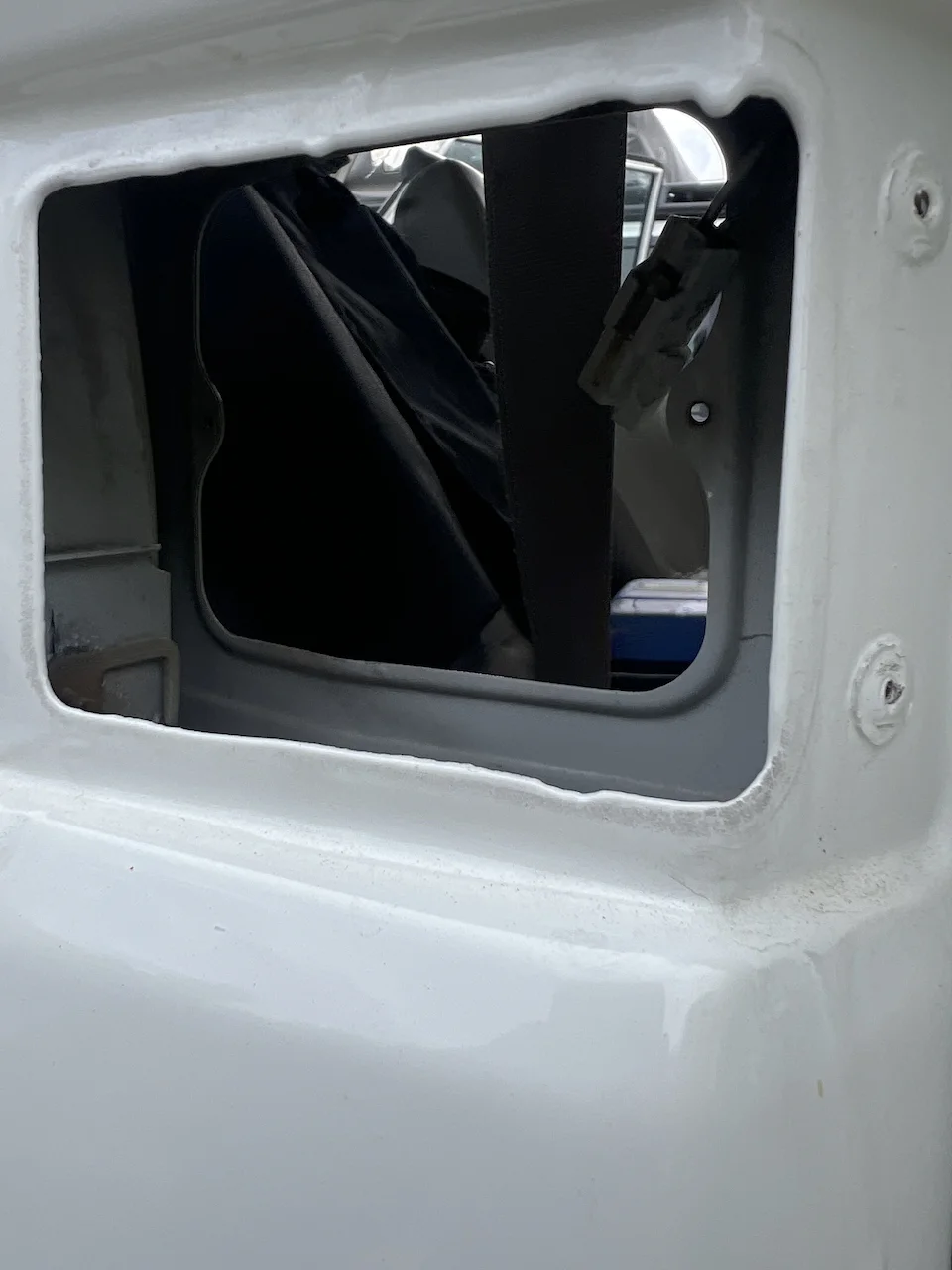

I then looked at the cool snorkel. Awww yeah! I have one for my LX470 I need to install...but this has one! Or does it??
the Dorkel was just drilled into the fender with sheet metal screws.

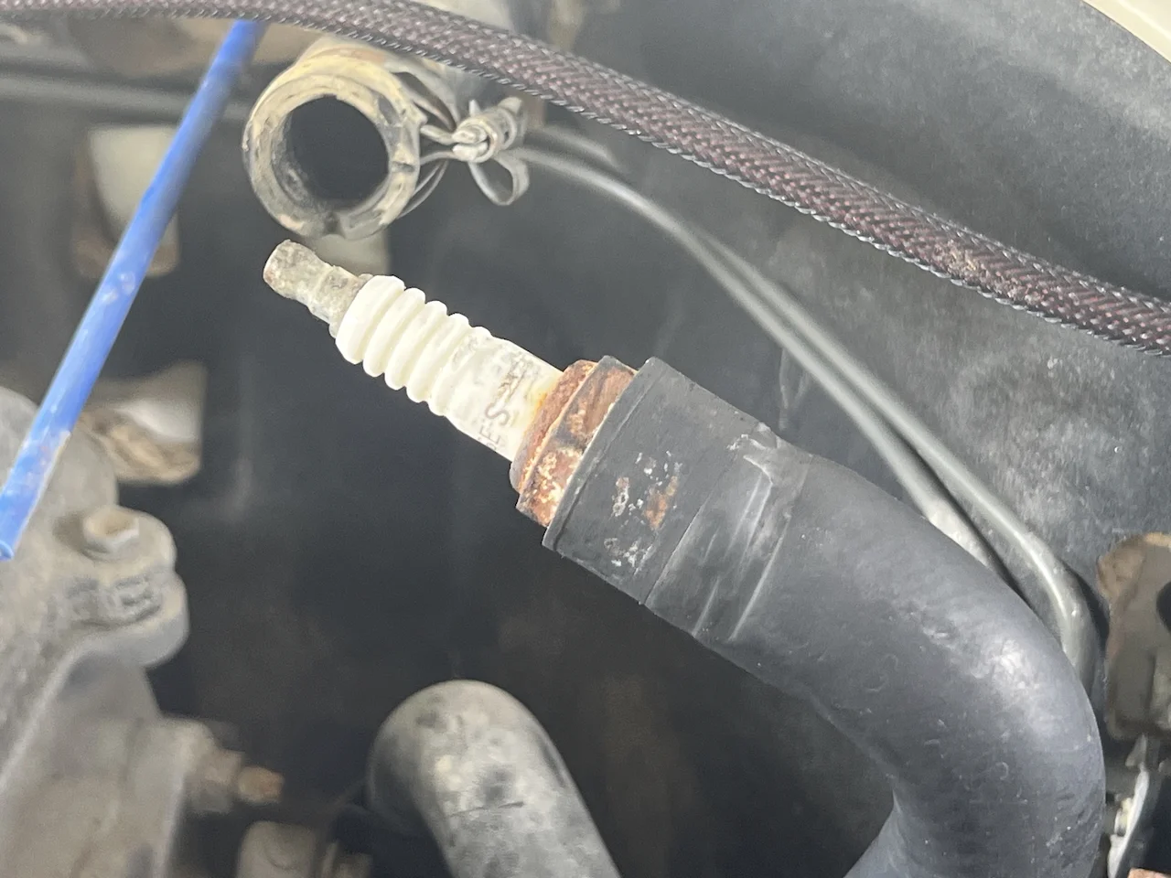

the Heater valve was broken off and the hoses plugged on either end, I was hopeful it was just the valve, but my gut told me something's up with the heater core. so....onto the heater valve replacement and see what happens.
a very creative plug was discovered, as well as confirming my suspicions that there's a leak somewhere in the heater core - seals? tank itself? time will tell. just going to re-plug it for the summer and deal with it later. :-)

What bulbs did you use in your dash? I’m digging the green color!
Cheers, James
Sorry for the delay…. One note, in my gauge cluster there’s one bulb that different than the others, at the top of the speedometer.
Amazon specials…
