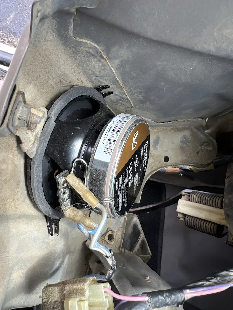

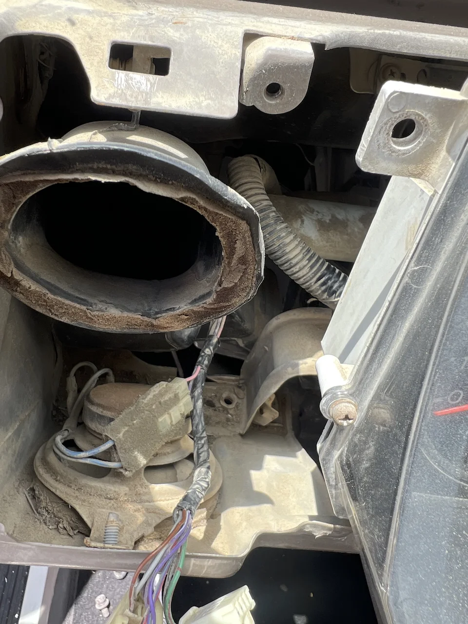

While I wait for her to arrive, does anyone know what size the stock head unit and speakers are? I’d like to replace the stereo with something tasteful and useful since the existing radio doesn’t work and speakers are worn out.
I put 4" speakers in the dash spots, 3.5 might also fit better
Pair of 4” speakers in the dash. Most come with bendable mounting tabs and will fit in the stock location with the tabs bent. You can see just that in the above example from @CardinalFJ60.
Radio is a standard double DIN, or single DIN with either a pocket or some other aftermarket/3d printed single DIN filler/gauge panel.
If it still has the OEM radio, likely not needed, but otherwise you may find that you need the radio mounting brackets (86211-90K00 and 86212-90K00) and screws (4x 90159-50173).
