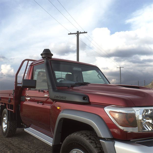

Clearview out of AUS makes mirrors. I know a guy with the on his 200. Pretty nice, also power folding and all that jazz. Not cheap.
I checked those out when I first saw them on 4WD Action, I get why they have the brace that goes farther down the door, but they look a little funny to me with that huge lower black piece. Maybe its the contrast on white. But if your towing, that extra view would be super helpful.
I agree, that lower portion looks a tad odd. Doesn't bother me a ton though. Personal preference, I think they don't look any worse than the oem mirror mount.
That's a good point, I forget the Ute boys already have a few extra holes and some goofy braces. Definitely and upgrade HA. I am a fan of the tundra telescoping style tow mirrors, so all things considered I think those clear views are an improvement. Will they go on your troopy?

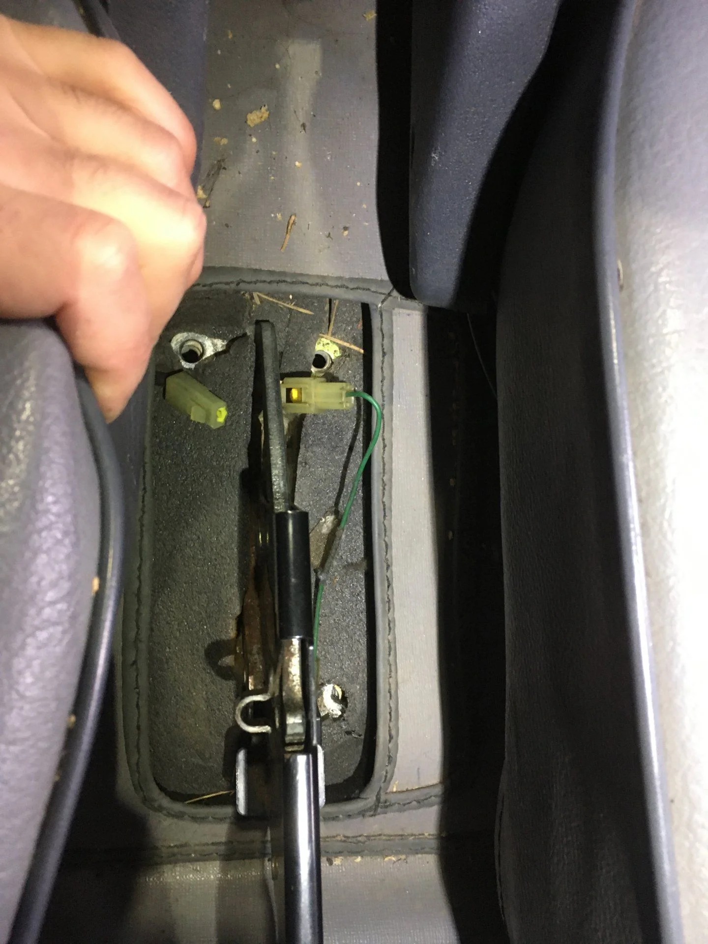

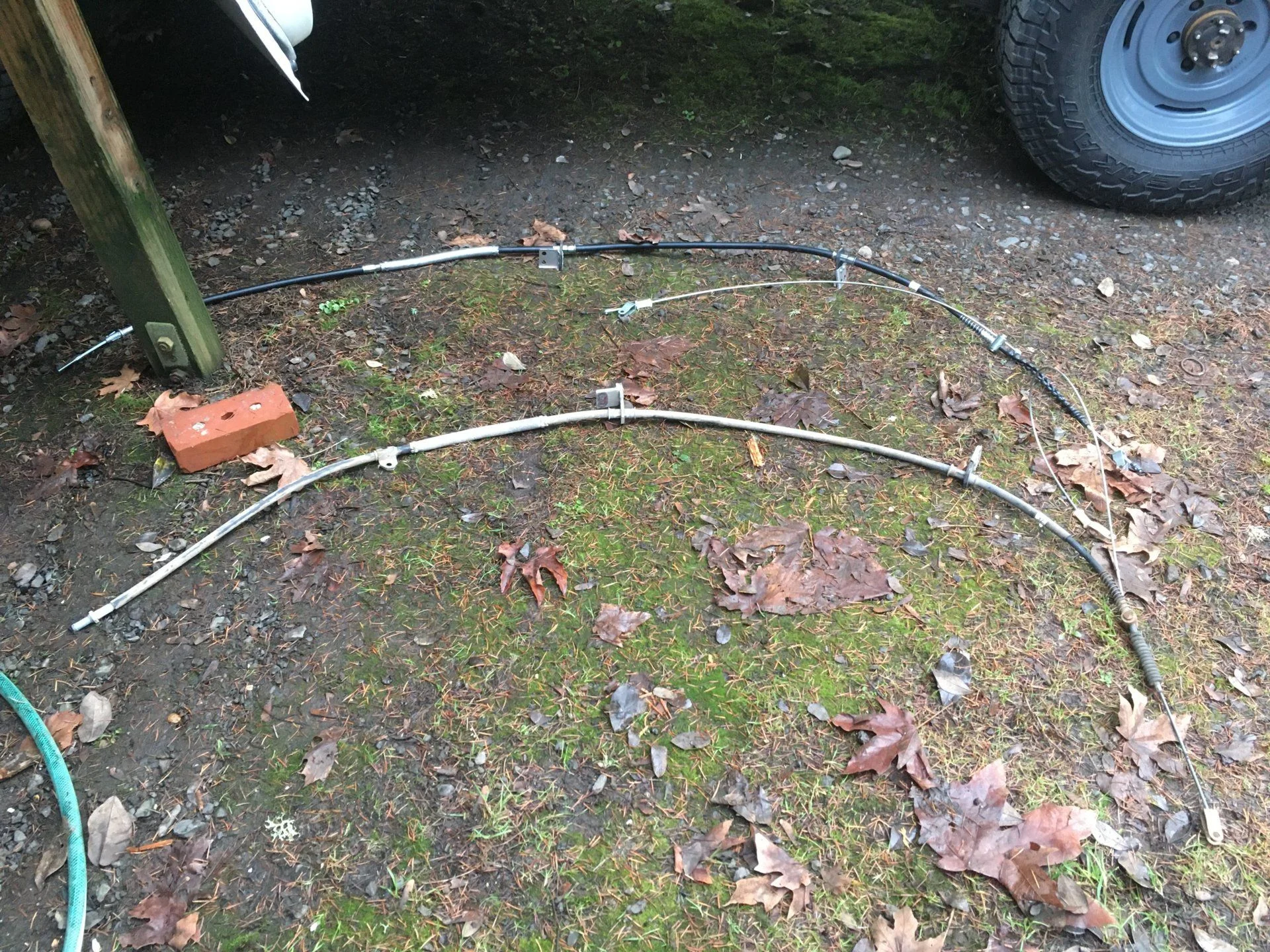

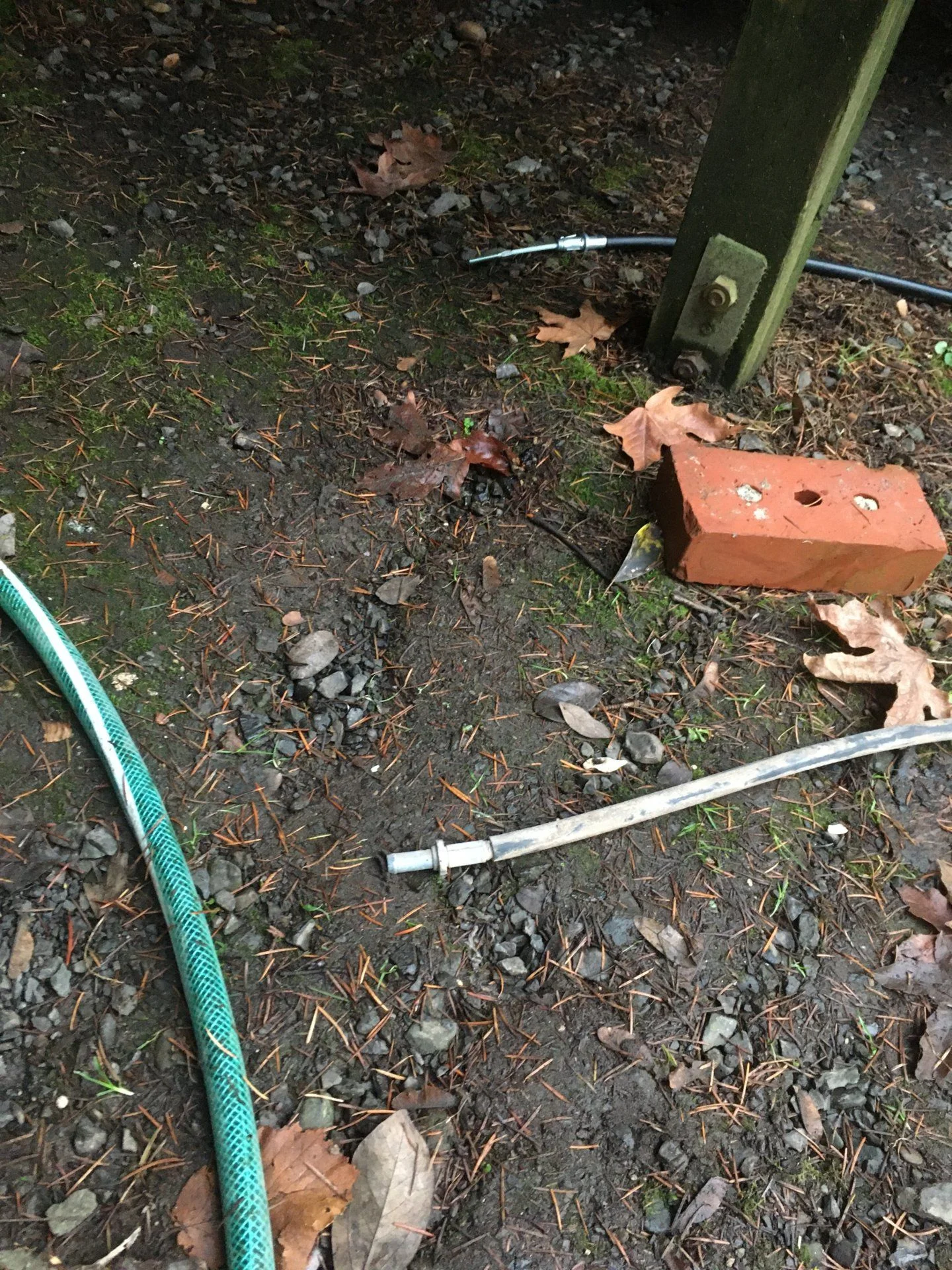

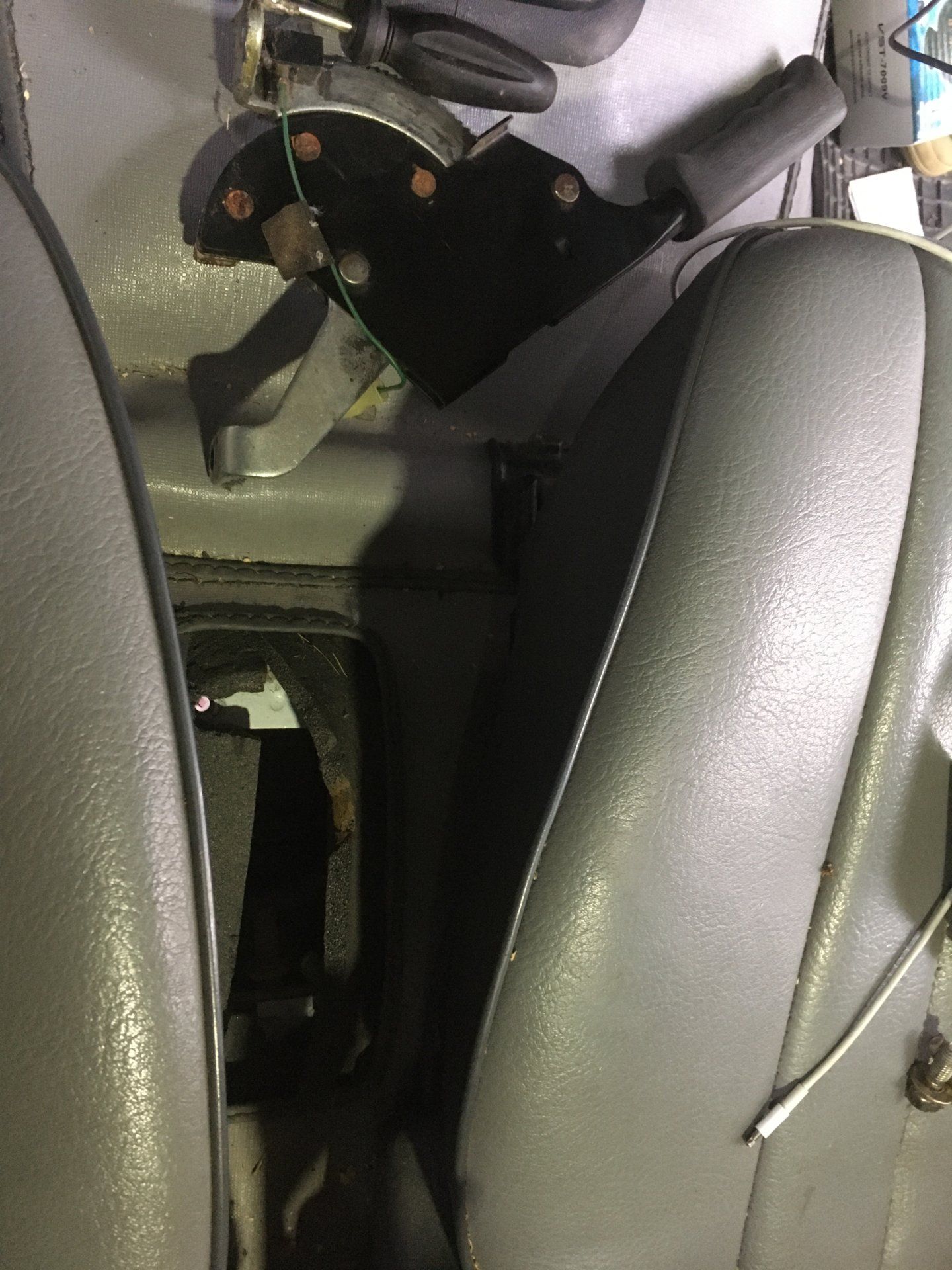

During my maiden trip up to Oregon to Utah and back to California, I had to replace a U-Joint and the E-Brake cable snapped. Not having an E-brake was not great for parking on hills and wanting to warm up the truck at higher colder altitudes, so I ordered one and replaced both while on the road. In the photos below, you can see how the end nub that screws into the brake lever broke.

Installation was super straightforward and logical in typical Toyota fashion. One lesson I learned though was to attach an electrical fishing wire or string to the end of the old E-Brake cable before yanking it out... otherwise it is kind of a pain fishing the new, stiffer, less malleable, E-Brake cable between the gas tank and the body to get it to the small E-Brake opening. To my recollection, I pulled out the old E-Brake cable unsheathed and duct taped it to the new one and fished it to the E-Brake hole.
