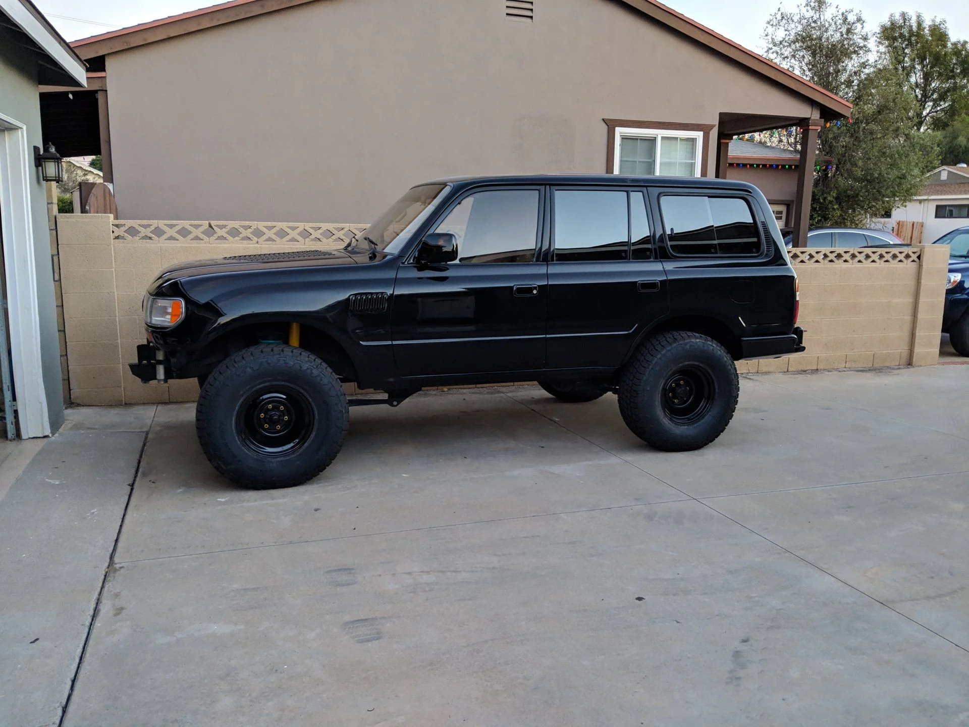

I bought my 80 in January from a good friend who has been a professional race mechanic for well over a decade. He usually owns 7-10 vehicles at a time from classic american and track ready Bmw's to Fj60's, 80's, jeeps. We have bought and sold multiple cars to each other and countless parts. He stripped the exterior trim, installed the louvers, bumpers and painted it. He did tons of maintenance work, installed steel wheels and the nitto's on it along with dobinsons springs, shocks, adjustable bars etc. I stopped by his house one day and this was in the driveway
I wanted it bad so we made a deal!
It now has 239k miles and is triple locked.

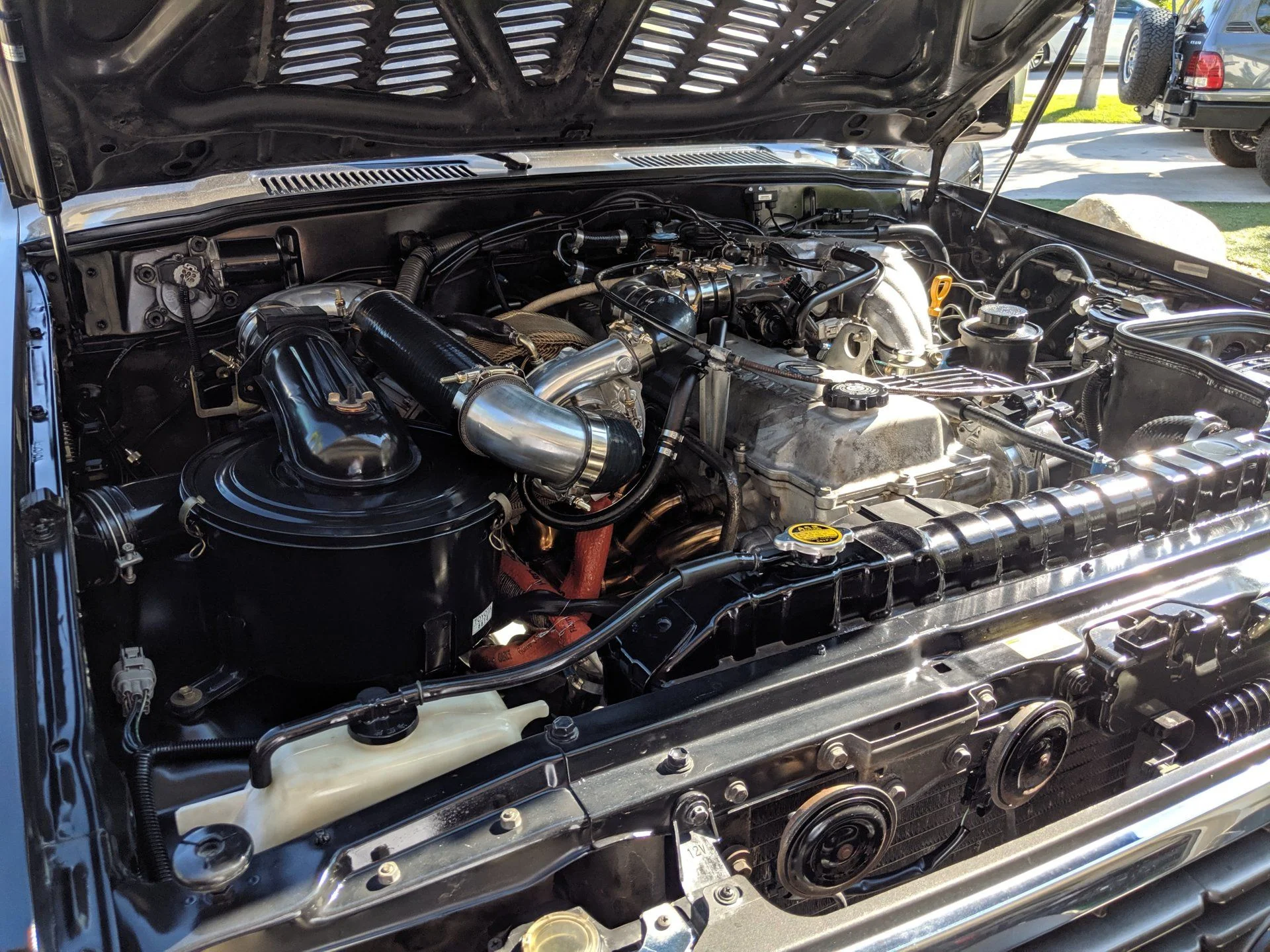

I put together a turbo kit using the CX racing manifold, downpipe and a T67 turbo with a .81 ar exhaust housing. I installed a split second enricher which works perfectly under closed loop. It maintains 11.6-12:1 afr from .5psi to 6psi (wastegate spring is 6psi), even though cx racing is china made its pretty good. I had a 1990 325is bmw and ran a cx racing manifold and turbo with a standalone and made over 400whp at 25psi with e85 and never had an issue in the 20k miles I put on it, other than head gaskets! I eventually oringed the block and never had a head gasket problem again. I will o ring the block of the 80 if the head gasket goes along with going standalone and a 5 speed swap!
