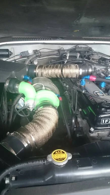

I have been running a turbo 1FZ since 2012
Borg Warner 7670 EFR turbo
600cc injectors
Water to Air Intercooler
Haltech
15-19psi of boost.
Rebuilt head, refreshed lower end with just seals and rubber parts, OEM bearings, Rods and Pistons.
Close to 80k miles.
I have driven across the country a couple times, up Eisenhower pass both directions at 80mph, up Monarch, over Rabbit Ear, etc. I have never found a hwy road that will slow down the turbo 1FZ on 35's with stock gears.

I like ... a lot .. Water cooled ok, like the short plumbing to from the cooler. The Water tank what the part of a kit prior offered? 15-19 PSI.. sweet! not your average build for sure. is that an extra injector in the air leaving the turbo? Haven't seen that .. before. got me curious ? Mil spec AN fittings.. hum What about heat induction there at the air filter ? looks like that corner is seal on that angle? yep got my attention for sure. Fuel, at that boost are you having to pull timing back for spark knock? at 15-19 that should pull if the flow is good, good power numbers. Standard radiator is appears, so no overheating issues then.
OEM bearings, got that .. New stock poem pistons and rings? Bored? Rods OEM too? I hear they are a heavy rod and heavy piston stock on the 1FZ, Tuff bottom end.. Did you stud the engine? Head or rods? Change the cams? Head gasket OEM?
I see this and it excites me... I was planning maybe 10 PSI boost to start and tune for that. Maybe 5-8 lbs if needed.
How's the trans holding this increased torque? and Mods to it? or it is a standard?

No with the Haltech an extra injector is not needed you can just add larger primary injectors. The stock are ~315cc, the ones I used are ~600cc. The water tank is completely custom, it cools the IC, holds windshield washer fluid as well as fluid for water/meth injection. Yeah the air filter was sealed off from the engine bay as well as possible while keeping it high and somewhat protected, I also run a mesh filter wrap that is not shown in those pictures. And have since wrapped the intake tubing with DEI heat wrap. I have complete control of the timing using the Haltech, I wrote my own timing tables. No knock at 19psi. Estimating about ~410hp and 600ft/lbs. Transmisison has been ok with the shift kit drilled out to the most aggressive setting.

Sweet.. I don't see a blow off valve, when you close the throttle, do you get any surges?

I have a recirculation valve on the turbo, that replaces the blow off valve and allows that air to stay in the intake tract so you have better throttle response. I am not running a MAF using the Haltech you can use MAP so there is a pressure sensor on the Haltech.
