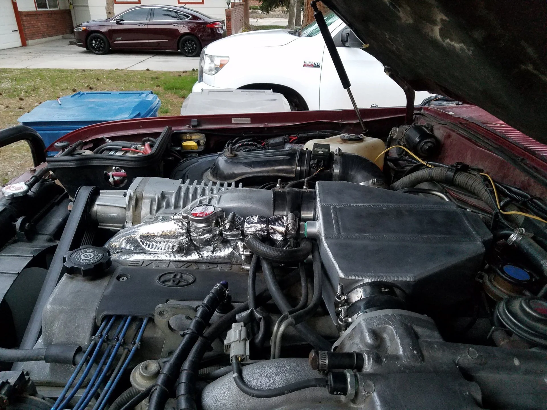

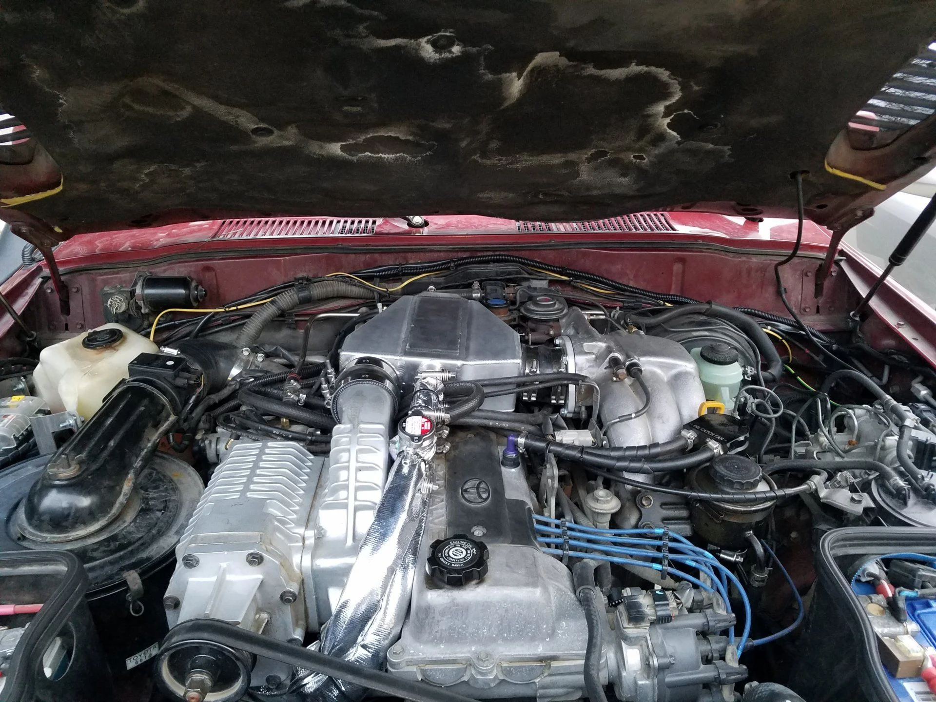

Attached is the way Safari routed its A2A intercooler. Very clean but does require relocation of the trans cooler.
Thanks! Do you know where the Safari kit relocates the trans cooler?
Yes FWIW I had a Safari turbo for a couple of years and sold it to @8cam so I know the system
Also FWIW the Safari Turbo in 8cams 80 was installed in 1997 so it has proven itself over the years as a reliable set up.
Below the radiator intercooler between the frame rails.

Pre-Detonation is bad.. when the knock sensor detects it, the computer retards the timing and you loose power. I remember when I was using the stock 3.25 pulley on my SC with NO intercooler and seeing the timing advance displayed on my UltraGage being in the -4 range.. effectively removing HP gains my SC would have giving me. All i got was extra heat and no extra power!
With my WAIC and a 2.8 pulley I dont see negative timing on the Ultra Gage, even under max boost.
In short.. yes.
Pre-Detonation is bad.. when the knock sensor detects it, the computer retards the timing and you loose power. I remember when I was using the stock 3.25 pulley on my SC with NO intercooler and seeing the timing advance displayed on my UltraGage being in the -4 range.. effectively removing any HP gains my SC would have giving me. All i got was extra heat and no extra power!
