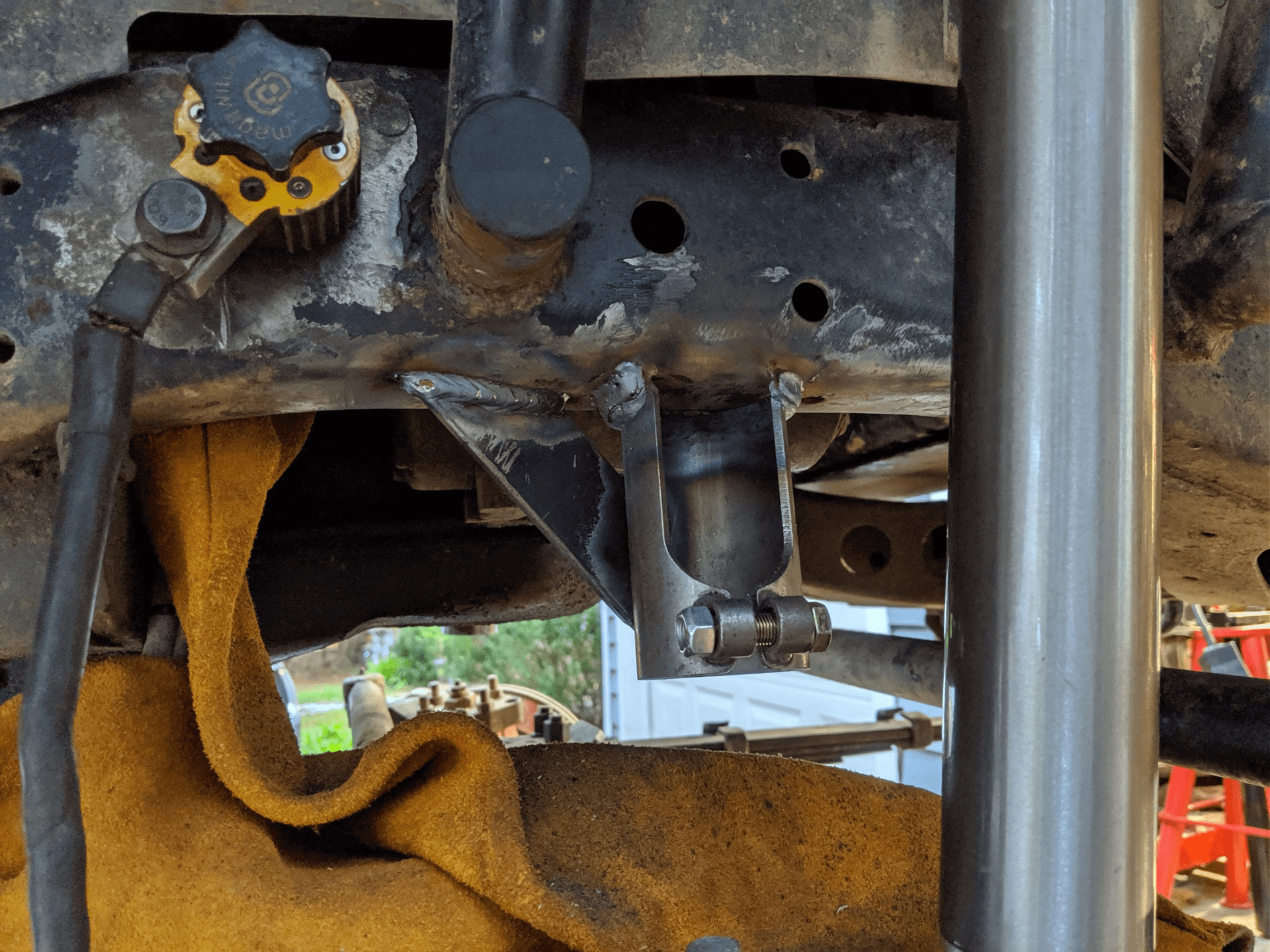

So from what I have found no one has run a front sway bar (other then the stock 60 front bar) on a SOA 60 before , which we all know is a rock magnet, plus all the bushings and links and mounts are thick rubber which means a ton of effectiveness is lost to compliance.
I am actively working on a front sway bar for my rig, nothing to show yet though. The 60 steering box being on the outside of the frame is the major obstacle. A RHD 60/80 box on mounted on the inside of the LHD frame rail or something like a Ford steering box would make it worlds easier, neither are options without completely re-doing my motors accessory drive though (I think).
