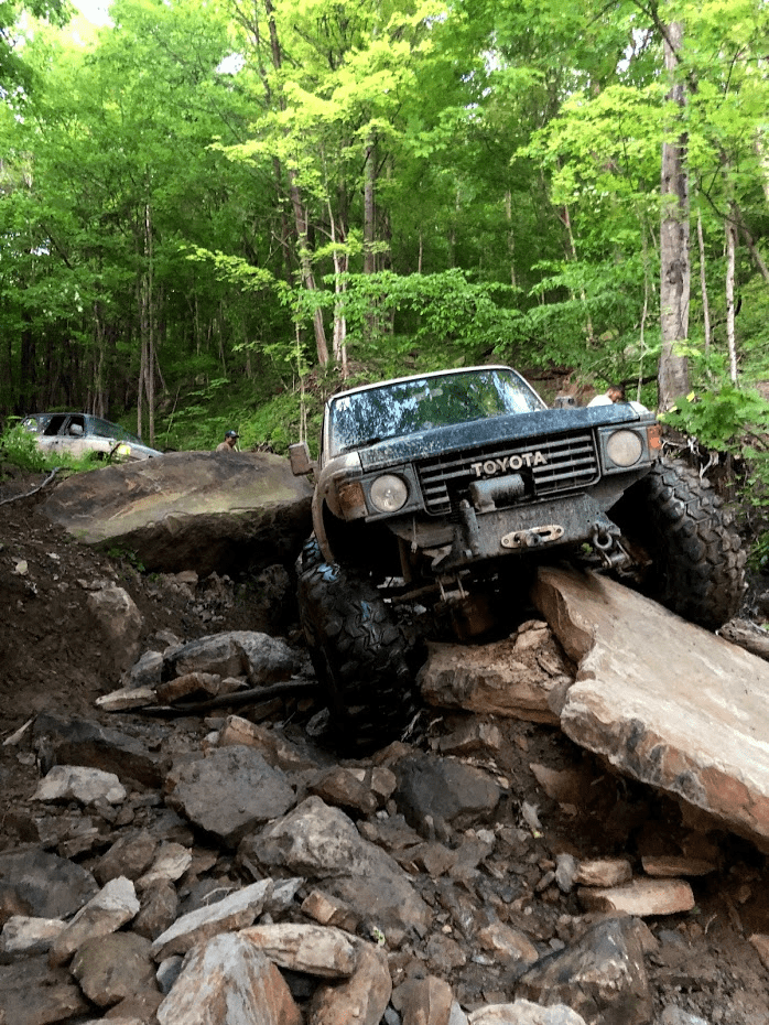

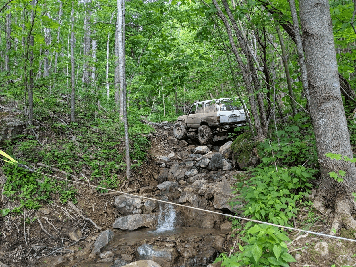

Last day I wanted to push it a bit, so the green 80 and I had planned on doing 71 and 71b in Windrock. 71b is a red that goes up a creek bed, very cool trail. Got up in there, and starved the truck for fuel, like I did two years ago on 74b. PITA.

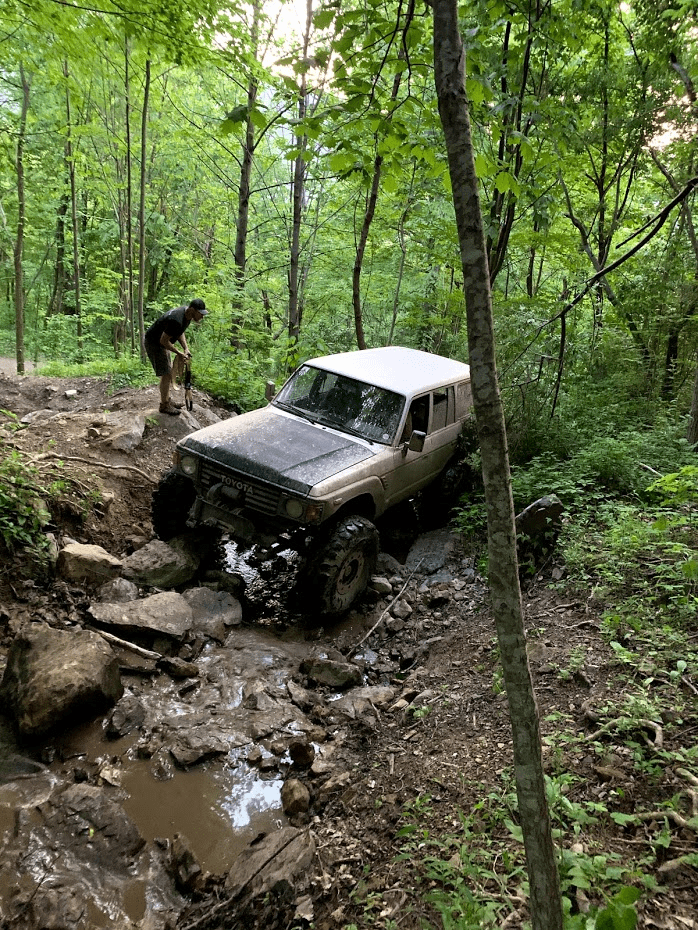

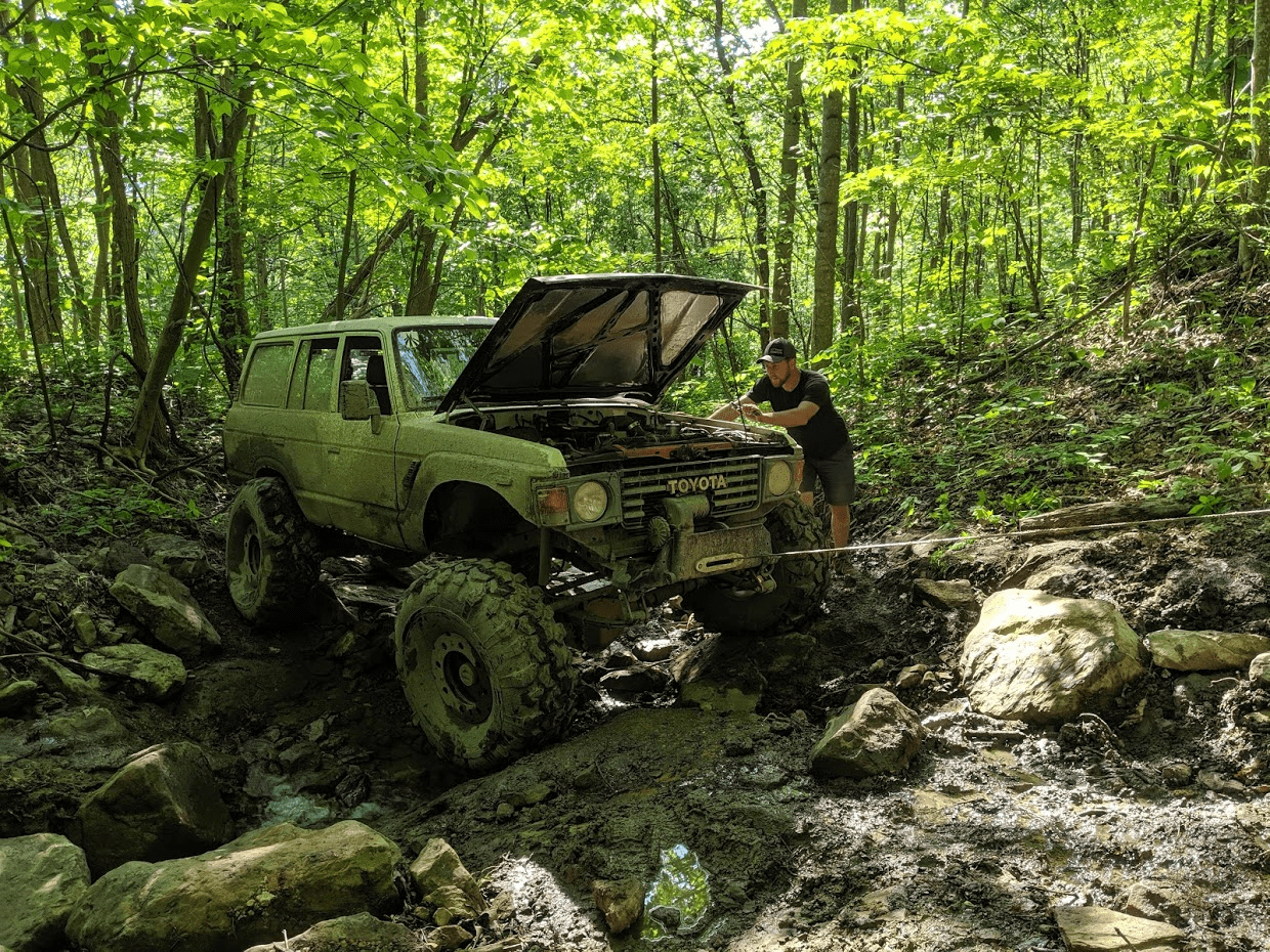

Had to get creative winching to get her down to a flat spot so we could work on her.

To make matters worse, moving the truck with starter and winch at the same time seems to have burned out my fusible link. Had to cobble together a repair on the trail.
4ish hours later a buddy of mine brought up 10gallons of diesel and we were moving again. It was fun getting out of 71b :D
