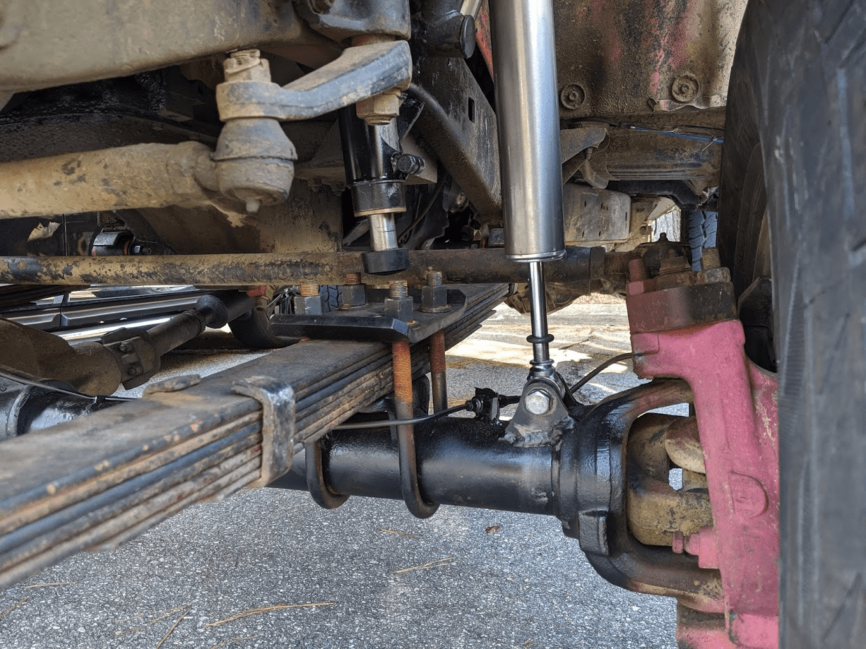

After a couple days of driving, I can feel the bump stops going over even the smallest bumps in the road.
This is how much uptravel I'm seeing with road use and *spirited* driving. Bumpstop shaft has black on it, and the shock shaft has the little o-ring that indicates the shock compression. This is going over roads with bumps big enough to bottom out my suspension with the old setup. I'm going to pull out one insert and space the bumpstop up an inch (internally) to give the spring some movement before the bumpstop. We'll see how that goes.
I think I'm going to love the fact that I can adjust how the bumpstop behaves :D

This is how easy it is to reconfigure the bump stops.
Step 1, jack it up
Step 2, slide out bumps, take them apart
Step 3, reconfigure. Added a spacer to restrict travel, keep one firm insert
Step 4, slide them back in, tighten the cans, done!
I think this will work well. I'll take her for a test drive tomorrow.

Adjusted bumpstops seem to be performing well. Over the past couple of days I get smoother ride over normal bumps and whatnot, but the bumps still prevent the shocks from bottoming out. You can see via the bumpstop shaft that it compresses about halfway, which is perfect.
I'm happy, she's happy.
