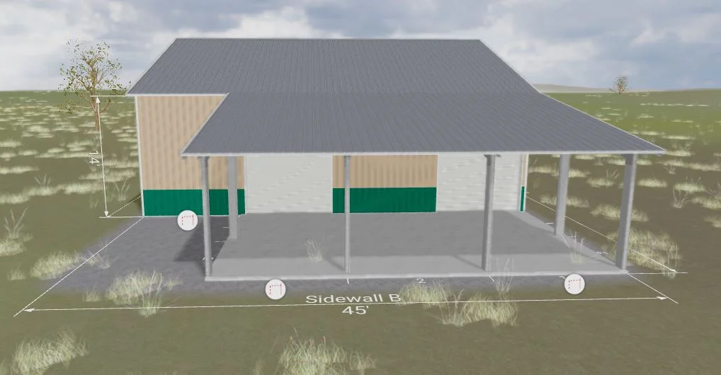

We set on a 40x45 with 14' eve height and a big leanto. We discussed 12' eve height with scissor trusses or steel trusses (open ceiling) and he said that the cost to do one of those would be the same as the additional height with regular trusses. He would have to special order the others. This will give me a good height to be able to add a mezzanine above my workbench space. He gave me an idea on cost of a smaller building (40x30) he finished this week and it has some significant differences and add-ons that I will not have so it added to that guy's cost. The building was really nice looking. Had lots of windows and high-end finishes, insulation and a ceiling. it also had considerably more concrete than he needed since the owner plans to add to it after his main residence is built. It was well below what I would have expected given the current cost of materials.

Here are some images of my plans:
I will now stop hi-jacking Michael's thread with the plan on starting my own once I sign papers (fingers crossed). Thanks again guys! You have all been helpful. Mud delivers once again.
Glad to be of service @Hugh Heifer The pictures look nice. I look forward to your shop thread soon!

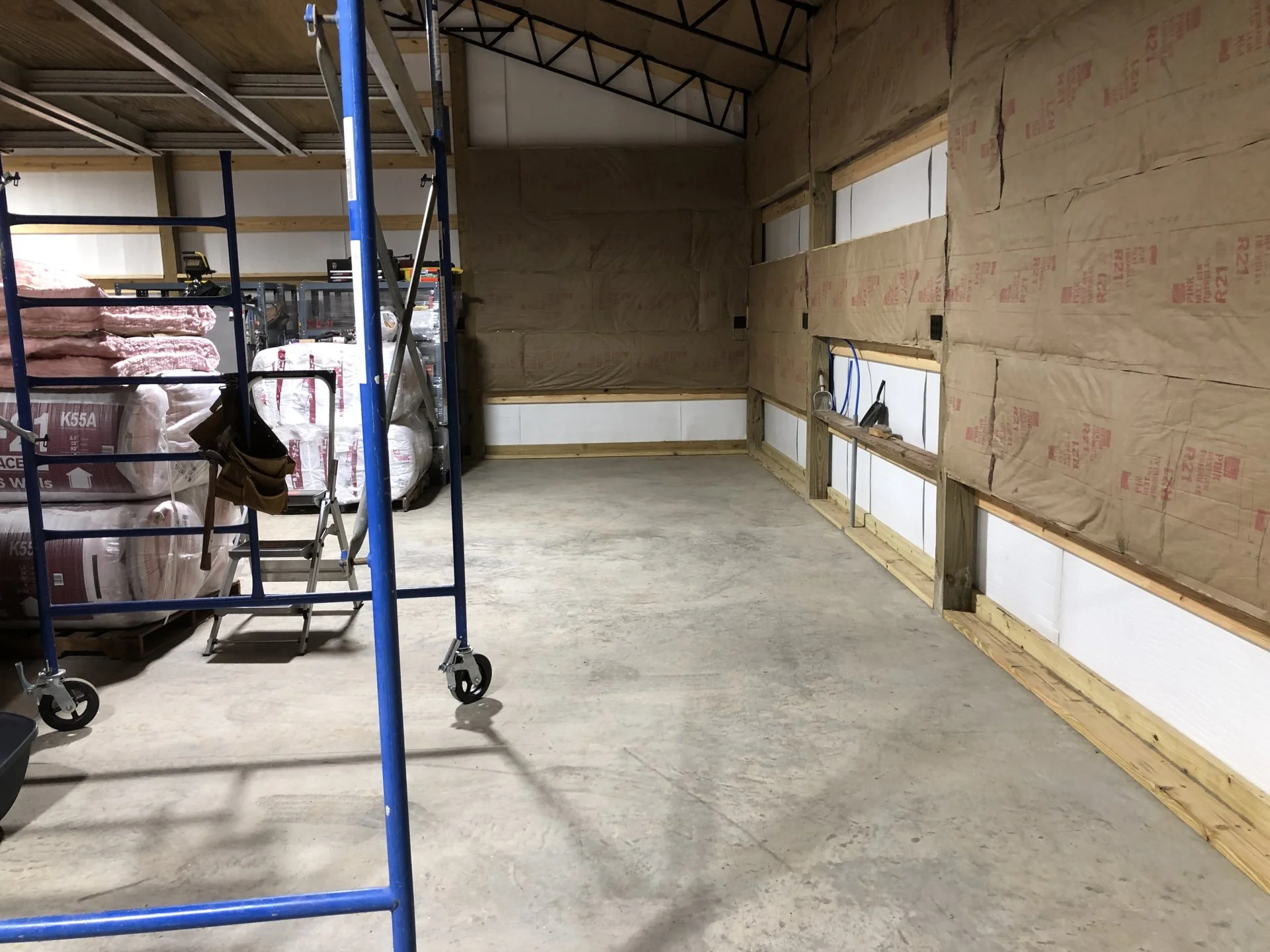

Worked on more insulation today. Tomorrow I need to pull nails empty the trailer for next weekend. Next weekend I plan on salvaging more metal. Hopefully the rest of the roof and start on the walls.
