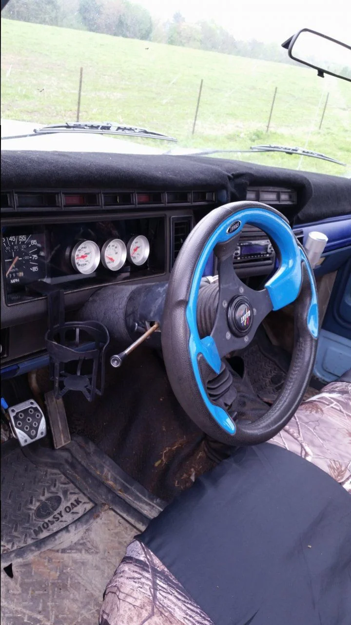

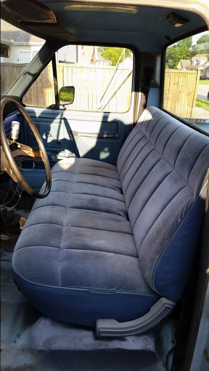

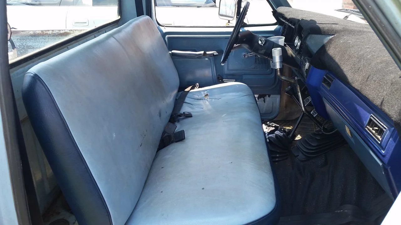

It came with vinyl bench with an "awesome" real tree seat cover and a b!t#hin' grant GT steering wheel. The springs were soo bad you may as well have been sitting on the floorboard. Our good buddy Jason picked me up a really nice cloth bench and a OE steering wheel that I decided to swap in today and thus begins what will undoubtedly be the first of many new adventures.

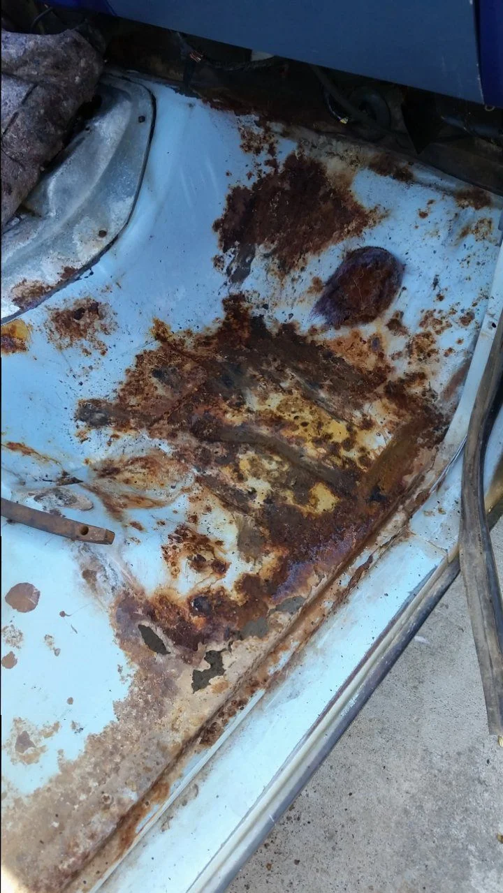

Pulled the old seat and decided to clean the floor good so I lifted the rubber floor covering on the passenger side to find this maddness..
Yep, those are holes in the pan and alot of nasty surface rust, so I guess I will give try my hand at replacing the pan soon. Drivers side looks much better. Some surface rust, but not bad. I ditched the factory rubber floor because the jute sound deadening was soaked. I plan to fix the pan, sand everything good, prime it, apply some lizard skin and then paint the floor.
I went ahead and put the new seat in just to get it in but it will have to come out to do the floors.

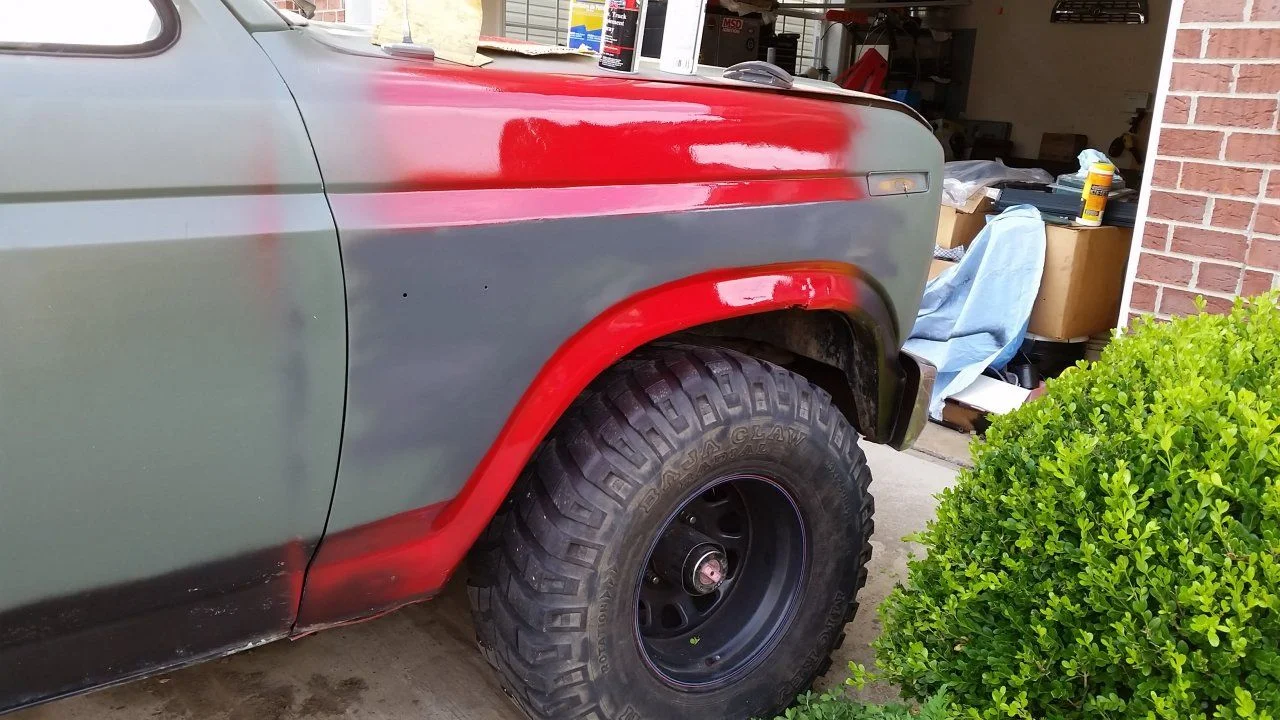

I also played with some paint. I think I am gonna redo it in a semi-factory two tone.
Massey Ferguson red and charcoal grey. Gonna really try to slick up the body to try to make the rattle can job look pretty good.

Got my floor repair panel in last week. I ordered it from Bronco Graveyard and must say it was the most well packaged sheet metal panel I have ever ordered.

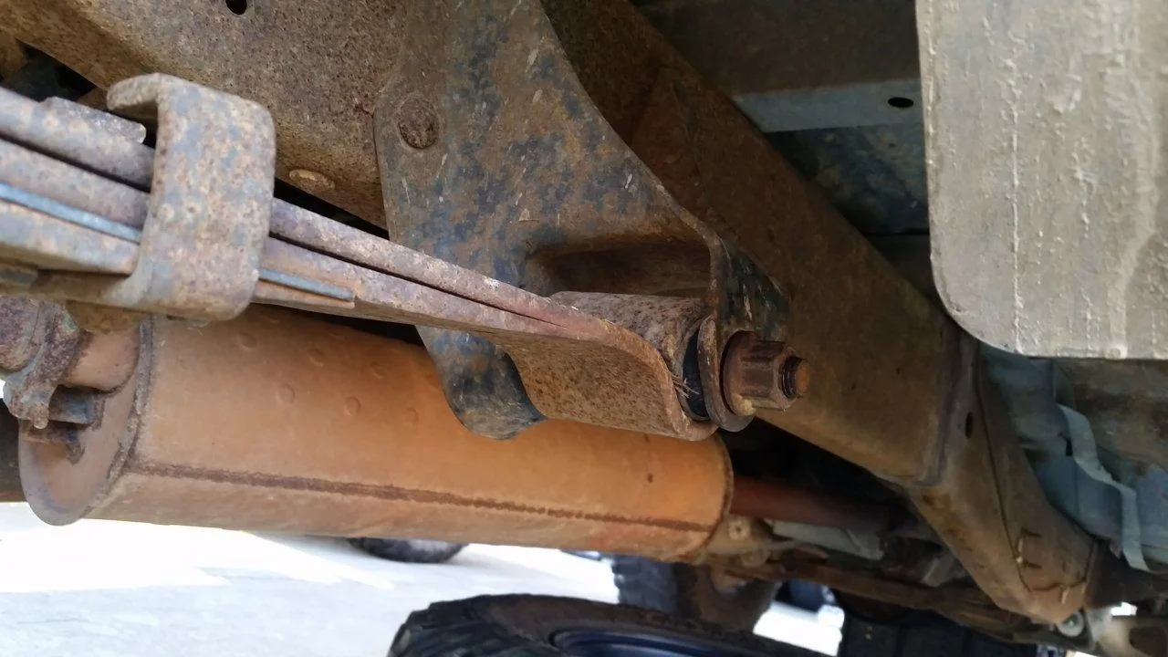

Well round 1 on the suspension goes to the 30 year old rusty bolts. I went out to try to swap out the rear springs.... almost 3 hours later I got a total of 5 bolts loose.
The nut came off the front mount, but the bolt is seized inside the sleeve... Guessing the shackle end is going to be the same, therefore the plan now is to pick up all new hardware and a new recip blade and stack the odds in my favor for the next round.
Guess I will try to burn in the cat and install the new tailpipe this week whilst I hunt for hardware.
guessing you're gonna be better off with a cut off wheel than a reciprocating saw, tried that before and they basically just scratch the surface and don't really cut much. Sounds fun though in the 90* heat, best luck!!
Thanks Ted, now that you mention it I remember trying cut a LCA bolt with a recip and it taking FOREVER.... I have a stack of wheels for my little grinder, but probably should pick up a few for my other grinder too.
yeah major cut-off wheel or torch..plus a BFH for fun
Yeah... Cut or burn those suckers off. Gonna waste a LOT of time trying to get them off and will end up having to replace them anyway.

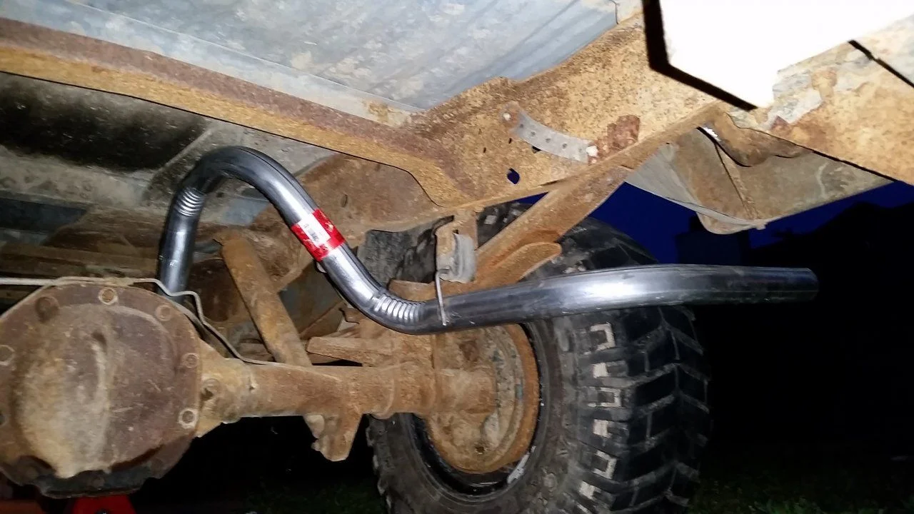

I got out tonight and did a little exhaust work. Unfortunately somewhere down the line somebody redid the exhaust, so my catalytic converter is 1/4" too big. Will stop by pep boys and grab a few misc pieces of piping and hanger brackets to put it all together.
I did cut off the old tailpipe and slide in the new one. Just need to drag out the welder and burn it in.

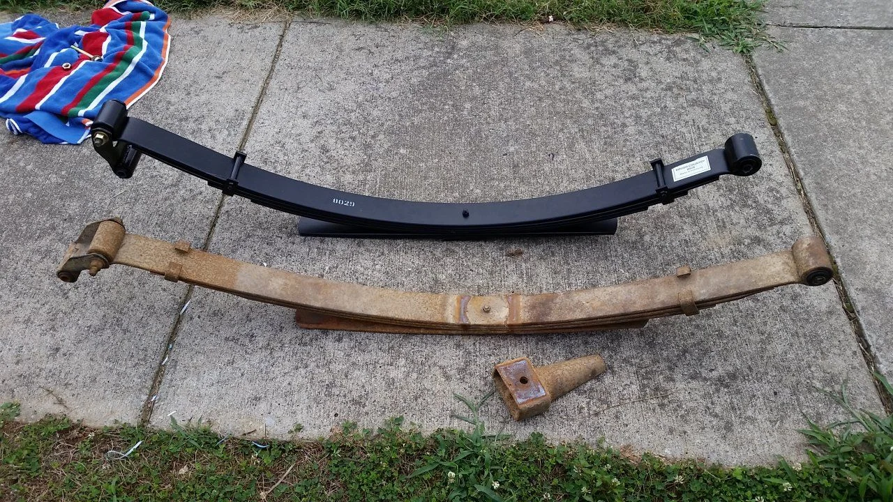

Well Betsy was a real b!tch to me this afternoon. At around 1 I decided to try and knock out the rear springs.... grinder made short work of the one stubborn bolt and since all the others on the passenger side were already free I had the old springs out in less than 30 minutes.
New and old
The new 5-leaf pack replaces the old 4-leaf and the block. And that folks is where the good ended in my afternoon. What followed over the next 4.5 hours was EVERY wrong way to try and install the new spring. If Erin hadn't been there to lend extra hands I'm not sure I'd be done now.
So 5 hours later we had the passenger side spring in
I need to trim the u-bolts and finish tightening them down. Shocks will go on after we do the drivers side.
Gained about 1.5" from the old worn out stock springs and hopefully we got the process so the drivers side will go much faster.
