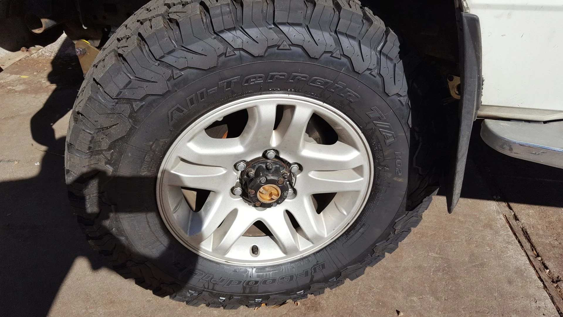

Finally picked up my BJ73 from Diesel Dog. This truck has quite a history. Sold by DD, repossessed by me, lifted by me, returned to DD by :princess: after DDs accident and before I left for PI. It was stored indoors for about 6 years. Javier in Houston went through it to be sure it was ready for a cross country journey and put my new BFGs on there. North bound to Austin tomorrow. It needs some care to mitigate a bit of rust but the 3B and H55 are in good shape.

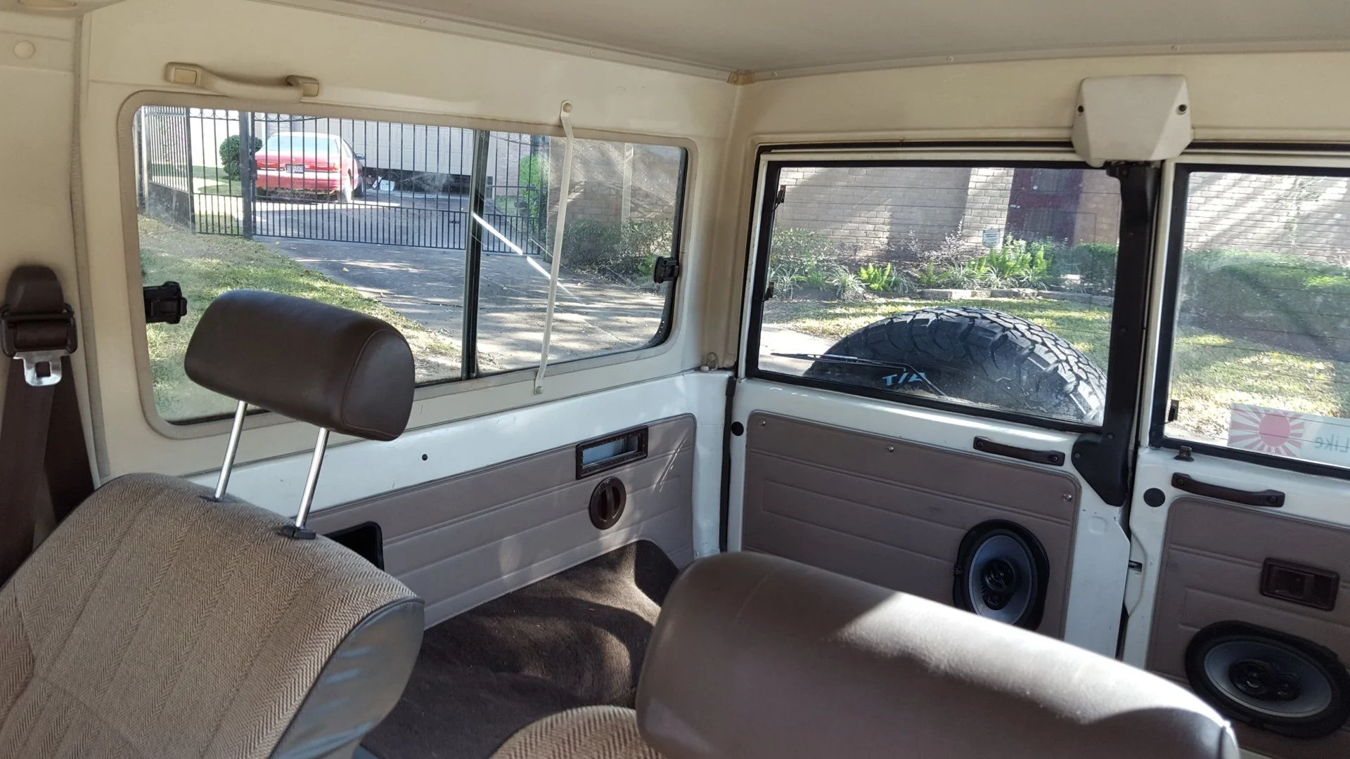

Did all the JDMs have those glass protecters on the back windows? I only recall seeing them on JDM 6* series
Have you checked to see if they are the same as a 60 series?
Yeah - it is the same split case as a 60 series so should be easy to get. Lots of places are closed today and I am drinking beer everywhere so I did not try too hard. The wife wants me to wait because she knows something silly will go wrong.
The other question I can not answer. I was thinking it was to strengthen the FRP top where the big hole was for the side windows and prevent some flex.
I thought it was to stop loads hitting the windows although surely something would find its way around a skinny little rod like that.
