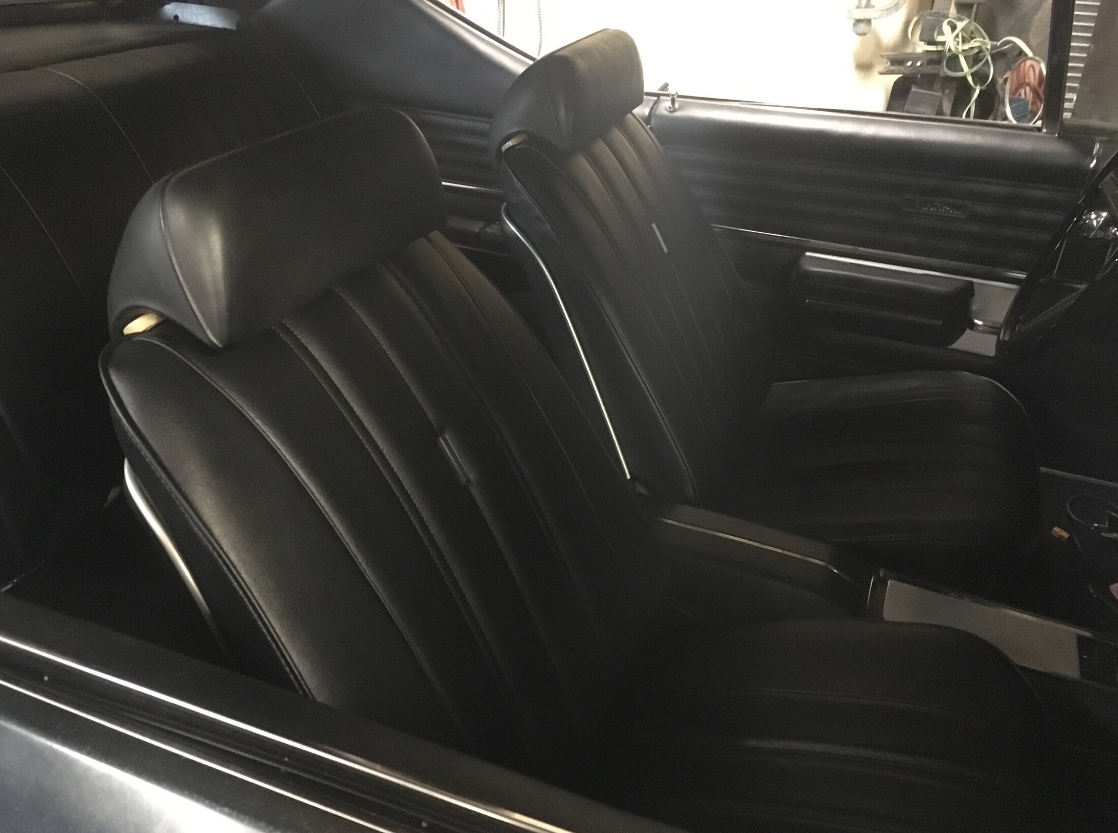

Thanks. It’s a 68 Chevelle Malibu. Originally 307, powerglide, bench seat, blue interior. I tried to buy this car for about 15 years; was sitting under a tarp near a shed. Easter in 2017 or so I stopped by and he finally agreed to sell it. Swapped it over to black interior with bucket seats, console and Muncie 4 speed behind a BBC 454 that’s had a thing or two done to it: should be near 600+ hp. Also 2000 Z06 Corvette 4 wheel disc brakes and very upgraded suspension. Built it with the intention of a very good handling street car that I could AutoX but haven’t tried that yet. It does handle like it’s on rails though and according to my phone gps, 135+ mph isn’t unattainable. *Allegedly*…..
Landcruisers not included, my mantra has always been “First, it must be fast”.
Day I bought it.
OSPHO and buffing.
Black interior swapped in.

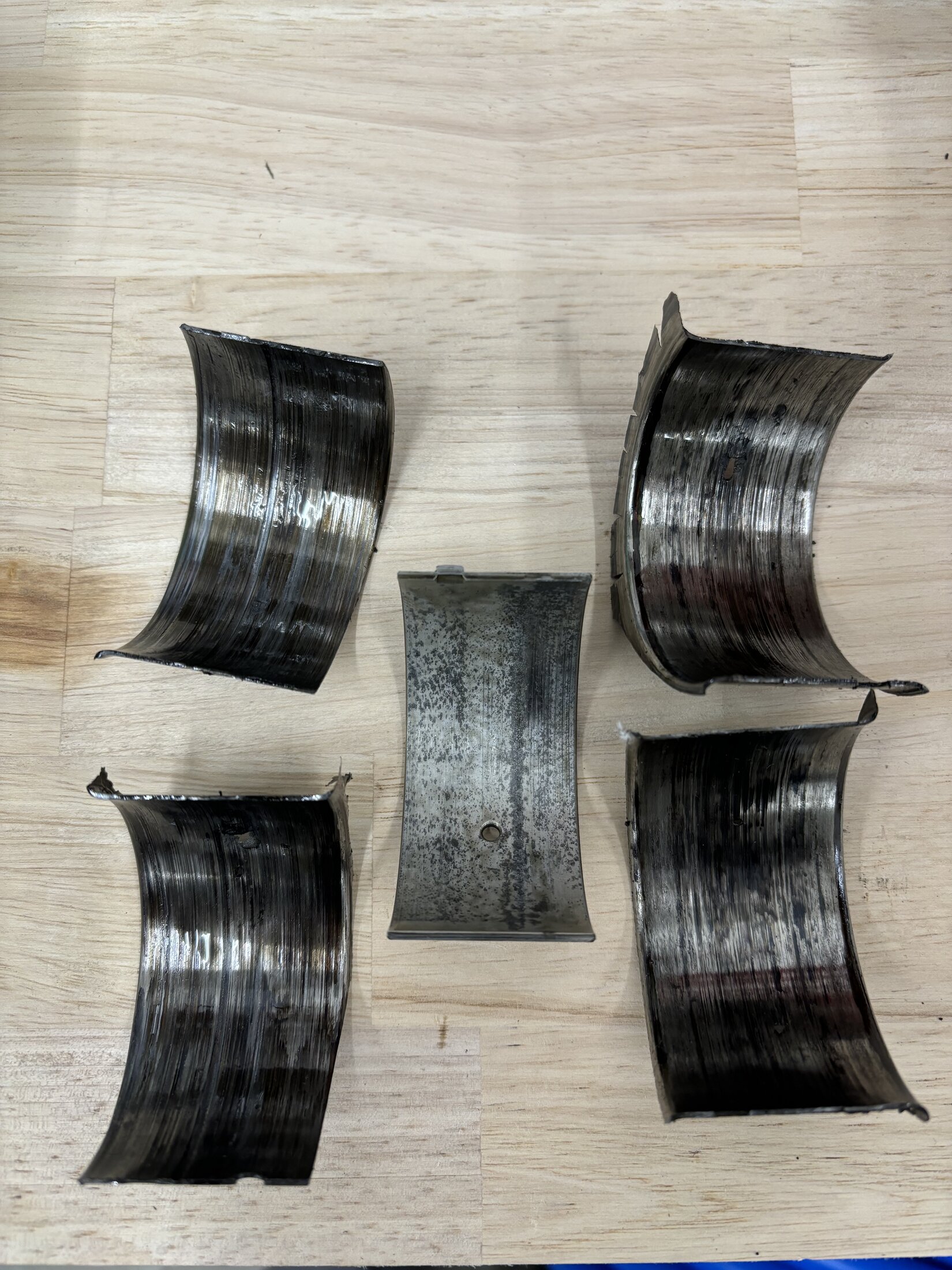

Getting running, driving, reliable and safe then sell it.
I started a thread on it; crank is out getting turned right now and then I’ll start putting the engine back together. It’s on the semi-back burner while I replace the head on my silver 60 and build stainless exhaust for it, but I should be done with that one in the next week. Hoping the gray one is driving in about a month or so.

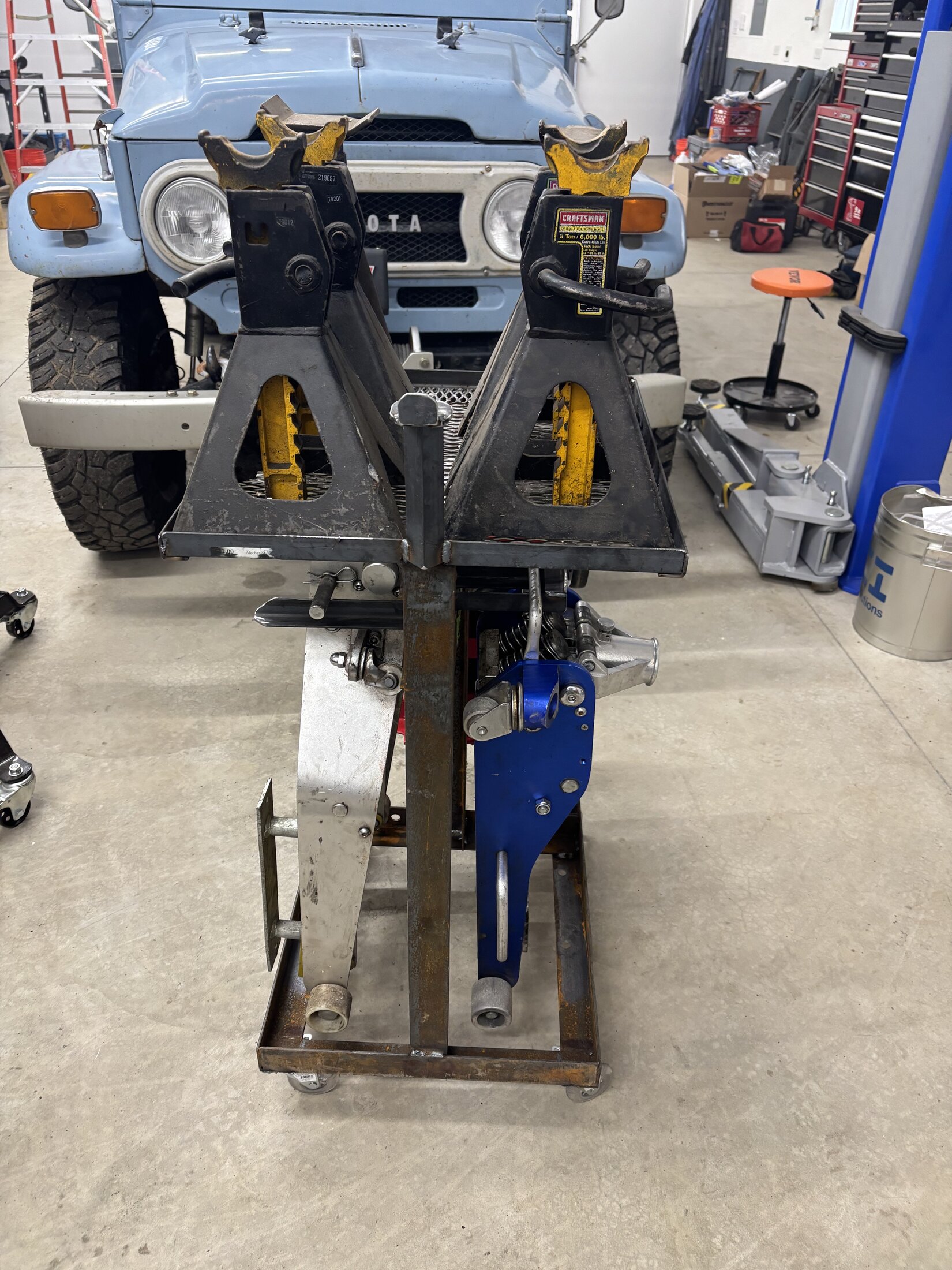

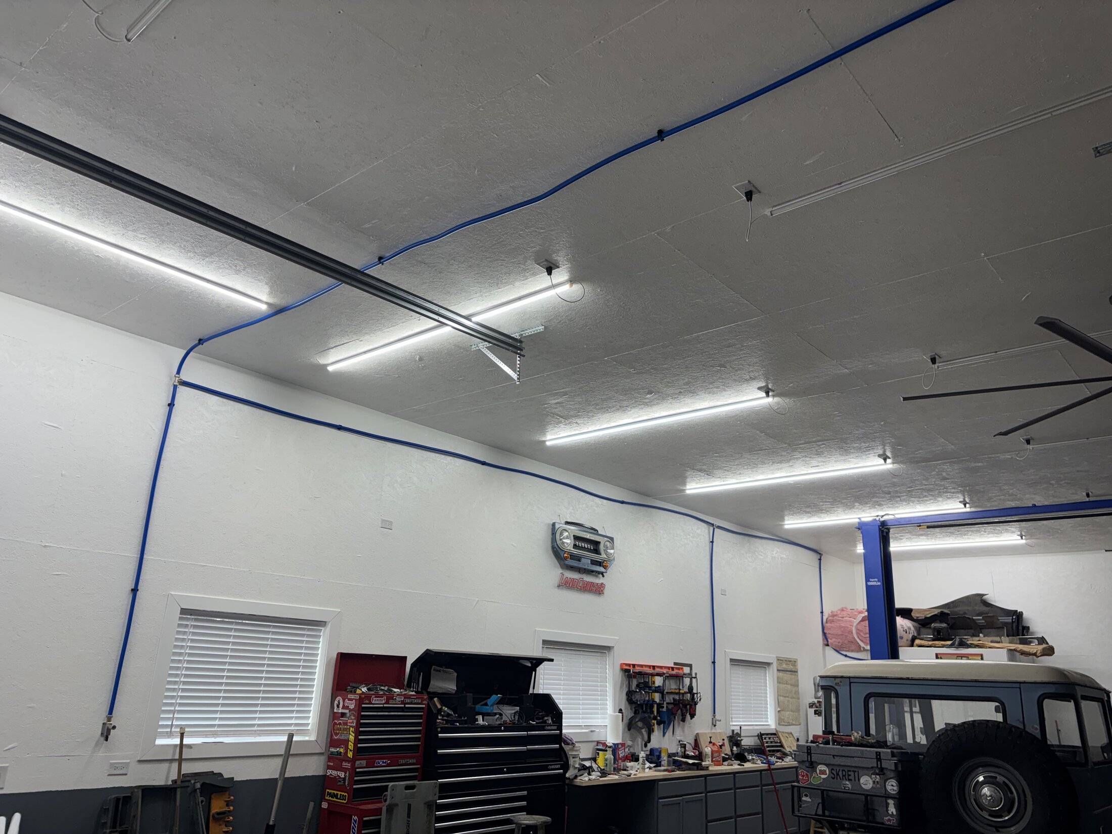

I have been neglecting the last little things on the shop since I’ve been able to work in it. Last couple days I finally started running my air lines. Then today I made a cart for my jacks and jack stands out of some scrap I had. Been making dollies for everything like my blasting cabinet and parts washer so I can move things easily.
Darn good idea with the rolling cart… been welding some dollies for my heavy stuff and lately, they’re all heavy. I prefer all 4 wheels swivel, makes it easier to roll into tight spaces with easy maneuvering
I bought a couple $45 Wen brand dollies online for a couple pieces. Mostly because they had flip up casters and I couldn’t build it that cheap. But, weeks on one side are fixed and the other 2 swivel. For the blasting cabinet and parts washer that’ll rarely get moved, that’s fine. But this jack cart, the cart I’m building for my stomp shear, things like that; all 4 need to swivel.
How are your airlines working out….?
After 2 years I do have a slight leak somewhere..i Ihave 8 drops and tees for each at 11 feet high. I am not anxious to get on a ladder and tweak this fittings… (old guy syndrome) some of the junk I trip over these days is annoying AF, falling off the ladder would really hurt.
The leak is certainly nothing to worry about…I keep my regulators around 120psi and it stays charged a few hours but then kicks on
After 2 years I do have a slight leak somewhere..o Ihave 8 drops and tees for each at 11 feet high. I am not anxious to get on a ladder and tweak this fittings… (old guy syndrome) some of the junk I trip over these days is annoying AF, falling off the ladder would really hurt.
Haven’t even put air to them yet. I need to finish one more drop and the thine to one hose reel.
I’m disappointed with the kit. I picked one off Amazon with the most/best reviews and the length I needed and amount of fittings I thought I needed. Had to buy 2 “T”’s and 2 pipe to tube fittings still.
My problem is, everything is pipe thread but straight cut threads, not tapered. I had to buy a bunch of extra brass fittings that were tapered to make everything work. Still probably cheaper than a rapidair kit but annoying.
Good to know, I have a blue chineesium kit waiting for installation.
I have the RapidAir kit… had to buy and extra 100’, extra tees, extra terminal ends and extra parts to connect my old hose reels. That overnight Amazon shipping was great but then every other day I was re-ordering what I did not think I needed
