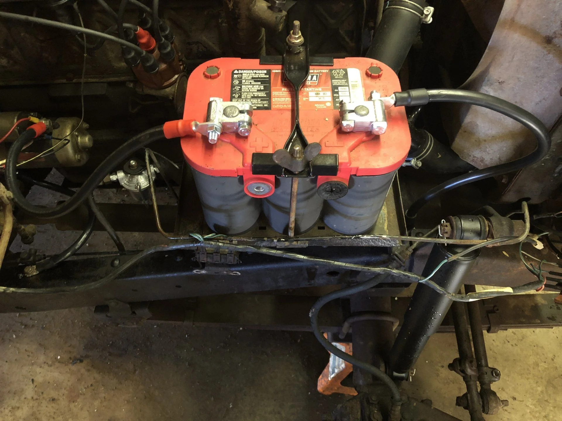

I got some new battery cables from Mud vendor @Fourrunner installed. Very nice cables. I run them on my 40.

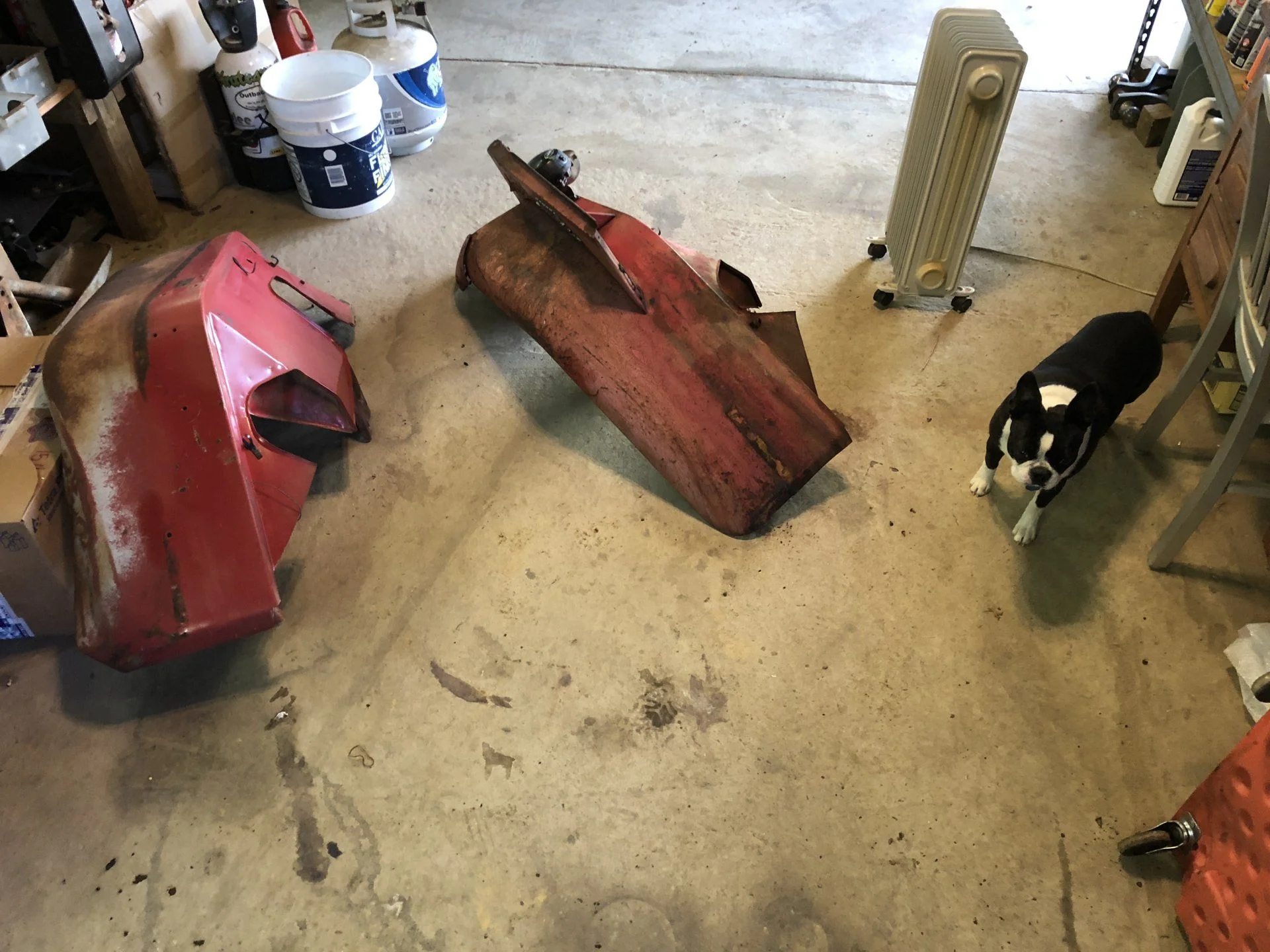

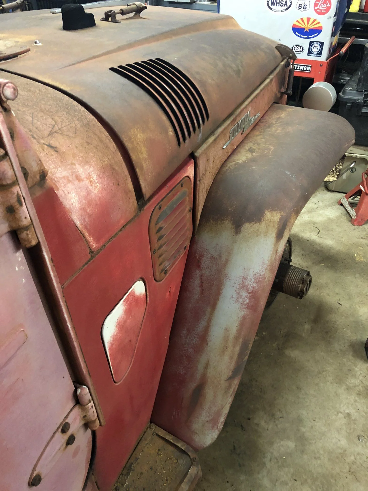

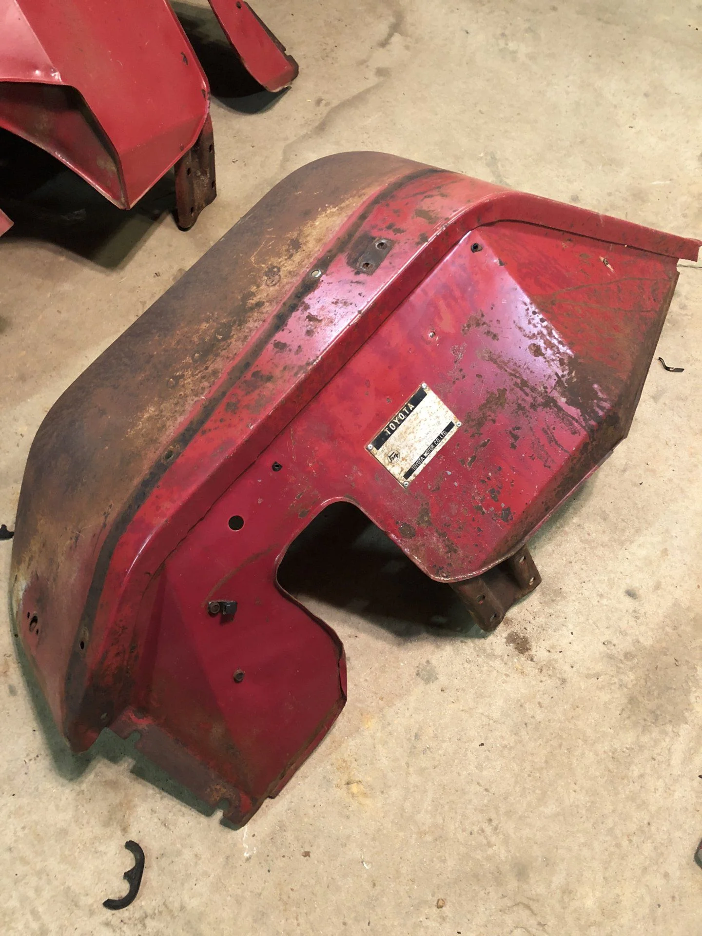

Got a bit done tonight. Treated the new fender with Rust Inhibitor and then hit it with CLR after 5 hours cure time
I swapped the correct fender badge on to the “new” fender

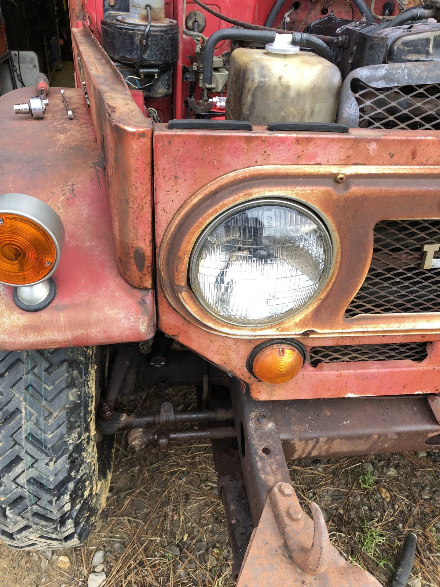

I realized how bad the front end was out of whack when I put the fender on
I broke out the dead blow hammer and went to town.

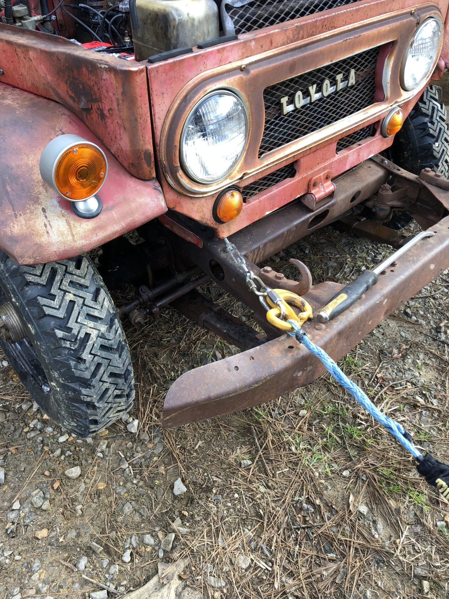

Before I swap in the drivers side fender I’ve got to massage the grill to work with the new fender. I’m going to have to pull it out forward. Likely use my little warn portable winch.
I think it all matches pretty nicely

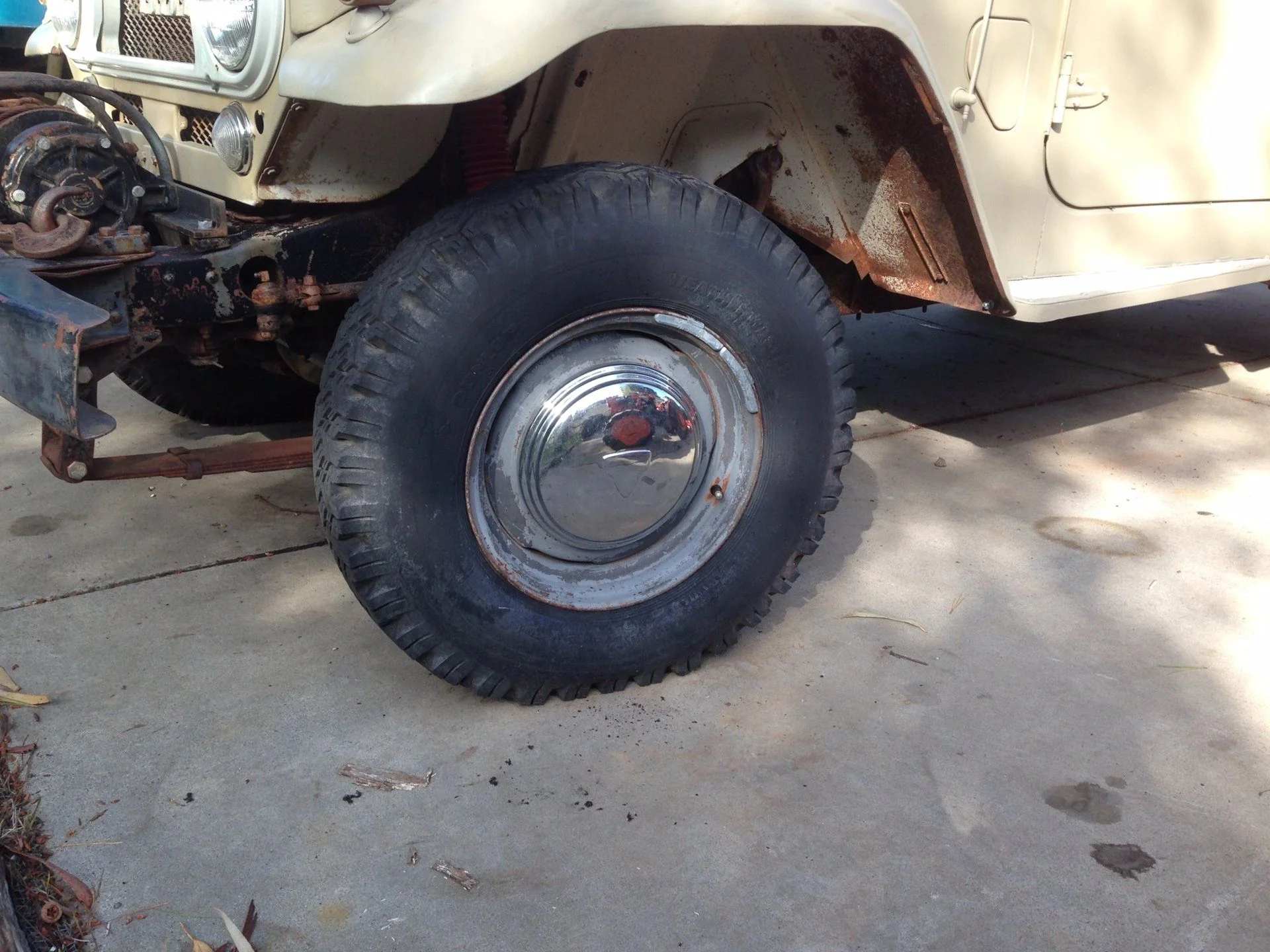

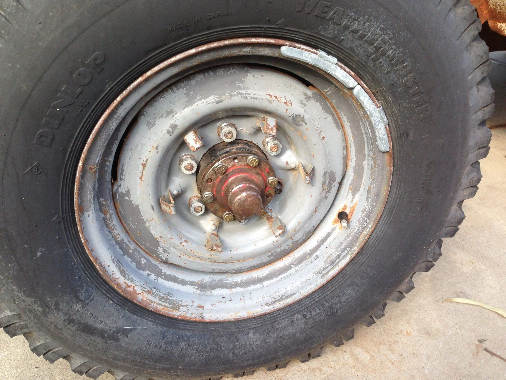

Nolen,
I still have the flanges that came off Patina when you put in the disk brake axle. They are yours.
Nolen,
I wonder if they work with a ball and claw outer axle? I’ve got no clue.
That said I’m waiting to hear if I can buy two repro fronts
You know you’re going to want discs on there eventually...
Yes. Likely. Right now it’s all new. Drums so it stops fairly well. It’s on the list but at the bottom.

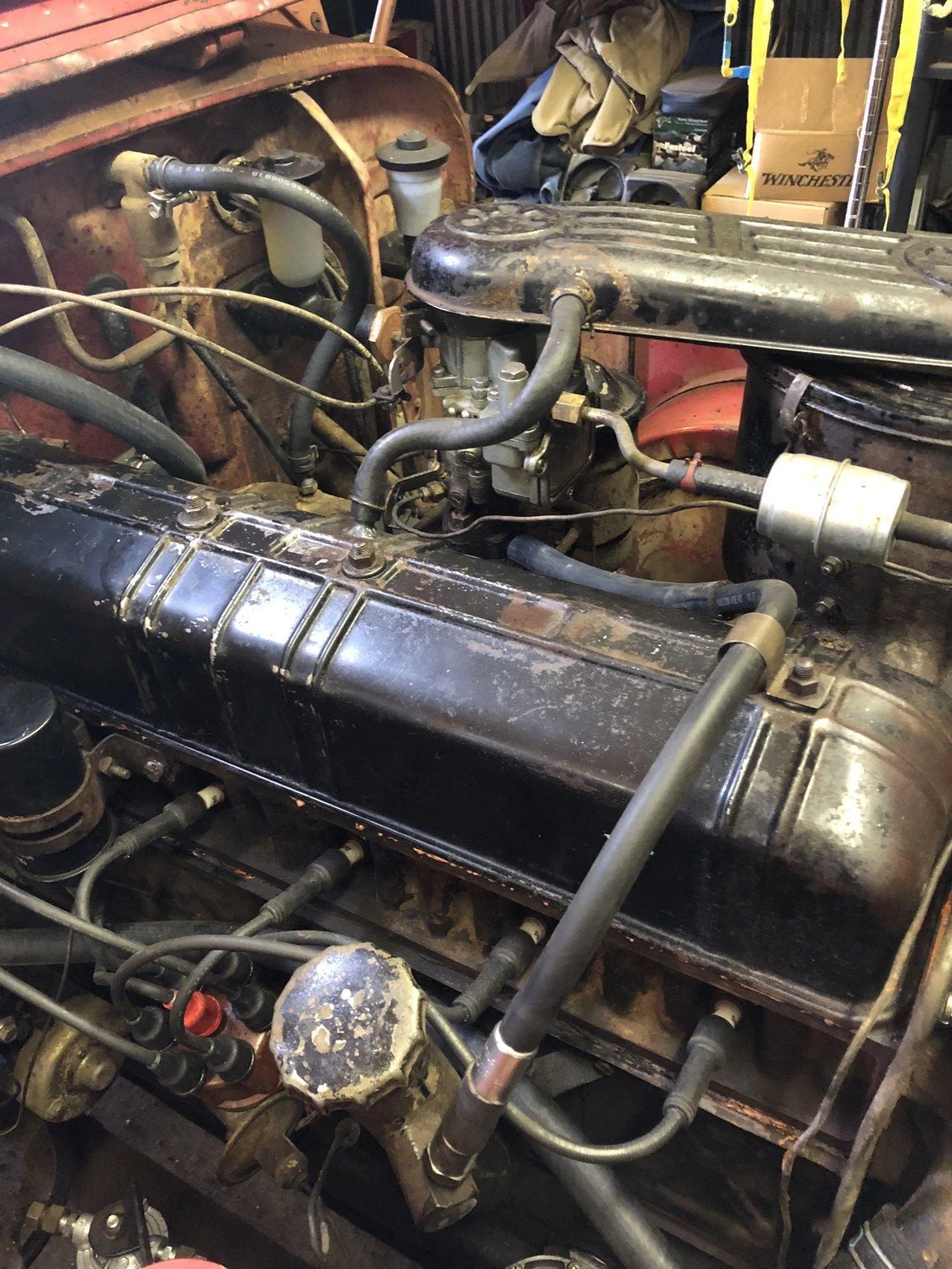

Got the final pieces of the coolant party in place.

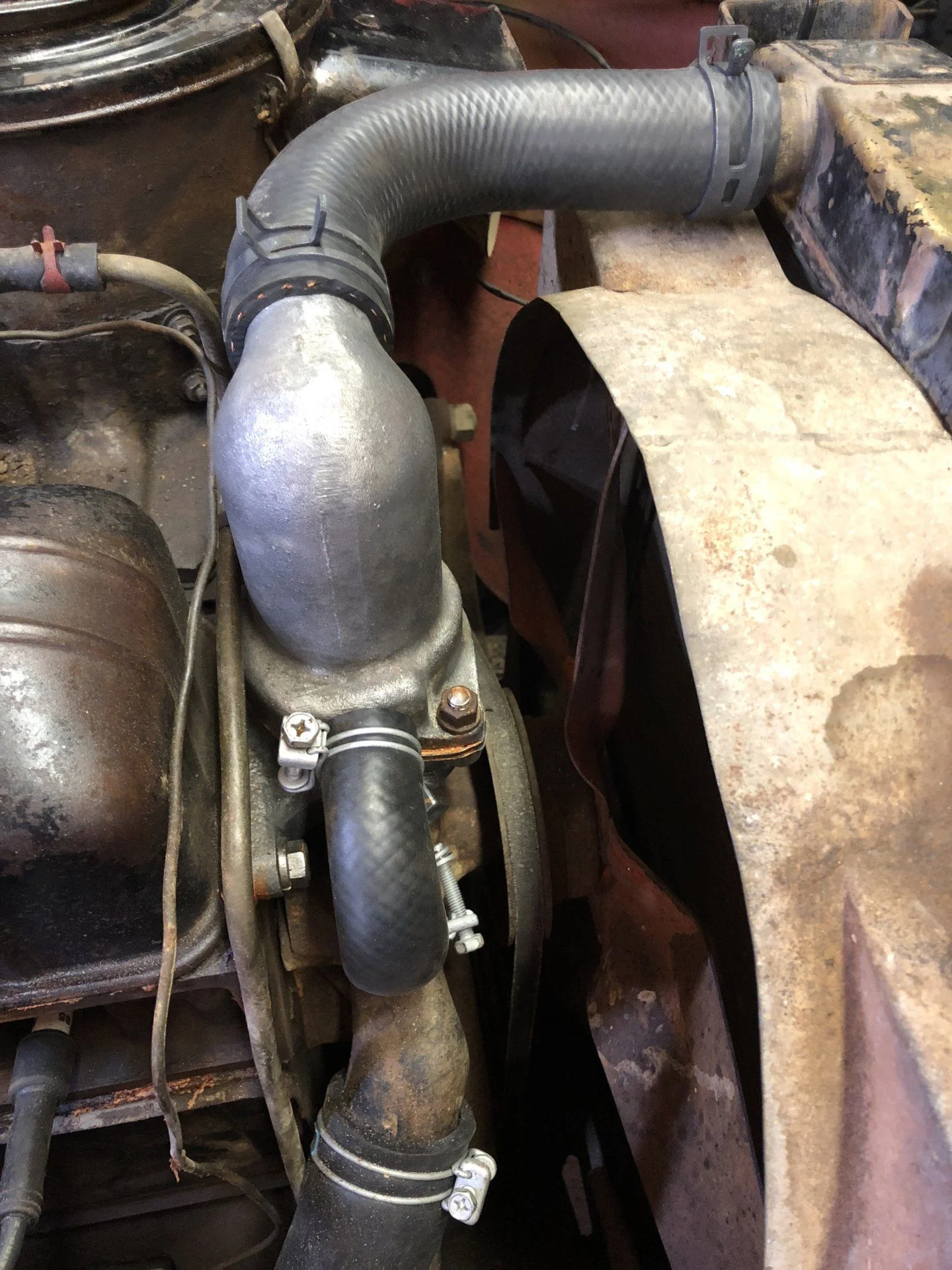

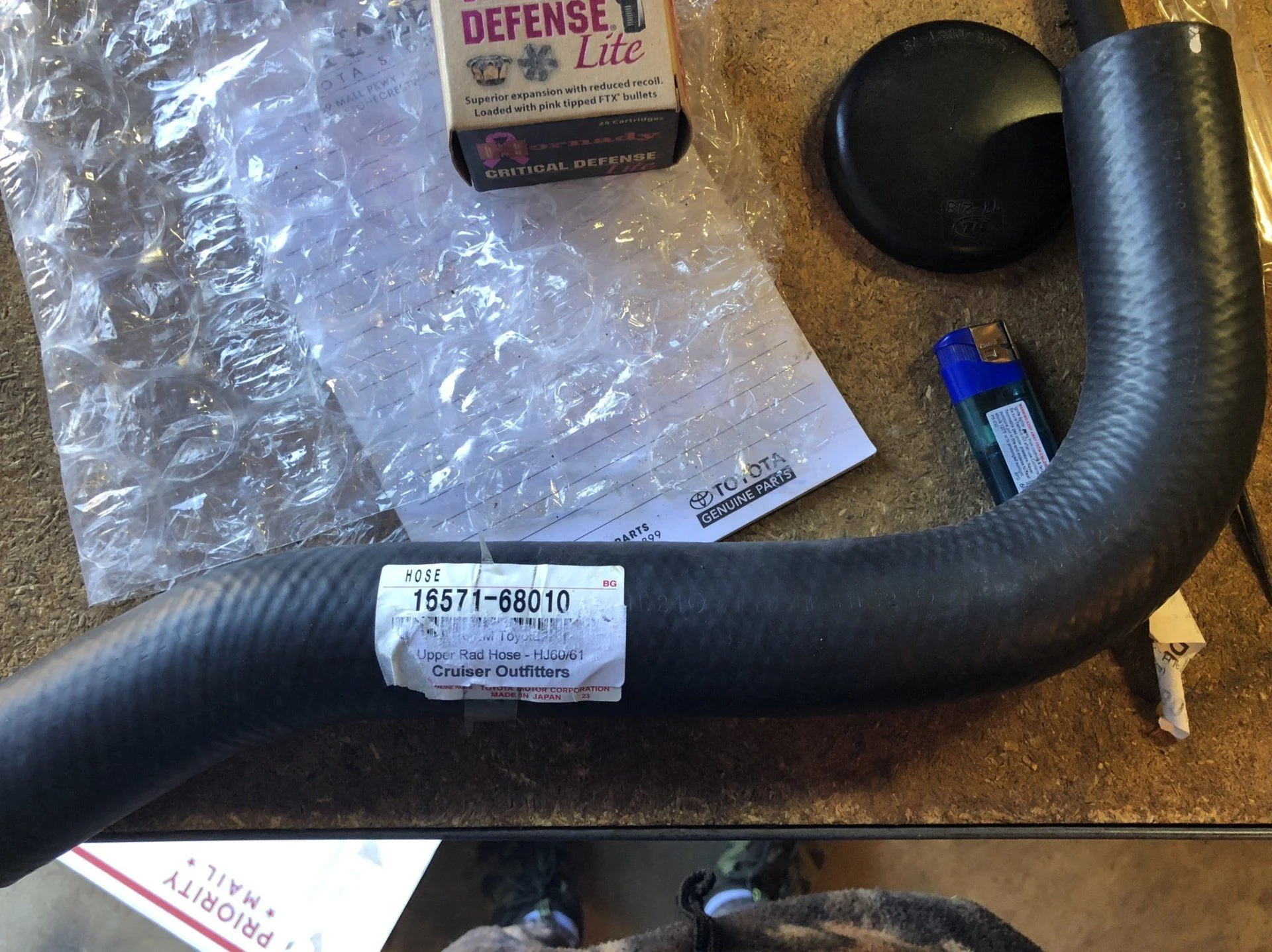

The upper hose came in from @cruiseroutfit For the record it’s an HJ60 upper with about 6” trimmed off the long end.

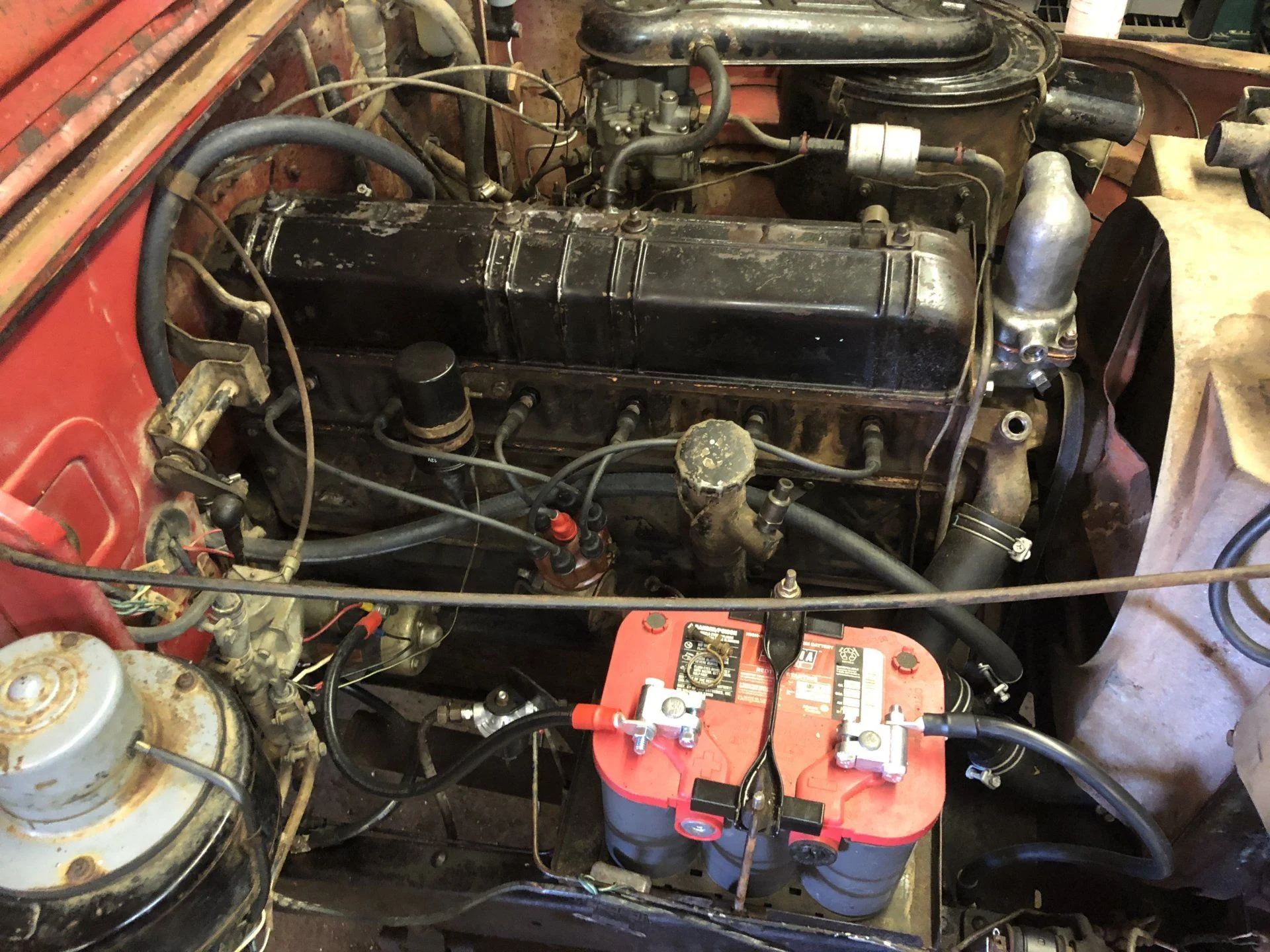

I got a bag of clamps from @beno and buttoned it all up. Vacuum lines new too. The plug in the carburetor base was a piece of Pinion pine.

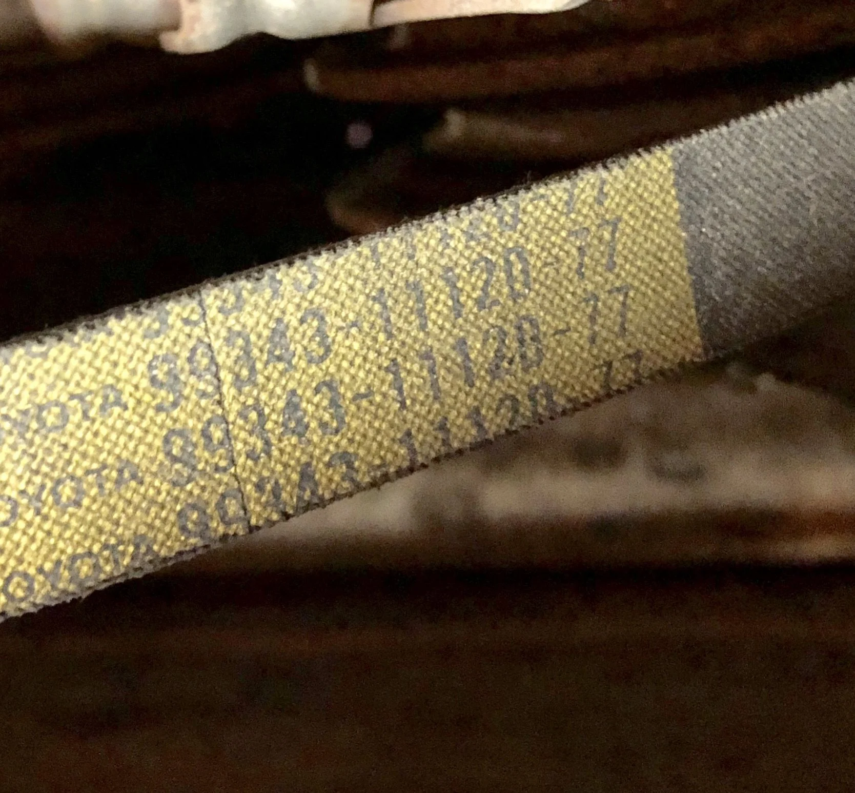

None of my new belts fit but I found this one I replaced (I think when I put in the new 2F in my FJ60) that worked perfectly
These black clamps for the upper radiator hose are too cool
And after filling it all up with fresh fluid it fired up and idled perfectly with the new spark plugs and cables and cap.
Then I looked under the hood to see the thermostat housing is pissing fluid. Crap.
I licked my wounds and moved on.

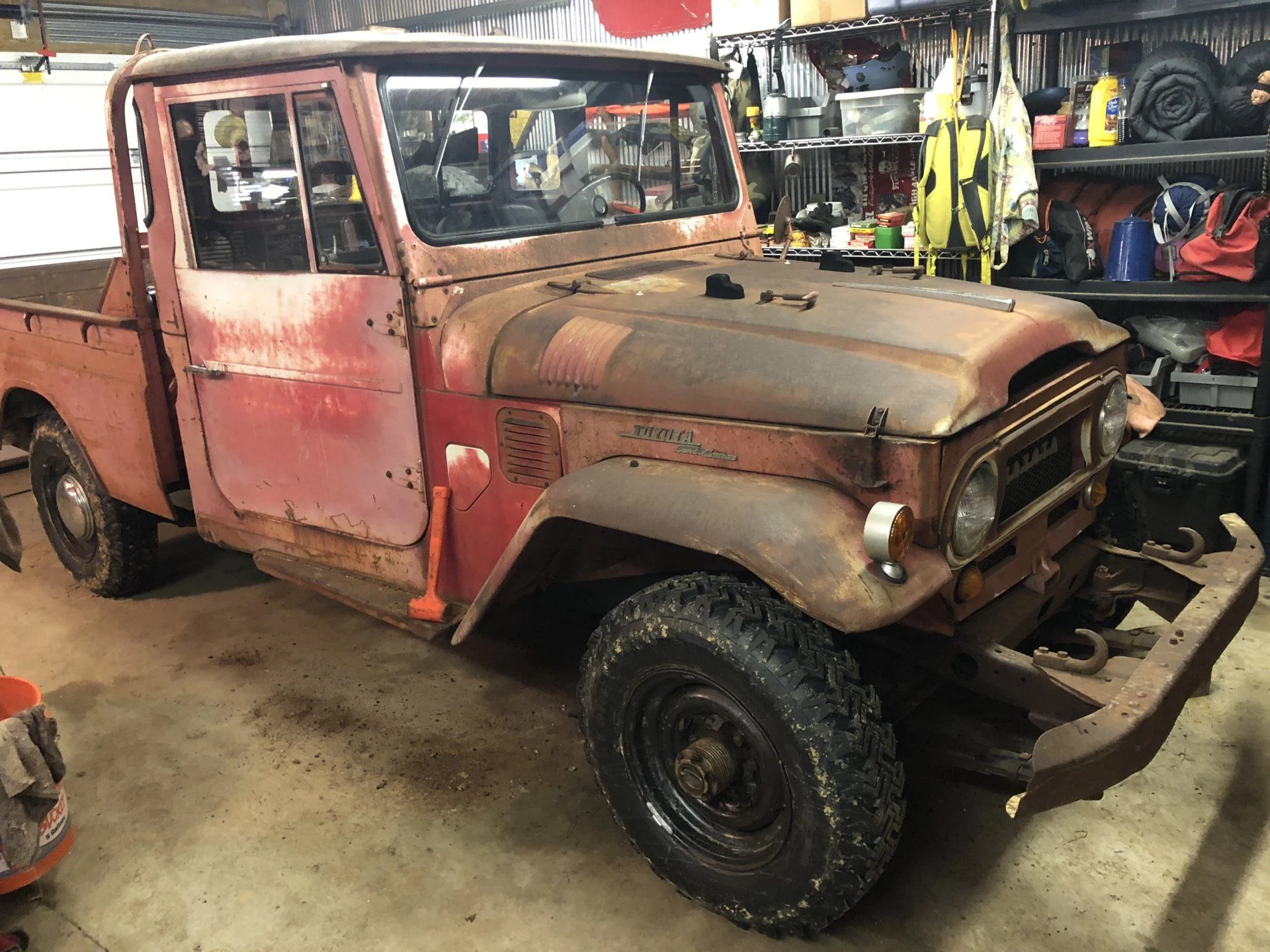

Pressure washed the antifreeze off everything then tackled the bodywork.
Got it all lined up.
Popped off the drivers fender before I called it quits for the day
Glad that hose worked out Nolan, the error was totally my own. Bryce asked if the 60060 fit and I was 100% confident it would, I was in fact 100% wrong :) I should have walked out front and popped the hood on Candace's 45. That hose works nicely it seems but I think with a bit more time we can find a match that requires less trimming and thus less cost :D
