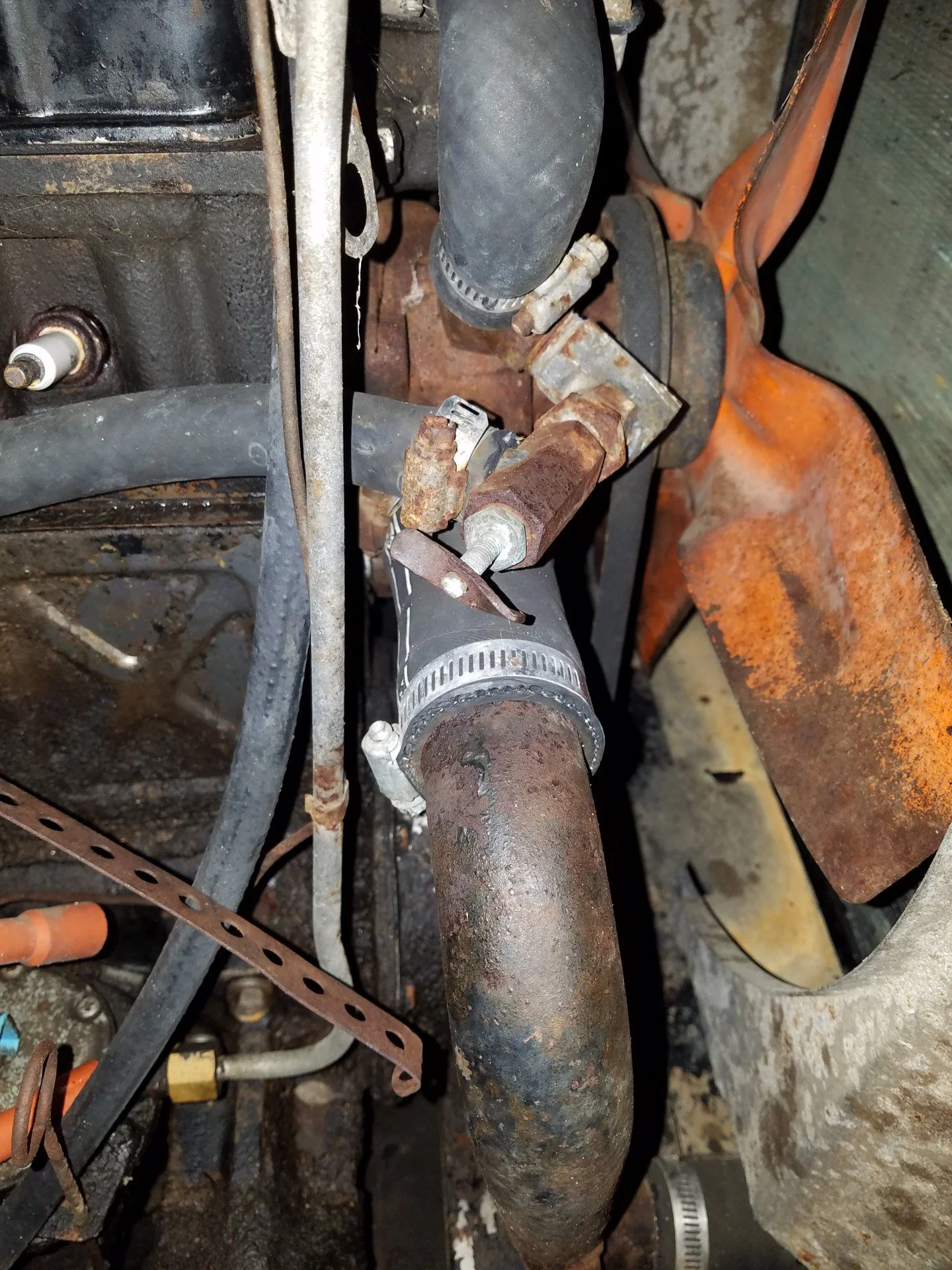

Y’all help me put my brain around this.

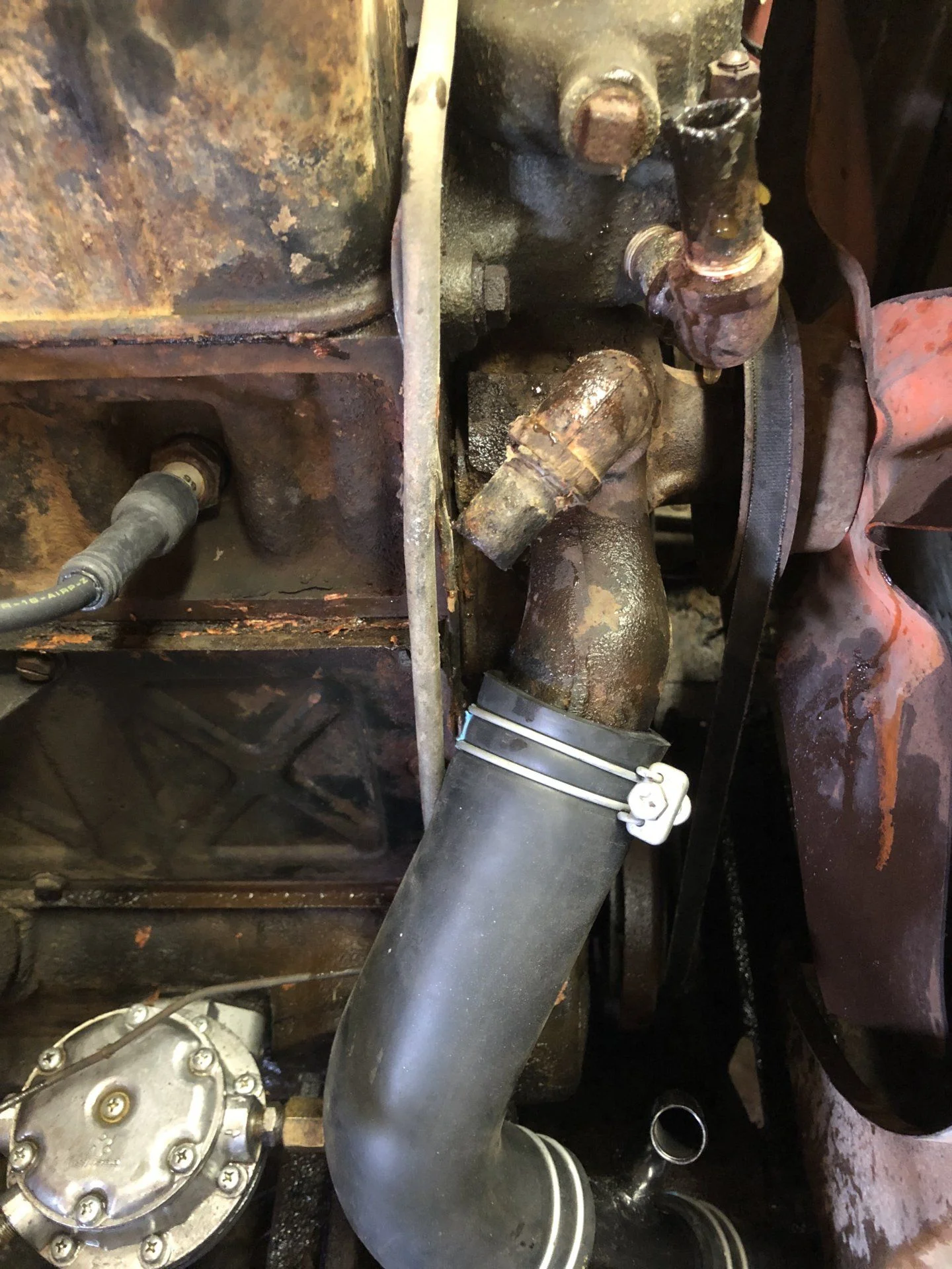

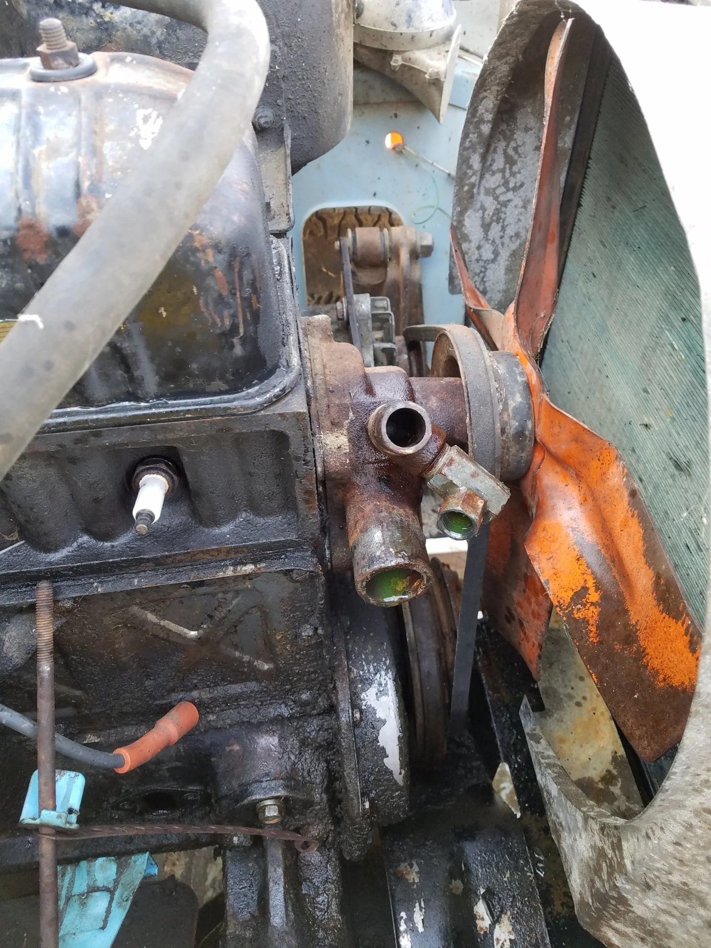

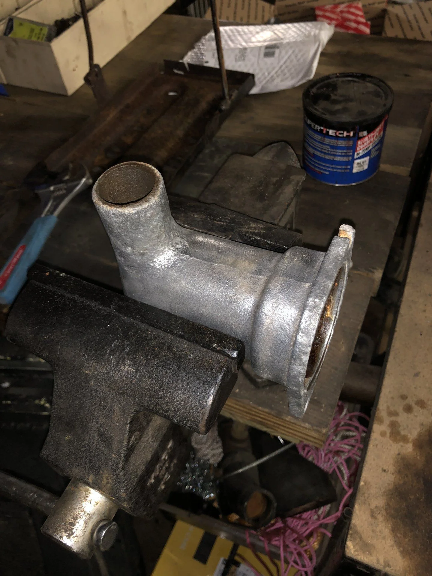

Since I have a later water pump and some hardware fittings and I’m installing new heater tube I’m going to reinstall the OEM bypass hose.
Which of these 3 holes needs the bypass hose?

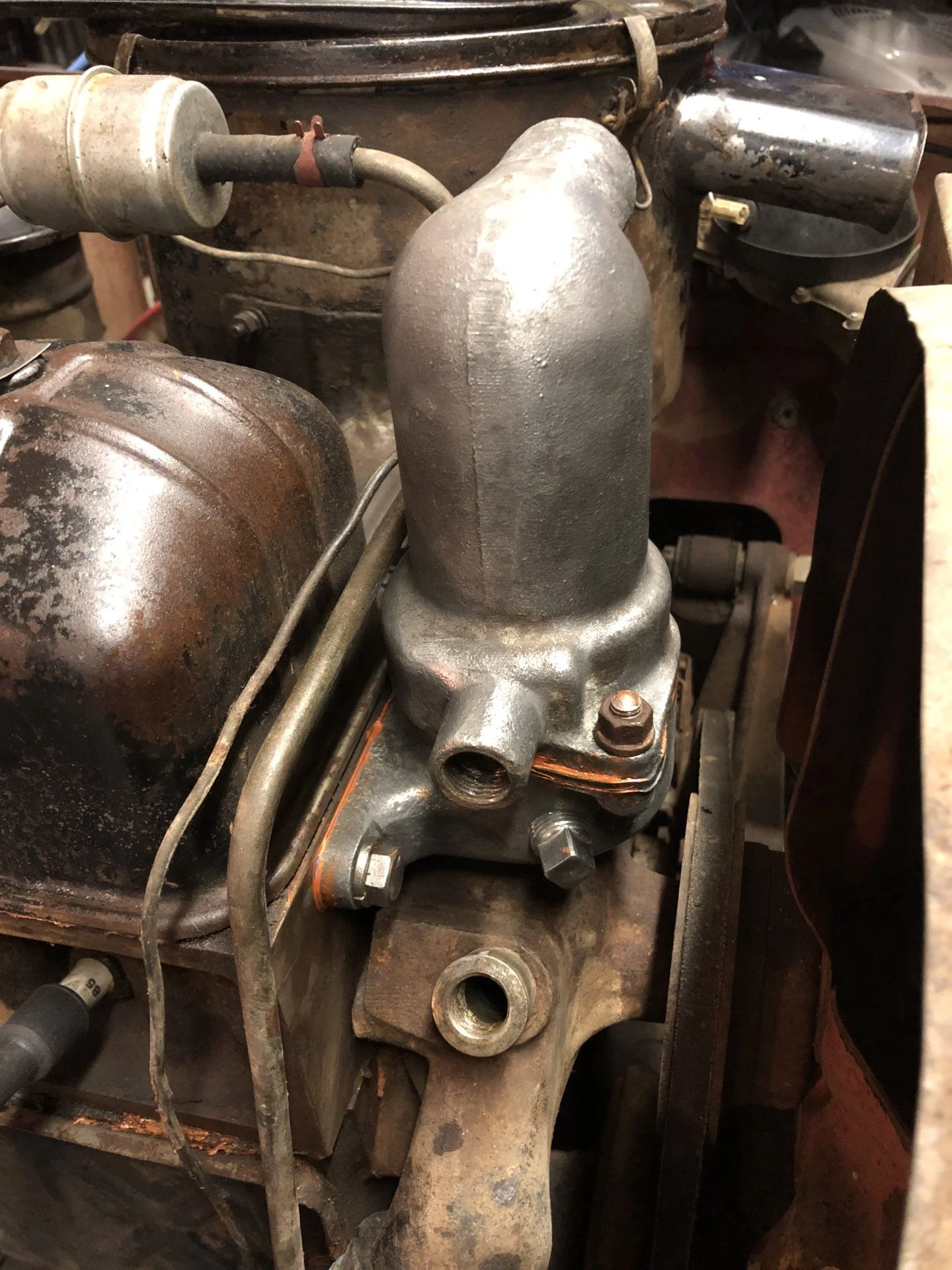

This is what I’m thinking. Plug the center right one.

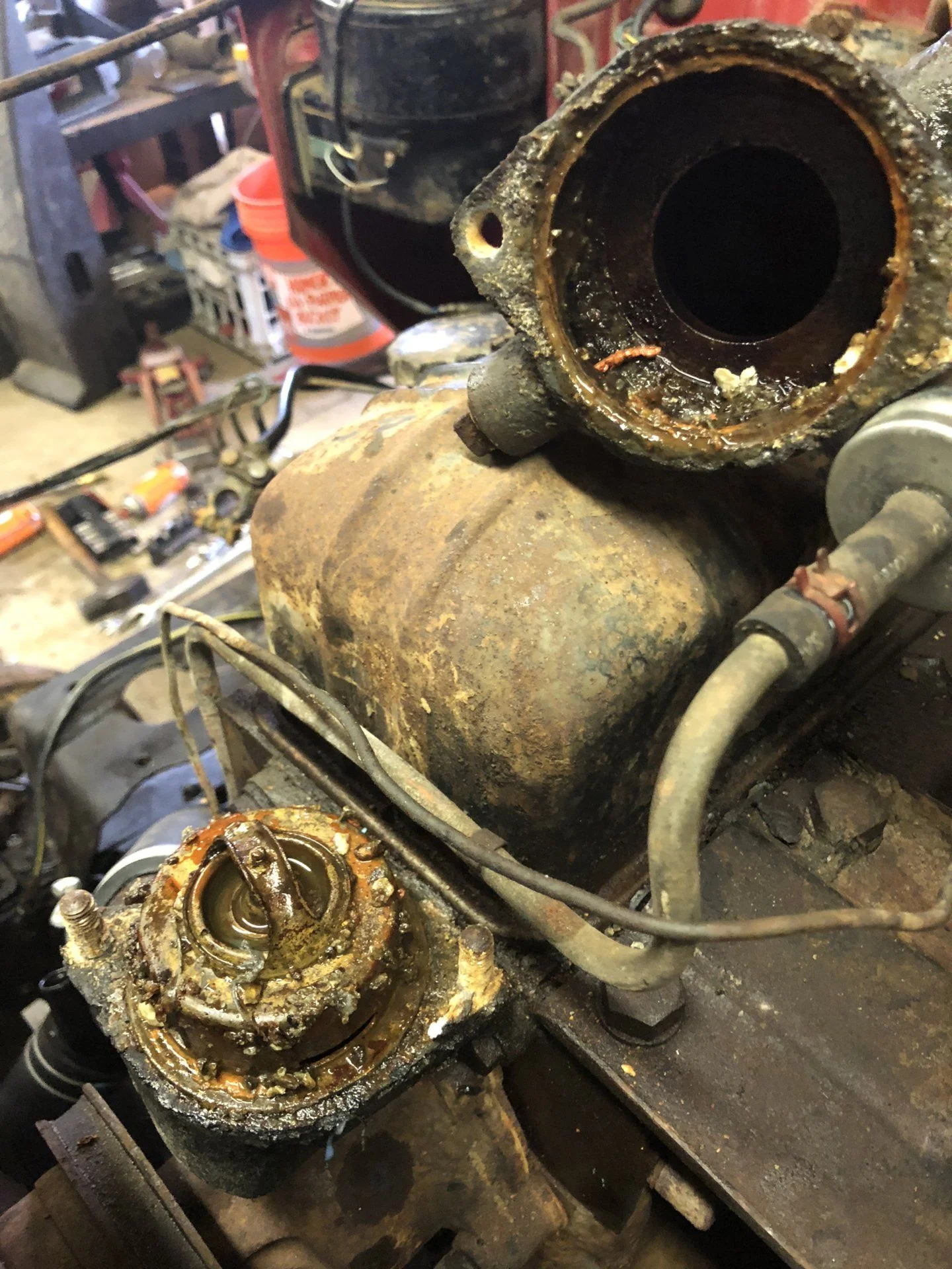

On the 2F lower thermostat housing, I thought that the thermostat flange sits into a recessed ring, then the sandwich gasket goes on top of the thermostat flange before joining the upper and lower housings.
Can't tell from the photo, but is the F engine thermostat housing different?
The lip is in the top part of the housing on this old tall F housing @Bear
It’s one of the coolest things on the motor. Mine is heavily pitted but I’ll RTV it as well to make it work.

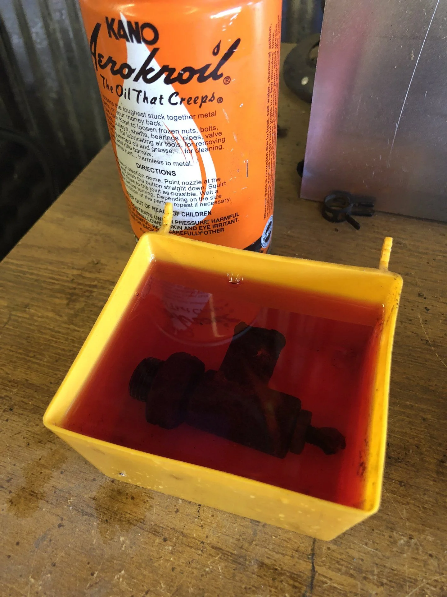

Yeah if I plug the bottom T housing hole and am able to get the plug out of the top hole (it’s soaking in Kroil for 48 hours) the top will line up perfectly with a bypass hose.

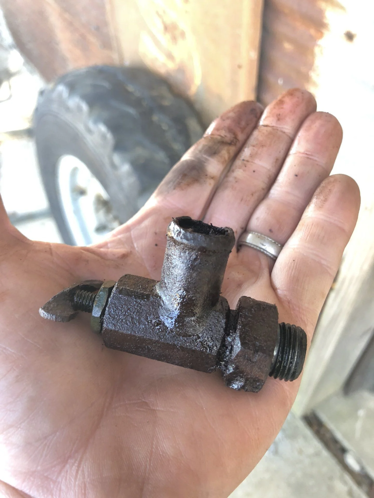

I farmed the heater valve off the 1970
Parts 40 too
I had a can of Kroil go bad so I cracked it open and dropped the valve in it.

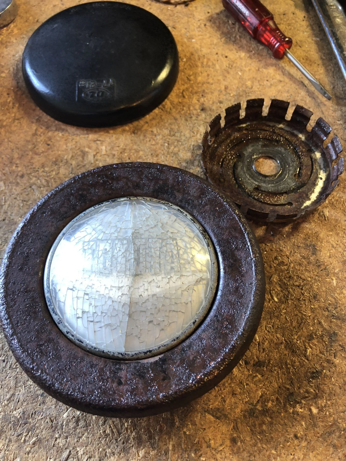

I also farmed the intact horn button off of it for Patina. Rust Inhibitor is on.

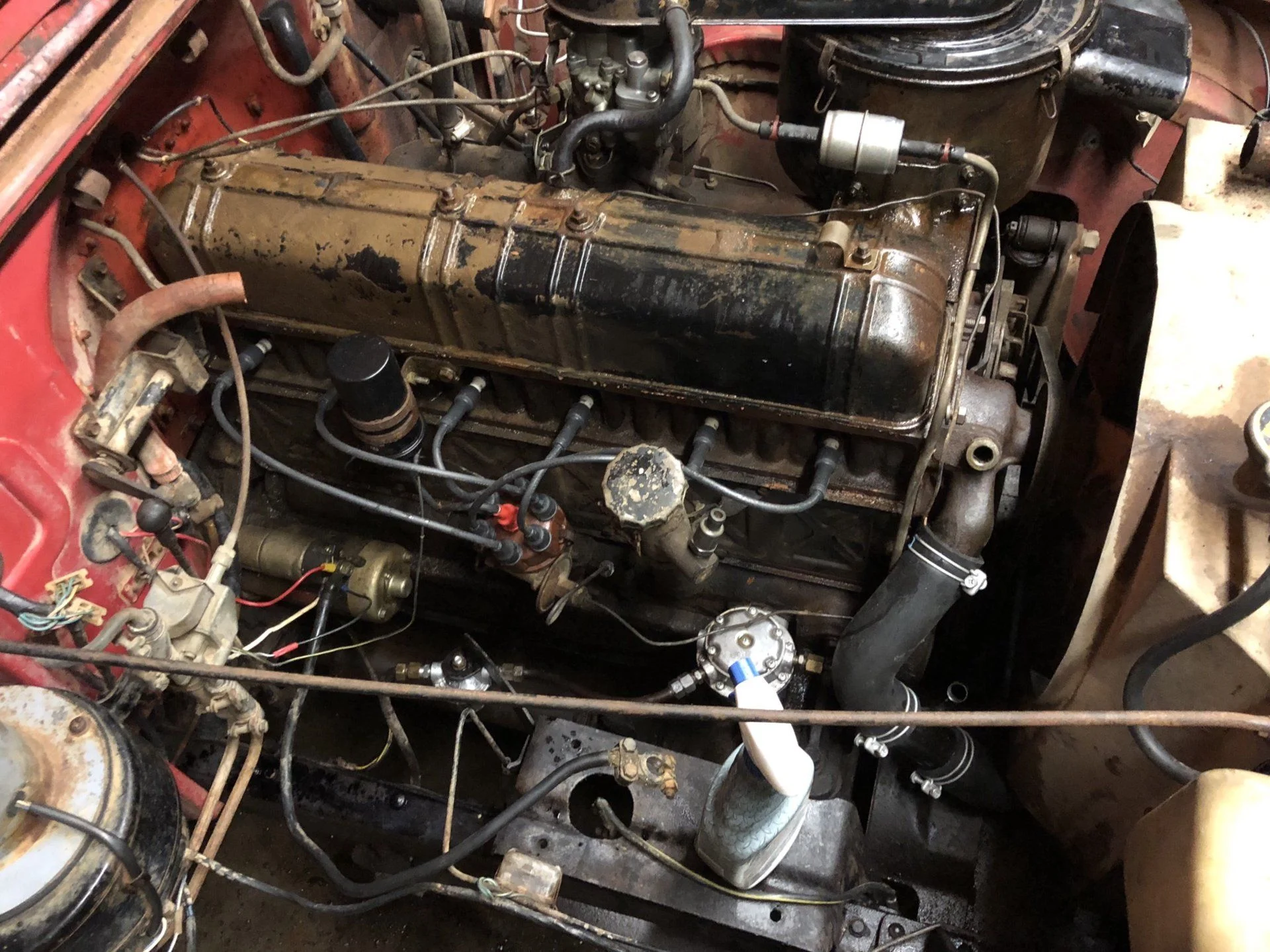

I got the lower housing plugged and put it all back together. Due to the heavy pitting I used RTV along with a rubber thermostat gasket I found in my stash.
It lines up now perfectly for the stock bypass hose.

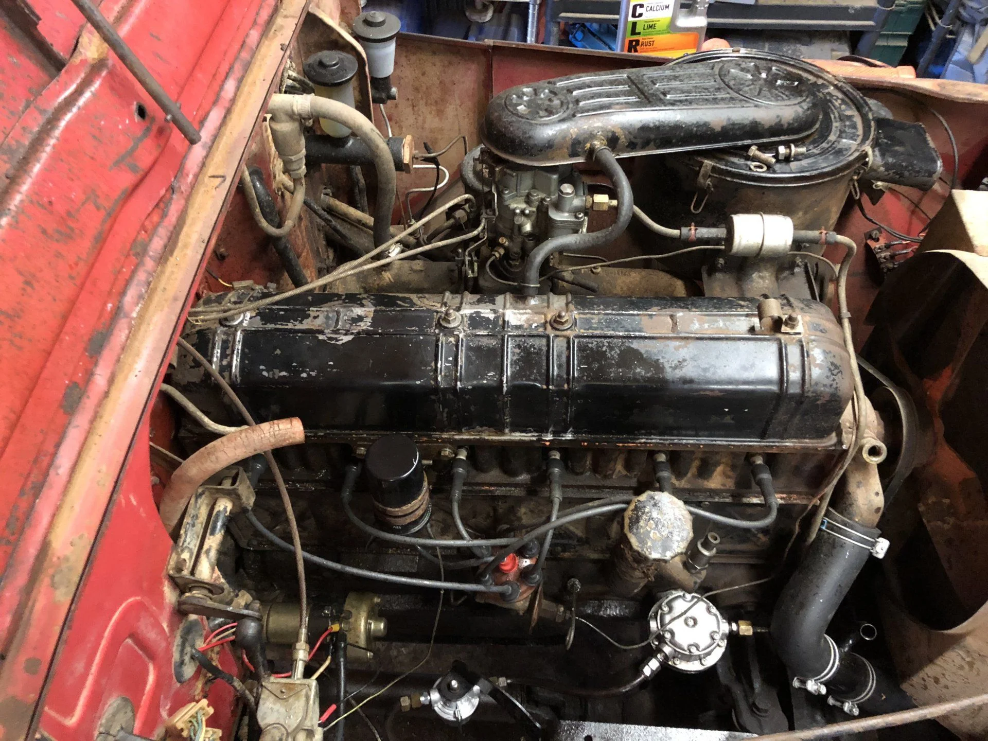

I also got the valve cover clean (ish)

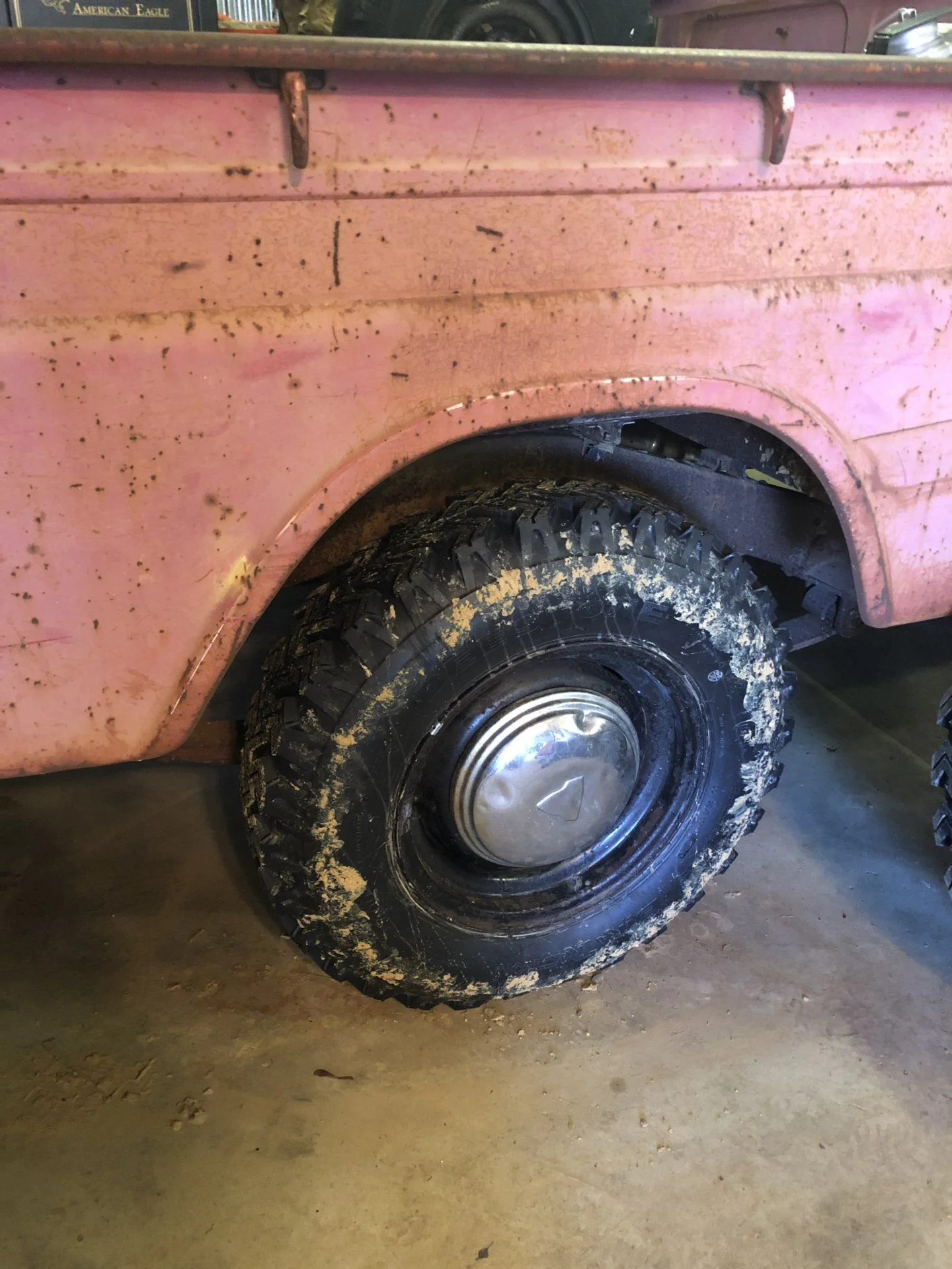

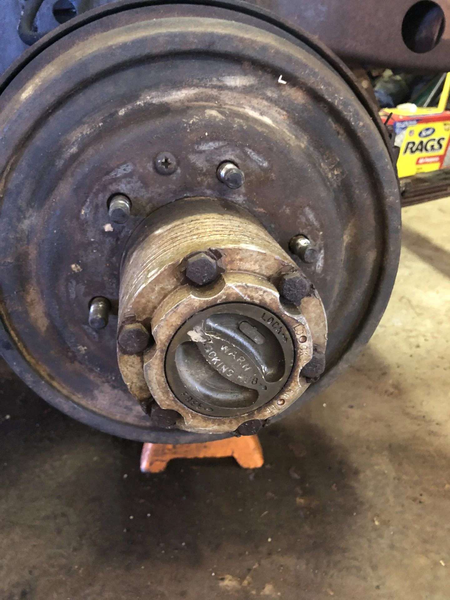

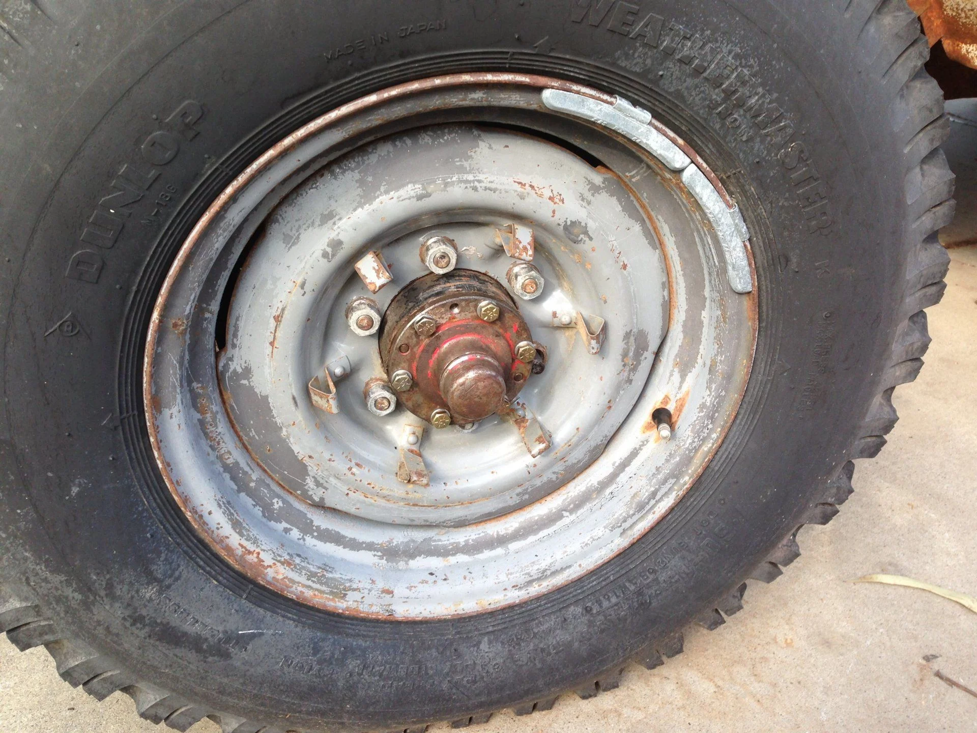

In 1974 your red Goat handled the Route 66 without hubs. :)
Cheers Peter I don`t miss them on mine
No!!!
Hang two w/o holes on wall (or pass along - hint hint), buy two repro ones with holes, drag them around behind the GOAT a bit and they’ll be worthy for the front wheels with hubs.
